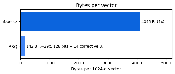

Name
Bytes / dim
1024-d vector
Compression
`Float` (Baseline)
4
4096 B
1x
`int8`
1
1024 B
4x
`int4`
0.5
512 B
8x
`bbq`
~0.14
142 B
~29x

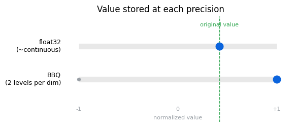

Better Binary Quantization (BBQ) is Elasticsearch's 1-bit quantization mode for dense vectors. Each dimension of the vector is stored as a single bit, plus a few corrective bytes per vector. Then, a rescoring step is applied at query time. This keeps the final retrieval quality close to a full precision search.
For the math behind each level, see Scalar quantization 101, Optimized Scalar Quantization, and the BBQ deep dive.
How does BBQ preserve search accuracy?
Plain 1-bit quantization leads to too high a search quality degradation on its own. BBQ maintains high retrieval quality through three mechanisms:
  1. Asymmetric precision: Stored vectors use 1 bit per dimension.
  2. Corrective factors: A few floats per vector record the rounding error and correct distances at scoring time.
  3. Oversample and rescore: BBQ scans candidates with the bits and then reranks the top ones with higher precision. Fetching the top 10 means scanning about 30 candidates.
The result is the vectors that are roughly 32x smaller, with retrieval quality close to full precision. In the next section of the article, we’ll measure the memory savings and the recall on a real corpus.

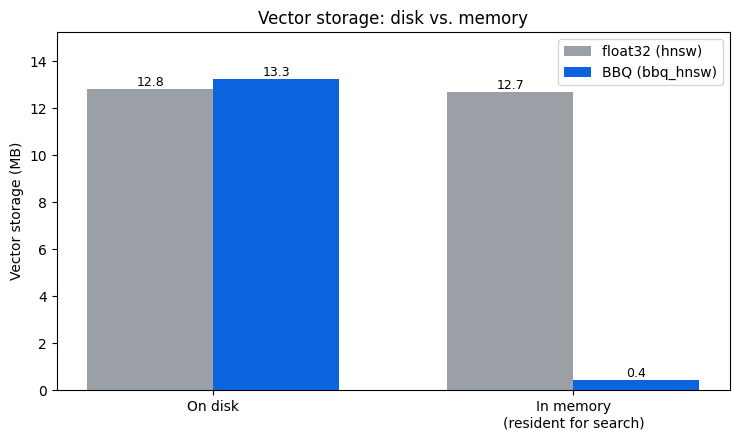

Results: Disk versus memory
The disk usage API reports how many bytes each index spends on vectors (knn_vectors).
def vector_disk_bytes(name):
    du = es_client.indices.disk_usage(index=name, run_expensive_tasks=True)
    field = du[name]["fields"]["embedding"]
    knn = field.get("knn_vectors")
    if isinstance(knn, dict):
        return knn["size_in_bytes"]
    return field["knn_vectors_in_bytes"]
float_disk = vector_disk_bytes(FLOAT_INDEX)
bbq_disk = vector_disk_bytes(BBQ_INDEX)
N = len(docs)
float_mem = N * DIMS * 4
bbq_mem = N * (DIMS // 8 + 14)
print(f"On disk   -> float32: {float_disk/1e6:6.2f} MB | BBQ: {bbq_disk/1e6:6.2f} MB")
print(f"In memory -> float32: {float_mem/1e6:6.2f} MB | BBQ: {bbq_mem/1e6:6.2f} MB  ({float_mem/bbq_mem:.0f}x smaller)")
Result:
On disk   -> float32:  12.80 MB | BBQ:  13.25 MB
In memory -> float32:  12.71 MB | BBQ:   0.44 MB  (29x smaller)
On disk, the two indices are about the same size. A quantized index still keeps the raw float32 vectors (needed for rescoring and requantization during merges) and adds the 1-bit vectors on top, so BBQ ends up slightly larger on disk.
The real savings is in memory. The HNSW scan only needs the 1-bit vectors in RAM, while the raw floats are read from disk to rescore the top candidates. We size that footprint using the documented kNN memory formulas: float uses num_vectors × dims × 4 and bbq uses num_vectors × (dims/8 + 14).
BBQ's extra bytes on disk should match the 1-bit payload we computed for memory. Here, that’s 13.25 - 12.80 = 0.45 MB versus the computed 0.44 MB. They line up.

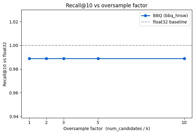

Results: Recall
To check whether the quantized index returns results similar to the float baseline, we use recall:
recall@k = | BBQ top-k ∩ float32 top-k | / k, averaged over all queries.
We vary the oversampling factor (num_candidates / k) that’s the number of candidates BBQ scans with 1-bit vectors before reranking the top ones against the original floats to find the lowest value that still matches float32.
def search_ids(index, qvec, k=10, num_candidates=10):
    resp = es_client.search(
        index=index,
        size=k,
        _source=False,
        knn={
            "field": "embedding",
            "query_vector": qvec.tolist(),
            "k": k,
            "num_candidates": num_candidates,
    return [h["_id"] for h in resp["hits"]["hits"]]
K = 10
# Ground truth: full-precision float32 with a wide candidate list (~exact)
ground_truth = [
    set(search_ids(FLOAT_INDEX, qv, k=K, num_candidates=2000)) for qv in query_vectors
oversamples = [1, 2, 3, 5, 10]
recalls = []
for f in oversamples:
    num_candidates = max(K * f, K)
    hits = 0
    for gt, qv in zip(ground_truth, query_vectors):
        got = set(search_ids(BBQ_INDEX, qv, k=K, num_candidates=num_candidates))
        hits += len(got & gt)
    recalls.append(hits / (len(query_vectors) * K))
    print(f"oversample {f:>2}x -> recall@{K} = {recalls[-1]:.3f}")
As a result, we have:
BBQ starts at 0.994 recall@10 at 1x oversampling, holds there up to 3x, and then settles at 0.989 at higher factors, meaning it returns at least 98.9% of the same top-10 documents as float32 across all oversampling values. For more on how recall varies across datasets under quantization, see Fast vs. accurate: Measuring the recall of quantized vector search.
BBQ quantization results summary
The same vectors, two storage formats, and one experiment:
  • Disk: Roughly the same (12.80 MB versus 13.25 MB). BBQ keeps the raw floats around for rescoring and merging.
  • Memory: 29x smaller (12.71 MB versus 0.44 MB). This is the number that decides whether your cluster fits the corpus.
  • Recall@10: 0.994 at 1x oversampling. Quantization-aware training pays off.
