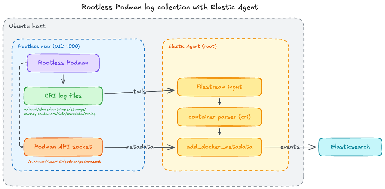

How the rootless Podman log pipeline fits together
The setup we ended up with is simple once all the pieces are known:
  1. Elastic Agent tails the raw CRI log files from the rootless user's container storage.
  2. A container parser with format: cri strips the timestamp, stream, and flag prefix from each line.
  3. A processor extracts the container ID from a fixed position in the log file path.
  4. The add_docker_metadata processor resolves that ID against the rootless Podman socket and attaches container name, image, and labels.
  5. Enriched events are shipped to Elasticsearch.

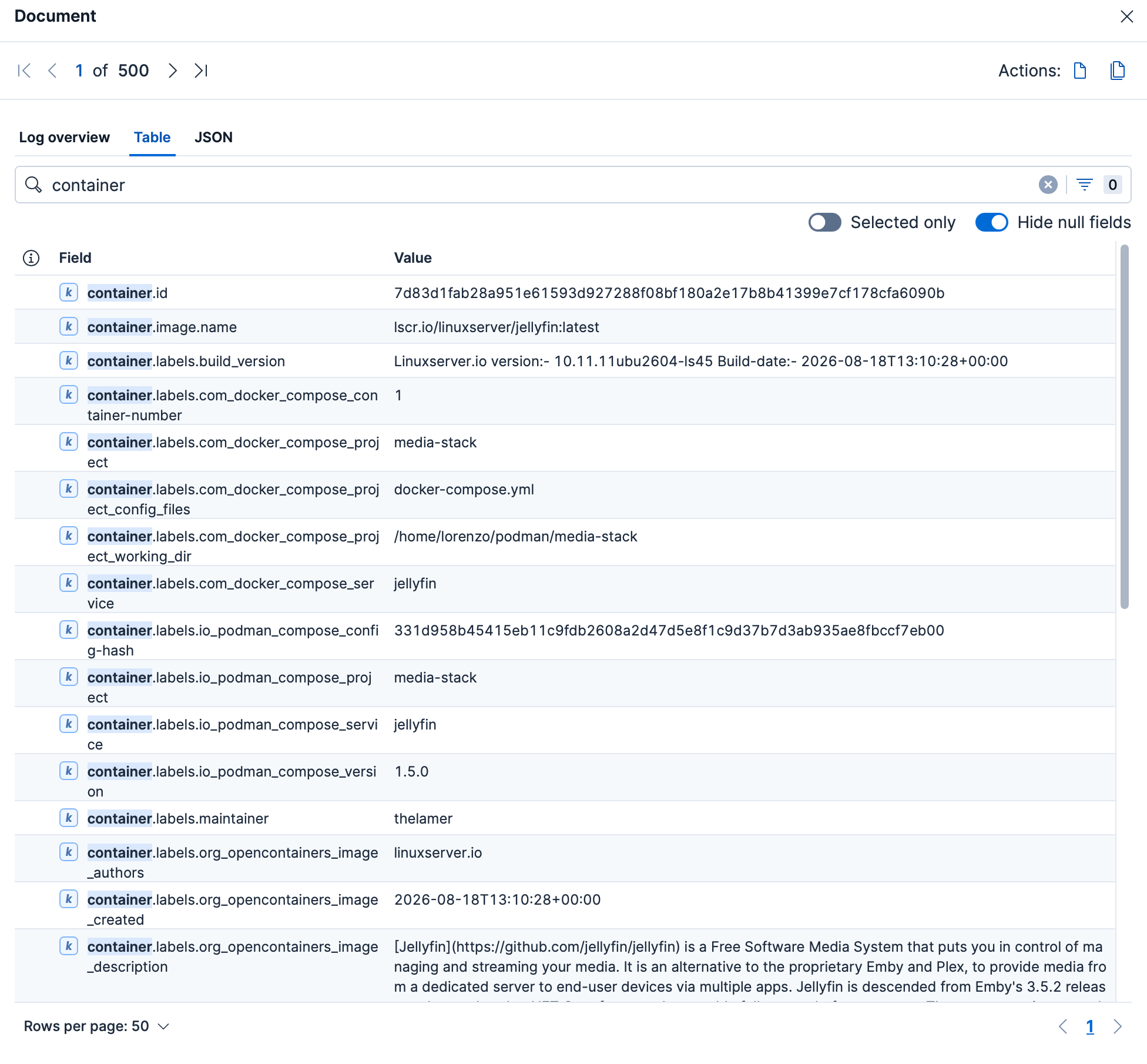

Once the ID resolves correctly, the processor calls the Podman socket and each event gains the familiar container.* fields. Here is a real document from a Jellyfin container managed with podman-compose:
The metadata is more complete than it first appears: alongside container.id and container.image.name, every label on the container arrives too, including the com_docker_compose_* and io_podman_compose_* labels set by podman-compose and the standard org_opencontainers_image_* labels baked into the image. Filtering all logs of a compose project is now one query on container.labels.com_docker_compose_project.

  • container.id is the full 64-character ID, and container.name and container.image.name are populated.

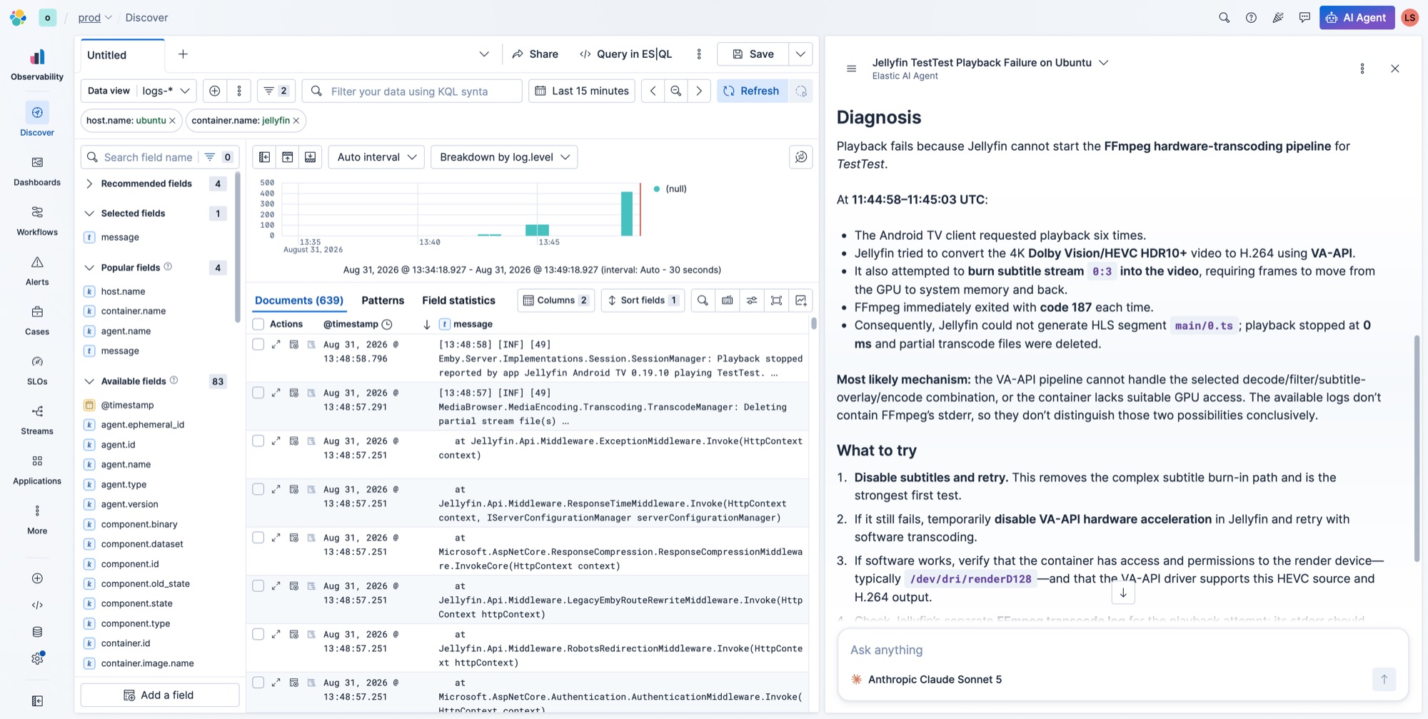

Root cause analysis on Podman logs with Agent Builder
Was it worth the effort? Absolutely! Getting clean, metadata-rich container logs into Elasticsearch lets an LLM investigate issues against the data directly, and Elastic Agent Builder is the quickest way to see that in action.
Agent Builder, available on Elastic Cloud Serverless and the Enterprise tier for Elastic Cloud Hosted and self-managed, provides a chat interface in Kibana, backed by an LLM, with built-in tools to explore your indices and run ES|QL queries against them.
Here is a real example from the host we just configured. Among other containers, it runs Jellyfin, a media server, as a rootless Podman container. One day, playback of a title fails instantly on an Android TV client: the screen goes black and drops back to the menu, with no error apart from a cryptic "Playback error".
In Discover, filtering on container.name: "jellyfin" narrows the view to a few hundred verbose .NET log lines around the playback attempts. The histogram shows a burst of activity at each failed attempt, but the actual cause is buried somewhere in the noise.
Instead of scanning the messages manually, open the Agent Builder panel directly from Discover and ask it to investigate the issue. The agent queries the log data stream on its own, reconstructs the timeline, and returns a diagnosis:
In this run it worked out that the client requested playback six times. Jellyfin tried to convert a 4K Dolby Vision/HEVC video to H.264 through VA-API hardware transcoding while burning in a subtitle stream, and FFmpeg exited with code 187 each time before producing the first HLS segment. That is why playback stopped at zero milliseconds. It also stated its uncertainty honestly: the available logs don't contain FFmpeg's stderr, so it proposed concrete steps to discriminate between a broken transcoding combination and missing GPU access, including checking whether the container can reach the render device /dev/dri/renderD128.
The pipeline we just built made each step of this investigation possible. The agent can slice by container.name only because add_docker_metadata resolved it from the Podman socket, the message field is queryable because the CRI parser stripped the prefixes, and the timeline is trustworthy because @timestamp comes from Podman, not from ingestion time. Without that work, the LLM would face a pile of prefixed raw lines, likely resulting in worse performance and higher token usage.
