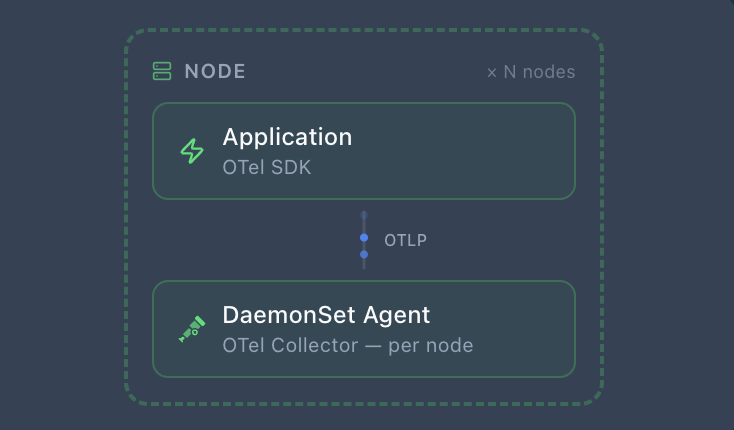

DaemonSet Agent — One OpenTelemetry Collector per Kubernetes node, deployed as a DaemonSet. Applications export to the agent running on the same node (typically via status.hostIP:4317 using the Kubernetes Downward API). The agent also tails container log files from disk via the filelog receiver and scrapes host-level metrics via the hostmetrics receiver. This is the most common Kubernetes pattern because it handles both application and infrastructure telemetry with a single deployment, and applications only need to know about localhost.

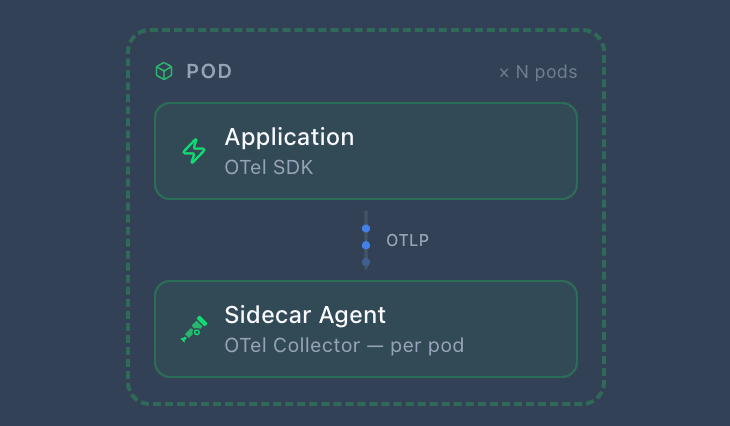

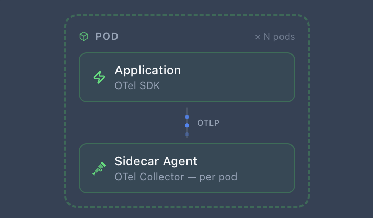

Sidecar Agent — One OpenTelemetry Collector per pod, deployed as a sidecar container. Each service gets its own collector with a custom configuration. This is required on managed container platforms like AWS Fargate or Azure Container Apps where DaemonSets aren't available, and it's useful when services have different processing requirements. When running alongside a DaemonSet, the sidecar handles application telemetry while the DaemonSet independently collects node-level telemetry — applications don't send to both.

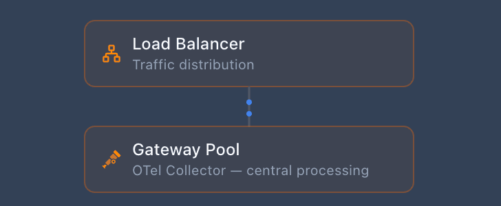

Centralized policy (Gateway) — A pool of OpenTelemetry Collectors that sits between edge collectors and the backend. This is where you enforce consistent filtering, transformation, and PII redaction across all services. It's also where you manage backend credentials — edge collectors export to the gateway over OTLP, and only the gateway holds the API keys. Credential isolation is often the primary reason teams add a gateway.
Replica count scales with data volume. At low volumes (under 1K events/sec), 2 replicas co-located with workloads is sufficient. At medium volumes, 3–5 replicas on a dedicated node pool. At high volumes, 5–20+ replicas, potentially in a separate cluster. This is a general rule of thumb, and you should adapt it to your specific needs as loads might vary significantly between payload types.

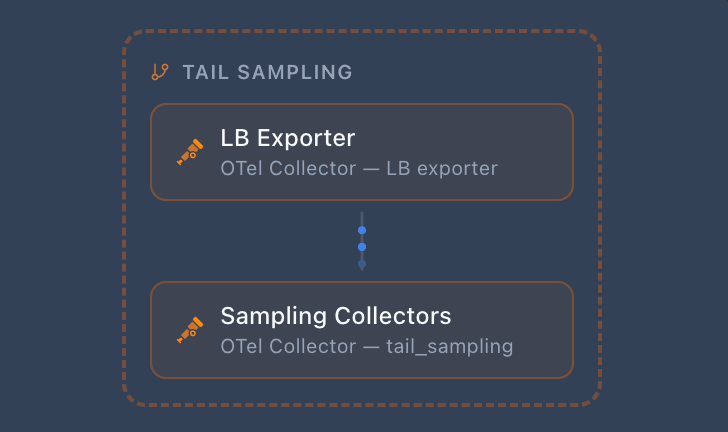

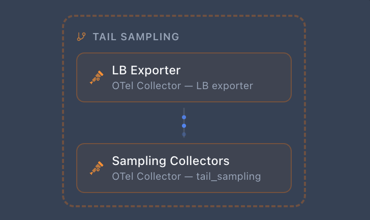

Tail-based sampling — Sampling decisions that consider the complete trace (e.g., "keep all traces with errors, sample 10% of successful traces") require that all spans of a trace reach the same collector instance. This is achieved with the loadbalancingexporter using routing_key: traceID, which consistently routes spans from the same trace to the same downstream collector.
There's a critical subtlety here: if you're deriving span metrics (RED metrics) from traces using the spanmetrics connector, the derivation must happen before sampling. Otherwise, your metrics only reflect the sampled subset, not the true traffic. The correct pattern is a two-step pipeline within the sampling stage:
  1. Receive traces, derive spanmetrics from 100% of traffic, forward via a forward connector.
  2. Apply tail_sampling to the forwarded traces, export only kept traces.
  3. A separate metrics pipeline exports the derived RED metrics.
This ensures accurate metrics regardless of your sampling rate.

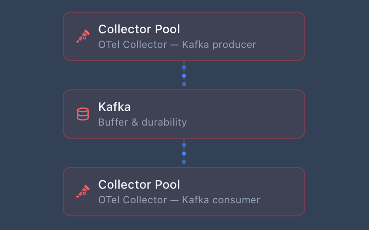

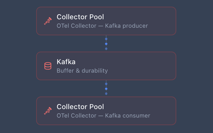

Kafka Buffer — An external Kafka cluster sits between collectors and the backend. Producer collectors write to Kafka topics; consumer collectors read from Kafka and export to the backend. This provides the strongest durability guarantee — Kafka can buffer hours of telemetry during extended outages and enables replay. But it adds significant operational complexity.
The important thing to understand is that resilience is orthogonal to the other layers. You can add persistent queues to an edge agent, a gateway, or a sampling tier. You can put Kafka in front of a gateway, in front of a sampling tier, or in front of the backend. A tail sampling deployment that needs to survive extended outages might use Kafka-backed ingestion — combining what might look like two separate "modules" into a single stage. The building blocks compose freely based on what you need to protect against.

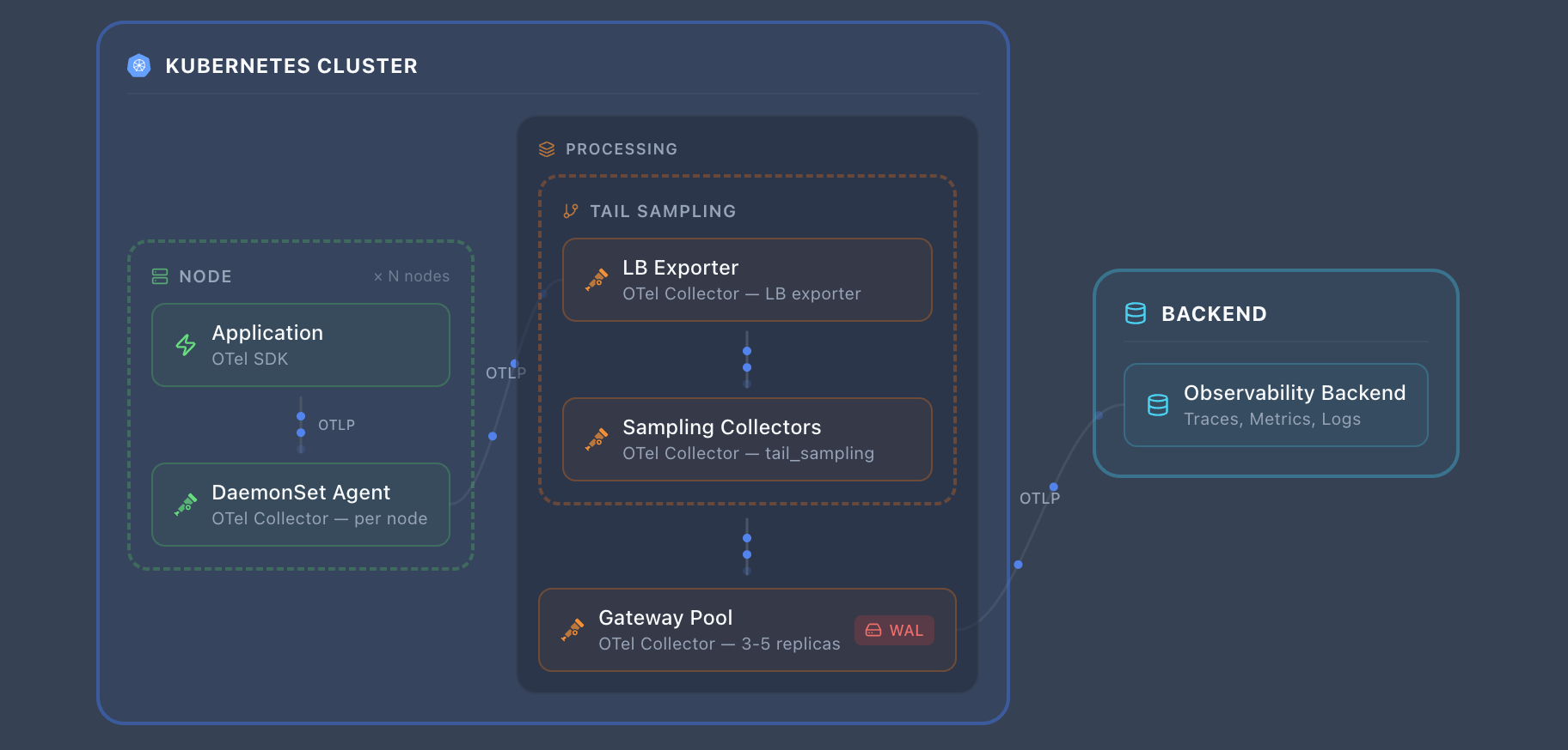

The Agent + Gateway two-tier pattern is the de facto production standard, used by the vast majority of organizations running OpenTelemetry at scale. DaemonSet agents on every node handle local collection — pulling infrastructure telemetry via filelog and hostmetrics, receiving application telemetry via OTLP — while a centralized gateway pool enforces policy, manages credentials, and exports to the backend. Persistent queues (WAL) on the gateway protect against backend outages without external dependencies.
Every other configuration either simplifies this pattern or extends it. Smaller environments might drop the gateway and export directly from agents. Larger ones might add a tail sampling tier with traceID-based load balancing, a Kafka buffer for extended resilience, or span metrics derivation before sampling. The building blocks described in the previous sections — edge, processing, resilience — are the modules you add or remove from this foundation.
The key is to start with the two-tier pattern and evolve incrementally:
  • Need credential isolation or centralized PII redaction? You already have the gateway.
  • Need tail-based sampling? Add a load-balancing exporter and a sampling tier between agents and gateway.
  • Need hours of buffer during extended outages? Insert Kafka between agents and the processing tier.
  • Running on Fargate or Azure Container Apps? Swap DaemonSet agents for sidecars — the rest of the pipeline stays the same.
Start here. Add modules as your needs grow. The architecture adapts to your scale, not the other way around.

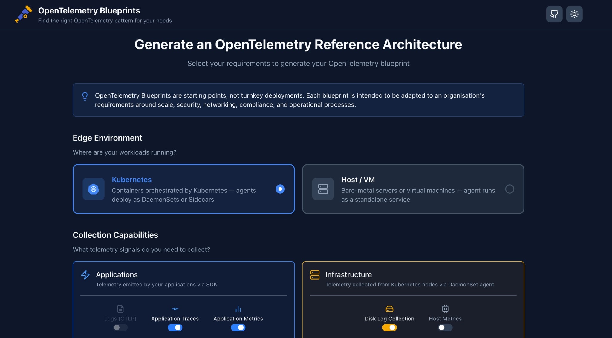

If you'd rather explore how these building blocks compose than assemble them by hand, OpenTelemetry Blueprints is an open-source tool that generates reference architectures from your requirements.
Toggle your environment, signals, volume, resilience, and processing needs — and get a composed diagram with animated data flow, interactive tooltips, and reference collector configurations you can open directly in OTelBin for validation.
The generated configurations export via OTLP, so they work with any OTLP-compatible backend — including Elastic Observability, which natively accepts and stores OTLP traces, metrics, and logs.
The architectures Blueprints generates are reference compositions — starting points for understanding how the building blocks fit together, not turnkey deployments. Every architecture should be adapted to your organisation's scale, security, networking, and compliance requirements. The patterns might combine or overlap differently in your environment than in anyone else's, and that's the point.
