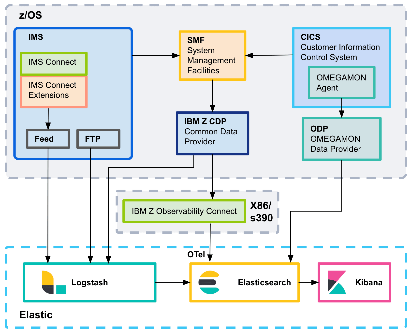

Flow diagram of the ingest paths from z/OS to Elastic.
IBM Z CDP: The workhorse for z/OS operational data
IBM Z CDP is the most widely deployed first-mile collector for z/OS operational data. It reads from SMF datasets in near-real time and forwards off-platform, handling the genuinely difficult part of getting data off z/OS without burdening performance-critical paths. In the environments I work with, it's the standard path for SMF type 30 job accounting, IMS statistical records, and z/OS SYSLOG.
CDP forwards to Logstash, which handles parsing, field extraction, and routing into Elasticsearch. Kafka is an optional middleware message queue:
  • CDP → (Kafka →) Logstash → Elasticsearch
The trade-offs: CDP is a separately licensed IBM product, binary SMF records need preprocessing before Logstash can parse them, and the architecture isn't suited to sub-minute latency requirements.

Reference architecture: Logstash to Elasticsearch.
IMS Connect Extension: For IMS workloads that can bypass CDP
Rocket Software's IMS Connect Extension journals IMS transaction activity directly as JSON, bypassing the SMF layer entirely. Events publish to Kafka, and Logstash consumes and indexes. Some organizations standardize all log streams through Kafka (rsyslog → Kafka → Logstash) as an optional resilience pattern.
  • IMS Connect Extension → (Kafka →) Logstash → Elasticsearch
This works well for IMS transaction performance data and application-level event streams. JSON output removes the binary parsing problem. Kafka gives you decoupling, replay, and a buffer for downstream maintenance.
The trade-offs: IMS Connect Extension licensing, Kafka infrastructure to operate, and IMS-specific coverage that doesn't help with z/OS SYSLOG or other SMF types.
