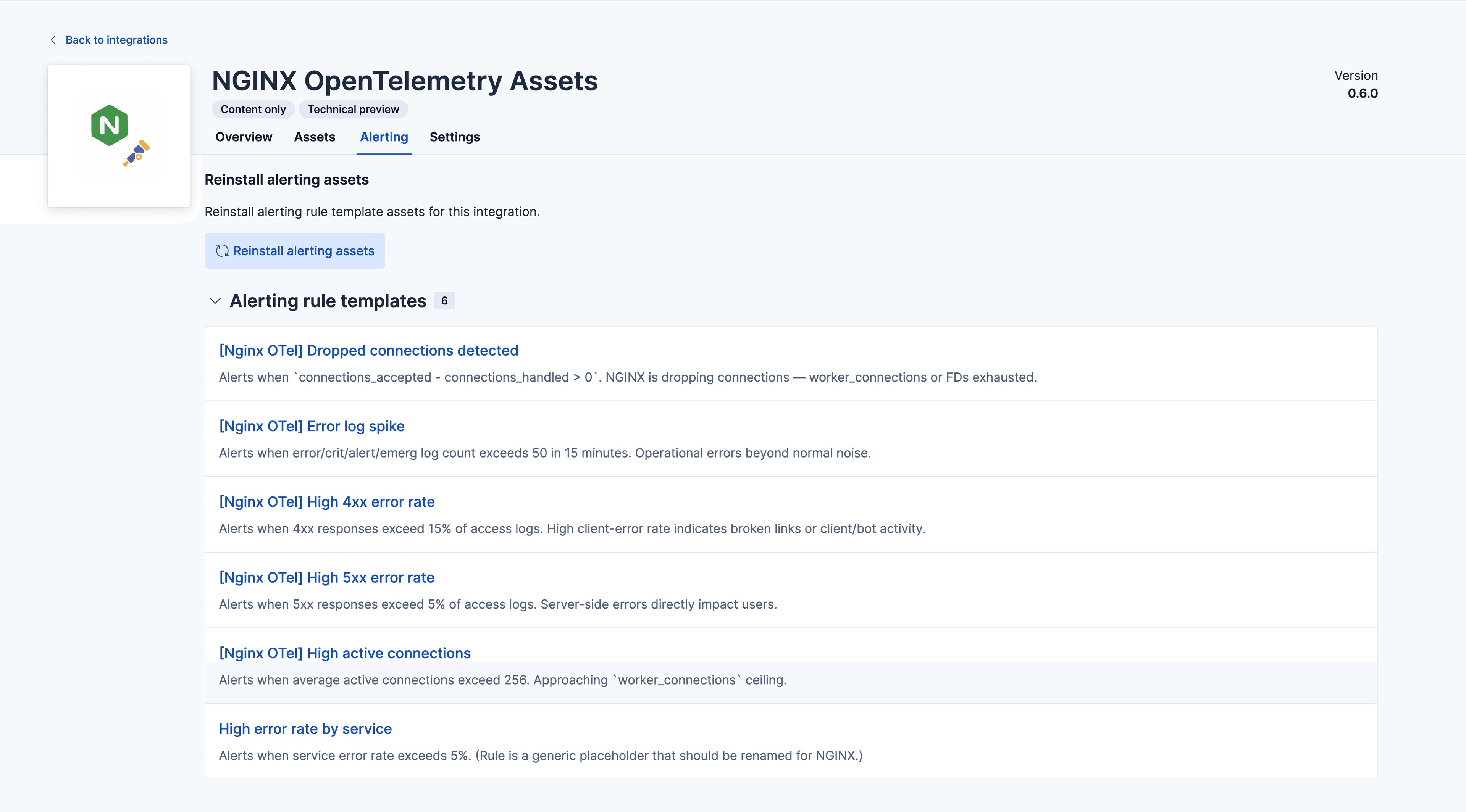

Open the integration and select the Alerting tab.
This package ships six templates: high 4xx and 5xx error rates, high active connections, an error log spike, dropped connections, and a generic High error rate by service template that points at a placeholder logs-myservicereceiver.otel-* index for you to repoint and rename. The five NGINX rules run ES|QL every minute and group results by host.name, so an alert points at the host with the problem. The generic template groups by service.name instead, since it is meant to be repointed at whichever service you choose.

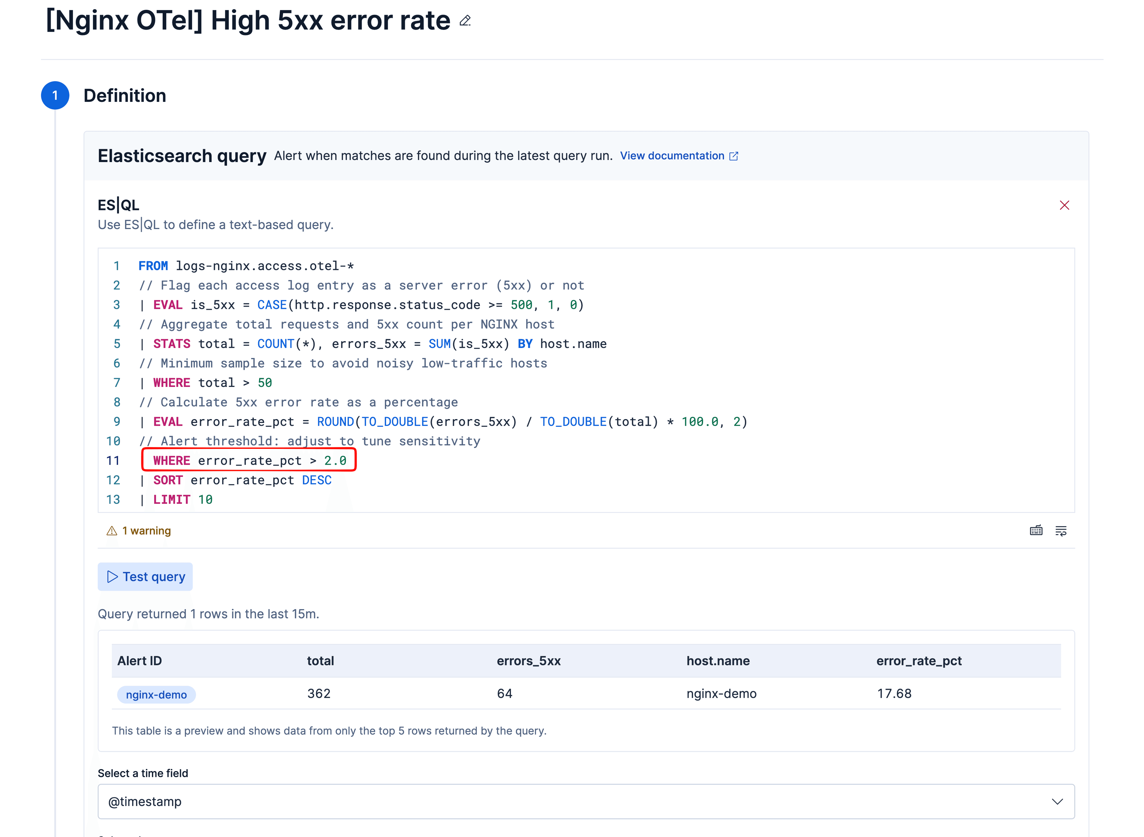

Select a template, for example [Nginx OTel] High 5xx error rate. Kibana opens a prefilled Create rule form built on an Elasticsearch query rule. It runs the template's ES|QL on a schedule and alerts when the query returns rows.
The query looks like this:
FROM logs-nginx.access.otel-*
// Flag each access log entry as a server error (5xx) or not
| EVAL is_5xx = CASE(http.response.status_code >= 500, 1, 0)
// Aggregate total requests and 5xx count per NGINX host
| STATS total = COUNT(*), errors_5xx = SUM(is_5xx) BY host.name
// Minimum sample size to avoid noisy low-traffic hosts
| WHERE total > 50
// Calculate 5xx error rate as a percentage
| EVAL error_rate_pct = ROUND(TO_DOUBLE(errors_5xx) / TO_DOUBLE(total) * 100.0, 2)
// Alert threshold: adjust to tune sensitivity
| WHERE error_rate_pct > 5.0
| SORT error_rate_pct DESC
| LIMIT 10
It counts requests and 5xx responses per host, keeps hosts with enough traffic to matter, and returns those above five percent.

Step 4: Tune alerting rule template thresholds in ES|QL
The thresholds are starting points, so confirm them against your own traffic. The threshold lives in the ES|QL WHERE clause.
To make the rule stricter, change error_rate_pct > 5.0 to error_rate_pct > 2.0. To require more traffic before it fires, raise total > 50. Use Test query in the rule form to confirm the edited query parses and returns rows before you save.
