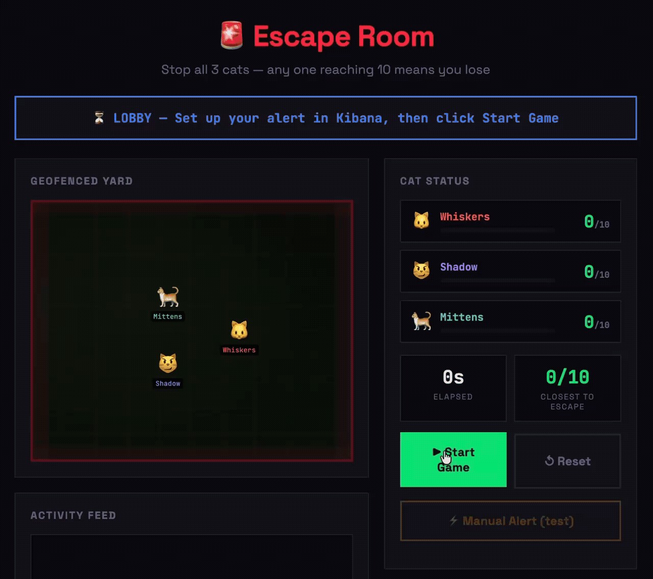

How The Great Cat Escape game works
In this detective game, the rules that you eventually create in your Elastic cluster govern whether you win or lose against these cats. Each cat creeps toward the fence at its own accelerating pace. If any cat hits 10 escape attempts, that cat is free and you lose your detective license. Your job, gumshoe, should you choose to accept it, is to configure an Elastic Observability alert that fires before any cat hits 10. The earlier it fires, the higher your score.

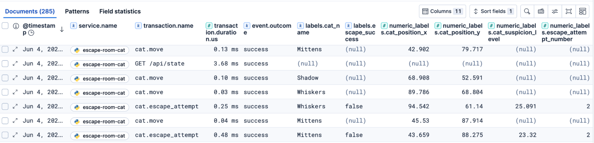

When you view the traces data in Kibana, the trace and its span attributes appear as follows:
The fields translated from our game are prepended with “numeric_labels” or “labels.” This is the result of our data being translated from OTel into the Elastic Common Schema (ECS). However, you can rename these in Kibana, if you choose, to shorten the name or make searching easier for you.

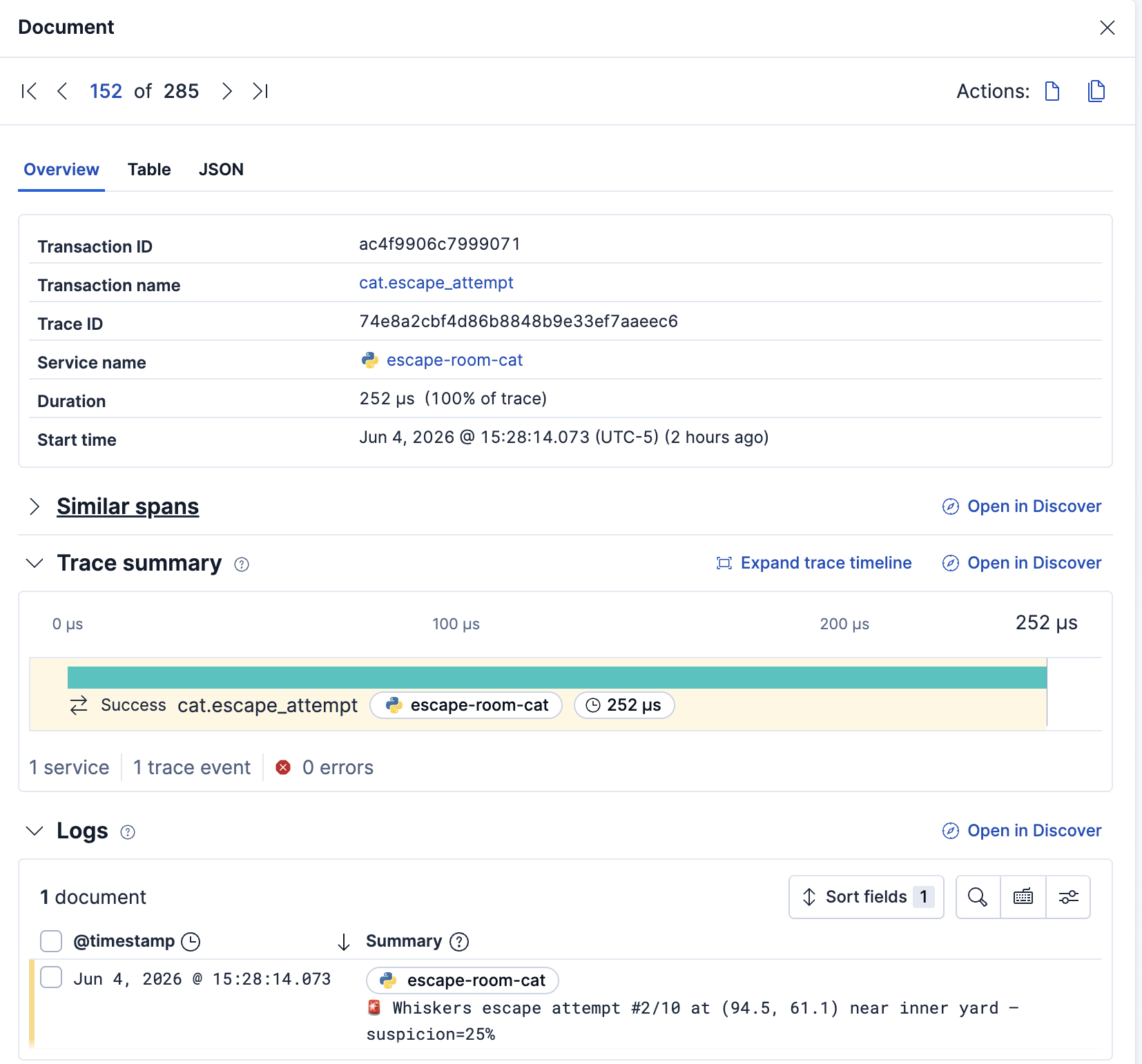

Emitting structured logs with the Python logging module
Logs are the most human-readable of the three signals, and this game emits them through semi-structured logging:

The game sends out several logs and communicates them via multiple methods. When it comes to logging, it’s generally good practice to keep your logs clear and concise so that they’re easily recognizable by anyone debugging, especially for errors. In this Flask application, we used the logging module by Python. The logs sent to Kibana are “logger.info”, “logger.warning”, and “logger.error”, and they indicate the log severity level. logger.info is used for generic information from your application, and logger.warning indicates unexpected events that the system has recovered from. logger.error notes a failure or critical error. In The Great Cat Escape, the only error is when you lose the game. These logs are emitted through the standard Python logger and exported via the OTLP log exporter, so they show structured severity_text and resource attributes, along with trace correlation in Kibana:
🚨 Mittens escape attempt #2/10 at (42.2, 62.1) near inner yard — suspicion=24%

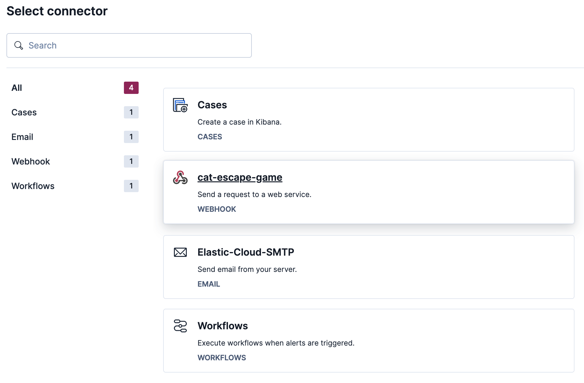

Wiring a webhook connector for your alert
To send out a webhook alert, you use ngrok or a similar tunnel to expose your port to Kibana, enabling it to POST to that port over the internet. You front your own port with a tunnel, and that public URL is the <your-tunnel> you point Kibana at. Add a connection of type “Webhook” in Kibana with these settings:
Method: POST
URL: http://<your-ip>:5003/api/alert_fired
Headers: Content-Type: application/json
# You configure this with your rule under "Actions" later

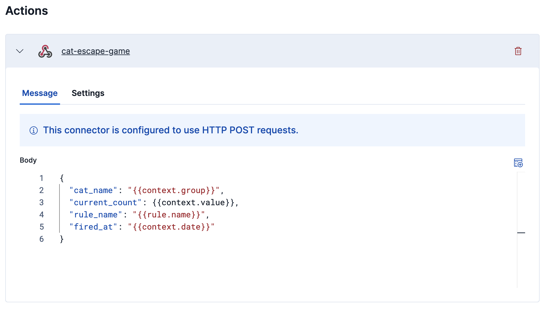

Body:
  "cat_name": "{{context.group}}",
  "current_count": {{context.value}},
  "rule_name": "{{rule.name}}",
  "fired_at": "{{context.date}}"
In Kibana 9.4, the connector lives under Stack Management → Connectors. Save it once, and you can reuse it across all of your rules.
The {{context.group}} field shows which cat triggered the rule, and the fired_at {{context date}} field tells you when the alert happened. These are purely informational parameters, but the winning endpoint, /api/alert_fired takes more precaution with “current_count” and “rule_name.” The game's /api/alert_fired endpoint, shown in the following code, has several checkpoints based on the parameters above that help with specificity in this game. These checkpoints are also important to real alerting in systems to ensure that the correct source, system, or alert was sent via your alerting webhook.

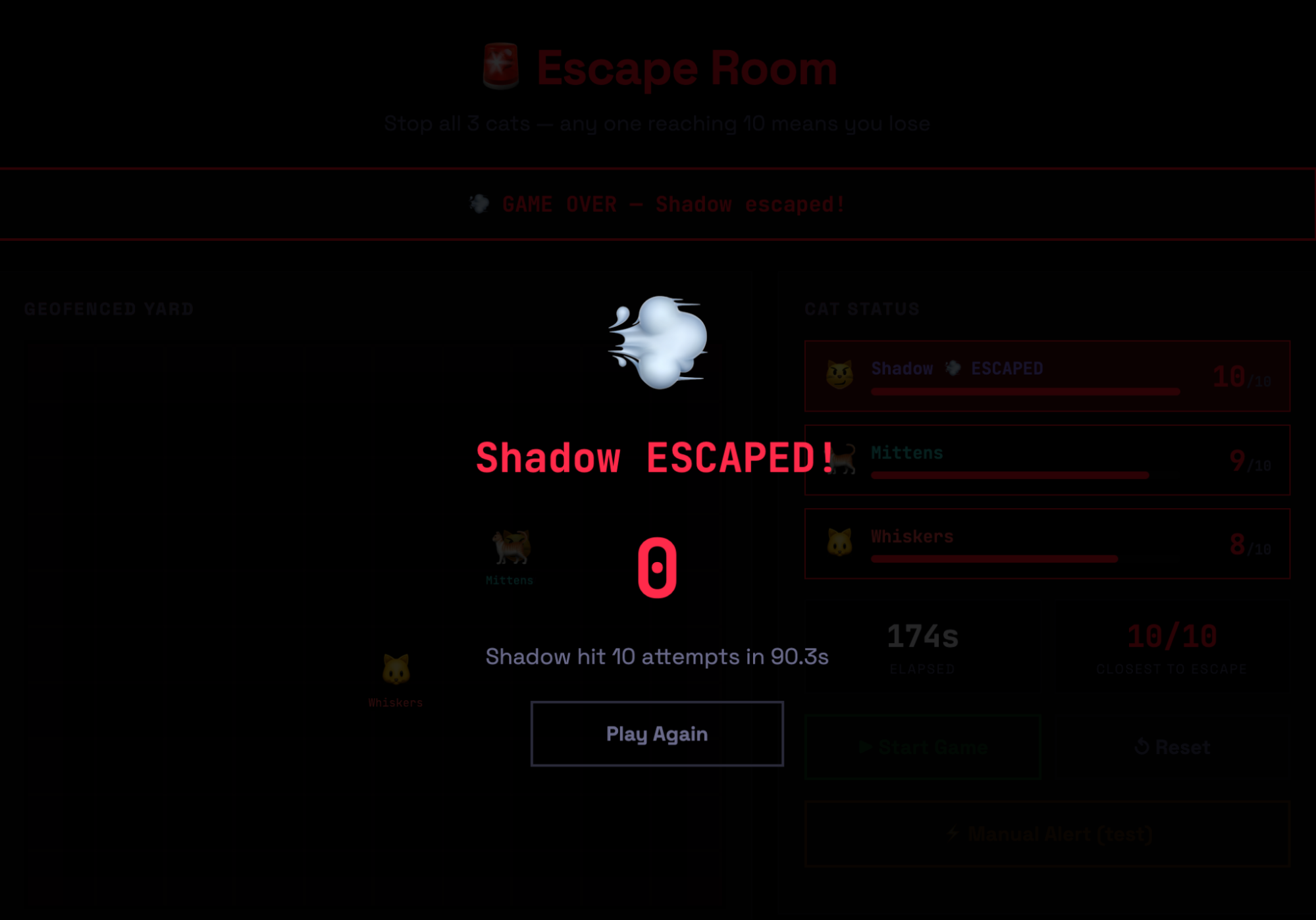

This game ends one of two ways. You win if your created rule alerts properly; and you lose if any cat reaches 10 escape attempts.
To create your rule and play the game, follow these instructions. Lettered subsections give you a full breakdown of how to create a winning rule.

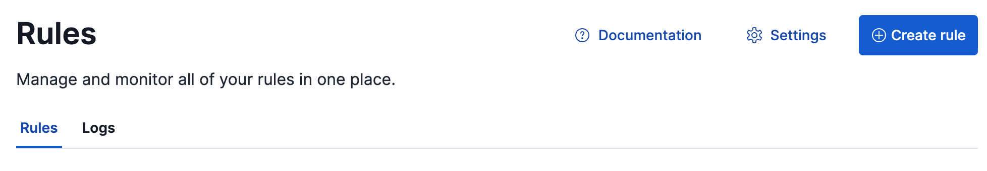

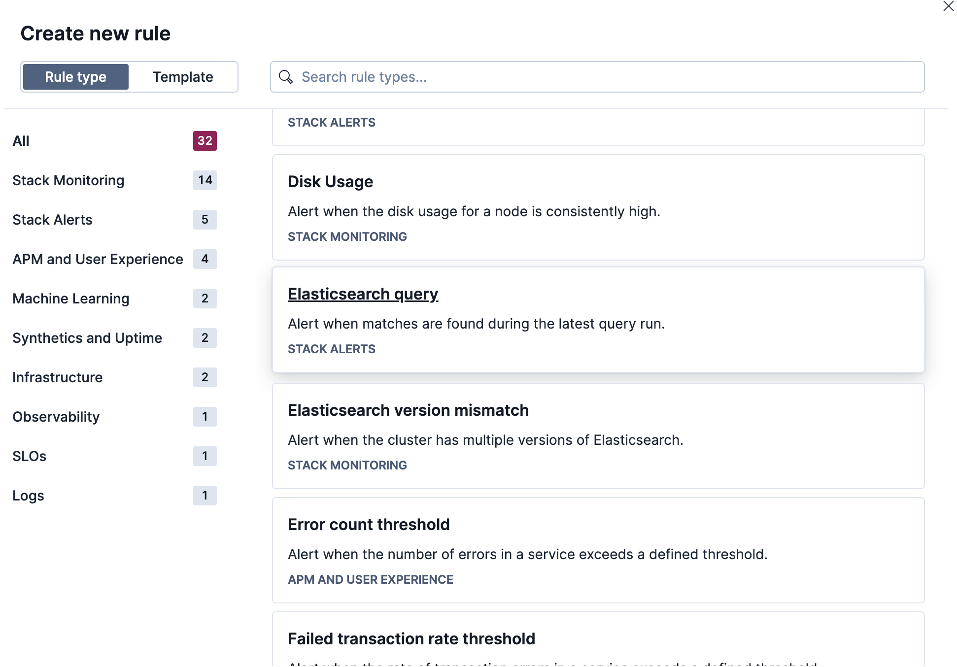

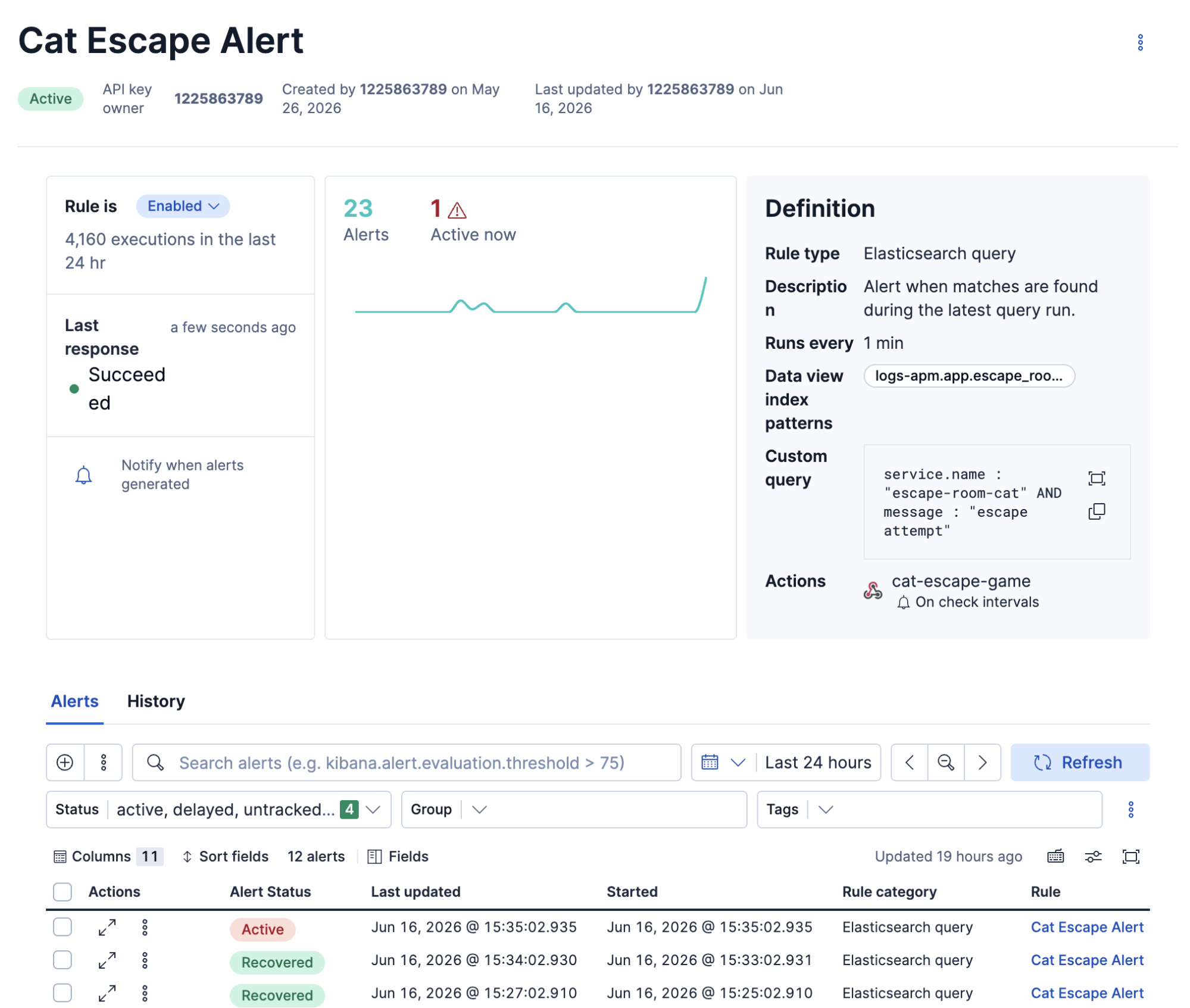

1. Go to Kibana → Stack Management → Rules.
2. Create new rule → Elasticsearch query.

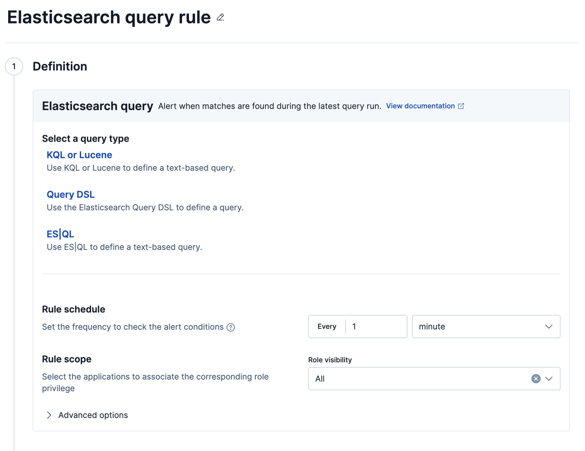

3. Create a rule to alert on logs or metrics. You can use Kibana Query Language (KQL) or Lucene, Query DSL, or ES|QL.
  • To create a winning rule, choose ES|QL. Enter the code block below into the box for creating a query. The service for this game is “escape-room-cat,” and “cat.escape.attempts” IS NOT NULL discards every row that isn’t an escape.attempts measurement. Since the cat.escape.attempts is an OTel counter, it only climbs and doesn’t reset when you restart your game. To circumvent this counter, we take the change in the counter over the window (EVAL attempts = hi - lo) instead of its absolute cumulative value.
  • ES|QL query:
FROM metrics-apm*
| WHERE service.name == "escape-room-cat" AND cat.escape.attempts IS NOT NULL
| STATS hi = MAX(cat.escape.attempts), lo = MIN(cat.escape.attempts) BY cat = labels.cat_name
| WHERE attempts >= 1
| SORT attempts DESC
| KEEP cat, attempts
  • Change the rule schedule for every 30–45 seconds.

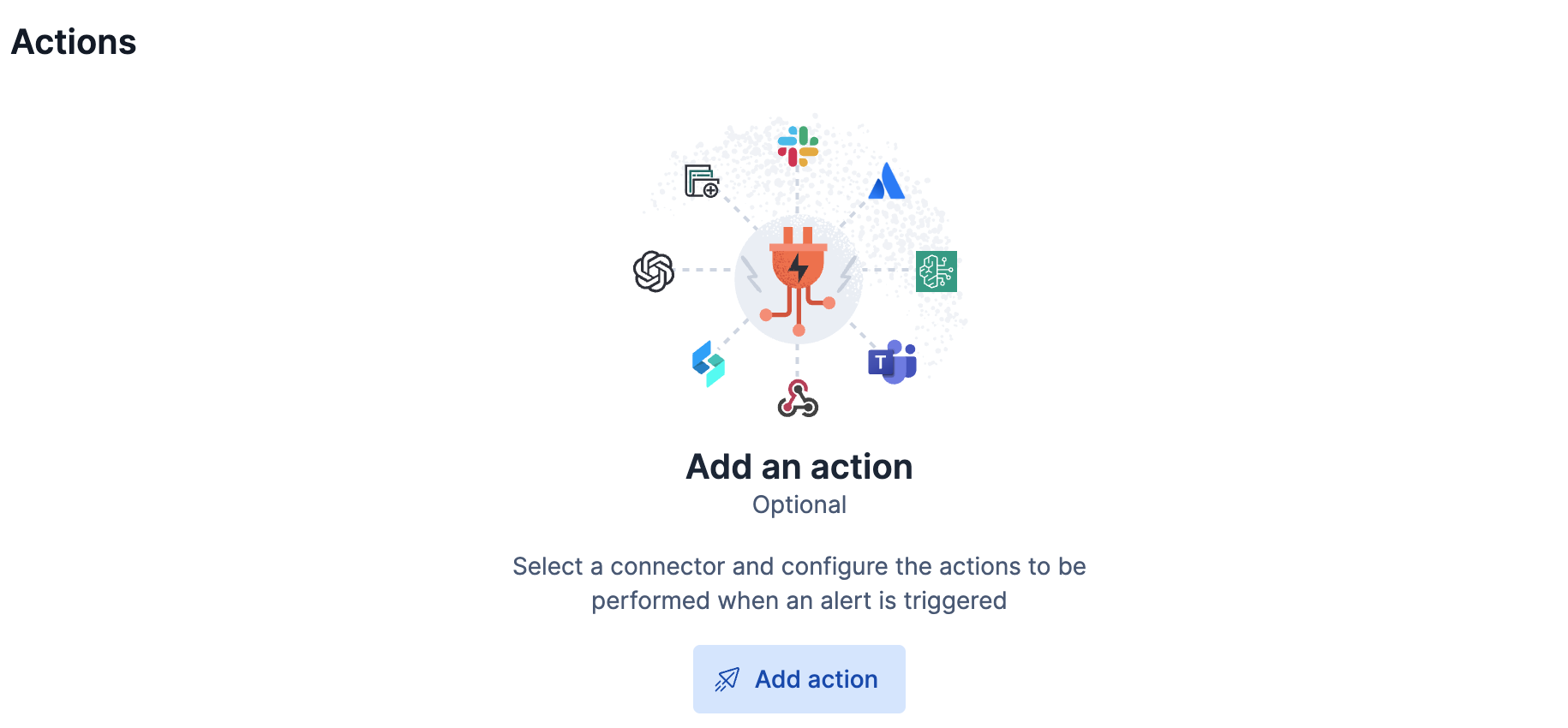

4. Add an action with your configured webhook, and use the configuration from the ″A webhook connector for your alert″” section of this post.

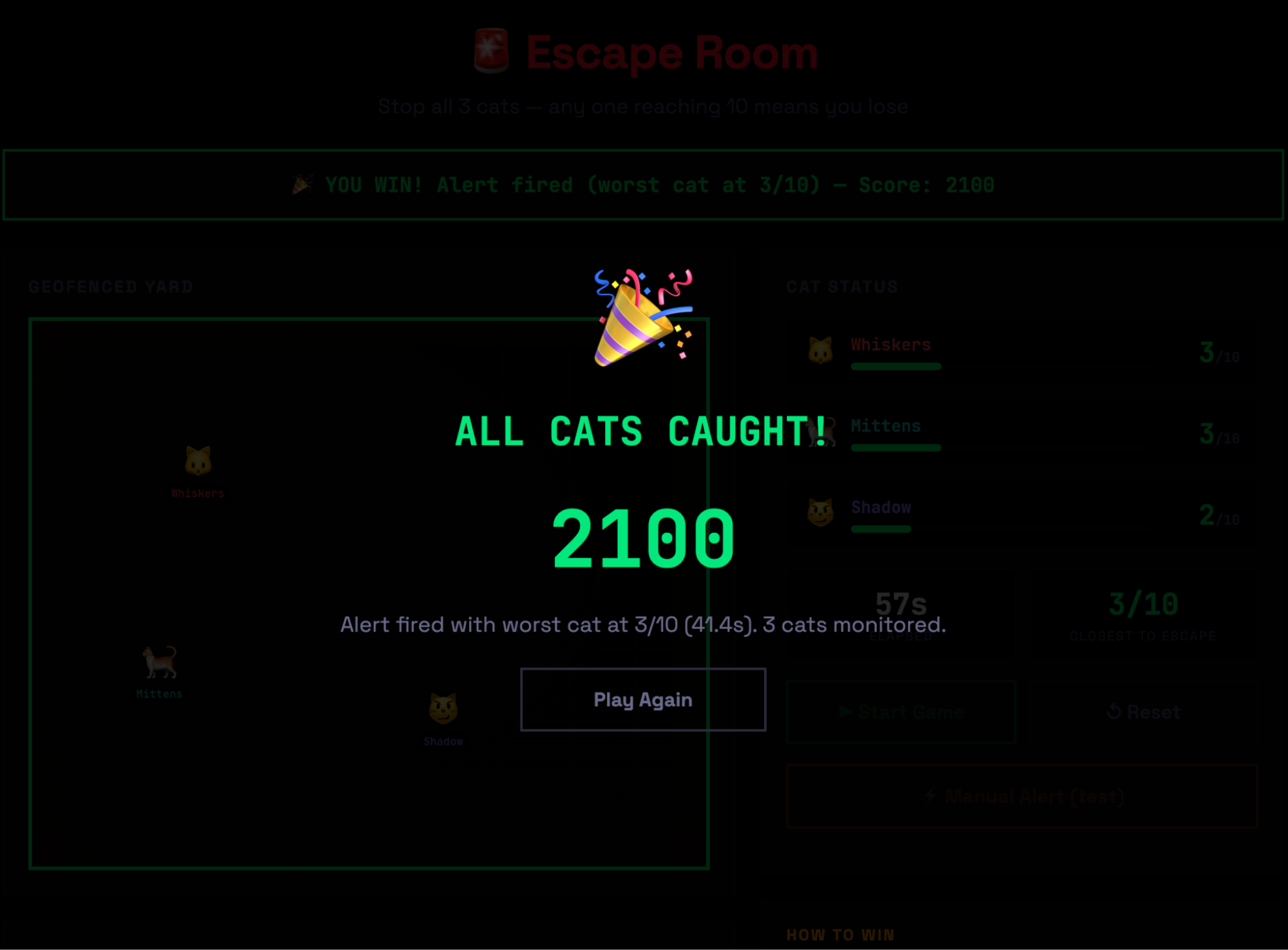

5. Click Start Game, and wait.
6. If your alert signals in time, you’ve won, detective. You sleuthed out the right cat and caught it in time. If your rule doesn’t alert by the tenth escape attempt, you lose. Try configuring a new rule and checking that it matches the correct rule_name for the checkpoint (including whitespace and casing) or changing your rule’s threshold or timing.
