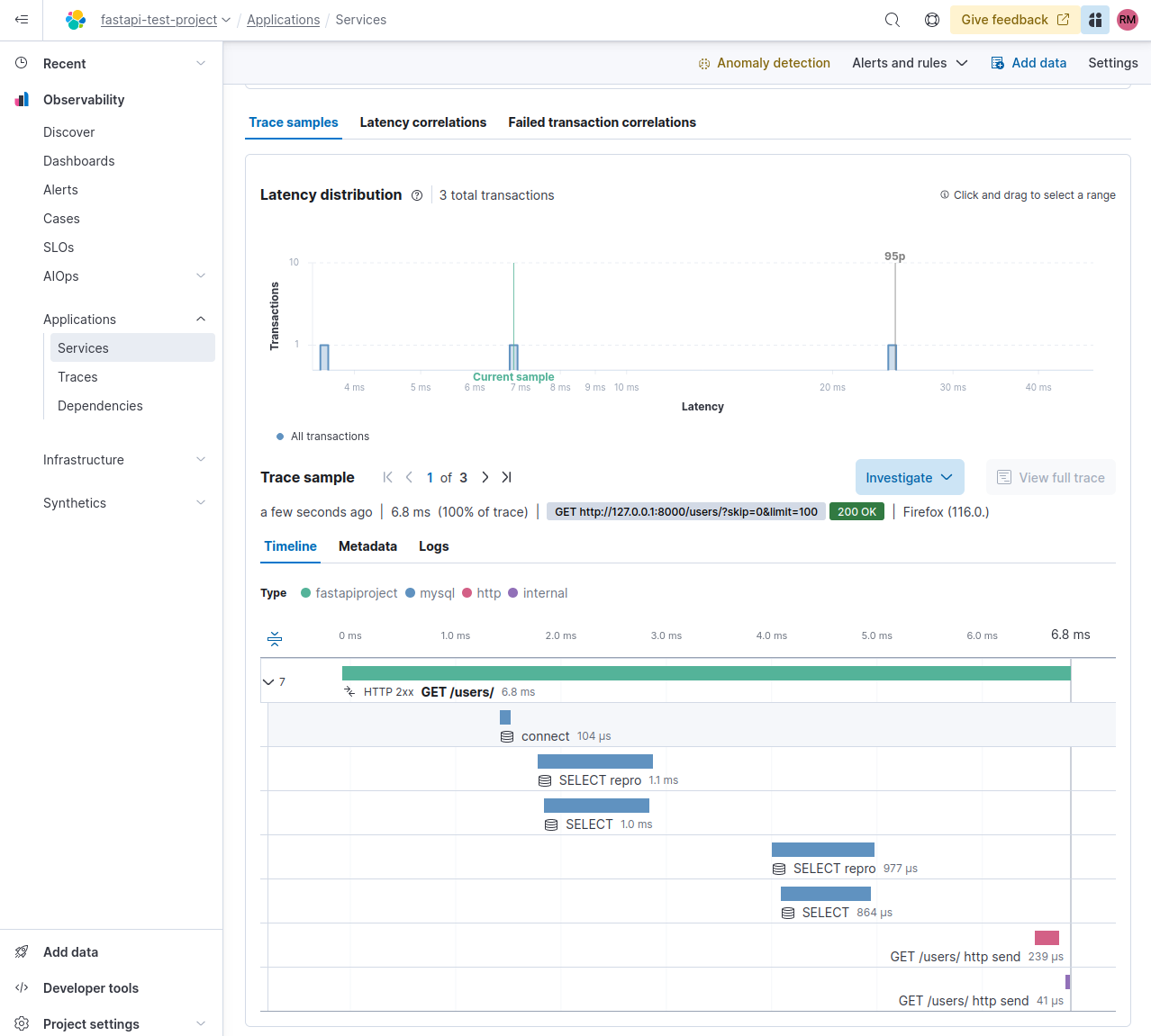

We are done with the configuration and the last piece of the puzzle is wrapping your service invocation with opentelemetry-instrument, the wrapper that provides zero-code instrumentation. Zero-code (or Automatic) instrumentation means that the distribution will set up the OpenTelemetry SDK and enable all the previously installed instrumentations for you. Unfortunately Zero-code instrumentation does not cover all libraries and some — web frameworks in particular — will require minimal manual configuration.
For a web service running with gunicorn it may look like:
opentelemetry-instrument gunicorn main:app
The result is an observable application using the industry-standard OpenTelemetry — offering high-quality instrumentation of many popular Python libraries, a portable API to avoid vendor lock-in and an active community.
Using Elastic Observability, some out-of-the-box benefits you can expect are: rich trace viewing, Service maps, integrated metrics and log analysis, and more.
