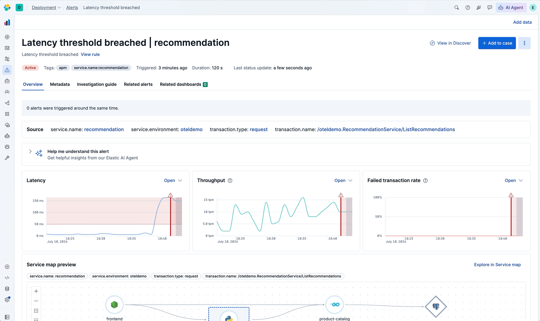

Step 1: Confirm the service degradation on the APM alert detail page
The redesigned alert detail page in Elastic Observability shows the impacted service, environment, endpoint and RED metrics in one view. Open it from the alert notification.
You can clearly see which service is impacted, which environment it runs in, what endpoint is being affected and easily look for correlations in their RED metrics. In this case, we can immediately rule out a spike in traffic as the throughput is clearly stable.

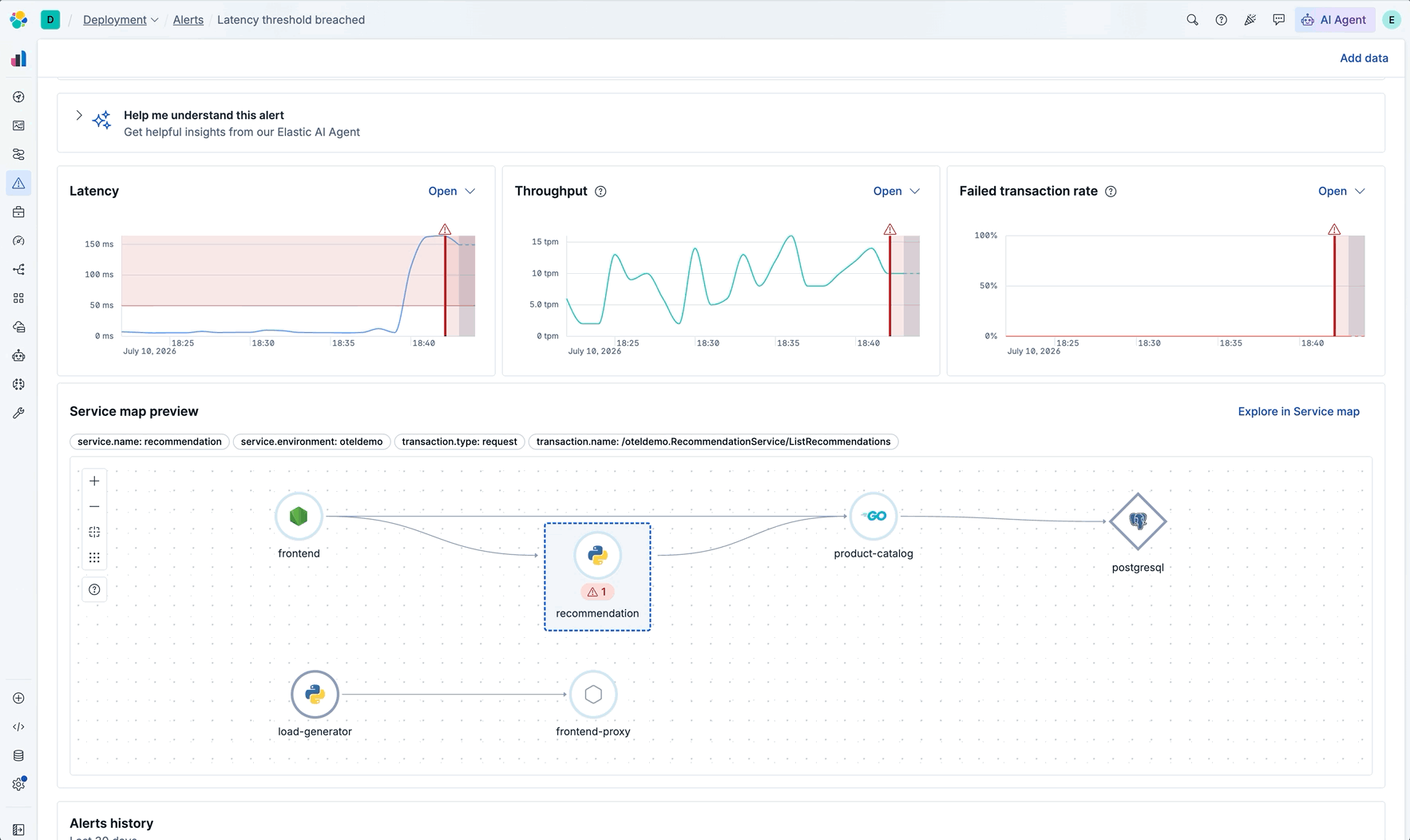

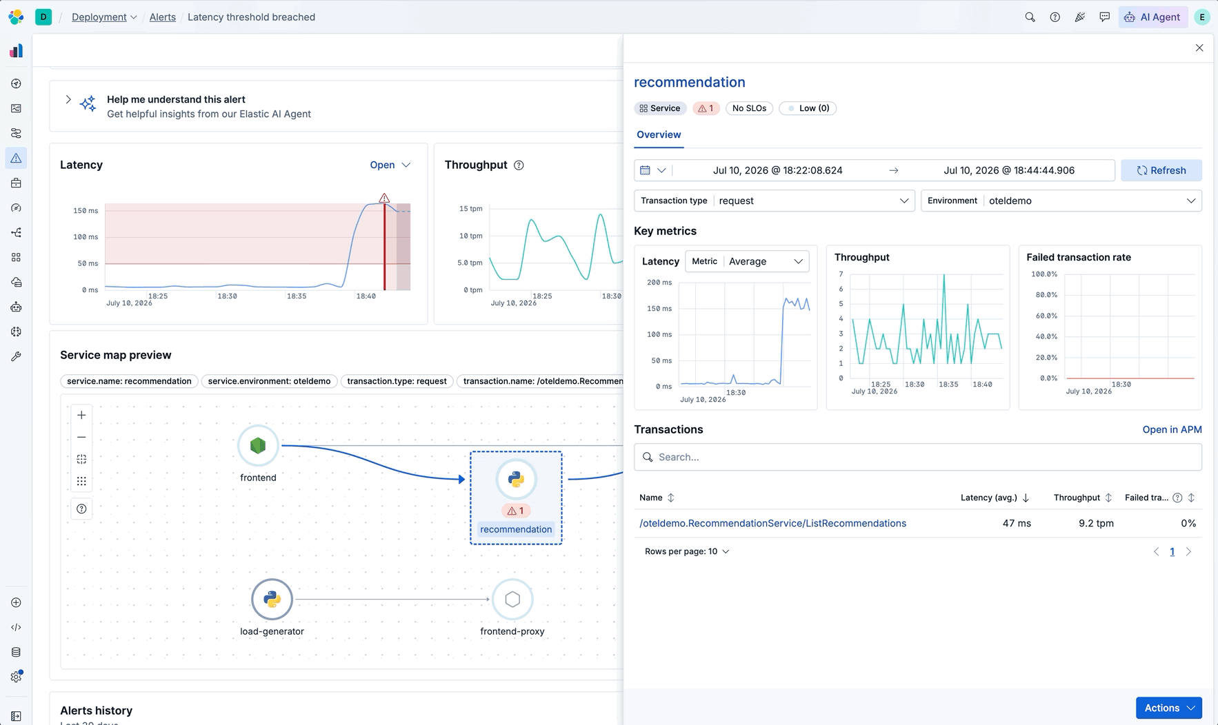

Step 2: Rule out service dependencies with the embedded service map
The newly embedded service map preview on the alert detail page shows the health and RED metrics of every dependent service, so you can rule out upstream causes without navigating away. In this case, we have been able to quickly rule out problems with other services causing the symptom with the symptomatic service:

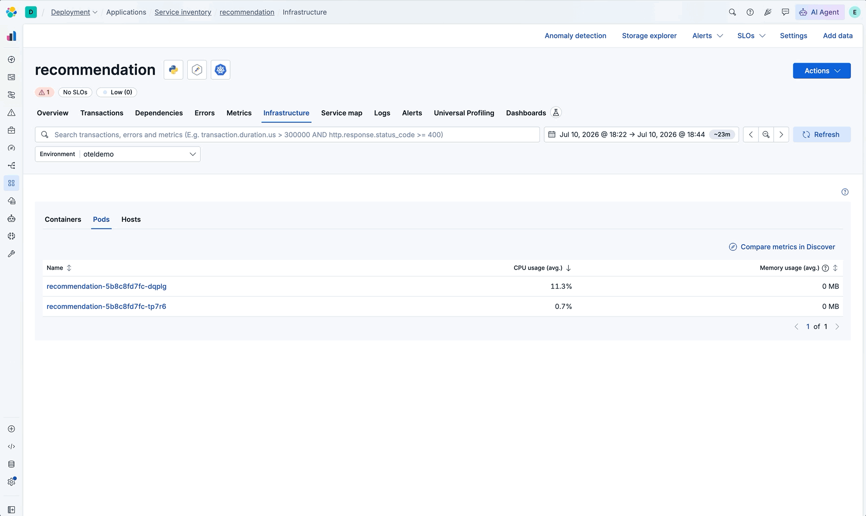

Step 3: Review Kubernetes infrastructure metrics per pod, container and host
After ruling out service dependencies, open the service's updated Infrastructure tab in Elastic Observability to check for infrastructure-level patterns.
The Infrastructure tab shows the average metric values over the specified time period. To really understand whether there is a problem with the infrastructure, we need to compare the pod, container and host metrics over time. This allows us to easily spot differences between different entities that may correlate with when the service started showing symptoms. In our example, we can clearly see a difference between some of the metrics between the pods that correlates with when the service symptoms began. So we know there is something going on with the infrastructure that needs investigating:
