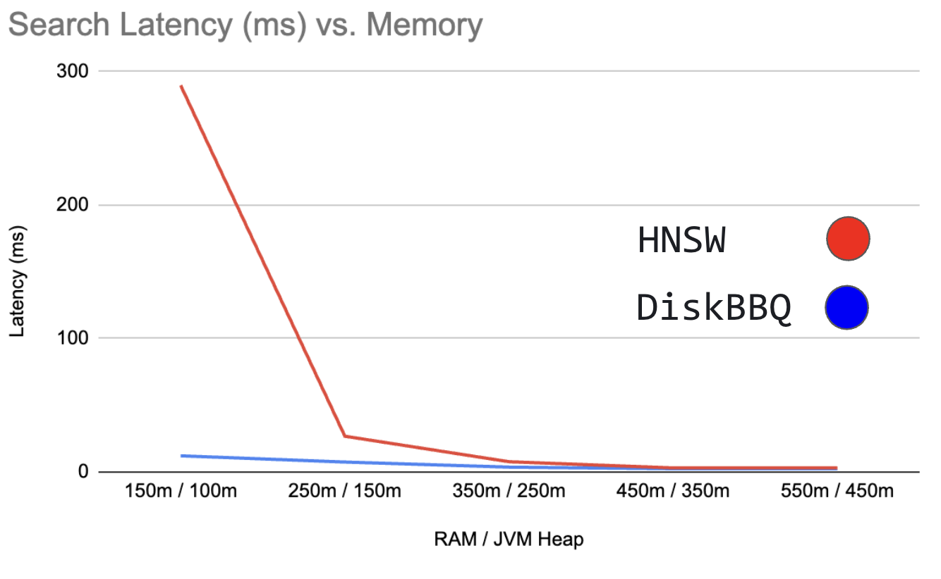

In our introductory blog, we talked about some high-level numbers. Let’s look back at the high-level query timings graph and dig a little deeper:
Figure 0: Shows search latency in milliseconds vs RAM / JVM Heap
DiskBBQ degrades in search latency, but is much more well-behaved than HNSW BBQ, which behaves exponentially as memory becomes increasingly restricted. But what does DiskBBQ look at in comparison as we add more memory?
Here’s those actual numbers laid out. And you can better see how DiskBBQ behaves in lower memory states. It definitely benefits from more RAM to better cache more clusters of vectors. Particularly, we rely heavily on off-heap cache, and as that increases, we see better performance until the whole of the quantized vectors are resident.

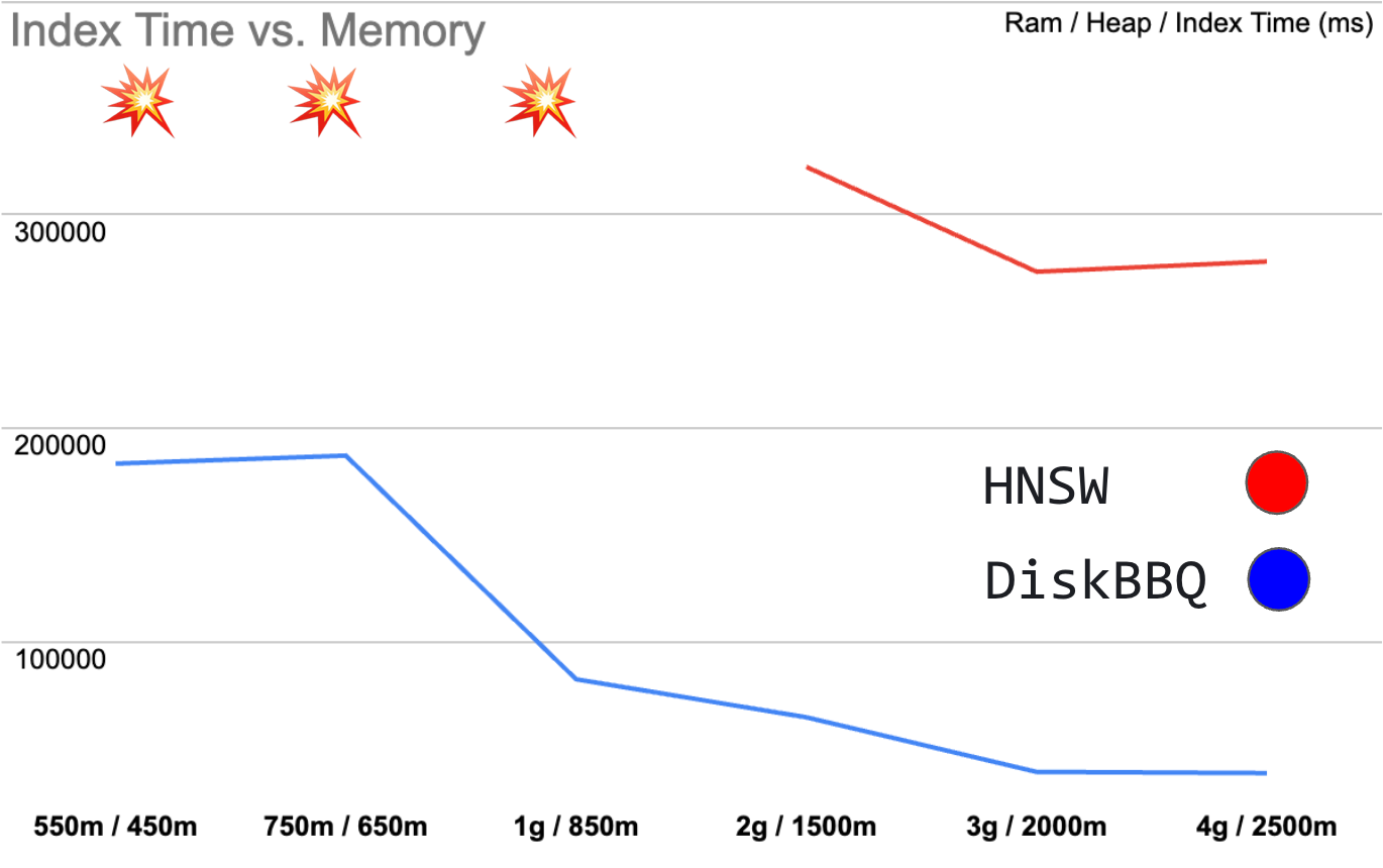

Indexing
Let’s also take a look at the indexing performance.
Figure 1: Shows index time in milliseconds vs RAM / JVM Heap
As overall memory reduces, DiskBBQ indexing degrades gracefully. HNSW BBQ, however, simply falls apart once memory gets very restricted. And downright fails in scenarios where DiskBBQ continues to operate. Again, let’s look at the numbers to get a better understanding of what’s happening.

As DiskBBQ can utilize more off heap cache space, larger chunks of particularly the raw vectors stay resident, which is especially useful as we partition the space with hierarchical k-means.
