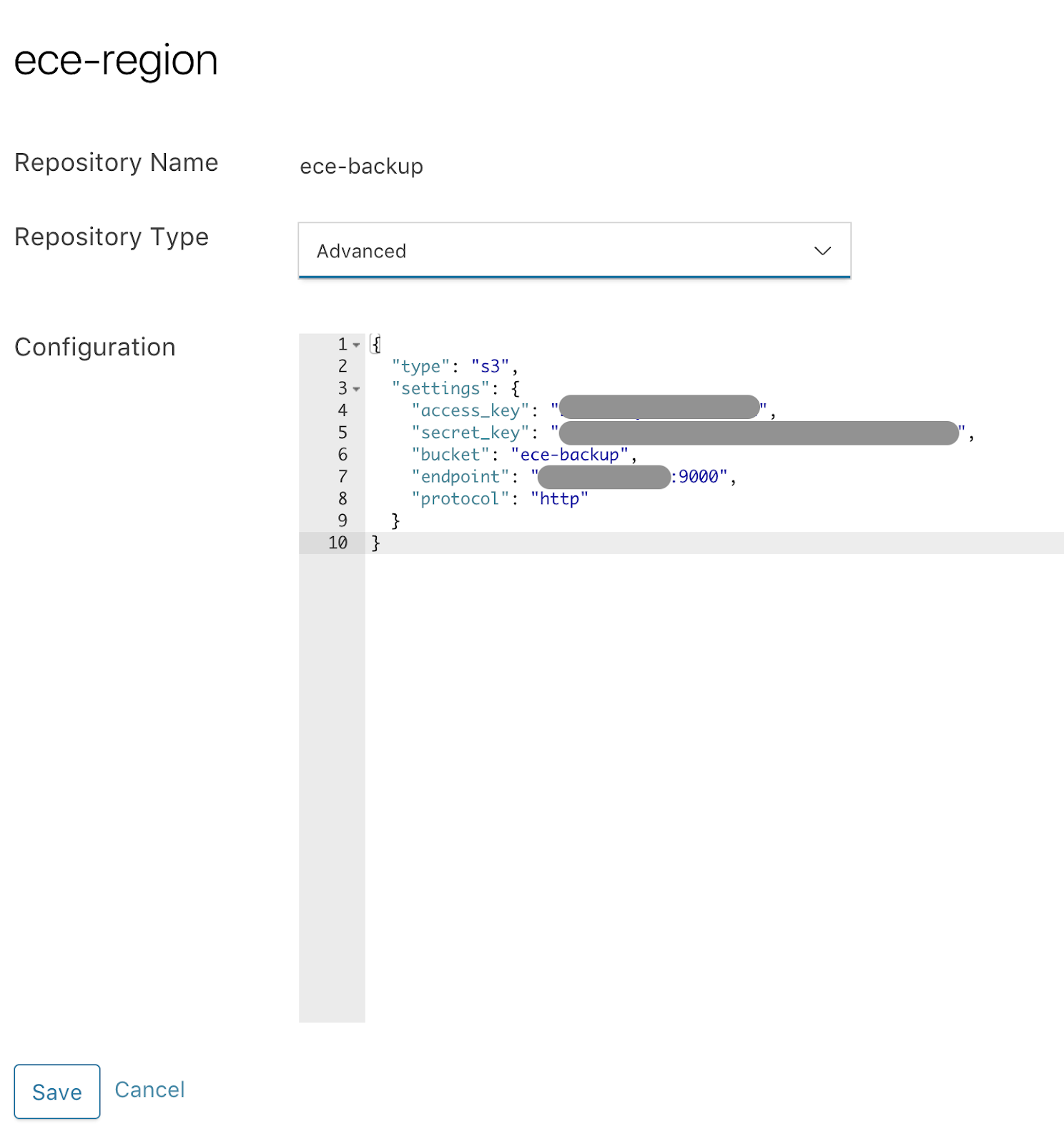

Add the repository to Elastic Cloud Enterpriseedit
You must add the new repository to Elastic Cloud Enterprise before it can be used with your Elasticsearch clusters.
- Log into the Cloud UI.
- From the Platform menu, select Repositories.
- Select Add Repository.
- From the Repository Type drop-down list, select Advanced.
In the Configuration text area, provide the repository JSON. You must specify the bucket, access_key, secret_key, endpoint, and protocol.
{ "type": "s3", "settings": { "bucket": "ece-backup", "access_key": "<your Minio AccessKey>", "secret_key": "<your Minio SecretKey>", "endpoint": "<your Minio endpoint URL>:9000", "path_style_access": "true", "protocol": "http" } }
- Select Save to submit your configuration.
The Minio repository is now available from the drop-down list of repositories when creating deployments.
