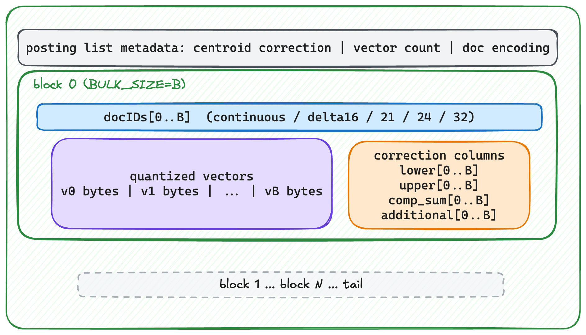

At the start of each posting list, we write a centroid score correction, the vector count, and the overall doc ID encoding method. Then we write doc IDs and vectors in subsequent blocks. The blocks and the internals are in ascending doc ID order. This respects segment doc ID order, which preserves index sort order. Filters aligned with that order are more likely to include or exclude whole blocks at a time. After the doc IDs, we store the quantized vector bytes and then all the corrections for the vectors in that block.
The layout of a posting list. Starting with a metadata header and then each block. The blocks have bulk_size doc IDs, and then quantized vector bytes, followed up by the quantized correction values.

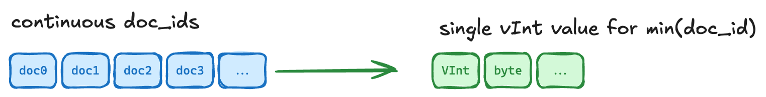

The most efficient is continuous. This is used when max(doc_block) - min(doc_block) + 1 == len(doc_block), meaning, the delta encoding only needs to worry about storing the minimum value, and the doc IDs can be reconstituted by adding one to each subsequent value. An example would be the IDs [4858192, 4858193, 4858194, 4858195]. Instead of writing four individual int values, which is 16 bytes, we only need to write a single value: 4858192.
Continuous encoding; only needs to write a single integer.

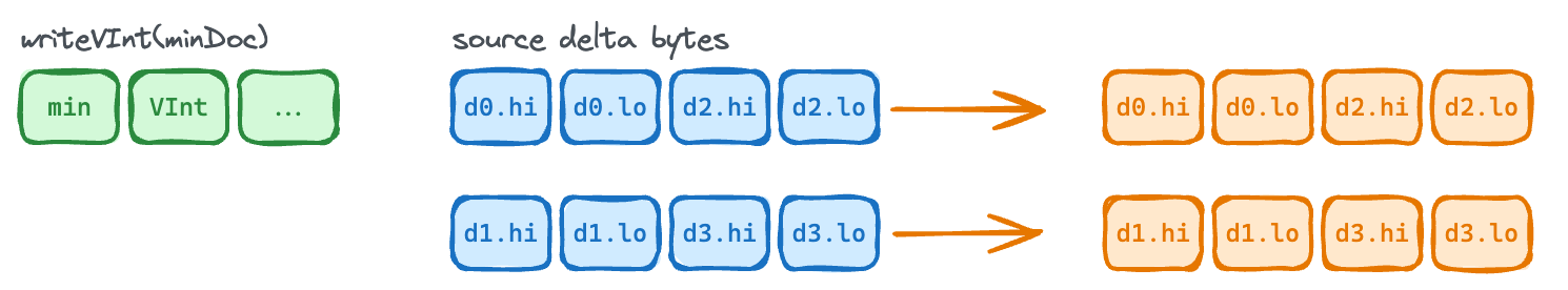

Next is delta 16. It applies when every delta fits in 16 bits, which can be stored in two bytes. Assume we have doc_ids = [1000, 1003, 1010, 1020, 1041, 1055, 1070, 1090, 1100, 1125, 1200, 1300, 2000, 4000, 16000, 66000]. This then means our min = 1000 and results in deltas = [0, 3, 10, 20, 41, 55, 70, 90, 100, 125, 200, 300, 1000, 3000, 15000, 65000]. These 16 deltas can be packed into eight int32 values (32 bytes), plus the min value, cutting the byte usage by almost 2x.
Delta 16; writes the minimum value and then packs two 16-bit deltas into each 32-bit integer.

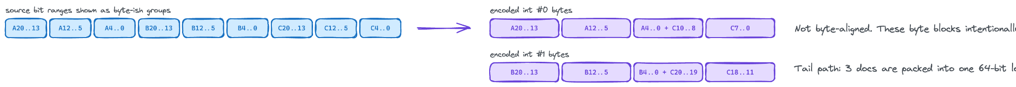

The next step up is 21 bits per value. This results in a fairly complex scheme where each triplet set of values is compressed into 64 bit values and a tail of 3 bytes for any remaining values. A concrete example would be doc_ids=[1000, 70000, 140000], which get compressed into a single 64 bit value doc0 | (doc1 << 21) | (doc2 << 42), the end result being three raw integer values, which comprise 12 bytes, get compressed into 8 bytes.
Twenty-one bits per value, a fairly complex scheme combining triplet compressed 64-bit values with a 3-byte tail.

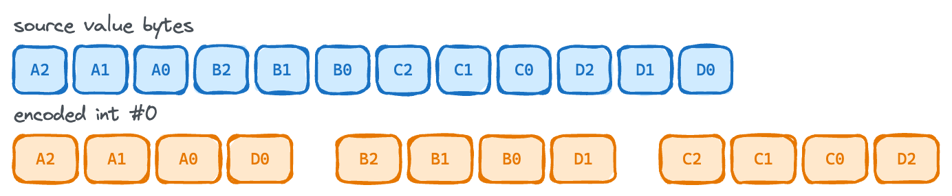

The second-to-last compression option packs integer values that require at most 24 bits. Since an int requires 32 bits of space, 24 leaves an entire byte completely unused. We cannot leave a single byte of real estate to waste. We want to fully fill as many bytes as we can, so this scheme compresses by filling in that empty byte. For example, docs_ids = [1000, 70000, 140000, 300000, 500000, 800000, 1000000, 1300000, 1600000, 1900000, 2200000, 3000000, 4000000, 8000000, 12000000, 16000000] will compress the final four integer values into the “free byte” in the prior integers, thus storing 16 integers, which usually cost 64 bytes, into 48 bytes.
This shows an example 24 bits per value where the final set of bytes is packed in the first. It’s taking advantage of that free byte of real estate.

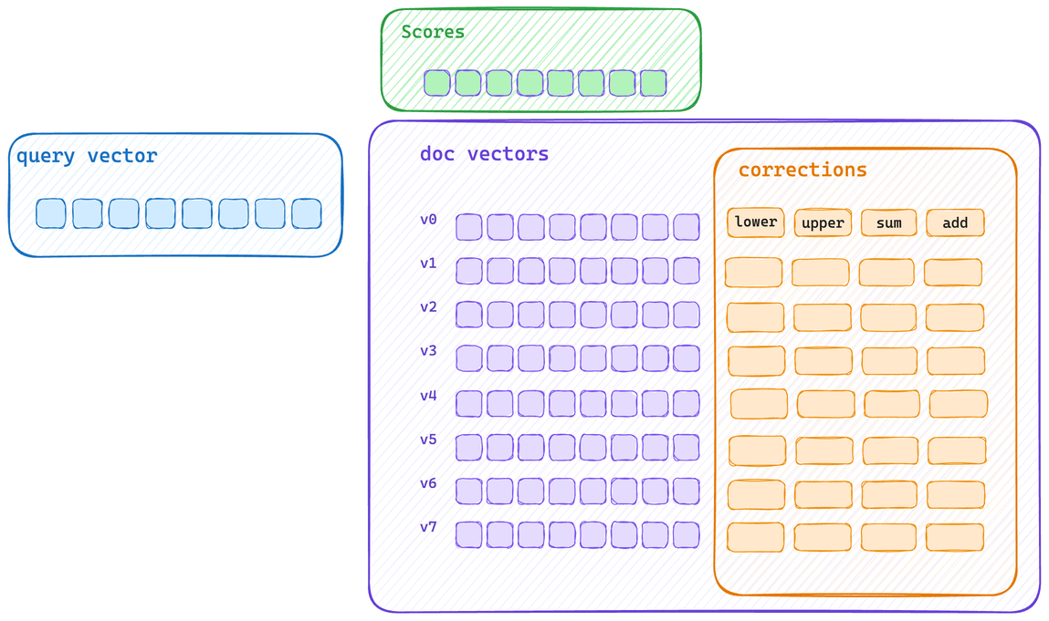

Storing the vectors in blocks allows SIMD-optimized bulk scoring. This keeps CPU cache lines saturated with vector bytes and allows quantization corrections to be applied with SIMD-optimized kernels. If vectors were stored inline with their corrections, after each vector score, the corrections would have to be applied. This loses valuable throughput and any opportunity for optimizing the correction application.

This shows the typical bulk scoring path. The query vector calculates initial score information for every vector in the block and then applies each correction with an optimized SIMD block operation.

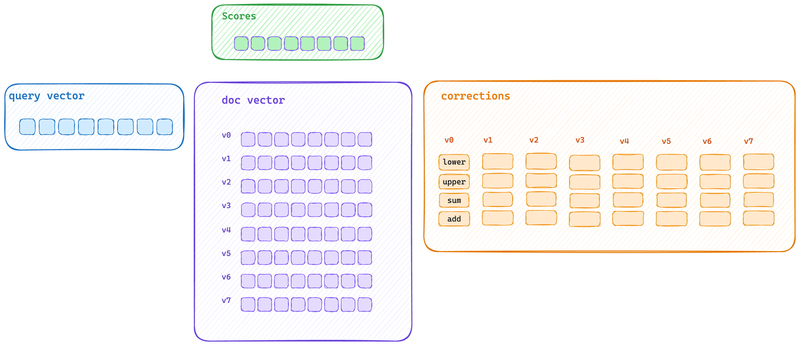

Here’s the typical single scoring path. Each vector is scored and then its corrections applied. This means that vector bytes don’t get to saturate CPU cache, and correction applications cannot be applied with the same SIMD block operation.
