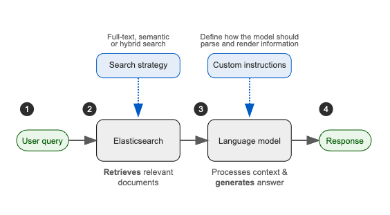

Retrieval Augmented Generation (RAG) is a grounding technique where you use search algorithms to retrieve relevant information from external sources, then you use that information as context for the LLM, and finally the model uses the augmented context together with their original training data to generate an answer.
Flow diagram of how RAG works:

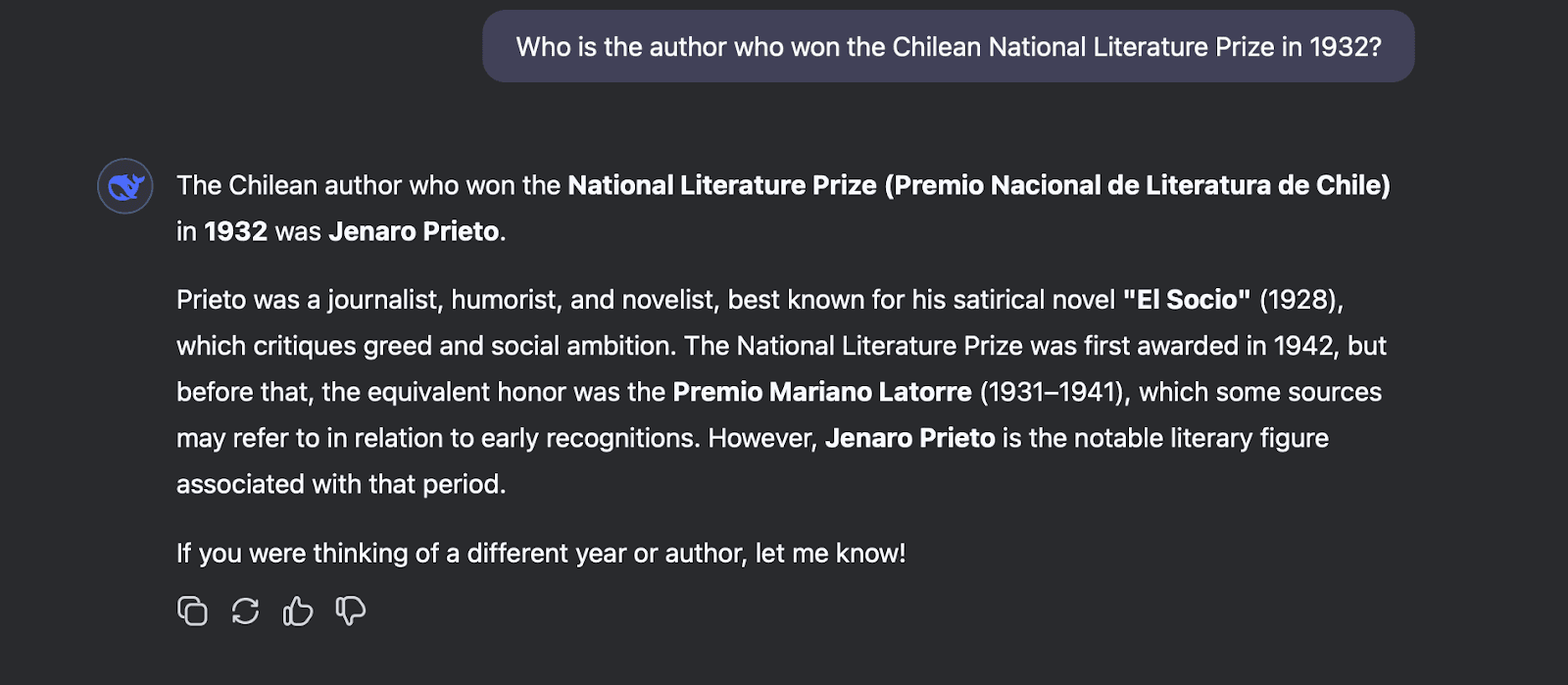

For this example, we’ll use DeepSeek and ask, “Who is the author who won the Chilean National Literature Prize in 1932?” This is a tricky question since the prize was created in 1942. Let’s see how the model answers:
As you can see, since the AI did not have all the information, it hallucinated and provided a made-up answer. Though the information is real in the sense that both the author and work exist, the other parts of the answer are wrong.

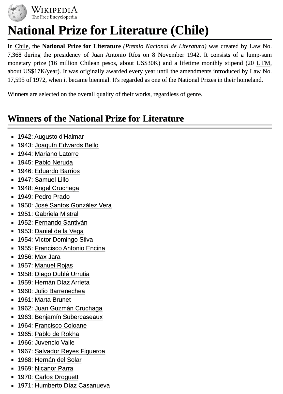

Now, let’s see how the model does when we ground it using RAG. For this, we will upload the Wikipedia page about the Chilean National Prize for Literature:

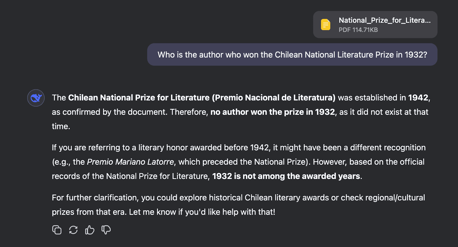

Now, let’s ask the same question and check the answer:
As you can see, with RAG we got the right answer. It says there was no prize in 1932 and asks for clarification from the user.

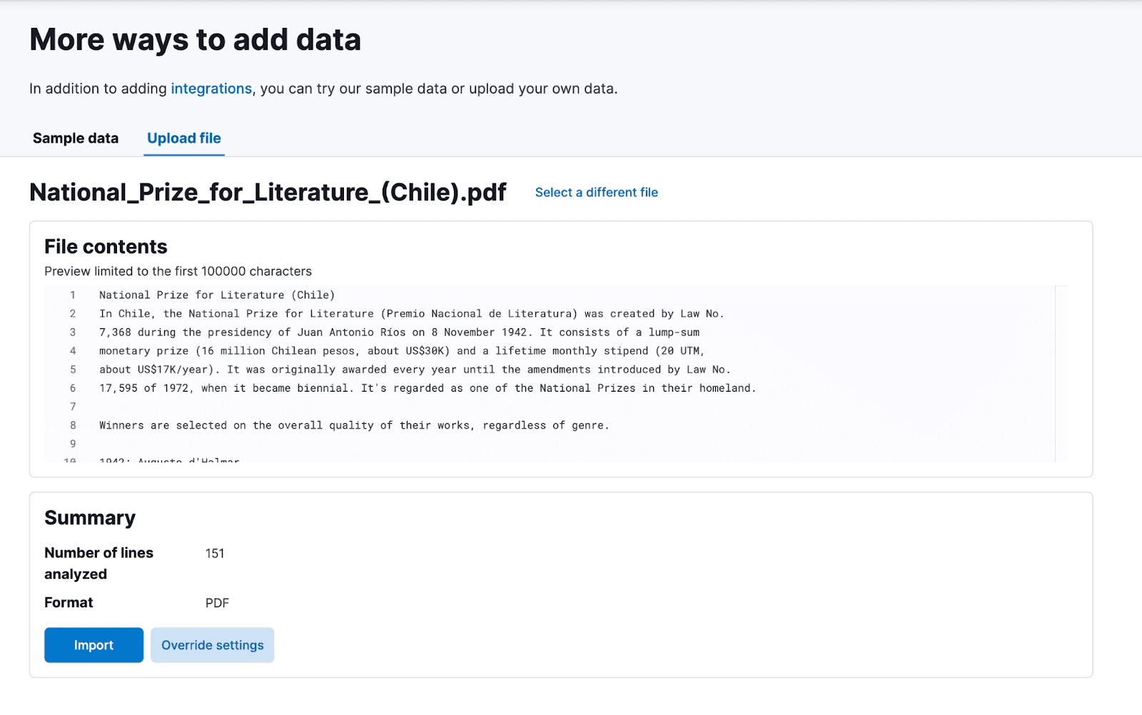

Upload the PDF
We’ll index into Kibana the same PDF file we provided to DeepSeek. If you followed the instructions in the article above and created the semantic_text field, you’ll be creating a vector database with its corresponding embeddings, ready to be used.

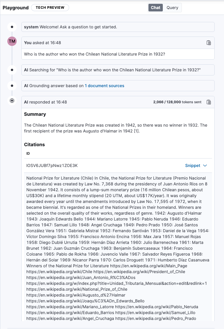

Ask the question
Ask the following question:

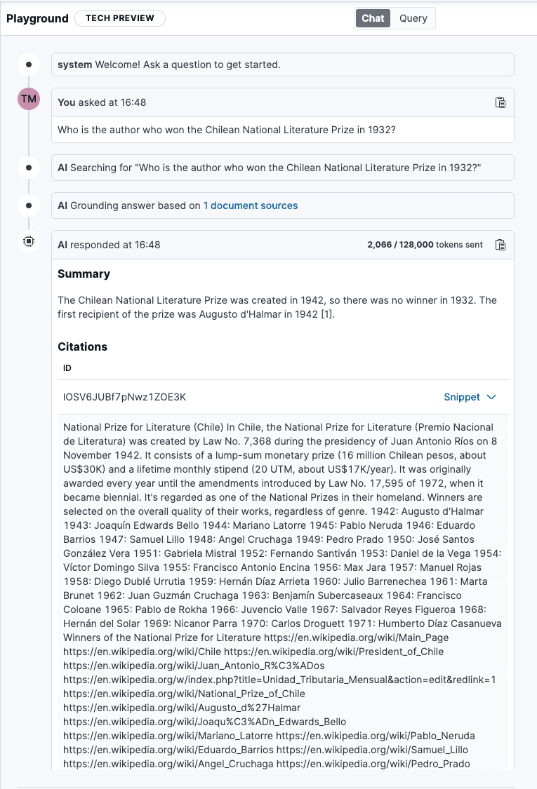

Playground sends this query to Elasticsearch, which in turn, runs a semantic search and localizes the fragments with information that is relevant to the question. Then, these fragments are included as context in the prompt sent to the LLM to ground the answer to the information source we provided.
Finally, Playground generated an answer saying that there was no prize in 1932 and provides citations for the relevant fragments as evidence.

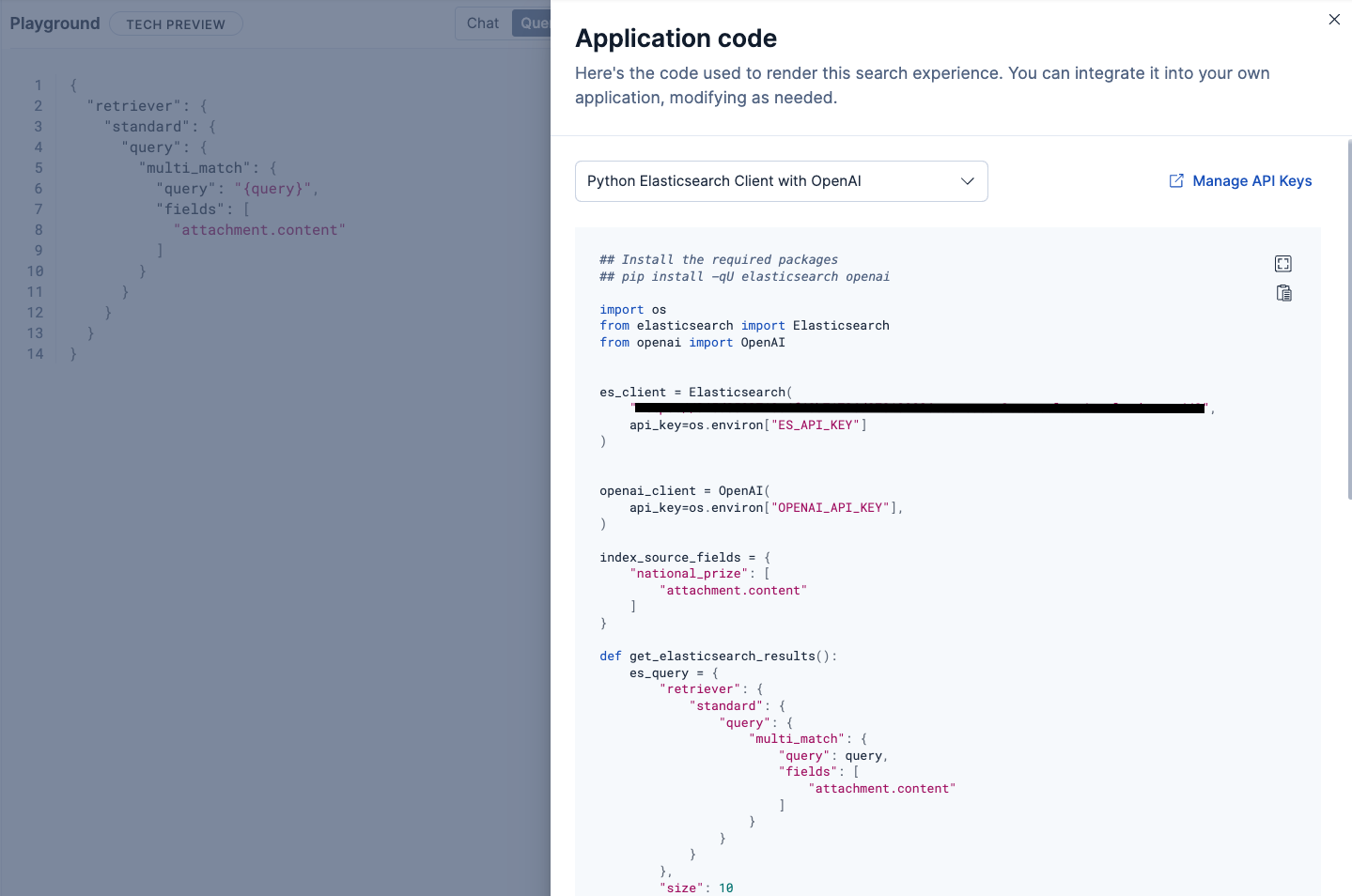

Playground also offers two very useful features to understand the RAG system underlying components:

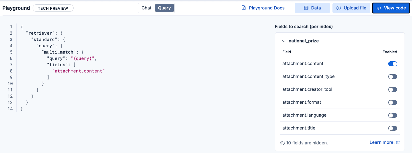

Query
You can see the query Elasticsearch is running to retrieve the relevant documents, and you can enable/disable fields based on your needs.
View code
If you can deploy your RAG application, Playground got you covered. Under the View Code tab, you can see the code used under the hood to create the entire RAG workflow. You can choose between two Python alternatives: Elasticsearch Client with OpenAI, or a Langchain based implementation.
If you want to customize the experience and deploy the code elsewhere, you can use this snippet as a starting point.
