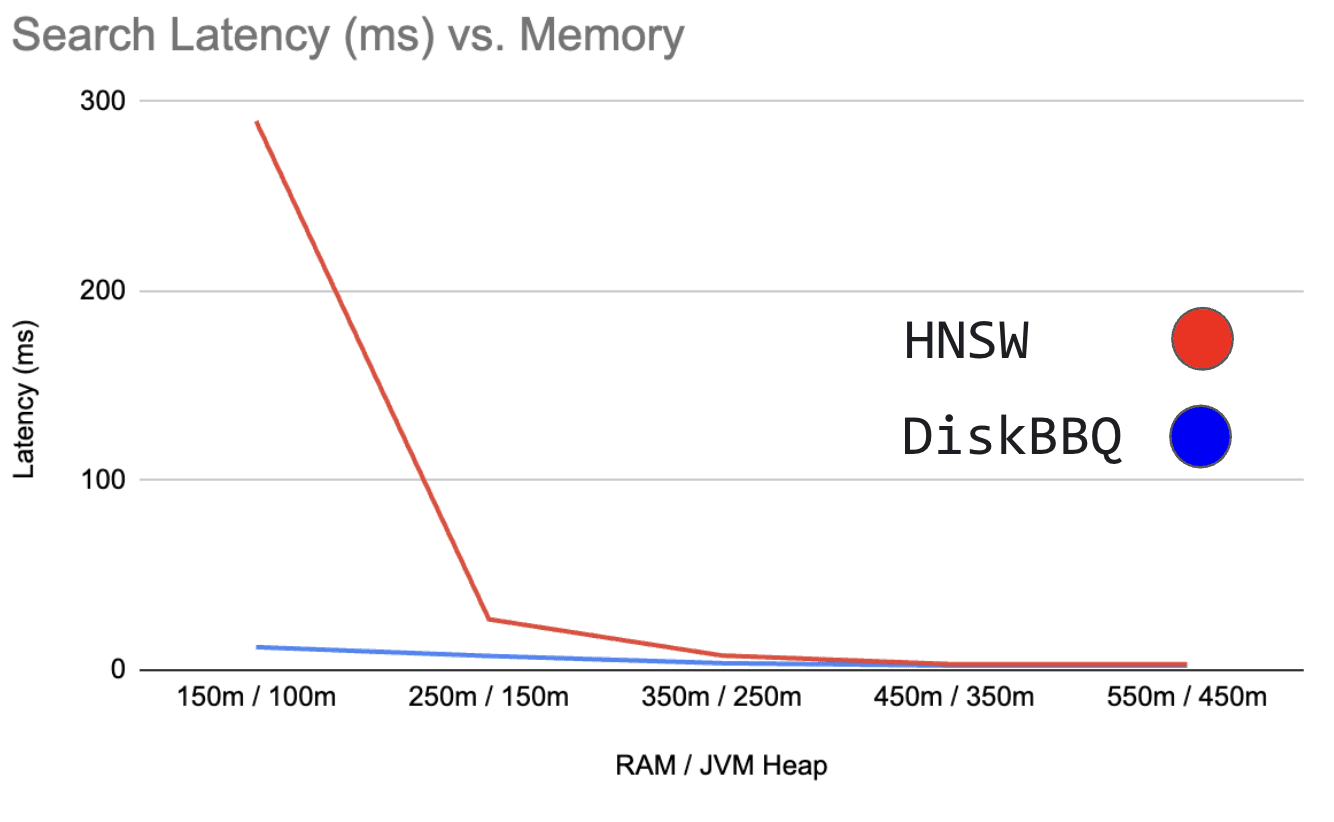

Show me the numbers
In our introductory blog, we talked about some high-level numbers. Let’s look back at the high-level query timings graph and dig a little deeper:
Figure 0: Shows search latency in milliseconds vs RAM / JVM Heap
DiskBBQ degrades in search latency, but is much more well-behaved than HNSW BBQ, which behaves exponentially as memory becomes increasingly restricted. But what does DiskBBQ look at in comparison as we add more memory?
Here’s those actual numbers laid out. And you can better see how DiskBBQ behaves in lower memory states. It definitely benefits from more RAM to better cache more clusters of vectors. Particularly, we rely heavily on off-heap cache, and as that increases, we see better performance until the whole of the quantized vectors are resident.

Here’s an additional run of 1m vectors only on DiskBBQ. Here, I did less to refine the exact ratios of RAM and Heap, and instead typically set one to half the other. We’ve also run it with up to 10g of RAM here. What’s interesting is to note the inflection point where the algorithm is no longer in a low memory configuration and no longer benefits from additional memory, in this case around 800m/400m.
RAM / Heap
Latency (ms)
101m / 10m
18
150m / 75m
12.13
200m / 100m
11.02
300m / 150m
4.26
400m / 200m
3.47
500m / 250m
3.5
800m / 400m
2.73
1.2g / 600m
2.76
1.5g / 750m
2.74
3g / 1.5g
2.83
5g / 2.5g
2.78
8g / 4g
2.73
10g / 5g
2.79

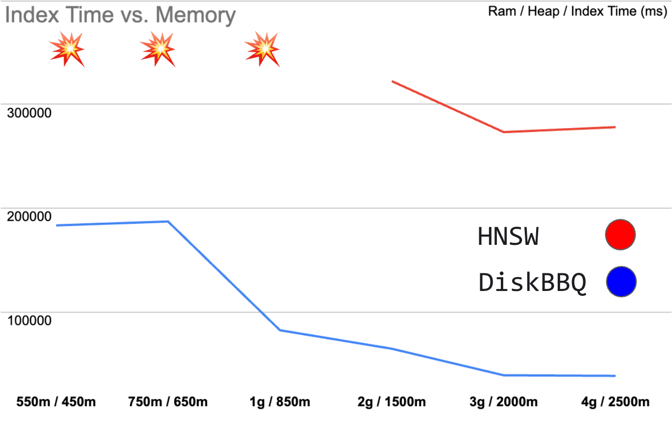

Indexing
Let’s also take a look at the indexing performance.
Figure 1: Shows index time in milliseconds vs RAM / JVM Heap
As overall memory reduces, DiskBBQ indexing degrades gracefully. HNSW BBQ, however, simply falls apart once memory gets very restricted. And downright fails in scenarios where DiskBBQ continues to operate. Again, let’s look at the numbers to get a better understanding of what’s happening.
Type
Ram / Heap
Index Time (ms)
DiskBBQ
550m / 450m
183377
DiskBBQ
750m / 650m
187123
DiskBBQ
1g / 850m
82397
DiskBBQ
2g / 1500m
64567
DiskBBQ
3g / 2000m
39002
DiskBBQ
4g / 2500m
38448
HNSW BBQ
550m / 450m
HNSW BBQ
750m / 650m
HNSW BBQ
1g / 850m
HNSW BBQ
2g / 1500m
322338 322338
HNSW BBQ
3g / 2000m
273239
HNSW BBQ
4g / 2500m
278005
As DiskBBQ can utilize more off heap cache space, larger chunks of particularly the raw vectors stay resident, which is especially useful as we partition the space with hierarchical k-means.
