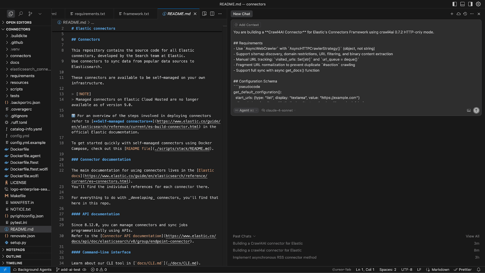

For development, use an AI-powered code editor connected to a powerful LLM (like Cursor, Claude Code, or Windsurf). Make sure you open the connectors project in your editor.
You should now see, for example, the README.md file in your top-level project structure.

You are building a Crawl4AI Connector for Elastic's Connector Framework, using the latest available version of Crawl4AI. Check the latest Crawl4AI version online.This sets the scene. Be explicit about the Connector Framework and the data source library being used. Mentioning the exact version helps the model generate compatible code, especially if it was trained on earlier releases.

Paste this structured prompt into e.g., Cursor to generate a complete connector implementation aligned with the interface expected by Elastic Connector Framework. From there, you’ll only need to validate, test, and tweak.

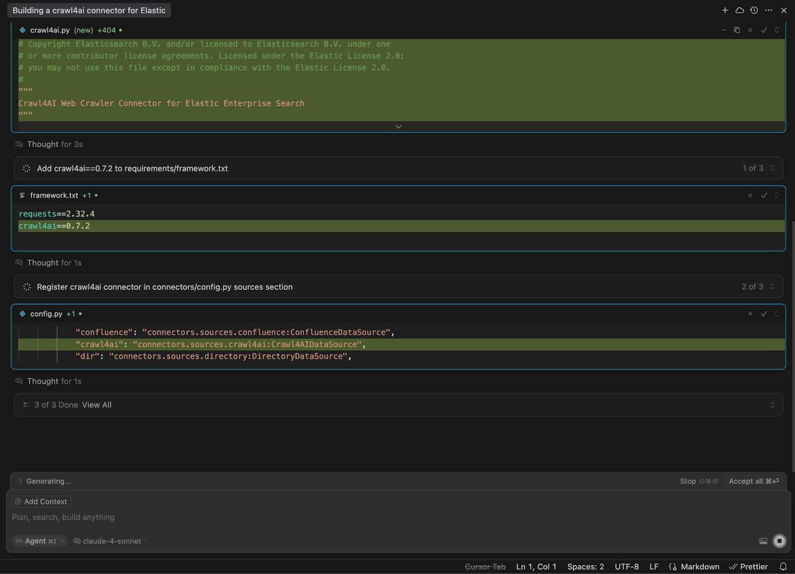

Generate the code

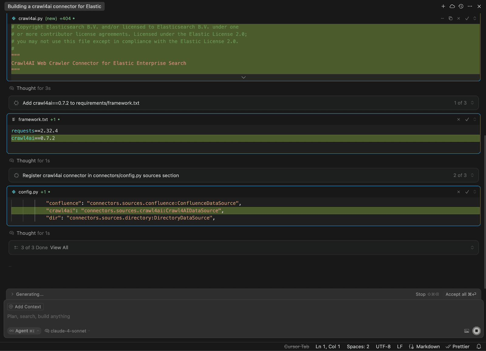

I'm using Cursor to generate the connector code. For this task, I chose the highly capable Claude Sonnet 4 reasoning model.

Connector file exists:
connectors/sources/crawl4ai.pyinheritsBaseDataSourceand implementsget_docs()andping().Registered in framework:
connectors/config.pymapsservice_type: "crawl4ai"to your class and adds it to the registry.Dependency added:
requirements/framework.txtincludescrawl4ai==<latest>
By now, your generated code should look roughly like this.

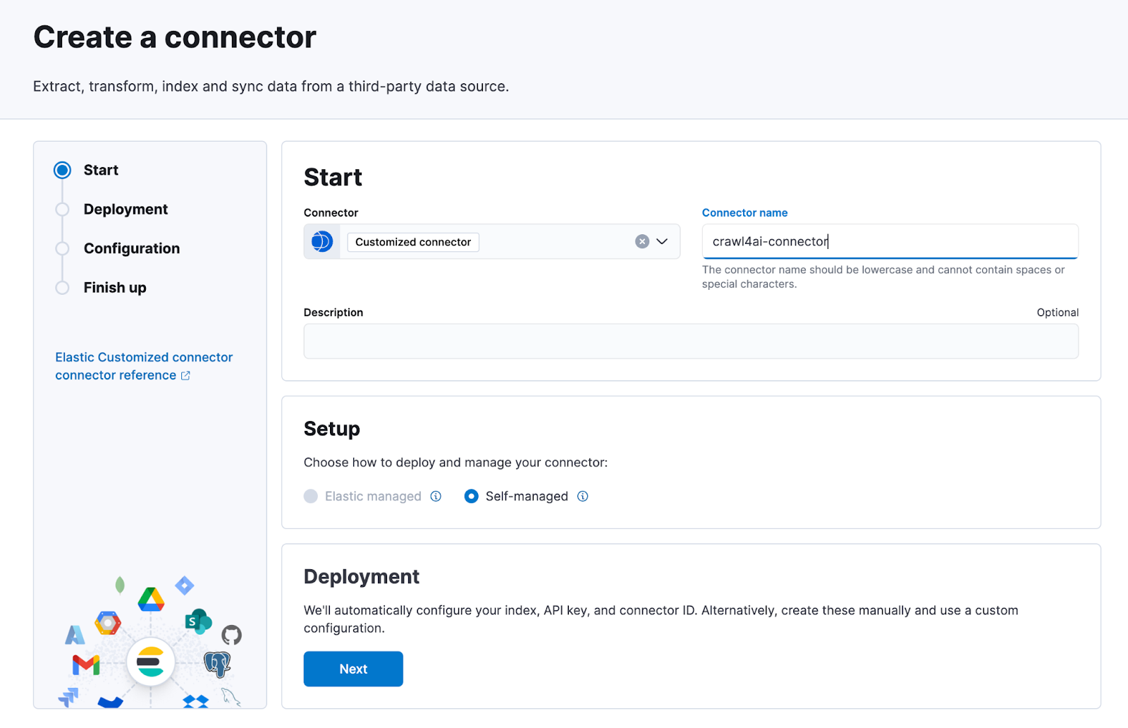

Connect to Elasticsearch
Once your connector code is generated, connect it to your Elastic Cloud instance using a config.yml:
You can get the connector_id by clicking “Create new connector” in Elastic and selecting “Customized connector” type:

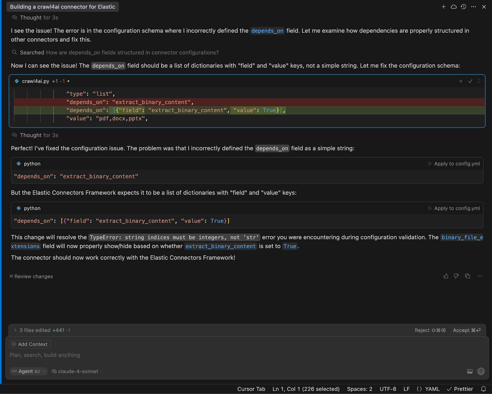

make runLet the LLM fix any issues
If you run into an error like I did in this example, just copy and paste it into Cursor, and the LLM will help you fix it.
In my case, the original prompt wasn’t clear enough about how the depends_on field works in the connector configuration. LLMs were able to look up how this property is used in other connectors to figure out the right definition.

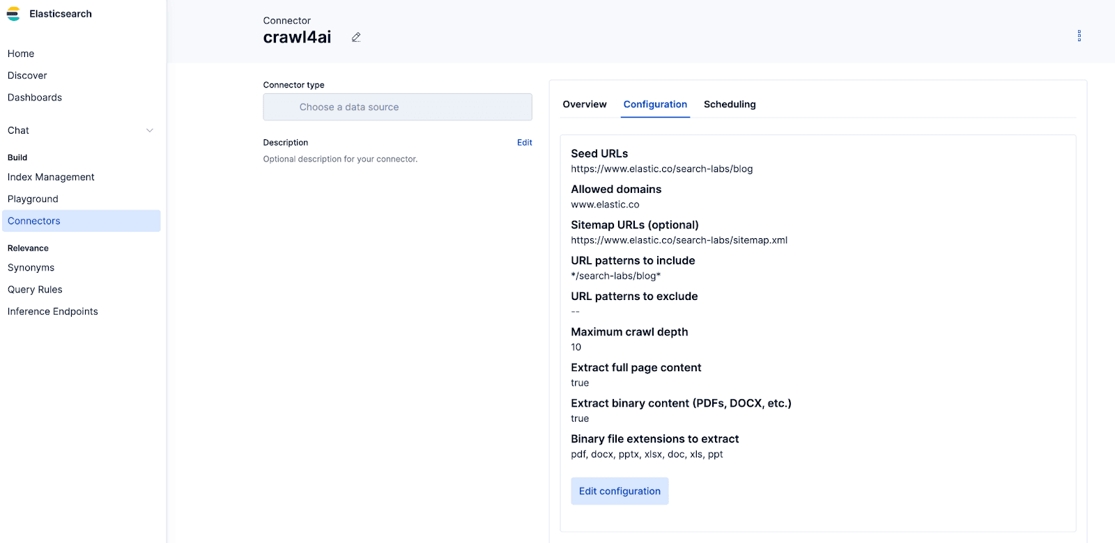

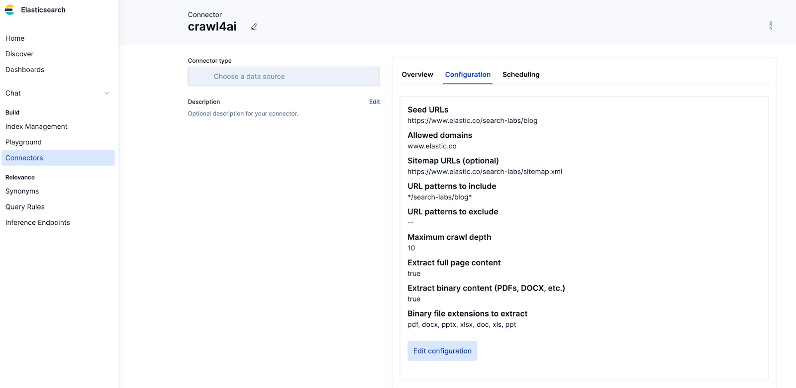

Configure and start syncing data

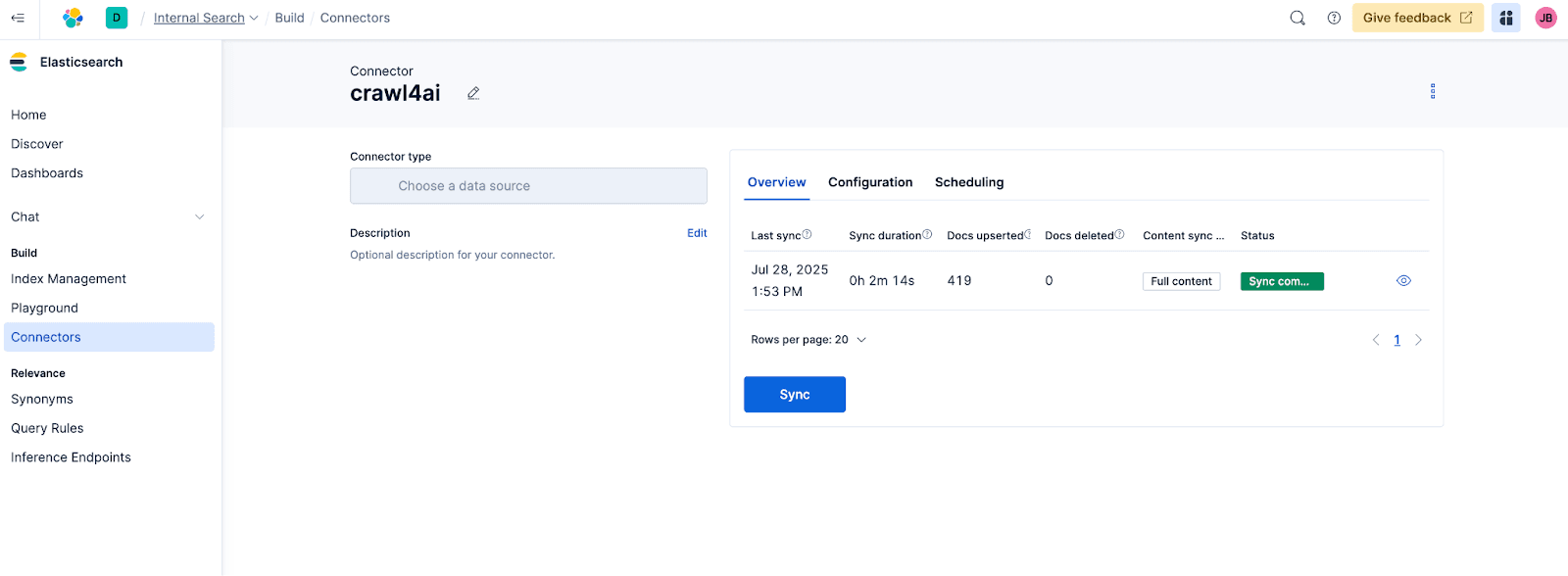

In our case, we crawled Elasticsearch Labs blogs into our index. Once your connector is configured, attach it to your index and start syncing.
If everything’s wired up correctly, your connector will begin ingesting data. If you encounter issues, paste the errors into Cursor and re-run the framework after fixes.
🎉 Success! Our connector crawled and synced 419 blog posts from Elasticsearch Labs.

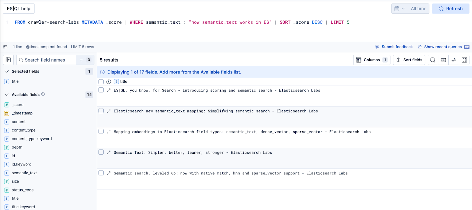

Here is an example of an ES|QL natural language query:
FROM crawler-search-labs METADATA _score | WHERE semantic_text : "how semantic_text works in ES" | SORT _score DESC | LIMIT 5Working implementation
