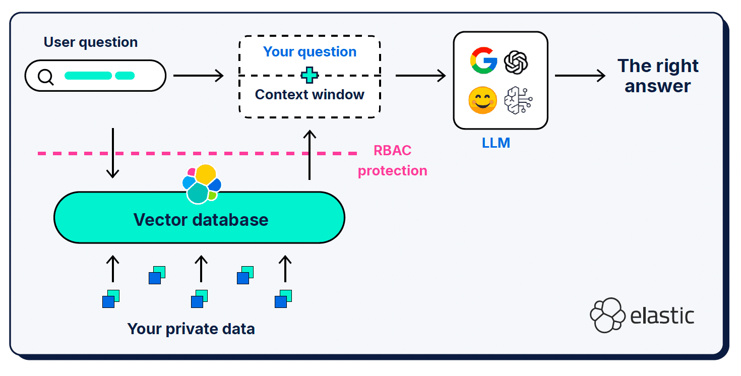

In addition to the user’s query and the system prompt, retrieval augmented generation (RAG) provides additional contextual information in what’s called a “context window.” RAG has been a critical addition to the architecture; it’s what we use to inform the LLM about the missing pieces in its semantic understanding of the world.
Context windows can be kind of persnickety in terms of what, where, and how much you give them. Which context gets selected is very important, of course, but the signal-to-noise ratio of the provided context also matters, as well as the length of the window.

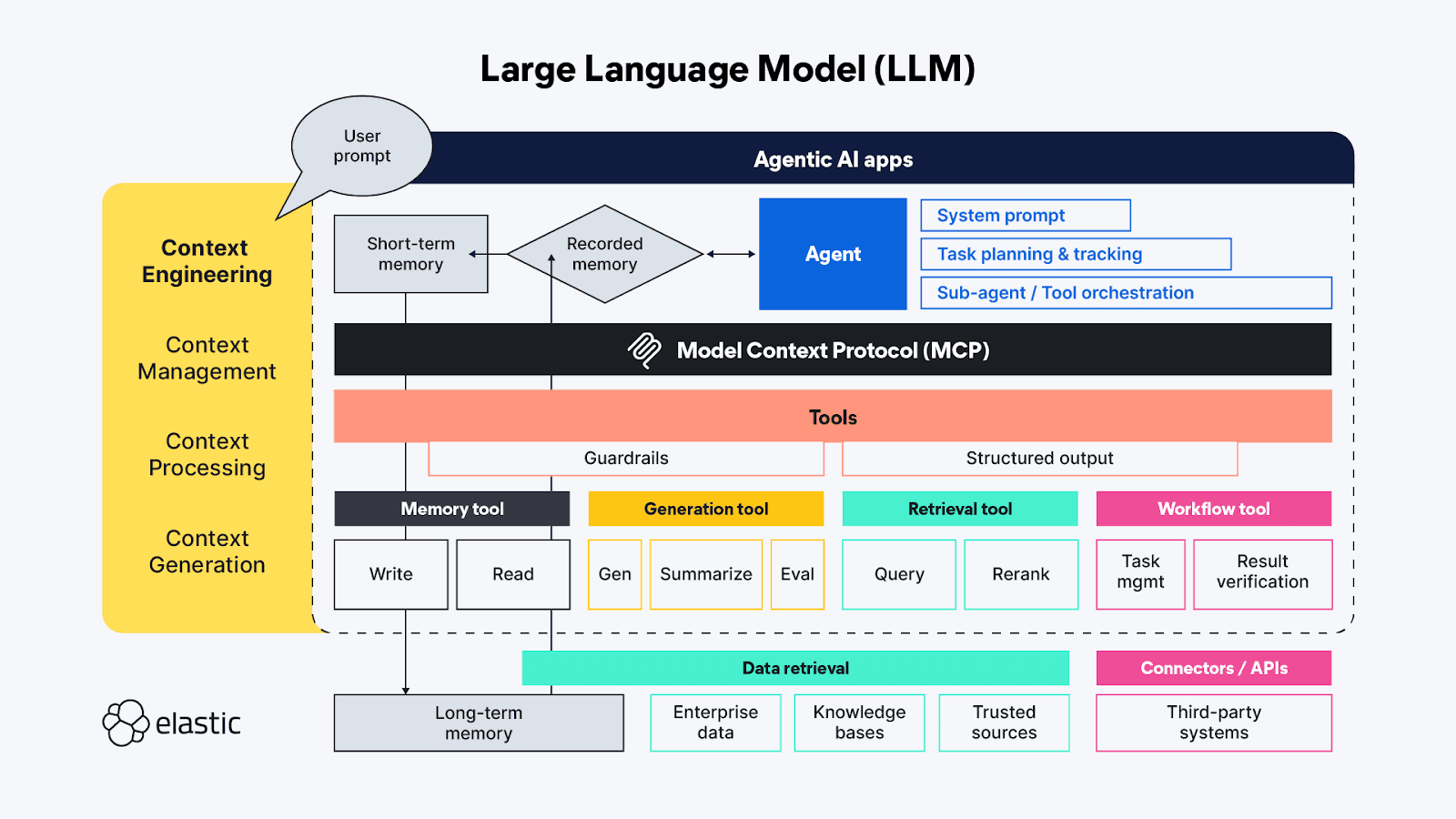

Welcome to context engineering!
If you’re familiar with generative AI terms, you’ve probably heard of ‘prompt engineering’ - at this point, it’s almost a pseudo-science of its own. Prompt engineering is used to find the best and most efficient ways of proactively describing the behaviors you want the LLM to use in generating its response. ‘Context engineering’ extends ‘prompt engineering’ techniques beyond the agent side to also cover available context sources and systems on the tools side of the MCP protocol, and includes the broad topics of context management, processing, and generation:
  • Context management - Related to maintaining state and context efficiency across long-running and/or more complex agentic workflows. Iterative planning, tracking, and orchestration of tasks and tool calling to accomplish the agent’s goals. Due to the limited “attention budget” agents have to work within, context management is largely concerned with techniques that help refine the context window to capture both the fullest scope and the most important bits of context (its precision versus recall!). Techniques include compression, summarization, and persisting context from previous steps or tool calls to make room in working memory for additional context in subsequent steps.
  • Context processing - The logical and hopefully mostly programmatic steps to integrate, normalize, or refine context acquired from disparate sources so that the agent can reason across all the context in a somewhat uniform manner. The underlying work is to make context from all sources (prompts, RAG, memory, etc.), all consumable by the agent as efficiently as possible.
  • Context generation - If context processing is about making retrieved context usable to the agent, then context generation gives the agent the outreach to request and receive that additional contextual information at will, but also with constraints.
The various ephemera of LLM chat applications map directly (and sometimes in overlapping ways) to those high-level functions of context engineering:
  • Instructions / system prompt - Prompts are the scaffolding for how the generative (or agentic) AI activity will direct its thinking towards accomplishing the user’s goal. Prompts are context in their own right; they aren’t just tonal instructions — they also frequently include task execution logic and rules for things like “thinking step by step” or “take a deep breath” before responding to validate the answer fully addresses the user’s request. Recent testing has shown markup languages are very effective at framing the different parts of a prompt, but care should also be taken to calibrate the instructions to a sweet spot between too vague and too specific; we want to give enough instruction for the LLM to find the right context, but not be so prescriptive that it misses unexpected insights.
  • Short-term memory (state/history) - Short-term memory is essentially the chat session interactions between the user and the LLM. These are useful in refining context in live sessions, and can be saved for future retrieval and continuation.
  • Long-Term Memory - Long-term memory should consist of information that is useful across multiple sessions. And it’s not just domain-specific knowledge bases accessed through RAG; recent research uses the outcomes from previous agentic/generative AI requests to learn and reference within current agentic interactions. Some of the most interesting innovations in the long-term memory space are related to adjusting how state is stored and linked-to so that agents can pick up where they left off.
  • Structured output - Cognition requires effort, so it’s probably no surprise that even with reasoning capabilities, LLMs (just like humans) want to expend less effort when thinking, and in the absence of a defined API or protocol, having a map (a schema) for how to read data returned from a tool call is extremely helpful. The inclusion of Structured Outputs as part of the agentic framework helps to make these machine-to-machine interactions faster and more reliable, with less thinking-driven parsing needed.
  • Available tools - Tools can do all sorts of things, from gathering additional information (e.g., issuing RAG queries to enterprise data repositories, or through online APIs) to performing automated actions on behalf of the agent (like booking a hotel room based on the criteria of the request from the agent). Tools could also be sub-agents with their own agentic processing chains.
  • Retrieval Augmented Generation (RAG) - I really like the description of RAG as “dynamic knowledge integration.” As described earlier, RAG is the technique for providing the additional information the LLM didn’t have access to when it was trained, or it’s a reiteration of the ideas we think are most important to get the right answer — the one that’s most relevant to our subjective query.
