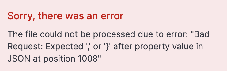

Despite going through few-shot examples and detailed explanations on how to build each visualization, we had no luck. If you are interested in this experimentation, you can find details here.
The result with this approach was seeing these messages when trying to upload to Kibana the files produced by the LLM:
This means the generated JSON is invalid or badly formatted. The most common issues were the LLM producing incomplete NDJSON, hallucinating parameters, or returning regular JSON instead of NDJSON no matter how hard we tried to enforce otherwise.

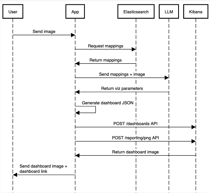

Inspired by this article –where search templates worked better than LLM freestyle – we decided to give templates to the LLM instead of asking to generate the full NDJSON file and then us, in code, use the parameters given by the LLM to create the proper visualizations.This approach didn't disappoint, and it’s predictable and extendable, as now the code is doing the heavy lifting and not the LLM.
The application workflow will be the following:
We will omit some code for simplicity, but you can find the working code for the full application on this notebook.

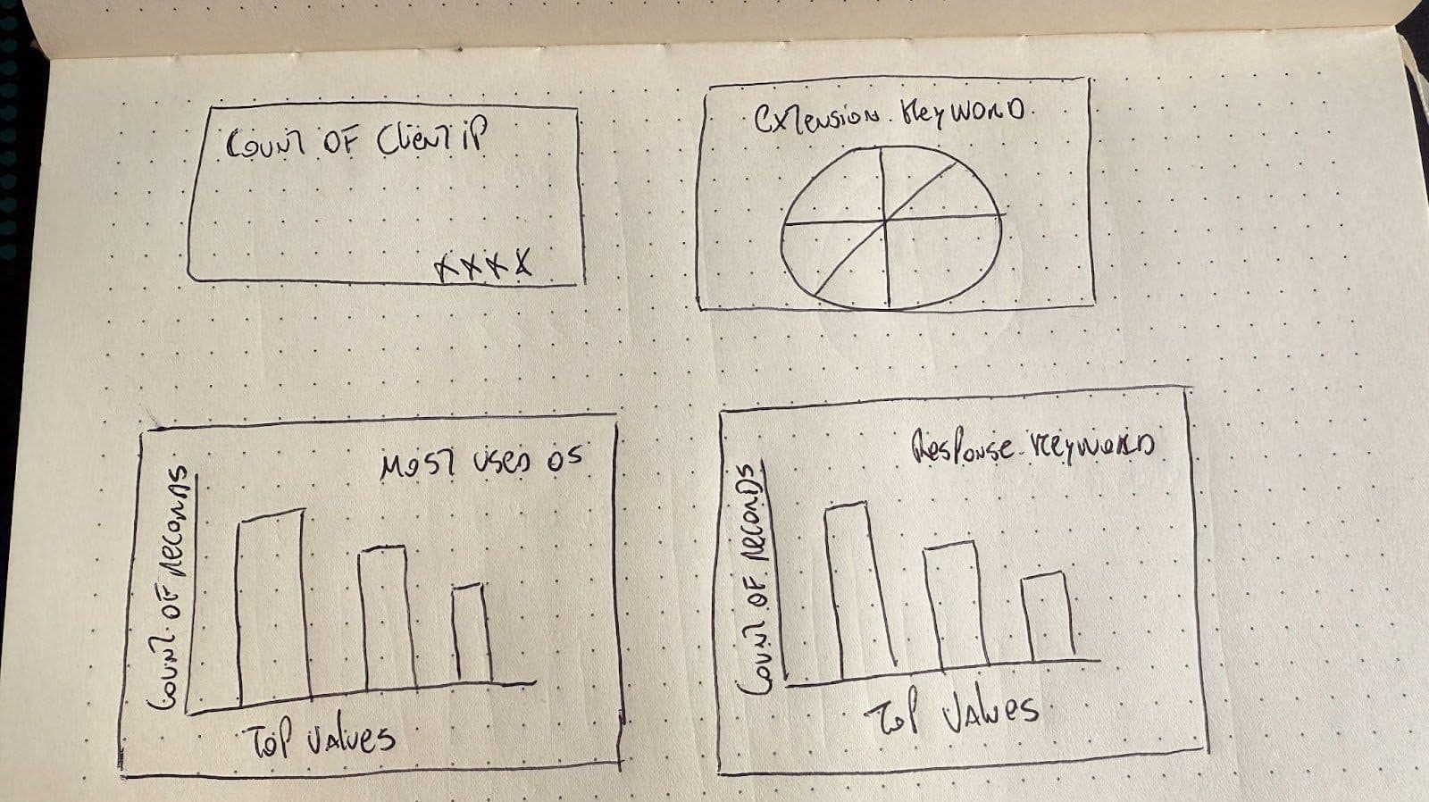

For the image input we will send a dashboard I just drew:

This will return an object with an array of visualizations to display:
"Dashboard values generated by the LLM successfully
title=""Client, Extension, OS, and Response Keyword Analysis""visualizations="[
   "Visualization(title=""Count of Client IP",
   "type="[
      "metric"
   "field=""clientip"")",
   "Visualization(title=""Extension Keyword Distribution",
   "type="[
      "pie"
   "field=""extension.keyword"")",
   "Visualization(title=""Most Used OS",
   "type="[
      "bar"
   "field=""machine.os.keyword"")",
   "Visualization(title=""Response Keyword Distribution",
   "type="[
      "bar"
   "field=""response.keyword"")"

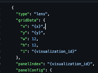

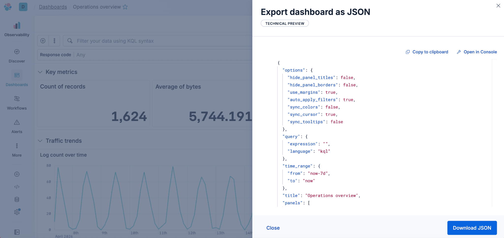

We created a sample 2x2 panel dashboard and then exported it in JSON using the Get a dashboard API, and then we stored the panels as visualization templates (pie, bar, metric) where we can replace some of the parameters to create new visualizations with different fields depending on the question.
You can see the template JSON files here. Note how we changed the object values we want to replace later with {variable_name}
With the information the LLM provided us, we can decide which template to use and which values to replace.
fill_template_with_analysis will receive the parameters for a single panel, including the JSON template of the visualization, a title, a field, and coordinates of the visualization on the grid.
Then, it will replace the values of the template and return the final JSON visualization.
