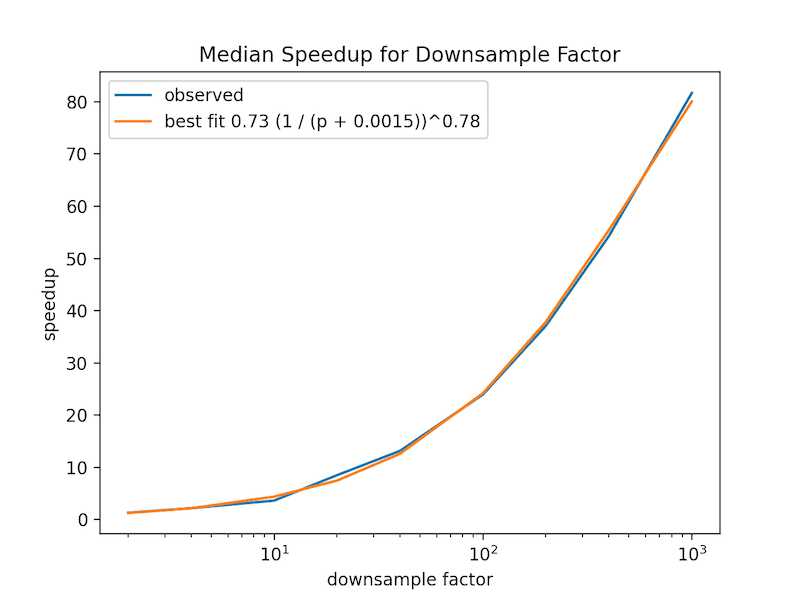

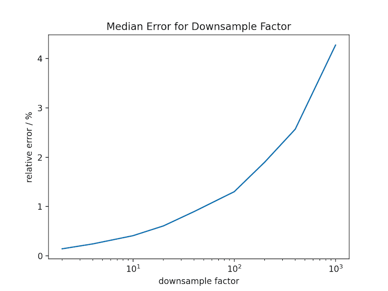

The calculations are from: 300 query and aggregation combinations, 5 seeds, and 9 sampling probabilities. In total, 13,500 separate experiments generated the following graphs for median speedup and median relative error as a function of the downsample factor which is 1 / sample probability.
Figure 2. Median speedup as a function of the downsample factor (or 1 / probability provided for the sampler).
Figure 3. Median relative error as a function of the downsample factor (or 1 / probability provided for the sampler).
With a probability of 0.001, for half of the scenarios tested, there was an 80x speed improvement or better with a 4% relative error or less. These tests involved a little over 64 million documents but spread across many shards. More compact shards and larger data can expect better results.

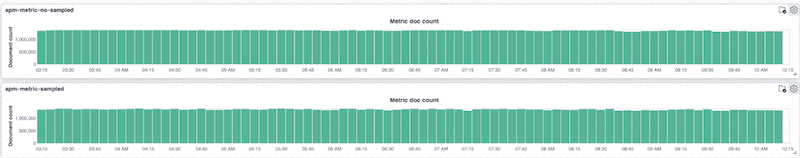

Below are two visualizations showing document counts for every 5 minutes over 100+ million documents. The total set loads in seconds and is sampled in milliseconds. This is with almost no discernible visual difference.
Figure 4. Sampled vs unsampled document count visualizations.

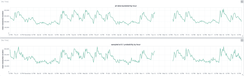

Here is another example. This time the average transaction by hour is calculated and visualized. While visually these are not exactly the same, the overall trends are still evident. For a quick overview of the data to catch trends, sampling works marvelously.
Figure 5. Sampled vs. unsampled average transaction time by hour visualization.

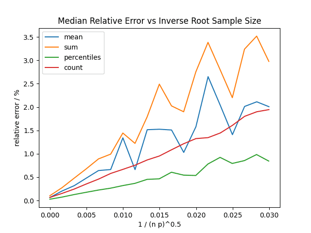

Here is a summary of what to expect from sampling with the random_sampler at query time.
Figure 6. Relative error for different aggregations.
Sampling accuracy varies across aggregations (see Figure 5 for some examples). Here is a list of some aggregations in order of descending accuracy: percentiles, counts, means, sums, variance, minimum, and maximum. Metric aggregation accuracy will also be affected by the underlying data variation: the lower the variation in the values, the fewer samples you need to get accurate aggregate values. The minimum and maximum will not be reliable with outliers, since there is always a reasonable chance that the sampled set misses the one very large (or small) value in the data set. If you are using terms aggregations (or some partitioning such as date histogram), aggregate values for terms (or buckets) with few values will be less accurate or missed altogether.

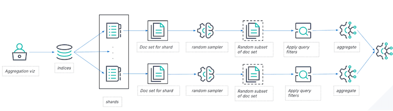

Sampling considers the entire document set within a shard. Once it creates the sampled document set, sampling applies any provided user filter. The documents that match the filter and are within the sampled set are then aggregated (see Figure 7).
Figure 7. Typical request and data flow for the random_sampler aggregation.
The key to the sampling is generating this random subset of the shard efficiently and without statistical biases. Taking geometrically distributed random steps through the document set is equivalent to uniform random sampling, meaning each document in the set has an equally likely chance of being selected into the sample set. The advantage of this approach is that the sampling cost scales with p (where p is the probability configured in the aggregation). This means no matter how small p is, the relative latency of performing the sampling adds will remain fixed.
