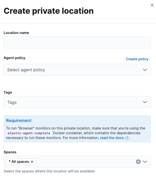

Next, you will need to create an Agent Policy. Go to Observability → Monitors (Synthetics) → Settings (top right) → Private Location → + Create Location
Fill in the fields and create a new policy for this Private Location. It is important to know that Private Location should be set up against an agent policy that runs on a single Elastic Agent.

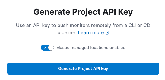

  1. Follow the prompt instructions to configure the default variables for your Synthetics project. Make sure to at least select your Private Location. Once that’s done, set the SYNTHETICS_API_KEY environment variable in your terminal, which allows the project to authenticate with Kibana.
    1. To generate an API key go to Synthetics Kibana.
    2. Click Settings.
    3. Switch to the Project API Keys tab.
    4. Click Generate Project API key.
