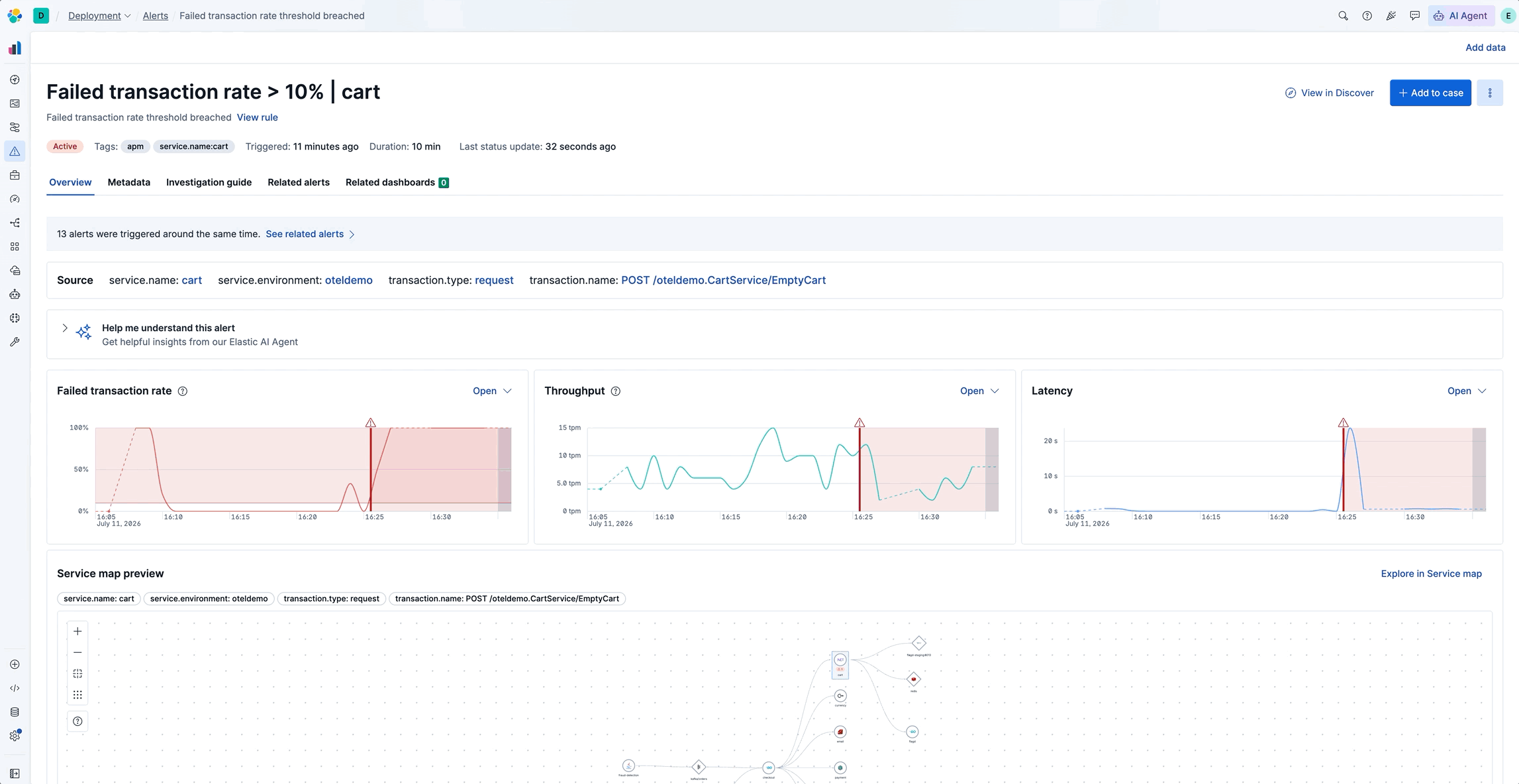

Step 1: Review RED metrics on the alert detail page
When you receive a notification for a RED metric threshold breach, if you open the alert detail page, you can review the symptoms for the impacted service on one page.
In our example, failed transactions have clearly increased for the cart service, so we want to understand what is driving that RED metric change:

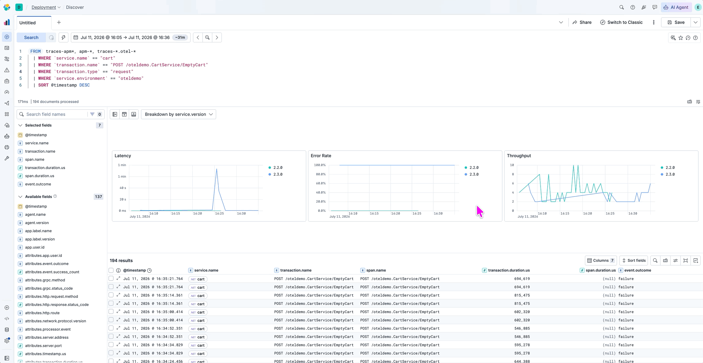

Step 2: Break down RED metrics by span attributes in Discover
To investigate why a RED metric changed, open Traces in Discover and use the new breakdown feature to split RED metrics by any attribute on your spans. In our example, we're going to check Kubernetes attributes and service version, but you could break down by any span attribute you send (e.g. cloud.region, cloud.availability_zone, or container.id).
Each breakdown shows which attribute values moved the metric, so you can see whether the problem is isolated to one pod, deployment, version, or whatever dimension you split on.
In our example, error rate clusters on a single Kubernetes deployment, which points the investigation at a release. We will break down by service.version to validate our hypothesis:
