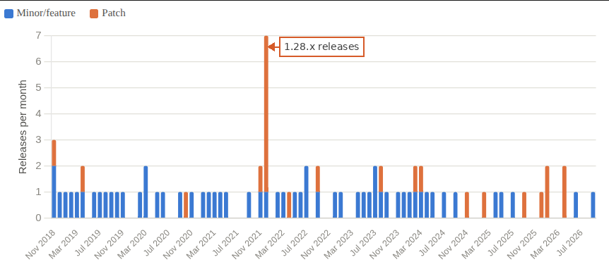

What Log4Shell told us about the migration
However, we were in for a surprise. The Log4Shell critical vulnerability was disclosed in December 2021 (less than three weeks after the publication of our initial blog post), and it triggered a wave of emergency upgrades across the Java ecosystem. Unfortunately, the Elastic APM Java Agent was impacted, since log4j is used for logging in the agent itself, exploitable under a non-default configuration, as detailed in the security advisory.
If you were trying to upgrade log4j in your application at that time, you probably remember the chaos and the stress it caused. To me, it seemed like almost everyone was upgrading to the latest version of log4j and publishing new releases of their own software and libraries. As a consequence, the Maven central repository was under extreme load and most builds and releases failed due to timeouts.
Economists have the concept of natural experiments, where an unexpected anomaly in the real world is used to try out a hypothesis that can't be tested in a controlled environment. We don't have a direct equivalent, but this unintentional massive migration to the newer version of the Elastic APM Java Agent provided us a strong signal that the implementation was stable and without major flaws.
Retrospectively, this was a very stressful moment for the team. But when we look at the release changelog, we can see that we didn’t have any major issues that would have required more patch releases. As shown in the chart below, except for the 1.28.x releases with log4j updates, the number of patch releases remains very low and the release cadence remains stable:
