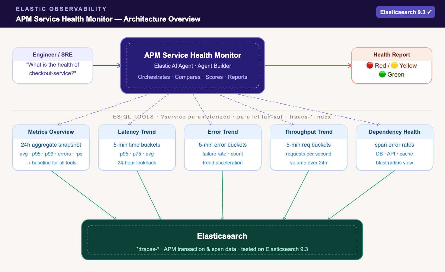

The APM Service Health Monitor encodes that reasoning (threshold logic, trend comparison, and dependency blast-radius analysis) into an Elastic AI agent that runs it on demand, for any service, anytime.
APM Service Health Monitor agent at the centre, fanning out to five ES|QL tools querying traces-*
How does the APM Service Health Monitor architecture work?
The agent is registered in Elastic Agent Builder as a chat-type agent wired to five ES|QL-powered tools. Each tool does one thing precisely. The agent orchestrates, compares, and reasons across all five.
POST kbn:/api/agent_builder/agents
  "id": "apm_service_health_agent",
  "type": "chat",
  "name": "APM Service Health Monitor",
The APM Service Health Monitor sits at the center, fanning out to five ES|QL tools that query traces-*.
Here is how the tool layer is composed.

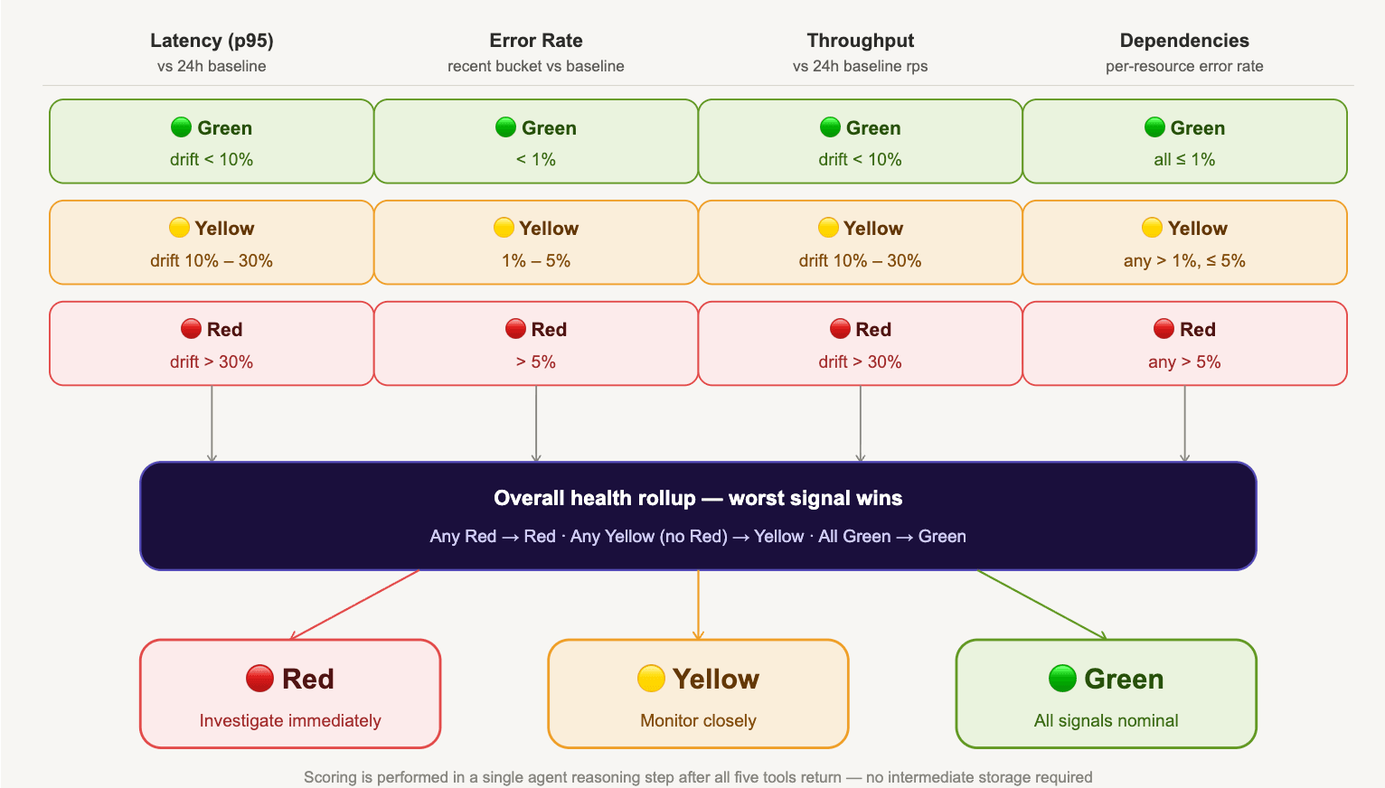

How the health scoring works
Once all five tools return their data, the agent computes a health state for each metric in a single reasoning step. There is no polling loop and no intermediate storage. Here is exactly what gets compared to what:
MetricTool providing the valueCompared againstHow scored
Latency (p95)apm_latency_trend_tool24h p95 from apm_metrics_overview_tool< 10% Green · 10–30% Yellow · > 30% Red
Error rateapm_error_trend_toolFixed thresholds + 24h error_rate from overview< 1% Green · 1–5% Yellow · > 5% Red
Throughputapm_throughput_trend_tool24h throughput_rps from apm_metrics_overview_tool< 10% Green · 10–30% Yellow · > 30% Red
Each dependencyapm_dependency_health_toolFixed thresholds only (no baseline)All ≤1% Green · Any >1% Yellow · Any >5% Red
The overall verdict follows a single rule: the worst individual metric wins.
Any metric is Red                → Overall = 🔴 Red
Any metric is Yellow (no Red)   → Overall = 🟡 Yellow
All metrics are Green            → Overall = 🟢 Green
The Red/Yellow/Green scoring logic lives in the agent's natural-language instructions. It is readable, auditable, and adjustable without touching code or redeploying infrastructure.

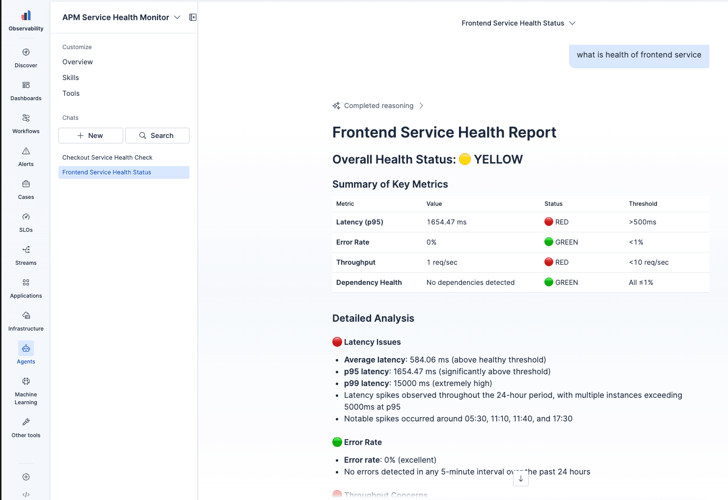

Try it: ask the agent about your service
Once deployed, open the agent in Kibana and type this:
What is the health of my checkout-service in the last 24 hours?
The agent fans out to all five tools, computes the metric states, applies the health logic in one pass, and responds with a structured report.
Kibana chat card: checkout-service · Last 24h · per-metric table with Red/Yellow/Green status pills · Overall: 🔴 Red
The agent identified the root cause without any manual correlation: postgres-primary is failing 6.1% of its calls, and that is cascading directly into the p95 latency spike. No dashboard pivoting, no manual ES|QL. One prompt, full situational awareness.

How does the agent decide Red, Yellow, or Green?
Each metric is scored against thresholds: latency and throughput are compared to their 24-hour baselines (within 10% Green, 10 to 30% Yellow, over 30% Red), and error rate uses fixed thresholds (under 1% Green, 1 to 5% Yellow, over 5% Red). The overall verdict is the worst individual metric: any Red makes the service Red.
