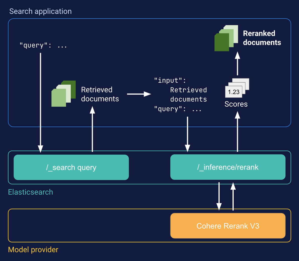

Reranking search results today - through your application
One way of harnessing the power of semantic reranking is to implement a workflow like this in a search application:
  1. A user enters a query in your app's UI.
  2. The search engine component retrieves a set of documents that match this query. This can be done using any retrieval strategy: lexical (BM25), vector search (e.g. kNN) or a method that combines the two, such as RRF.
  3. The application takes the top K documents, extracts the text field we are querying against from each document, then sends this list of texts to the rerank inference endpoint, which is configured to use Cohere.
  4. The inference endpoint passes the documents and the query to Cohere.
  5. The result is a list of scores and indices to match each score. Your app takes these scores, assigns them to the documents, and reorders them by this score in a descending order. This effectively moves the semantically most relevant documents to the top.
  6. If this flow is used in RAG to provide some sources to a generative LLM (such as summarizing an answer), then you can rest assured it will work with the right context and provide answer.
This works great, but it involves many steps, data massaging, and a complex processing logic with many moving parts. Can we simplify this?

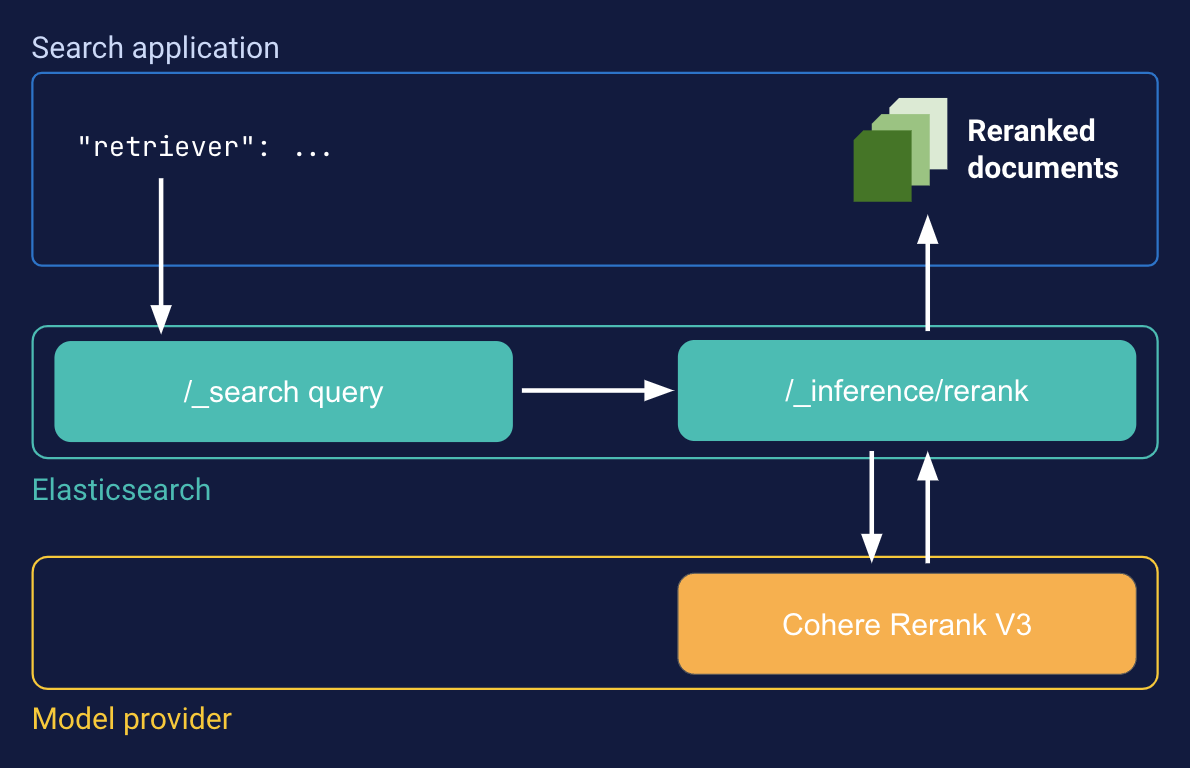

Reranking search results tomorrow - with retrievers
Let's spend a minute talking about retrievers. Retriever is a new type of abstraction in the _search API, which is more than just a simple query. It's a building block for an end-to-end search flow for fetching hits and potentially modifying the documents' scores and their order.
Retrievers can be used in a pipeline pattern, where each retriever unit does something different in the search process. For example we can configure a first-stage retriever to fetch documents, pass the results to a second-stage retriever to combine with other results, trim the number of candidates etc. As a final stage, a retriever can update the relevance score of documents.
Soon we'll be adding new reranking capabilities with retrievers, text similarity reranker retriever being the first one. This will perform reranking on top K hits by calling a rerank inference endpoint. The workflow will be simplified into a single API call that hides all the complexity!
This is what the previously described multi-stage workflow looks like as a single retriever query:
