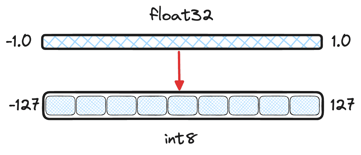

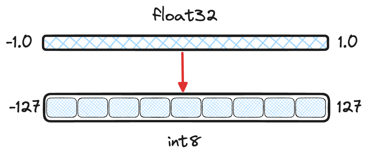

Scalar quantization takes each vector dimension and buckets them into some smaller data type. For the rest of the blog, we will assume quantizing float32float32 values into int8int8. To bucket values accurately, it isn't as simple as rounding the floating point values to the nearest integer. Many models output vectors that have dimensions continuously on the range [−1.0,1.0][-1.0, 1.0]. So, two different vector values 0.123 and 0.321 could both be rounded down to 0. Ultimately, a vector would only use 2 of its 255 available buckets in int8int8, losing too much information.
Figure 1: Illustration of quantization goals, bucketing continuous values from −1.0-1.0 to 1.01.0 into discrete int8int8 values.

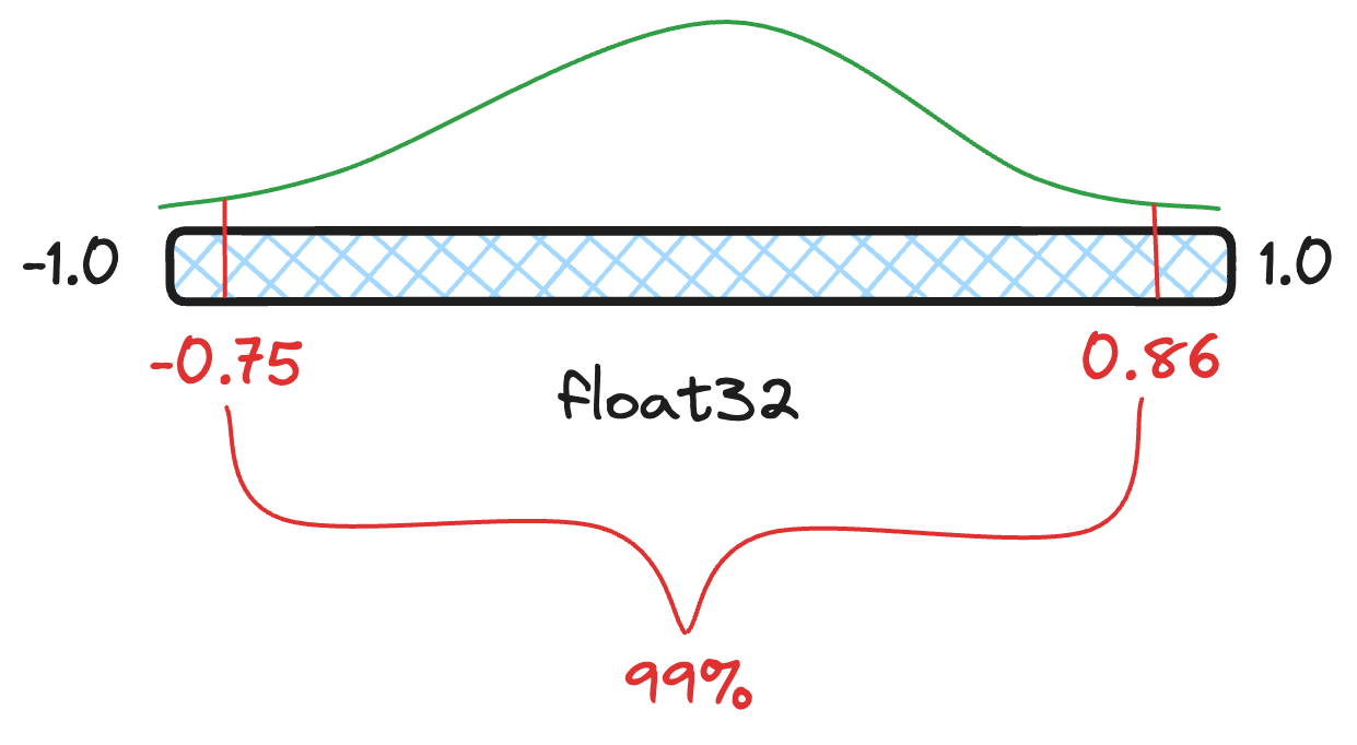

A quantile is a slice of a distribution that contains a certain percentage of the values. So, for example, it may be that 99%99\% of our floating point values are between [−0.75,0.86][-0.75, 0.86] instead of the true minimum and maximum values of [−1.0,1.0][-1.0, 1.0]. Any values less than -0.75 and greater than 0.86 are considered outliers. If you include outliers when attempting to quantize results, you will have fewer available buckets for your most common values. And fewer buckets can mean less accuracy and thus greater loss of information.
Figure 3: Illustration of the 99%99\% confidence interval and the individual quantile values. 99%99\%% of all values fall within the range [−0.75,0.86][-0.75, 0.86].
