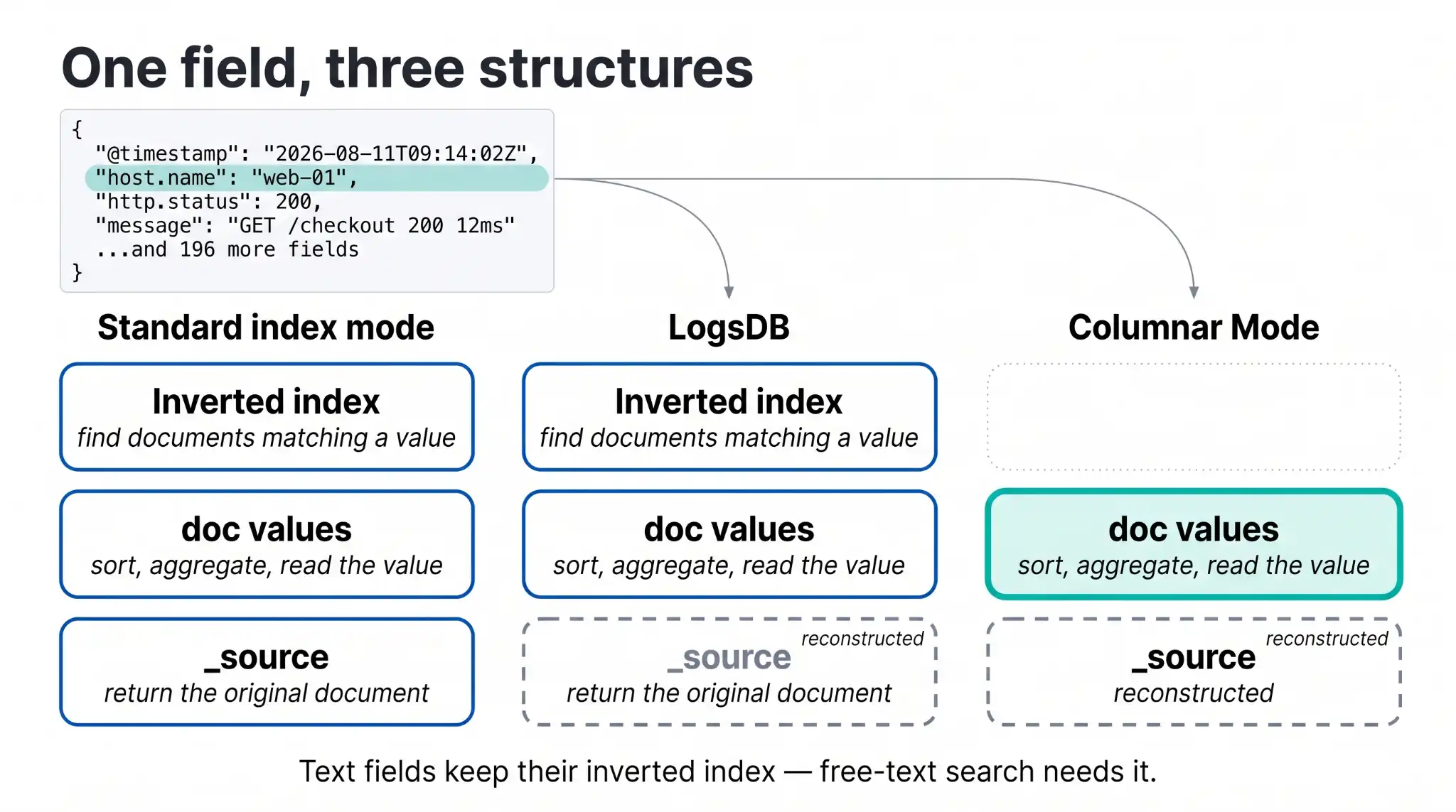

The columnar layout in Elasticsearch is built on four properties that TSDS has enforced since version 8.7:
  • The metric name plus dimension names and values produce the _tsid, a unique identifier per time series.
  • Data is sorted by [_tsid ascending, @timestamp descending], so each time series sits contiguously on disk and dimension values cluster together.
  • Shard routing is based on _tsid, so a given series lives in one shard.
  • Backing indices are time-bound and don't overlap.
The key change over the past year was to stop keeping separate inverted indices or BKD trees for every field and instead store each field as doc values (Lucene’s columnar storage), supported by doc value skippers, which are lightweight hierarchical sparse indices. That makes the on-disk layout columnar end to end, which is what lets the query engine read one column at a time and process it with vectorized execution.
