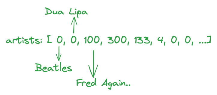

A vector is a mathematical entity that has both magnitude (size) and direction. In this context, vectors are used to represent data, such as the number of songs listened to by a user for each artist. The magnitude corresponds to the count of songs played for an artist, while the direction is determined by the relative proportions of the counts for all artists within the vector. Although the direction is not explicitly set or visualized, it is implicitly defined by the values in the vector and their relationships to one another.
The idea is to simply create a huge array where we do a key => value sorting approach. The key is the artist and the value is the count of listened to songs. This is a very simple approach and can be done with a few lines of code. We create this vector:
Which is super interesting because it is now sorted by the artist name. This gives us zero values for all artists we didn't listen to, or which the user didn't even know existed.

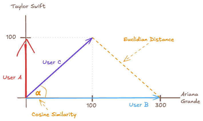

Finding your musical match then becomes a straightforward task of calculating the distance between two vectors and identifying the closest match. Several methods can be used for this, such as the dot product, euclidean distance, and cosine similarity. Each method behaves differently and may yield varying results. It is important to experiment and determine which approach best suits your needs.
How does cosine similarity, Euclidian distance and dot product work?
We will not delve into the mathematical details of each method, but we will provide a brief overview of how they work. To simplify, let’s break this down into just two dimensions: Ariana Grande and Taylor Swift. User A listens to 100 songs by Taylor Swift, user B listens to 300 songs by Ariana Grande, and user C falls in the middle, listening to 100 songs by Taylor Swift and 100 songs by Ariana Grande.
  • The Cosine Similarity is better the smaller the angle and focuses on the direction of the vectors, ignoring their magnitude. In our case, user C will match with user A and user B equally because the angle between their vectors is the same (both are 45^\circ).
  • The Euclidian distance measures the direct distance between two points, with shorter distances indicating higher similarity. This method is sensitive to both direction and magnitude. In our case, user C is closer to user A than to user B because the difference in their positions results in a shorter distance.
  • The dot product calculates similarity by summing the products of the corresponding entries of two vectors. This method is sensitive to both magnitude and alignment. For example, user A and user B result in a dot product of 0 because they have no overlap in preferences. User C matches more strongly with user B (300 × 100 = 30,000) than with user A (100 × 100 = 10,000) due to the larger magnitude of user B’s vector. This highlights the dot product’s sensitivity to scale, which can skew results when magnitudes differ significantly.
In our specific use case, the magnitude of the vectors should not significantly impact the similarity results. This highlights the importance of applying normalization (more on that later) before using methods like Euclidean distance or dot product to ensure that comparisons are not skewed by differences in scale.

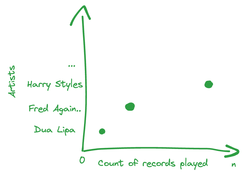

Using a sparse_vector type
We tried squeezing our vector where each position represented an artist into a dense_vector field, however it's not the best fit as you can tell. We are limited to 4096 artists and we end up with a large array that has a lot of null values. Philipp might never listen to Pink Floyd yet in the dense vector approach, Pink Floyd will take up one position with a 0. Essentially, we were using a dense vector format for data that is inherently sparse. Fortunately, Elasticsearch supports sparse vector representation through the sparse_vector type. Let’s explore how it works!
  "artists": {
    "Casper": 1334,
    "Fred again..": 22561,
    "Ariana Grande": 10234
Instead of creating one large array, we will create a key => value pair and store the artists name next to the listened count. This is a much more efficient way of storing the data and will allow us to store a higher cardinality. There is no real limit to how many key value pairs you can have inside the sparse_vector. At some point the performance will degrade, but that is a discussion for another day. Any null pairs will simply be skipped.
