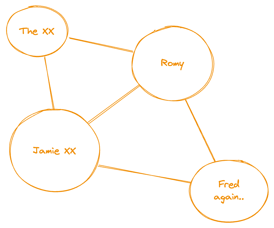

Let's assume we have the following documents, each row represents a new document.
artist: ["Jamie XX"]
artist: ["Jamie XX", "Romy"]
artist: ["The XX", "Romy"]
artist: ["Jamie XX", "Fred again.."]
artist: ["Fred again..", "Romy"]
Now, Kibana Graph will compute all term co-occurrences to build the connections between each node. Therefore, we would expect a graph to look like this:
This is a very simple example, but it shows the basic idea of how Kibana Graph works. It takes all the documents and creates a graph from them. There is some terminology involved here: the circles with the artist are known as nodes or vertices and the connection between those circles is known as an edge. There are also a few tuning options that we can use:

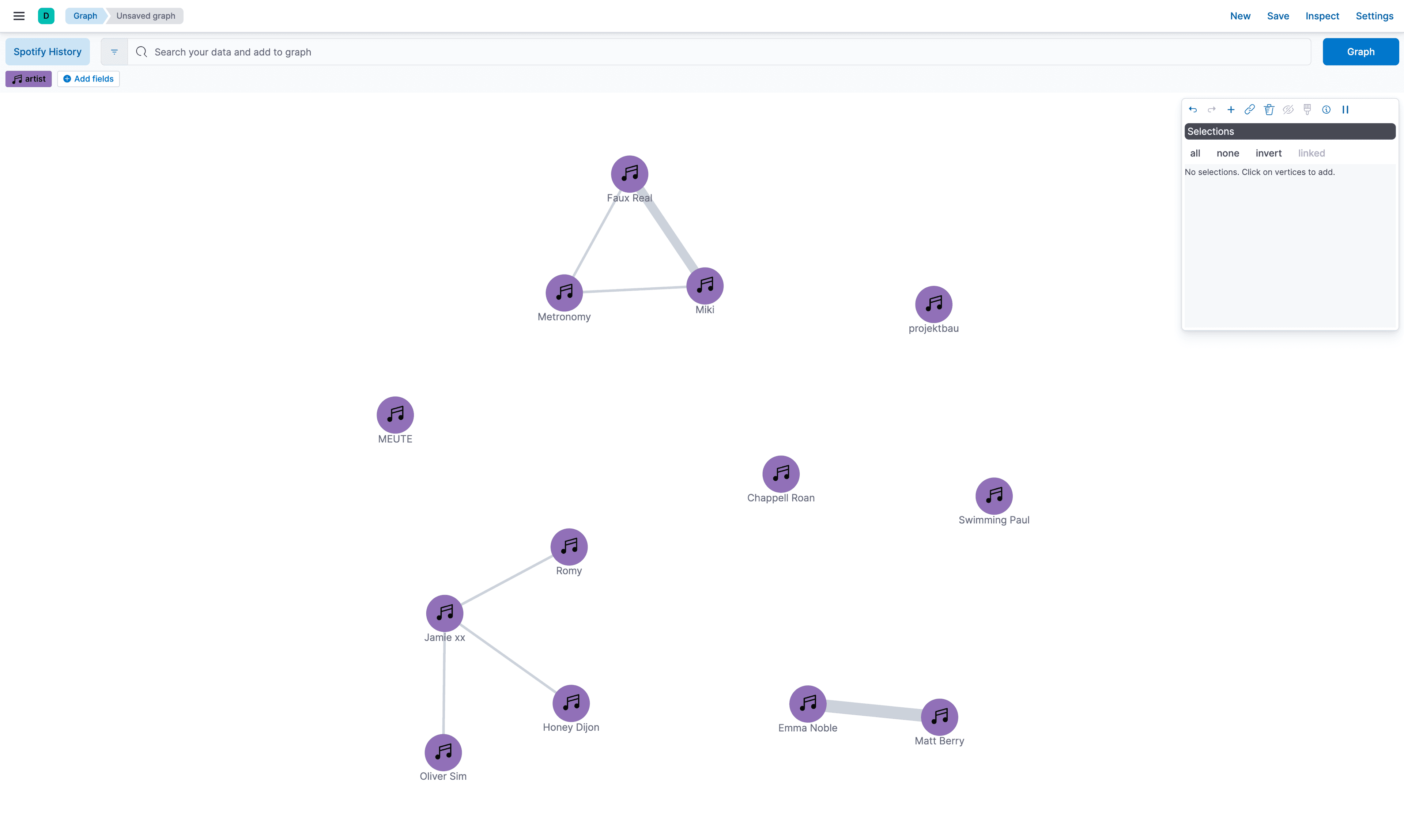

With the fundamentals explained, go to Kibana and click on the Graph app. You will need to select a data view, which is the Spotify History. When prompted to select a field, use the artist field. By default, that should turn out violet with a musical 16th note on it. I had to adjust my sample size to 5000 to get a good starting graph.

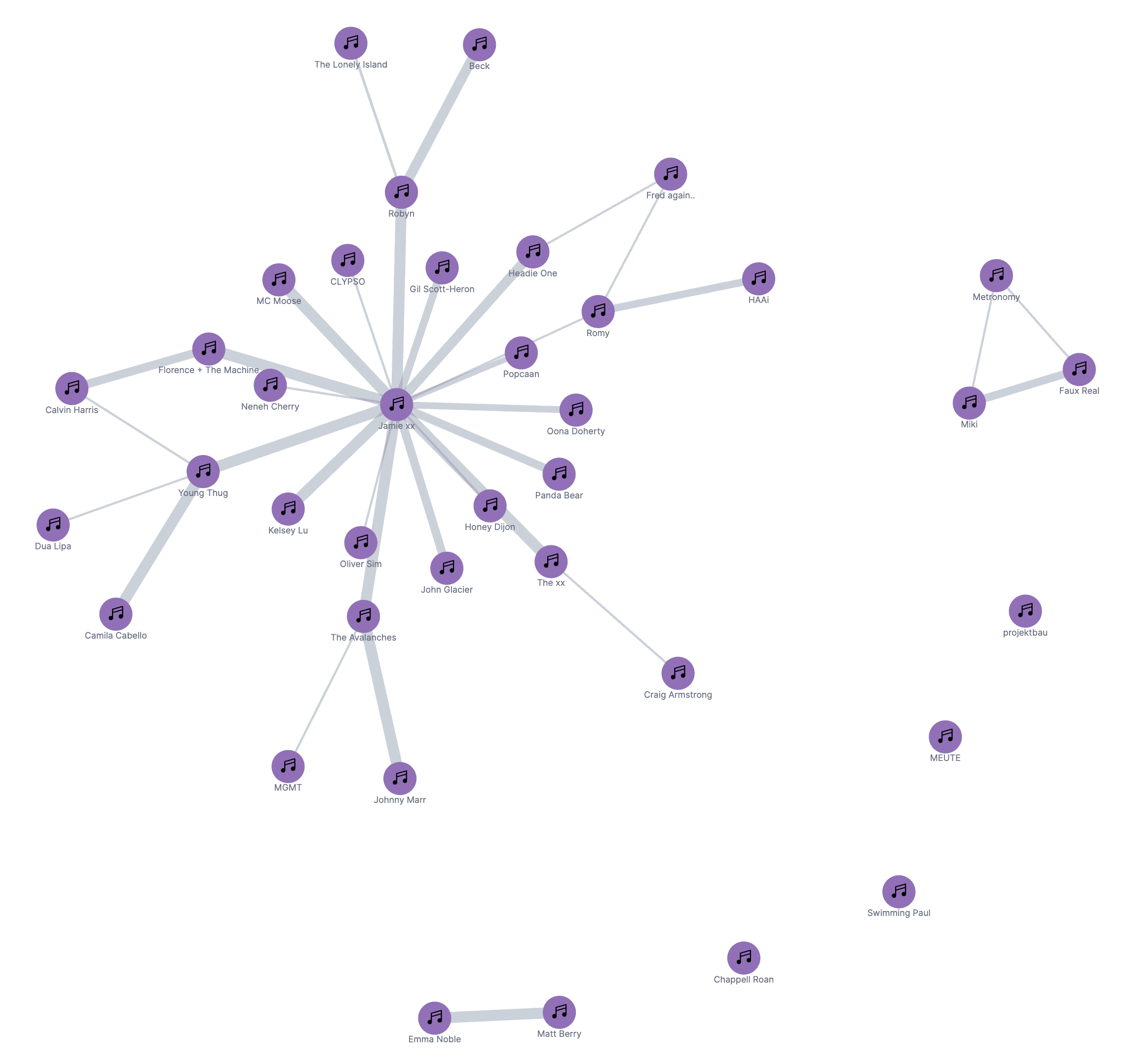

We can tell that we have multiple artists that are connected to each other. This allows us to select one of those artists and press the + sign. There are already some clusters forming, which is important. Those standalone artists are not interesting to us. There is an all button in the right panel. Select it and press the + again. This will now explode your graph and pull in the additional artists.

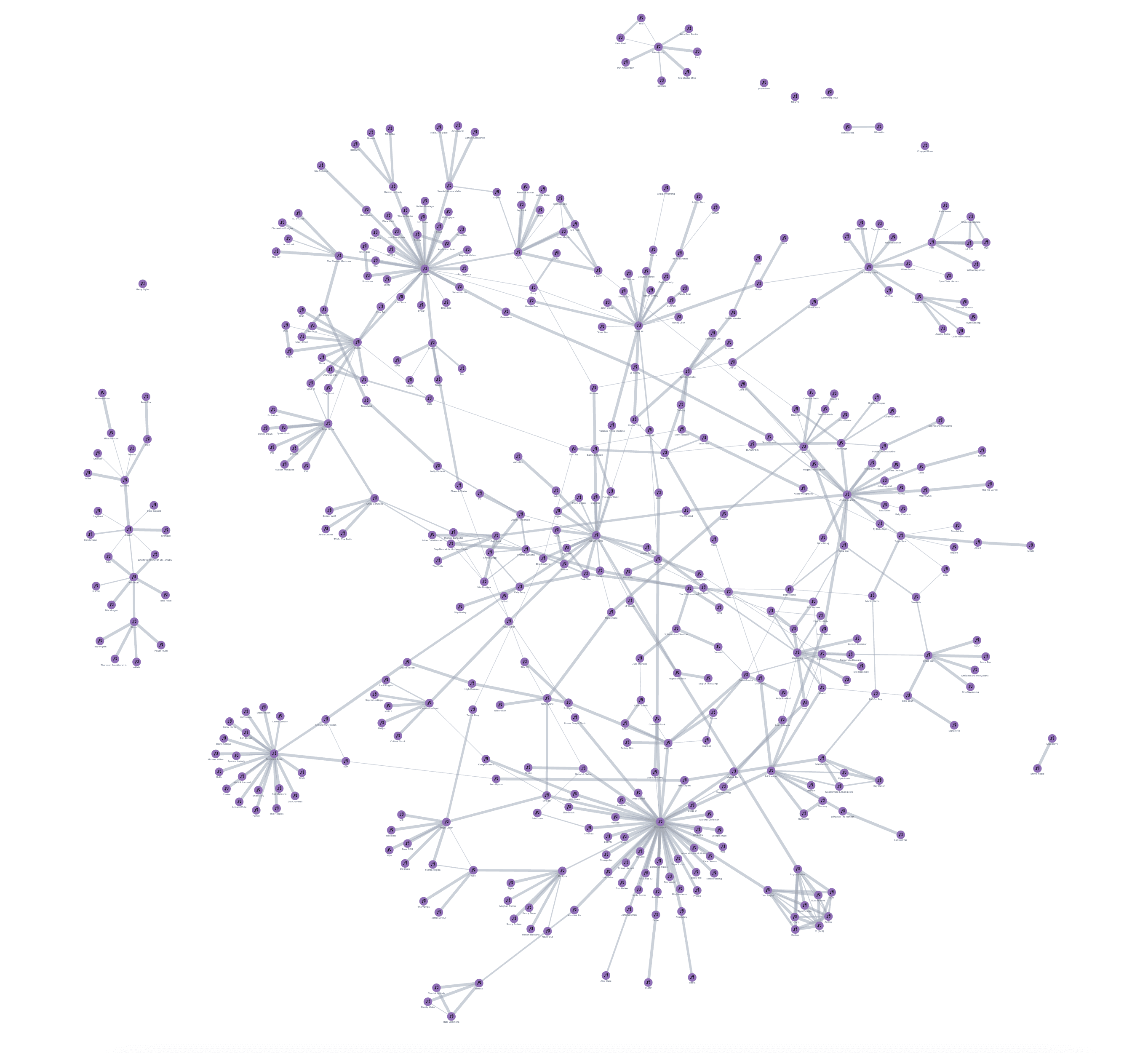

If we continue this process, increase the sample size and start exploding the graph more and more. Depending on your listening style, you should either get a lot of little islands or a few big clusters. In the next picture, we see one big cluster in the middle that interconnects Rudimental, Fred again.., and Jamie XX. This makes sense, as all of them belong to the same genre which heavily features the same artists. At the same time, we have some tinier islands around. Kraftklub is a German band and is connected to mostly all of the German music I listen to, like Casper and Blond. There are some isolated vertices such as Harry Styles.

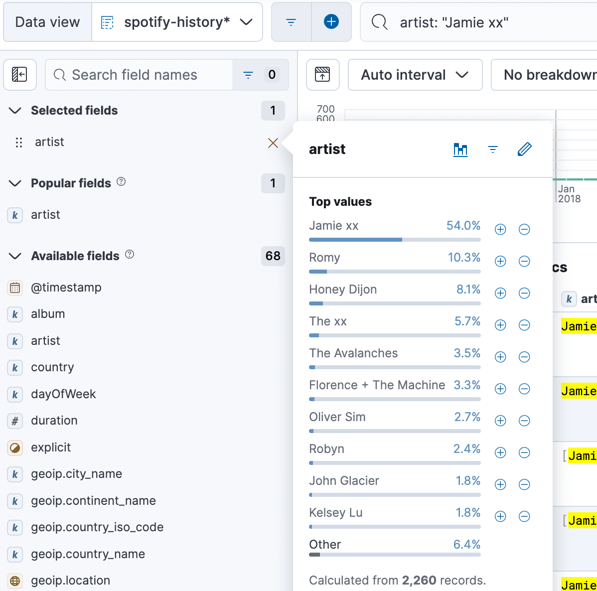

Go to Discover and perform the following:
  • In the search bar, write artist: "Harry Styles". This filters down to all documents that have Harry Styles in the name.
  • We can simply click on the field artist in the field picker on the left side and see that there is only 1 value.
  • Even though I listened to Harry Styles 2535 times, he has never featured another artist (or at least, according to Spotify data, it is not listed as such). Compare that to e.g. Jamie XX and we can see the difference.
