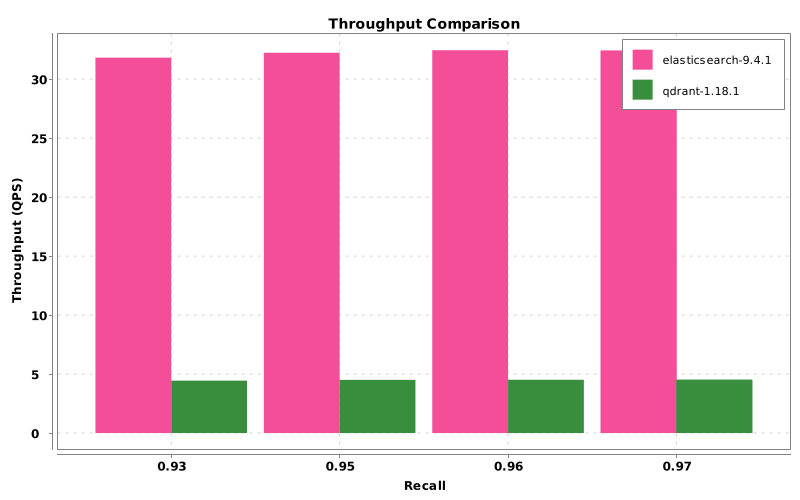

Graph 1: Throughput versus recall.
Vector search is a critical foundation for large language model (LLM) applications, retrieval augmented generation (RAG), and other AI workloads. In this benchmark, Elasticsearch achieved up to 7x higher throughput than Qdrant at comparable recall on the same storage topology. Elasticsearch as a vector database offers strong vector search performance even when network-attached persistent storage remains on the query path.
The difference reflects how the two systems interact with disk. Elasticsearch DiskBBQ is designed to keep vector search efficient when persistent storage remains on the query path, using a compact quantized representation and limiting costly access to full precision vectors during search. In this setup, Qdrant relies on a graph-based search path with rescoring against original vectors stored on disk. On network-attached persistent storage, that random access cost becomes much more significant, which is why the performance gap widens as recall increases. This benchmark therefore focuses specifically on network-attached persistent storage, a common deployment model in managed cloud and Kubernetes environments.

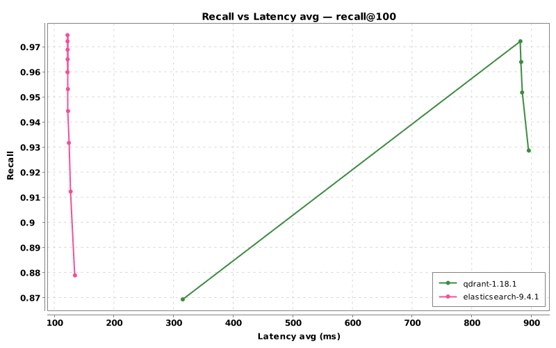

Graph 2: Recall versus average latency.
The key pattern in the latency curve is not only the size of the gap but also its shape. Elasticsearch latency remains comparatively flat as recall increases, suggesting that higher recall doesn’t require a dramatic increase in expensive storage activity. Qdrant’s latency rises sharply as hnsw_ef increases, which is consistent with broader candidate exploration leading to more rescoring work against original vectors on disk.

Matched comparisons at similar recall
To make the comparison fair, speedup is calculated only between configurations that achieve similar recall. This avoids comparing settings that trade off accuracy very differently.
Recall band
Elasticsearch recall
Elasticsearch Latency_Avg
Elasticsearch throughput
Qdrant recall
Qdrant Latency_Avg
Qdrant throughput
Throughput speedup
~0.87
0.8789
135.0802
29.343
0.8694
315.7849
12.629
2.32x
~0.93
0.9317
124.846
31.8225
0.9287
895.9933
4.4493
7.15x
~0.95
0.9532
123.276
32.2364
0.9518
884.7236
4.5066
7.15x
~0.96
0.9599
122.5559
32.4469
0.964
883.2114
4.5143
7.19x
~0.97
0.9722
122.5761
32.4221
0.9722
881.9643
4.5192
7.17x
This matched-recall view is the clearest expression of the underlying systems difference. At similar recall levels, Elasticsearch delivers both lower latency and much higher throughput, and the gap widens as recall rises. The recall-throughput pattern matters because higher recall in this benchmark requires broader search. DiskBBQ absorbs that increase with relatively little additional cost, while Qdrant’s graph plus rescoring path becomes much more constrained by random access to original vectors on persistent storage.

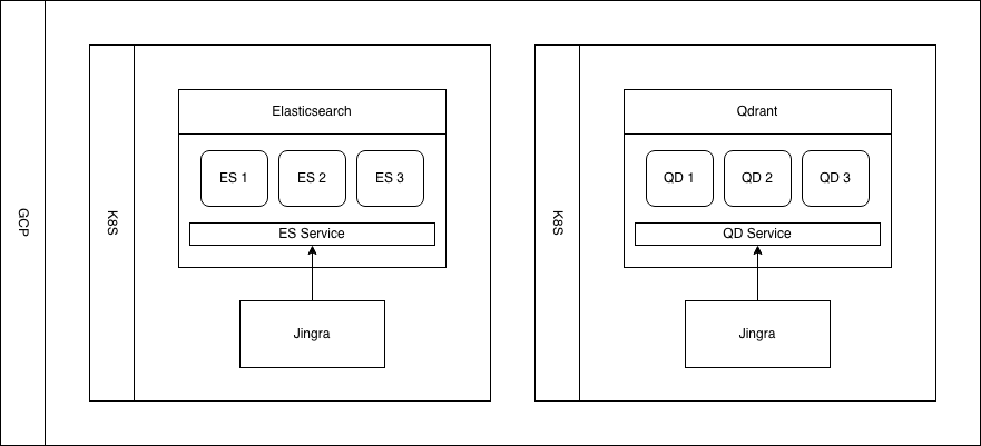

Cluster setup and DiskBBQ configuration
We ran the benchmark on GCP using three n4-standard-8 nodes, with each pod allocated 7 vCPUs and 26 GB of RAM, and using 200 GiB GCP Hyperdisk Balanced volumes at baseline performance allocation. The corpus contains 21 million vectors, (see dataset section below for more details and download links), which account for about 60.1 GiB of raw float vector data. With 2-bit quantization, the vector payload drops to roughly 3.8 to 4.0 GB. However, the full index footprint is much larger once graph and other index structures are included. That means the workload remains meaningfully sensitive to network-attached storage performance, especially because exact vector values still need to be read from disk during rescoring.
We chose this node size intentionally to keep the benchmark in a regime where network-attached persistent storage remains on the query path rather than allowing the full working set to remain comfortably memory-resident. Each system was therefore configured using the best-performing setup we identified for this workload within the tuning scope described in this post. In Elasticsearch, this meant bbq_disk. In Qdrant, the original vectors were stored on disk, while the 2-bit quantized representation used for approximate search was kept in RAM with always_ram: true. Because the two systems expose different search strategies and tuning controls, we compare them at matched recall rather than trying to map parameters one to one.
Elasticsearch was configured to use DiskBBQ, its disk-optimized approach for approximate nearest neighbor vector search, with 2-bit quantization. DiskBBQ uses aggressive quantization to keep the searchable index compact and then rescores with the original vectors to preserve accuracy. This helps maintain strong recall while keeping disk-based search efficient.
bbq_disk is an Elasticsearch Enterprise feature. We used it here because the goal of this benchmark was to compare the strongest disk-oriented vector search configuration available in each engine for this workload, rather than licensing tiers or default features.
We didn’t include bbq_hnsw in this comparison because the benchmark was specifically designed to evaluate disk-oriented vector search under a disk-sensitive workload.
This storage topology matters because Qdrant’s rescore step reads the original float32 vectors from disk with random access on each query. On local NVMe, those reads are much faster, and Qdrant correspondingly performs better. On network-attached persistent storage, the results are consistent with that random-read rescore path becoming a more important bottleneck. Qdrant latency rises sharply as hnsw_ef increases, while Elasticsearch remains comparatively flat across the same recall progression.
We chose 2-bit quantization because Qdrant couldn’t reach the target recall range with 1-bit binary quantization. Since the two systems expose different disk-oriented vector search strategies, we tuned each one to the strongest configuration available within its current feature set.
Both systems were configured with three shards distributed across the three nodes and with two total copies of each shard in the cluster. In Elasticsearch, number_of_shards: 3 and number_of_replicas: 1 means one primary plus one replica, for two total copies. In Qdrant, shard_number: 3 and replication_factor: 2 also means two total copies, since Qdrant’s replication factor refers to the total number of copies rather than the number of additional replicas. So although the field names differ, the effective replication level was the same in both systems.

Figure 1: Diagram of the setup of the clusters.
