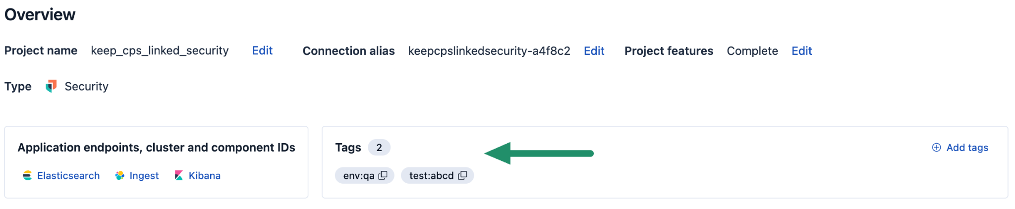

Each Serverless project has a set of key-value pairs associated with it, allowing you to categorize and organize your projects. These are called project tags. There are two types of tags:
  • Prebuilt tags: Predefined tags that exist for every project and are generated automatically; for example, _alias, _id, _type, corresponding to the project alias, project ID, and project type. Predefined tag names always begin with an underscore.
  • Custom tags: User-defined tags; they can have any name that begins with a letter and can contain lowercase letters, numbers, underscores, and hyphens. For example, you could have the tag env:qa for your QA environment projects and env:production for your production environment.
In the Elastic Cloud console, you can manage project tags in the “Manage project” screen:
