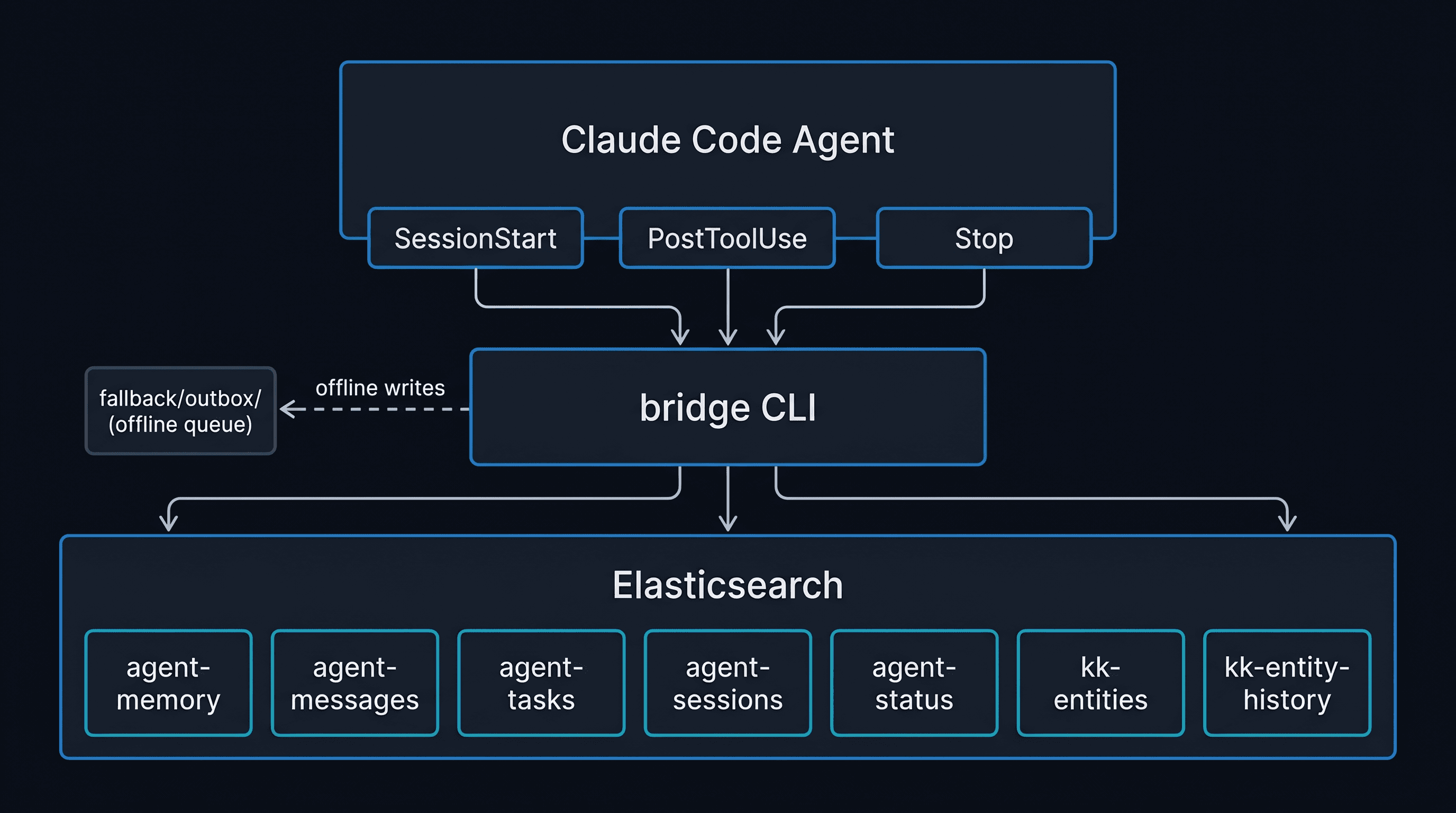

agent-memory is the layer that makes Elasticsearch useful as agent memory specifically for Claude Code. The entry point is a CLI called bridge. Seven Elasticsearch indices sit behind it.
Here's how the pieces fit together:
The Claude Code agent communicates with Elasticsearch entirely through the bridge CLI. Three hooks wire bridge into the agent lifecycle automatically; no explicit calls required from the agent. When Elasticsearch is reachable, bridge writes directly. When offline, writes go to a local fallback/outbox/ queue as JSON files, which bridge sync flushes via bulk API on the next online session.
Behind bridge, Elasticsearch holds seven indices: agent-memory (decisions, patterns, context), agent-messages (inter-agent communication), agent-tasks (task lifecycle), agent-sessions (action history), agent-status (heartbeats), {agent}-entities (the markdown knowledge graph), and {agent}-entity-history (temporal snapshots for diffs). The bridge graph commands (search, related, check-blockers, semantic-diff, and gen-handoff, reconcile) operate against the entity indices.

Hook integration
The integration point is the hooks. Three Claude Code hooks wire the system into normal agent behavior without requiring explicit calls:
  • SessionStart: runs bridge sync-memories to sync auto-memory files into Elasticsearch, and bridge heartbeat to register the agent as active.
  • PostToolUse (triggers on Write, Edit, MultiEdit): calls bridge entity index-file on every .md write. Your project files are continuously indexed as you work.
  • Stop: logs a session-end event to agent-sessions.
The result: the agent doesn't have to remember to update memory. It happens automatically. SessionStart sync hashes local memory files and re-indexes only changed ones — unchanged files are skipped. First-session sync (all files new) takes longer than subsequent sessions.
The offline queue
When Elasticsearch is unreachable, writes don't fail. They land in fallback/{agent}/outbox/ as JSON files. bridge sync (called automatically on SessionStart) flushes the queue via bulk API when connectivity returns. You can work offline; nothing is lost. Reads (bridge recall, bridge graph search) fail gracefully with a non-zero exit code when ES is unreachable. No local read cache exists. Still, the agent session continues normally with degraded memory. The fallback queue has no automatic size limit. For extended offline periods, sync with bridge sync --batch-size 100 to avoid oversized bulk requests.

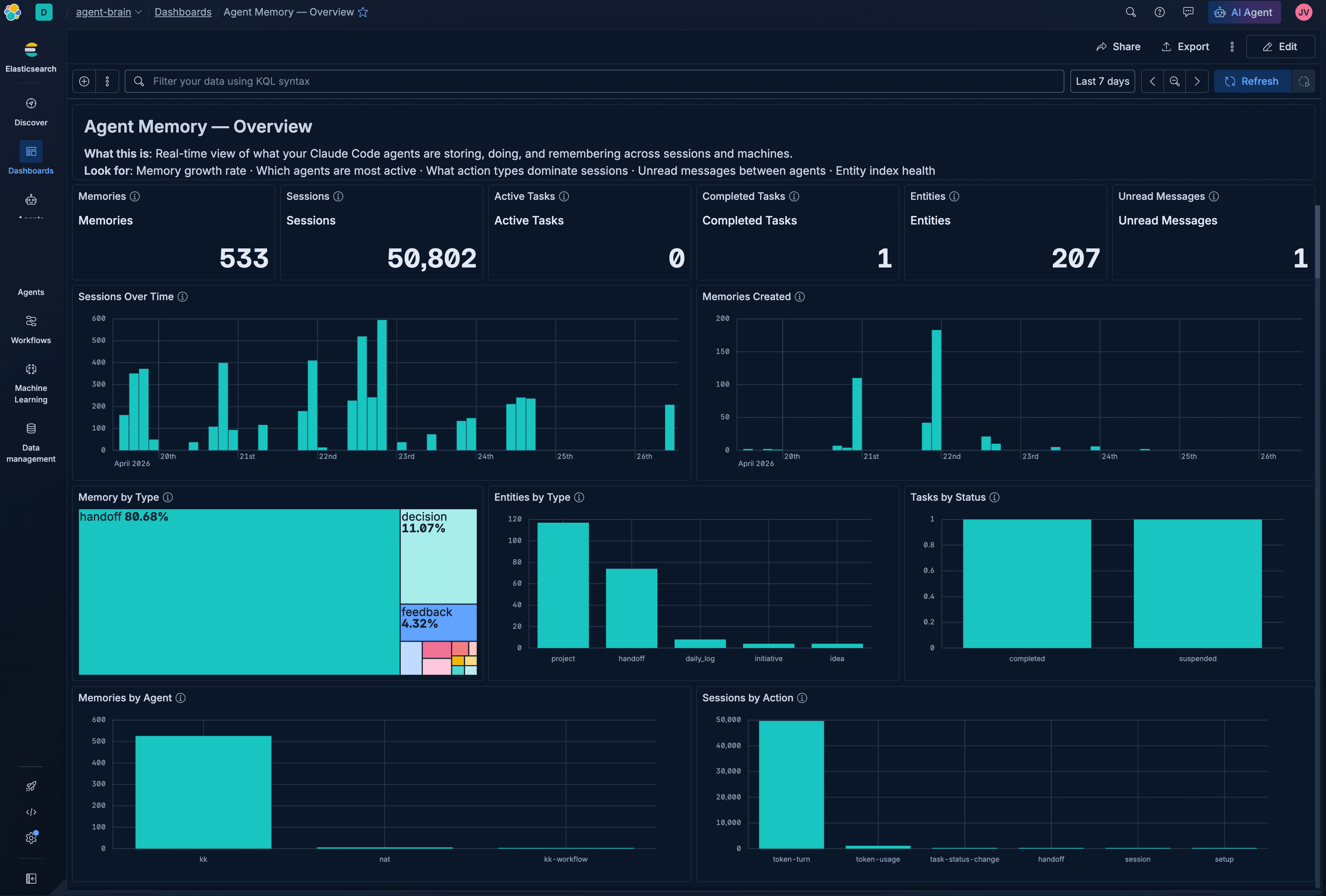

The numbers from a running instance: every project, decision, and blocked dependency tracked across sessions; roughly 1,364 relationship edges parsed from frontmatter fields (initiative, blocked_by, depends_on). These are real figures from a Kuchi Kopi agent instance that's been running across two laptops for several months.
To be clear upfront: this is not a graph database. Traversal is capped at depth 2, there's no Cypher query language or property graph model, and coherence depends entirely on consistent frontmatter. What it is: a queryable entity layer with enough relationship data to surface blockers and diffs across your agent's work.
What this index holds is a record of the agent's own work over time (decisions, project state, and blocked dependencies), not a curated knowledge base of external facts or world knowledge. Retrieval is by embedding similarity and BM25 over that working record.
