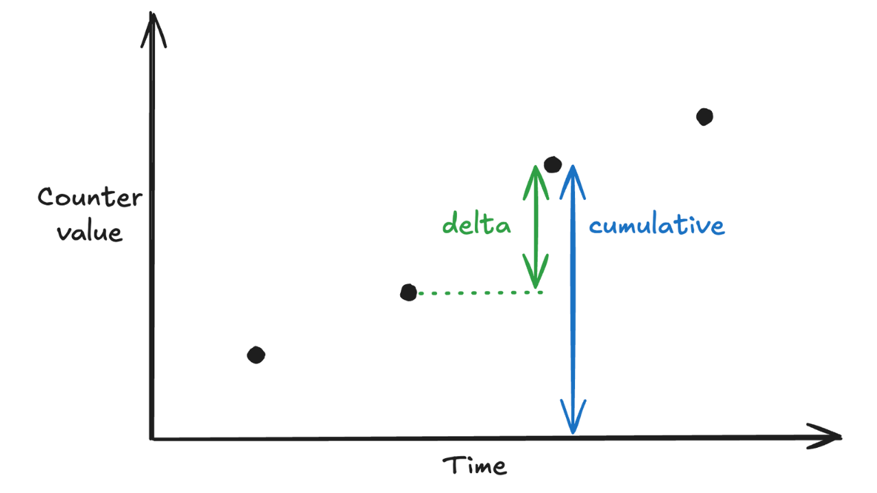

Cumulative temporality in OTel metrics
With cumulative temporality, each data point represents the total amount of change in the metric value since the process started. Values monotonically increase, with occasional reset to 0 (for example, when the process restarts).

Delta temporality in OTel metrics
With delta temporality, each data point represents the change since the last measurement. Values are independent of each other. In other words, after each export, the OTel SDK resets all values for all series.

To compute the rate or increase, we can use the value directly, without any subtraction.

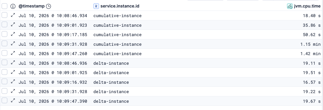

Let's query the first few raw data points of jvm.cpu.time for both instances to see the different temporalities in action:
After starting the demo with `docker compose up --build`, both instances will start reporting metrics to Elasticsearch.
Querying OTel counter metrics with ES|QL and PromQL
Let's query the first few raw data points of `jvm.cpu.time` for both instances to see the different temporalities in action:
This gives us the first five data points for each service instance:
The benchmark consumes CPU at a nearly constant rate. This is directly visible based on the delta temporality data: The values are nearly constant between exports. In contrast, the cumulative temporality values grow over time, as they represent the total CPU usage of the benchmark instance.

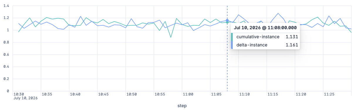

Now let's have a look at how to properly query this metric using PromQL:
PROMQL sum by (service.instance.id) (rate(jvm.cpu.time))
The screenshot shows that both benchmark instances consume a nearly constant of 1 to 1.2 number of CPU cores with some variance. This query works because we made our rate implementation respect the temporality: Every time series (so every service instance in our case) stores the temporality as a metric dimension. The rate implementation looks at this dimension and interprets the data accordingly: For delta temporality, values are summed up; for cumulative temporality, a difference computation is done. This all happens automatically in the background, without requiring any changes to your queries.

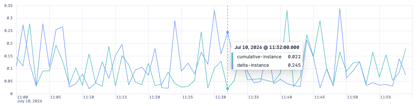

We’ve adapted rate, increase, and irate to work this way. The same applies when using those functions in ES|QL TS queries:
TS metrics-*
| STATS SUM(RATE(jvm.cpu.time)) BY TBUCKET(100), service.instance.id

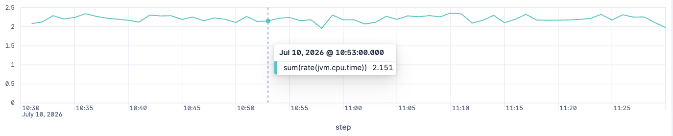

Because Elasticsearch tracks the temporality as a dimension, you can have multiple series with different temporalities for the same metric, just like in the demo use case. Aggregating across series also works as expected, because at that point rate, increase, or irate already took care of normalizing the data:
PROMQL sum(rate(jvm.cpu.time))
PromQL query showing total CPU time aggregated across both instances
