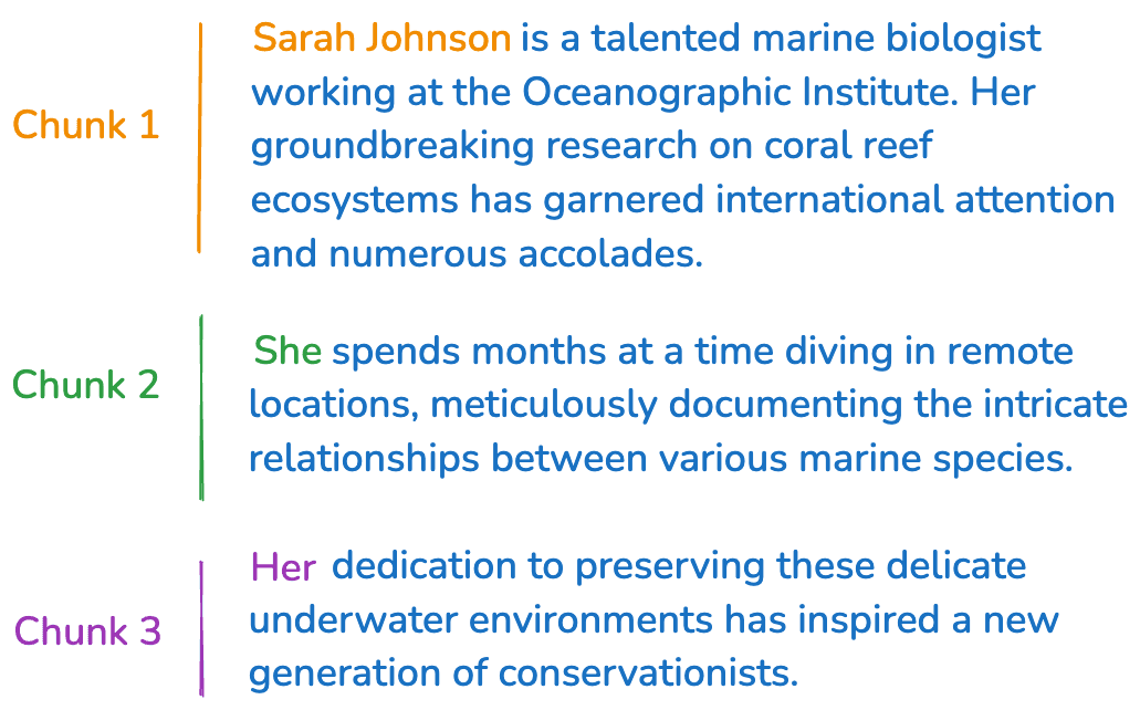

We generally see embedding models with a context length of 512 tokens, which means that if we try to create a longer embedding, only the first 512 tokens will be added to the vector field. The problem with these short contexts is that the chunks will not be aware of the entire context but only the text within the chunks:
As you can see in the image, in Chunk 1 we know we are talking about Sarah Johnson, but in Chunk 2 we lost the direct reference. So, as the document gets longer, it might miss the dependencies to when Sarah Johnson was first mentioned and don’t connect that “Sarah Johnson”, “She”, and “Her” refer to the same person. This of course can get even more complex if there’s more than one person addressed as she/her, but for now let’s see the first way to address this issue.

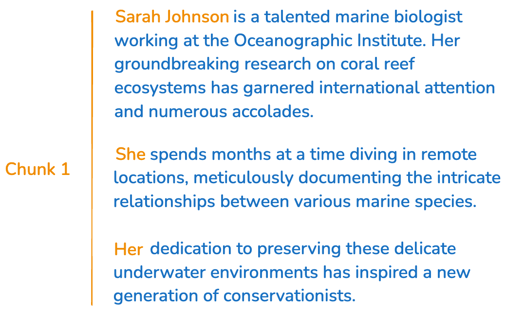

So, let’s see how this works: a longer context length allows us to keep in the same chunk the references to the first time Sarah Johnson was mentioned:

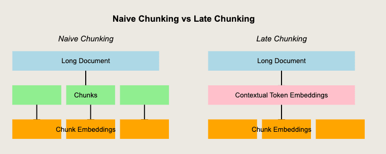

Jina, in an effort to bring together the best of both worlds, proposes an approach called Late Chunking. Late Chunking consists of chunking the text after embeddings, instead of chunking the text first, and then creating the embeddings for each isolated chunk. For this, you need a model capable of creating context-aware embeddings, and then you can chunk the generated embeddings while keeping the context, i.e. dependencies and relations between chunks.
