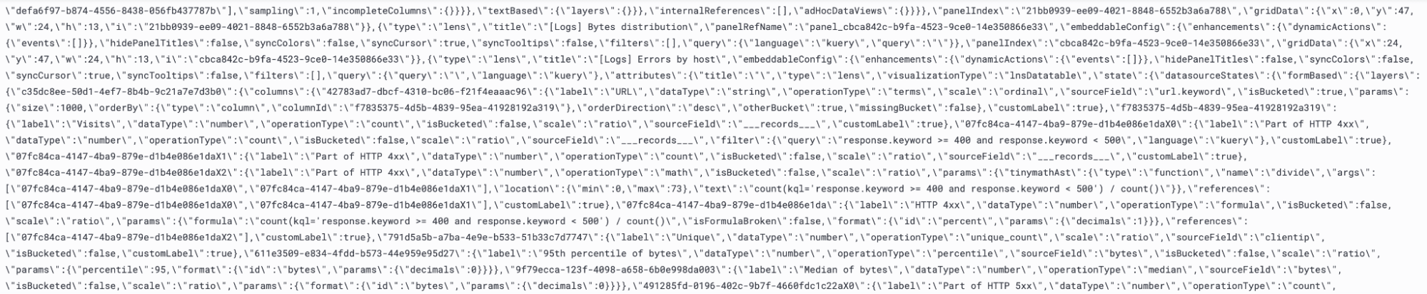

The existing Saved Object API exports dashboards as a single stringified JSON blob: visualization state, internal references, UUIDs, and metadata all tangled together. Changing one field in a Kibana Lens chart means parsing 200 lines of internal state that was never meant to be read. There's no clean way to diff it, review it in a pull request, or edit it programmatically.
That makes standard GitOps workflows impossible: no drift detection, no automated promotion across environments, no rollback to a known-good state without overwriting the whole document by hand.
For large language models (LLMs), it's not easy either. The Saved Object format is too complex and error-prone for language models to generate or modify reliably; a simpler, validated schema is a prerequisite for natural-language dashboard authoring, which is exactly how we're using it in the Elastic AI Chat and dashboard skills for third-party tools integration.

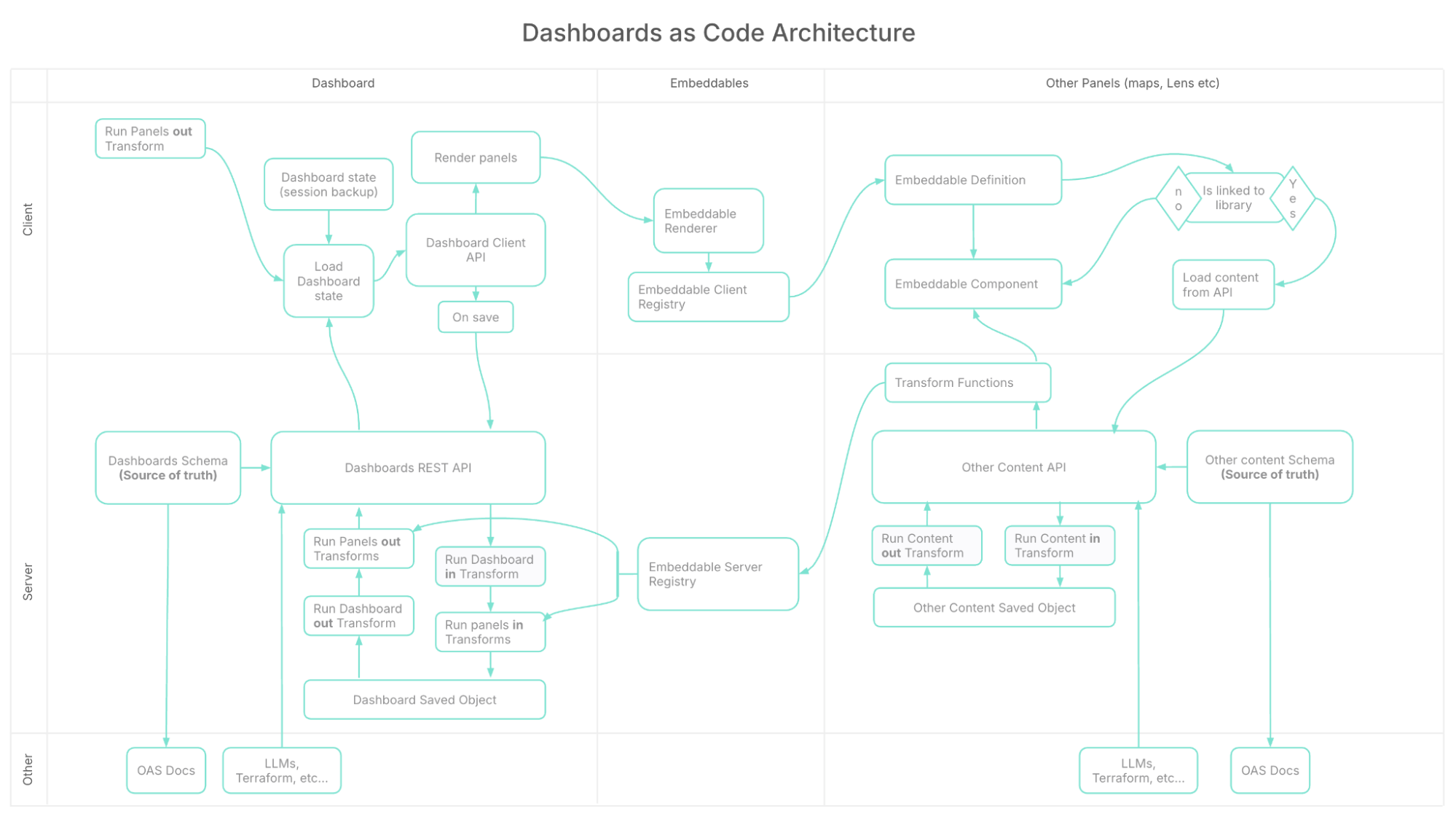

How the Kibana Dashboards API was built: the transforms layer
At the outset of this project, it was quickly discovered that the biggest culprit to the unusability of the Saved Objects APIs was the stringification of the dashboard contents. The dashboard’s entire panels array, for instance, was stored in one key, called “panelsJSON,” which could be thousands upon thousands of characters long, all stuffed into one line. We lovingly dubbed these fields “JSON Bags.”
If we could stop the stringification process for these keys and instead store the JSON directly in Elasticsearch, all of our problems would be solved. Unfortunately, after we de-stringified the JSON and truly saw what was inside, we found a jumbled mess.
Kibana has stored user-created UI content since day one. This content was stored with exactly one purpose in mind: allowing the UI to restore that content later. Because the actual shape of the storage was inconsequential, it was stored in Elasticsearch as a direct snapshot of the UI state. UI state is optimized for the specific UI that created it and is not meant to be looked at. Structures like deep nesting, objects with randomly generated IDs, parallel arrays, and internal references between different portions of the state are helpful in UI state but detrimental to readability.
Here, we faced a choice:
  • Leave the existing UI code in place and build a new alternative API schema for the public endpoints that bypasses the existing dashboard system and allows for some of its most-used functionality.
OR
  • Inject a new API schema into the existing dashboard system and build middleware to allow the same API schema to underpin both the UI and the public endpoints.
We chose the second option and set about the monumental task of crystalizing and redefining every key in every panel of the jumbled mess of existing UI state into something we would be comfortable publishing in a formal API schema. This process was completed over a long time frame, by multiple teams, in live code. Backward compatibility was of utmost importance as, throughout the entire process, dashboards were being saved and loaded by our users every day.

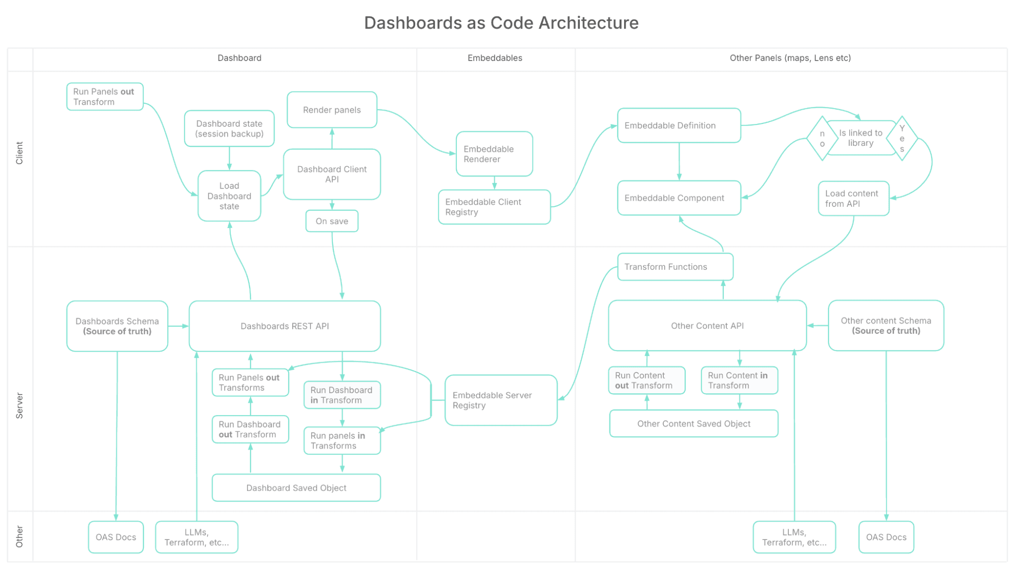

The middleware that made this possible is called the transforms layer; it’s responsible for translating back and forth between the legacy, stringified, state shape and the cleaner API shape. Transform functions are registered for each panel that a dashboard can host. The teams that owned those panels would iteratively improve on the schema and make matching changes to the UI with each PR to ensure that the UI continues to operate correctly.
As each panel registers its transform functions with the dashboard, it also has the ability to register a schema that becomes part of the contract of the public Dashboards API. Schemas registered like this must be fully complete to reduce the risk of breaking changes to the API in the future. If a panel type doesn’t have a schema registered, it will be stripped from public API responses. This allows us to iteratively include more content in the public APIs into tech preview and beyond, while ensuring that users who rely on the API can trust that the shape will not change.

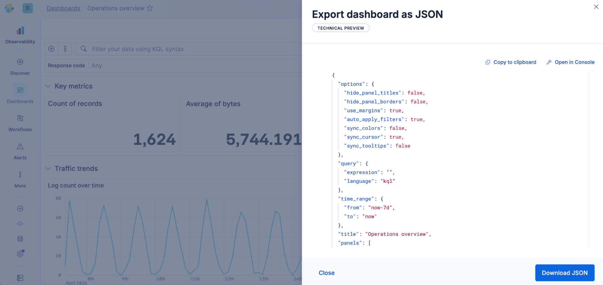

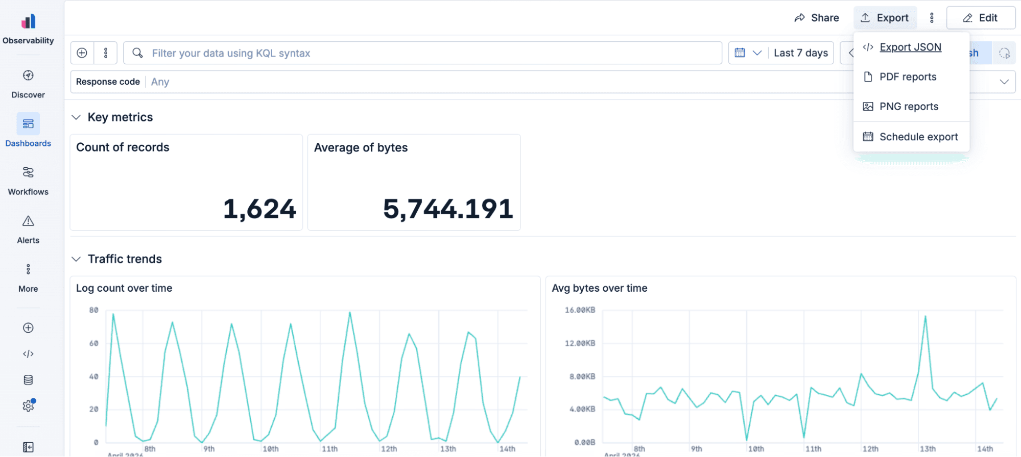

  • Open a dashboard, and click Export JSON from the top menu. This dashboard contains one control and two sections: one with two metrics and another one with two time series.
  • You’ll see the JSON of this dashboard displayed in a flyout. Now click Open in Console.

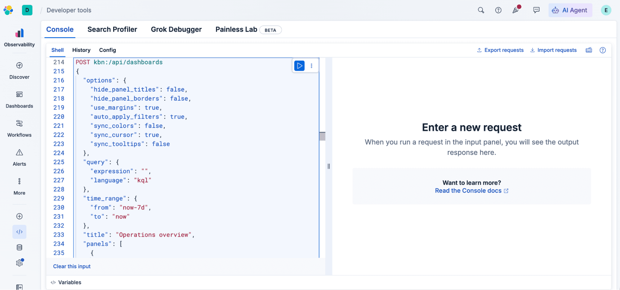

  • You’ll be redirected to the Developer tools, and a new POST request is automatically prefilled for you with the HTTP request.
  • Include the space ID in the POST request URL.

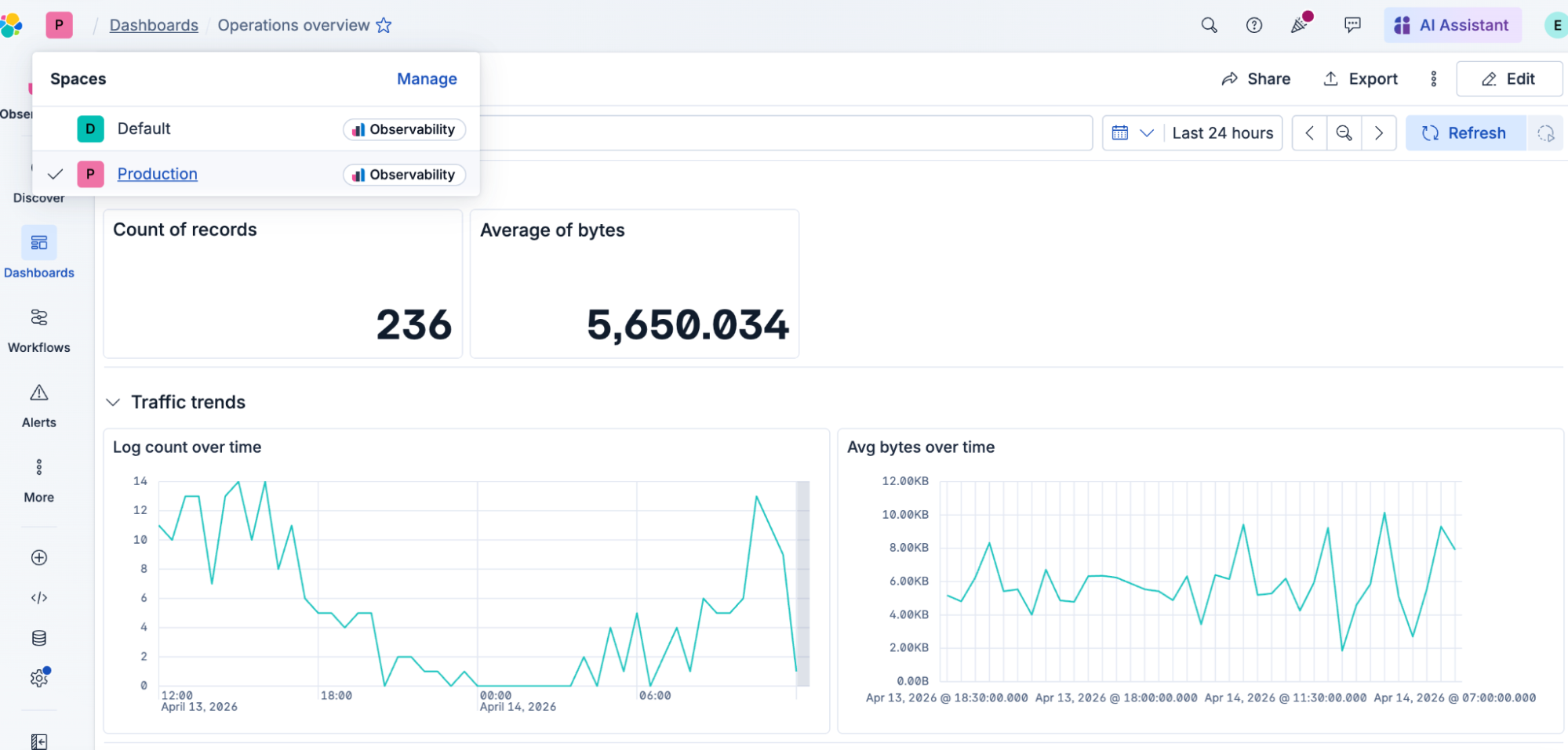

POST kbn:/s/production/api/dashboards?

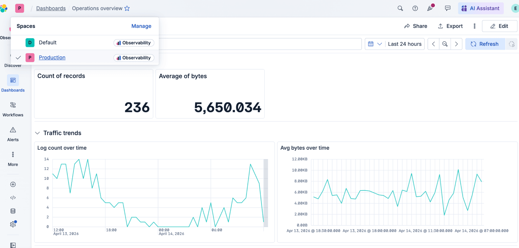

  • Go to the destination space, and see how the dashboard has been created.

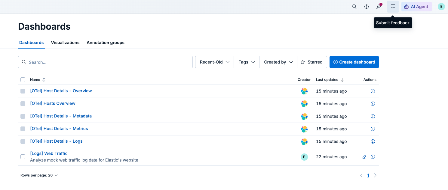

Try it out and let us know what you think. Send your feedback by using the Submit Feedback icon in the top menu, file issues on the Terraform provider GitHub repo, or join the conversation on Discuss. We’re looking forward to hearing from you!
