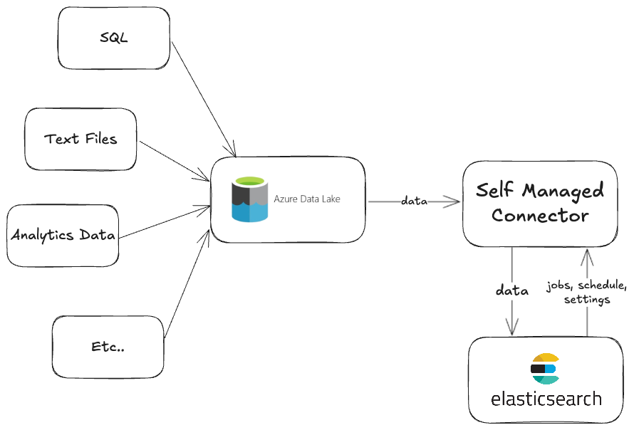

In this article, we'll put to use what we learned in part 1 to create a OneLake custom Elasticsearch connector.
We have already uploaded some OneLake documents and indexed them into Elasticsearch for search. However, this only works with a one time upload. If we want to have synchronized data, then we need to develop a more complex system.
Luckily, Elastic has a connectors framework available to develop custom connectors to fit our needs:

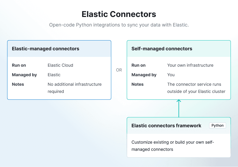

For context, there are two types of Elastic connectors:
Elastic managed connector: Fully managed and run in Elastic Cloud
Self managed connector: Self-managed. Must be hosted in your infrastructure
Custom connectors fall into the “Connector Client” category, so we need to download and deploy the connectors framework.

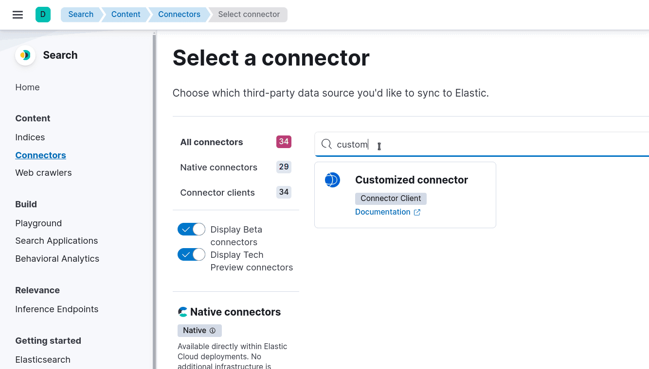

Go to : Search > Content > Connectors > New connector and choose Customized Connector
Choose a name to create, and then select Create and attach an index to create a new index with the same name as the connector.

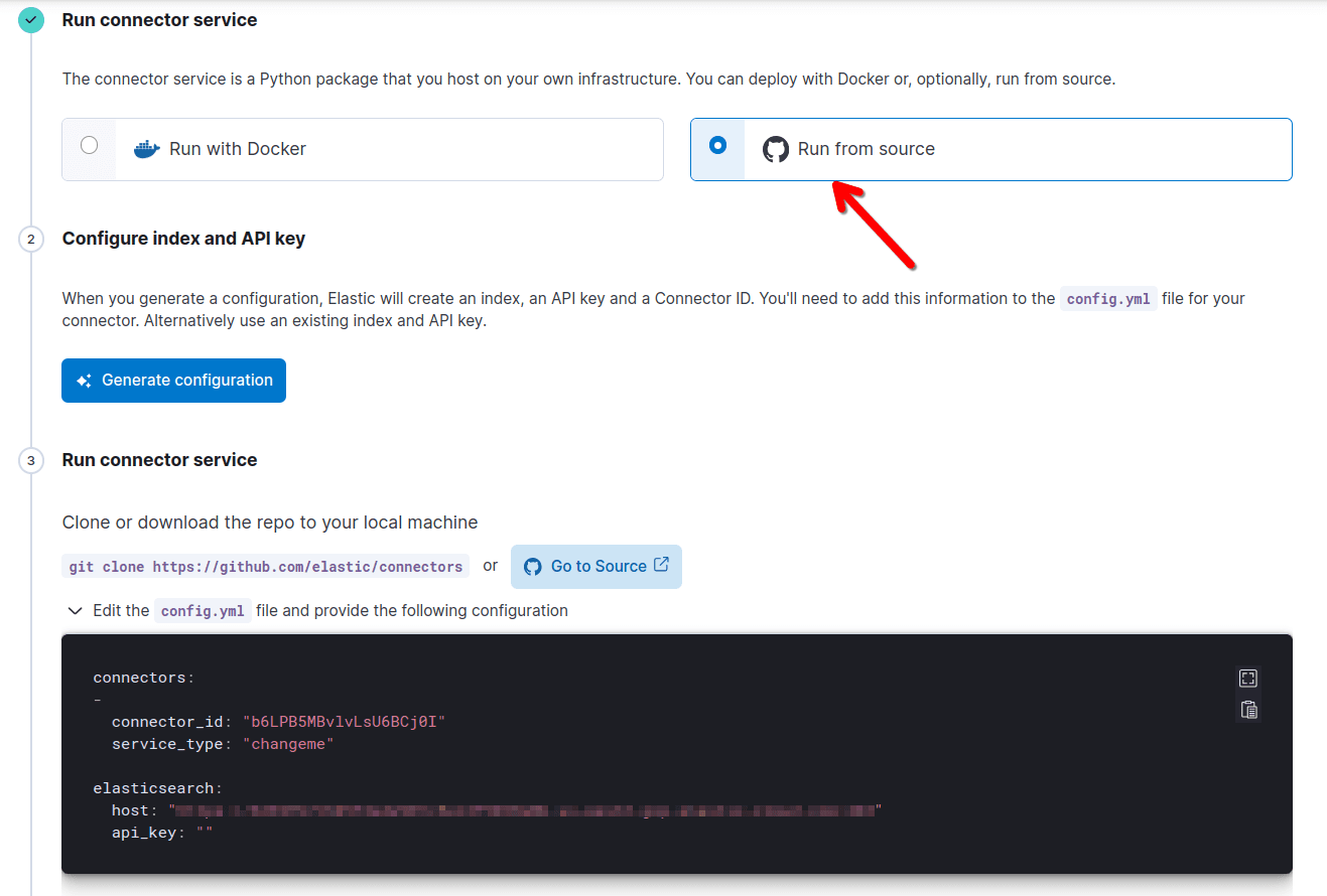

You can now run it using Docker or run it from source. In this example, we'll use "Run from source".
Click on Generate Configuration and paste the content from the box on the file config.yml file at the project's root. On the field service_type you must match the connector's name in connectors/config.py. In this case, replace changeme with onelake.

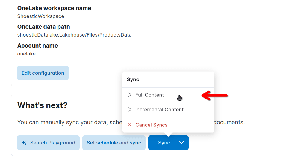

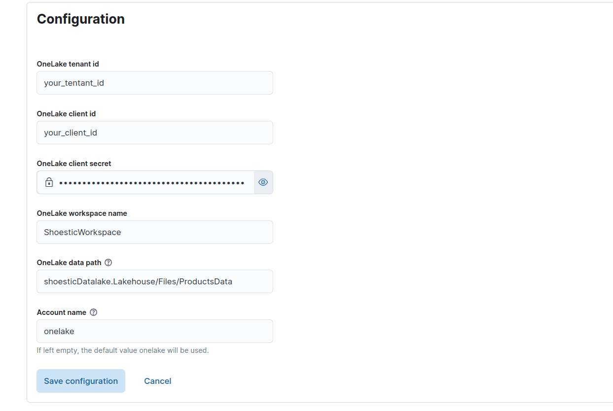

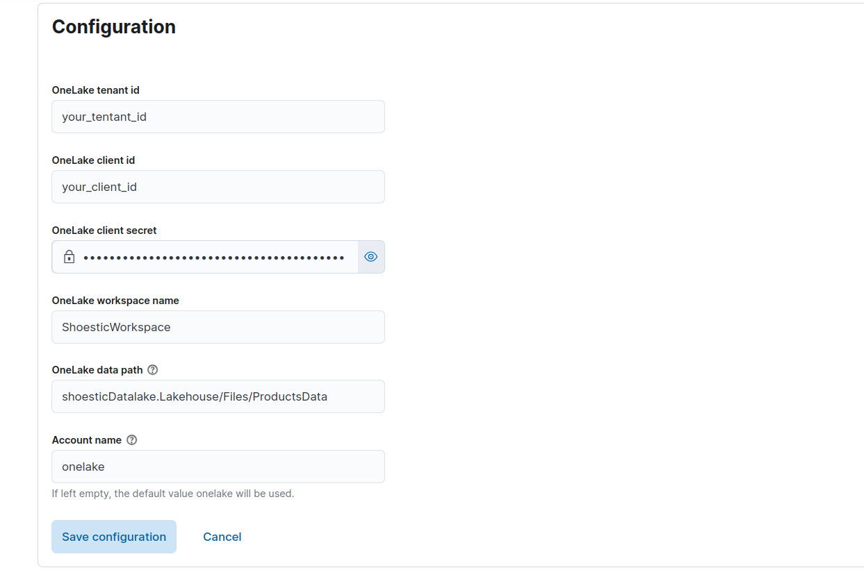

If everything went fine, our local connector will communicate with our Elasticsearch cluster and we'll be able to configure it using our OneLake credentials:
We'll now index the documents from OneLake. To do this, run a Full Content Sync by clicking on Sync > Full Content:
Once the sync is over, you should see this in the console:

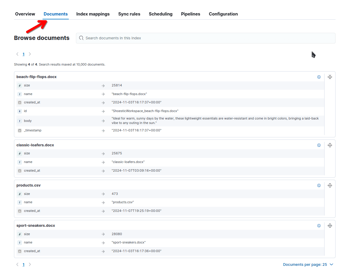

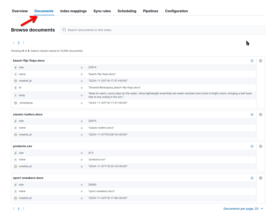

At the Enterprise Search UI, you can click Documents to see the indexed documents:

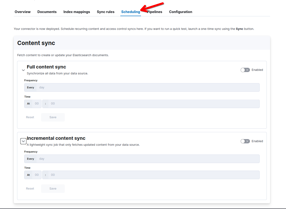

Configure schedule
You can schedule recurring content syncs using the UI based on your needs to keep your index updated and in sync with OneLake.
To configure scheduled syncs go to Search > Content > Connectors and select your connector. Then click on scheduling:
As an alternative, you can use the Update connector scheduling API which allows CRON expressions.
