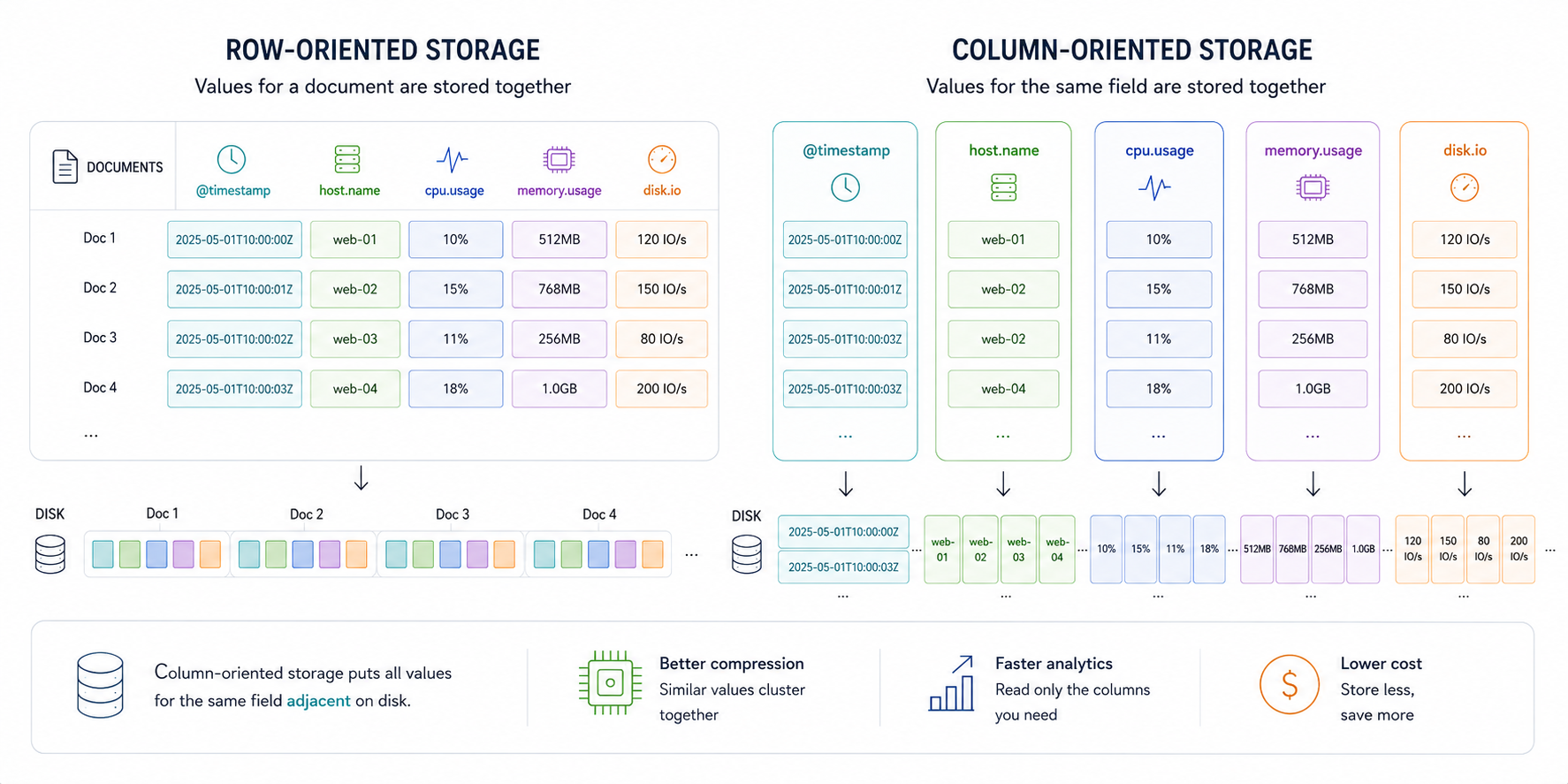

Elasticsearch stores time-series numeric values in doc values: a column-oriented structure where all values for the same field sit adjacent on disk. That adjacency makes compression possible: the codec compares consecutive values of the same field, finds patterns, and exploits them.
Figure 1: Column-oriented storage puts all values for the same field adjacent on disk.

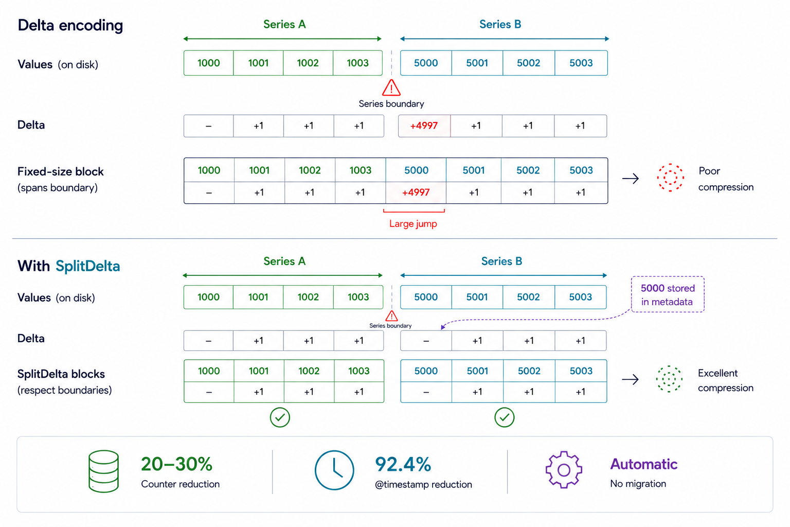

A time-series index is sorted first by its time-series identifier (_tsid constructed by the metric’s dimensions) and then by timestamp within each series. Timestamps on disk aren’t one smooth sequence; there are many smooth sequences laid end to end, one per series, with a large jump at every boundary where one series ends and the next begins.
The codec compresses data in fixed-size blocks without regard to those series boundaries. A block straddling a series boundary holds timestamps from two different series. The jump between them breaks monotonicity, reducing delta encoding effectiveness on blocks spanning different time series. A block that would otherwise compress to near-zero bits per value ended up needing nine or more, because bit-packing encodes every value in a block using the same fixed number of bits, so one large jump sets the cost for all of them.
Figure 2: SplitDelta preserves monotonic sequences by splitting blocks at time-series boundaries.
In the ideal case, every block belongs to a single series: timestamps increase at near-constant intervals, delta encoding captures the regularity, and bit-packing compresses the result to near-zero bits per value. With few series, boundary blocks are rare and the overhead barely registers. On an observability cluster ingesting millions of documents across thousands of series, that changes. The cost scales along two dimensions: series count and data density. More series means more boundary events; sparser series means multiple jumps packed into single blocks. In high-churn environments, both compound, and boundary blocks accumulate into a standing tax on the most-read field in any time-series workload. It’s why @timestamp storage grew faster than the data that produced it.
The fix was to detect series boundaries and treat each run as its own independent sequence. Instead of trying to encode across the jump between two series, which forces every value in the block to pay the storage cost of that one large jump, each run is compressed on its own terms. The boundary simply becomes a seam: the jump is never seen by the encoder on either side.
That encoding is called SplitDelta. @timestamp and monotonic long counters now use it by default. No format change. No migration. Existing segments retain legacy encoding.
On the high-cardinality Elasticsearch Rally benchmark, that single unplanned encoding cut counters storage by 20%–30% and @timestamp storage by 92.4%, from 1.03 GB to 79 MB. Gigabytes to megabytes, and no, that isn’t a typo.
The pluggable pipeline had already paid for itself. SplitDelta, which wasn’t part of the original plan, slotted in without a format change or migration before ALP even shipped.

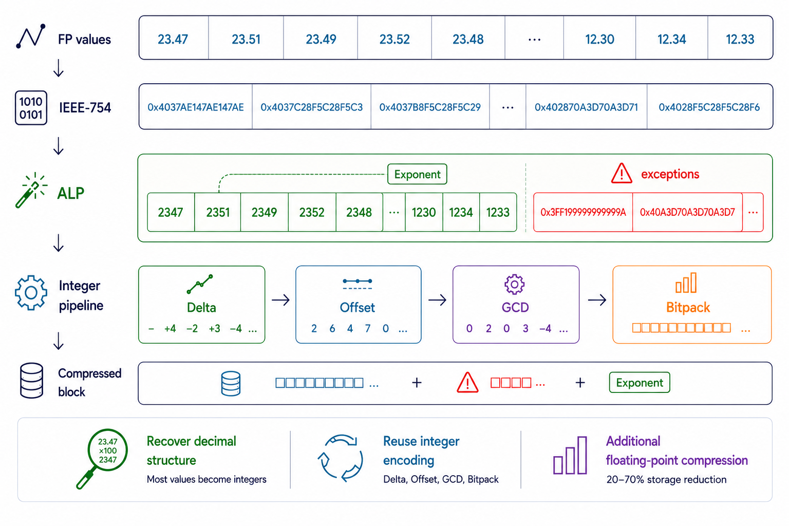

Most floating-point metrics can be expressed as short decimals with no loss of accuracy: CPU utilization at 23.47, load average at 1.15. ALP (Adaptive Lossless floating-Point compression) recovers that decimal structure from the floating-point representation, converting values into integers that the existing pipeline already handles well. ES95 feeds ALP's output into the same mature integer compression pipeline used for timestamps and counters, extracting additional savings rather than treating ALP as a standalone encoding. Values that don’t fit ALP's model (such as irregular high-precision floats or special values) fall back to direct bit-packing or the original representation without degrading the rest of the block.
Figure 3: ALP recovers decimal structure from floating-point values so they can be compressed as integers.
ALP lets Elasticsearch treat floating-point metrics according to the structure they actually contain rather than the binary representation they happen to use. It’s applied automatically to double-valued gauge fields, selected by field type and metric role, through exactly the door the architecture had built for it.
