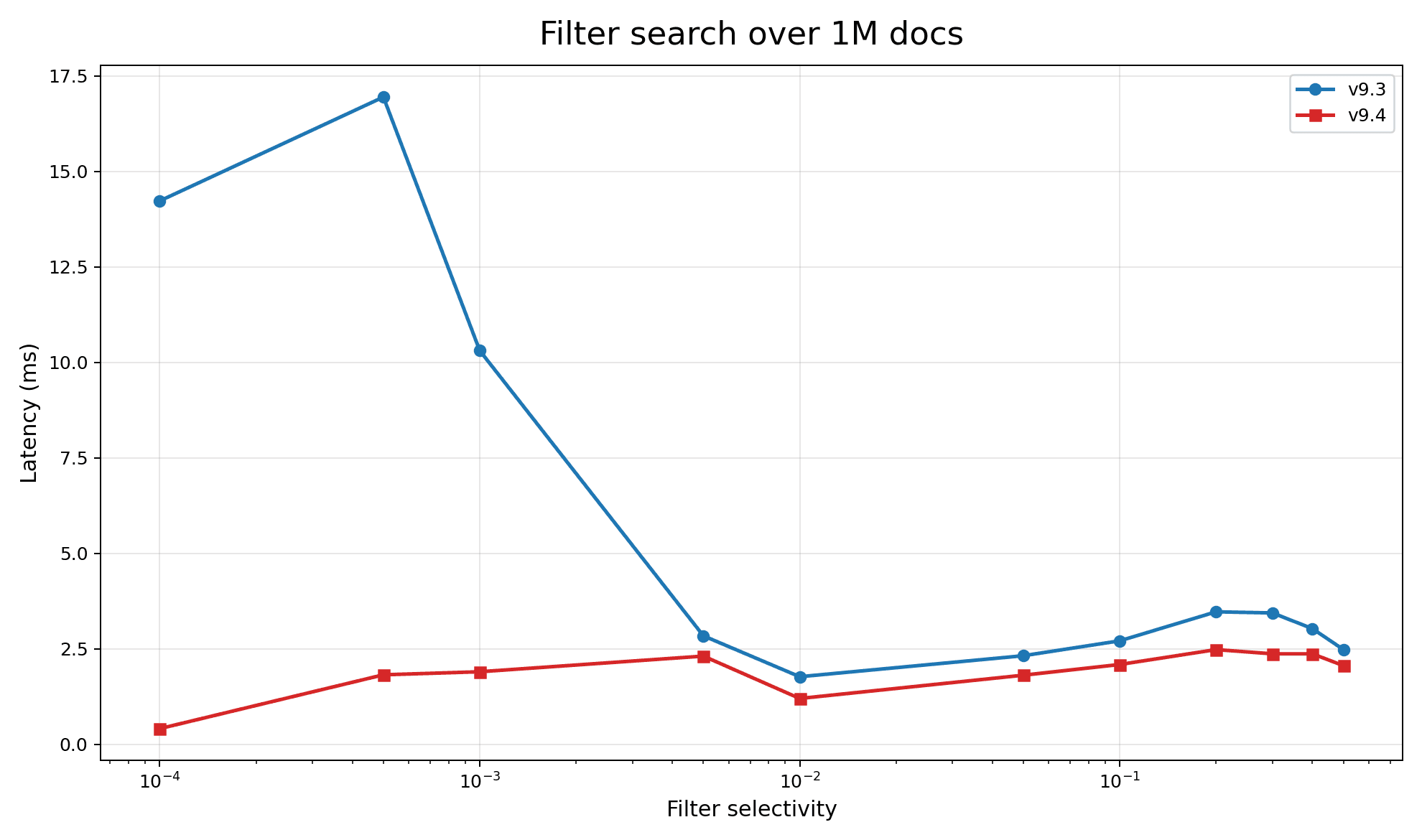

Here’s a macro-benchmark with a random filter. The filter selectivity is purposefully extreme to show the significant improvement on hyper-restrictive filters. Here we see almost an order-of-magnitude improvement. Where before, when filters got very restrictive, there would be a horrible elbow. Now latency remains consistent and will in fact improve as filters get more restrictive.

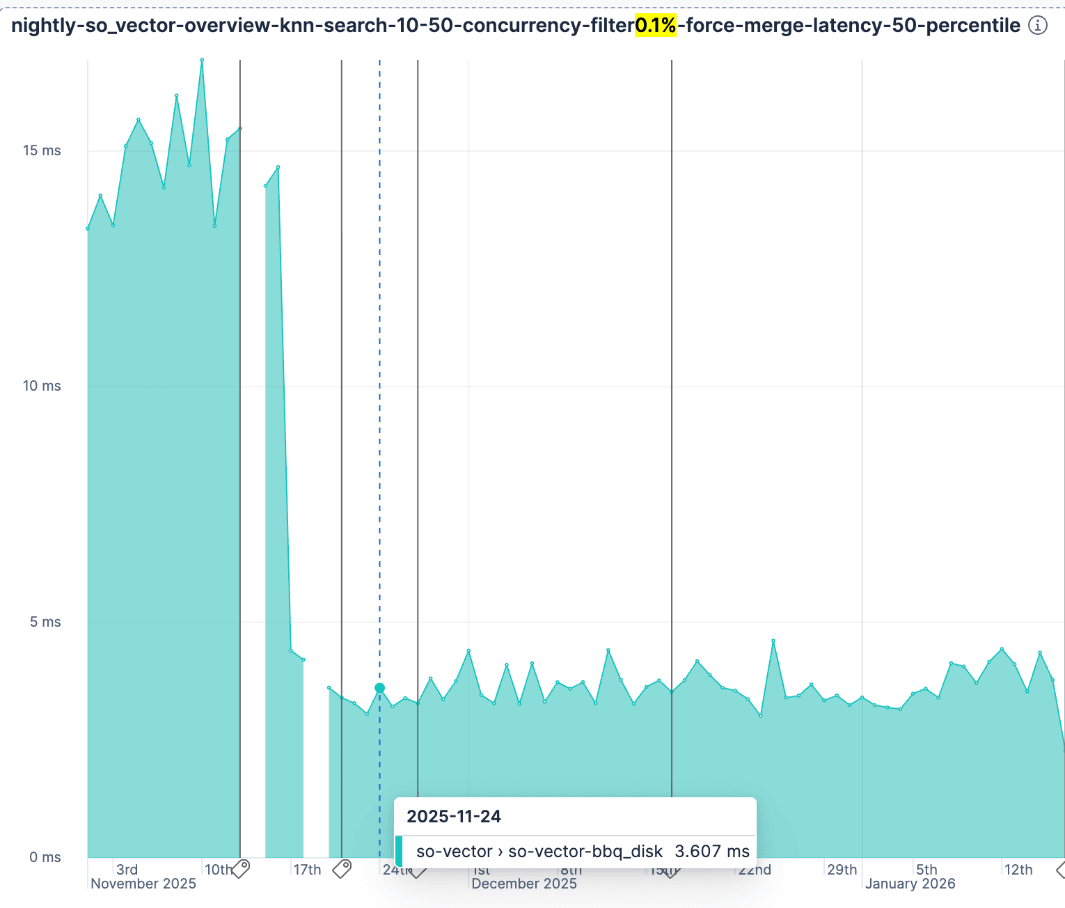

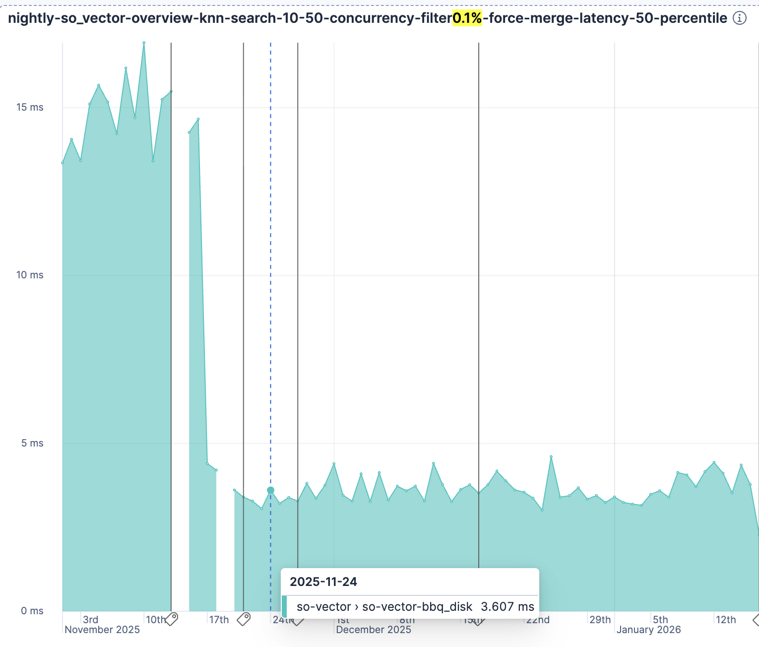

A further validation is our nightly runs of so-vector with rally showing the improvement. You can try this yourself by specifying bbq_disk in the vector_index_type in the rally configuration.
