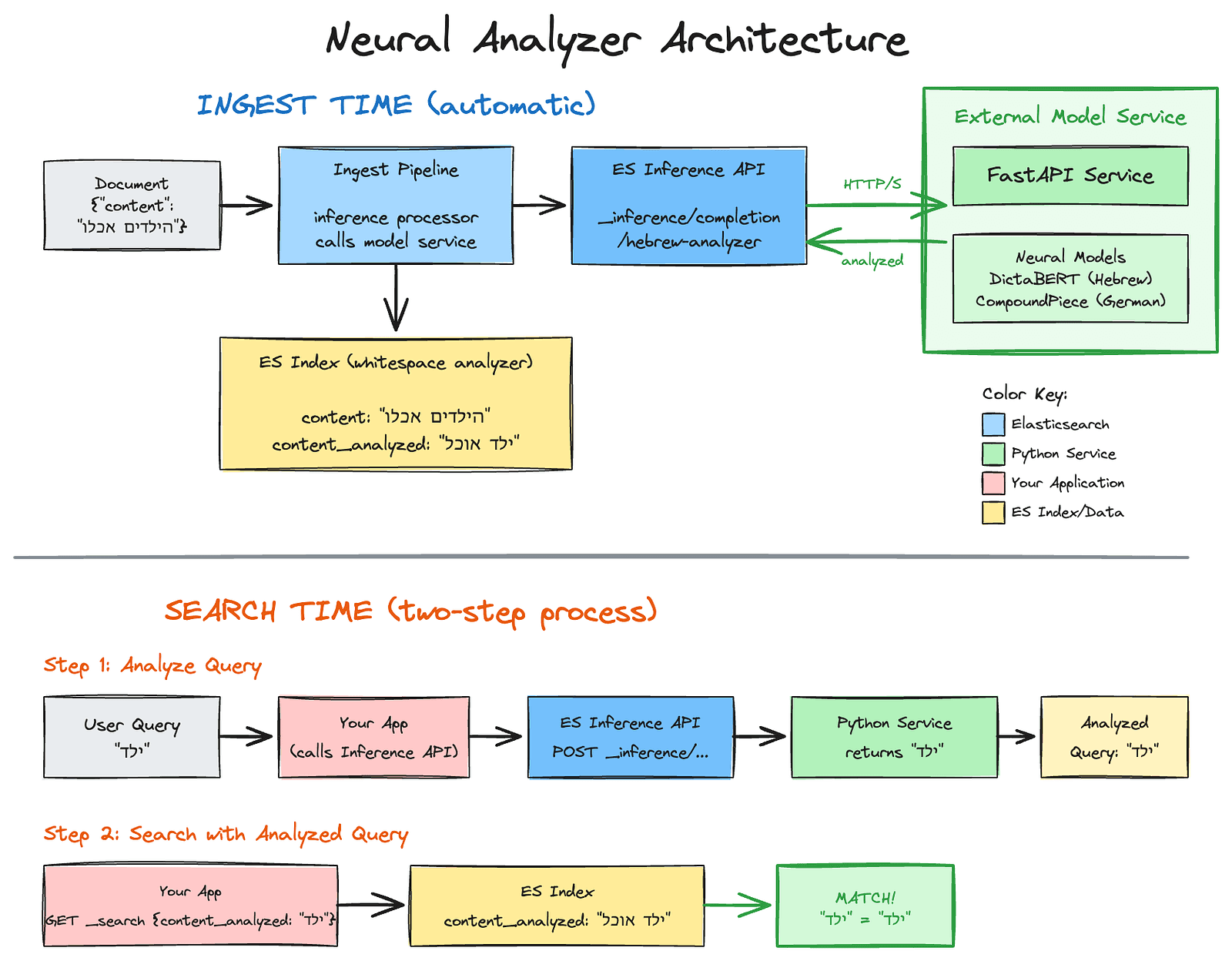

Architecture: The inference sidecar
We can integrate these Python-based models directly into the Elasticsearch ingestion pipeline using the inference API.
The pattern:
  1. External model service: A simple Python service (for example, FastAPI) hosts the model.
  2. Elasticsearch inference API: Defines this service as a custom model within Elasticsearch.
  3. Ingest pipeline: Sends text to the inference processor, which calls your Python service.
  4. Index mapping: Create a whitespace target field for the analyzed text.
  5. Indexing: The service returns the cleaned text, which Elasticsearch stores in the target field.
  6. Search: Queries are analyzed via the inference API before matching.

Search using a neural analyzer in Elasticsearch is a two-step process, so analyze the query first using the inference API, and then search with the result:
A. Analyze the query.
 POST _inference/completion/hebrew-analyzer
   "input": "הילדים אכלו גלידה בגינה"
B. Search with the result.
 GET /my-hebrew-index/_search
   "query": {
     "match": {
       "content_analyzed": "ילד אוכל גלידה גינה"
In production, wrap these two calls in your application code for a seamless experience.
