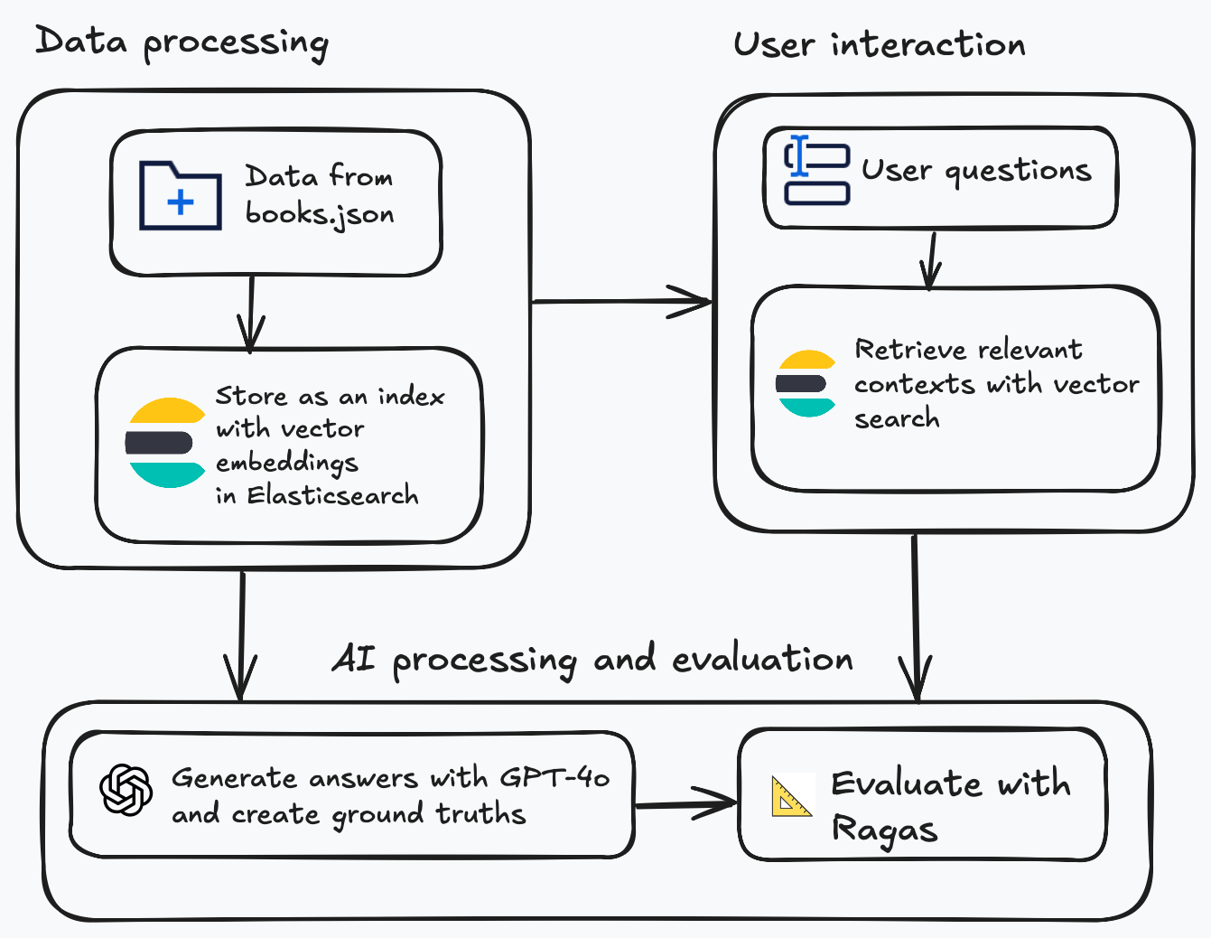

Overview of the solution
The solution, discussed in this blog post, first uploads a dataset from a JSON file into Elasticsearch. The dataset used is books.json, a subset of 25 books from Goodreads, including the book title, the author's name, book description, publication year, and a Goodreads URL.
After the book data is loaded, the next step is to store the index with vector embeddings in Elasticsearch. You can then create evaluation questions and use them to retrieve the relevant context through vector search.
Once the contexts are retrieved for each question, you can generate both answers and ground truths. Ground truths are essentially ideal answers. Using GPT-4o, you can create answers based on the retrieved context, while a separate function will generate ground truths applying scoring logic to rank and select the most relevant books from the retrieved results, generating recommendations that can serve as the evaluation benchmark. Basically, attempting to figure out what you are really looking for, trying to find a response that is the best match, and explaining to you the reason why.
Finally, you'll evaluate performance by comparing the generated answers against the ground truths using Ragas metrics and viewing the results.

Finally, you are now ready to run the demo. This function is similar to a main function, where it ties all the other functions together to generate an evaluation. First, you will define some demo questions to evaluate the RAG application. After that, you can initialize the lists and loop through each question. After looping through each question, you want to generate an answer using the retrieved context and create ground truths using the best-matching books. Next, you will collect the data for evaluation and create a dataset for Ragas evaluation. Once the evaluation dataset is created, you can run the evaluation, print the results, and save them to a CSV file.

In LLM applications, scores above 0.8 on these metrics typically show strong performance, but this could differ depending on the dataset, domain, and use case. More information on each metric is available in the documentation.
In the output below, the average faithfulness score is 0.750, indicating that most answers generally remained consistent with the retrieved context. The context_recall average of 0.500 shows that the system retrieved enough information for a complete answer only half the time. Meanwhile, the context_precision average of 0.625 suggests that a fair portion of the generated content directly matched the retrieved context, but there’s still room for improvement.
When you take a look at the individual questions, both Question 0 and Question 3 scored well on both faithfulness and context precision. This shows an alignment between retrieval and generation. Question 1 had strong recall but only moderate precision, which means that some details were likely added beyond the retrieved context. Question 2 scored low on both precision and recall, showing gaps in retrieval and that the generated content drifted away from the provided context.
To improve these results, you could focus on enhancing retrieval quality by experimenting with different embedding models, refining chunking strategies, or applying context engineering to better match user queries. On the generation side, using stricter prompts and other prompt engineering tactics could be helpful in reducing hallucination, and ensuring that evaluation ground truths are tightly aligned with retrieved content will lead to more accurate scoring.
