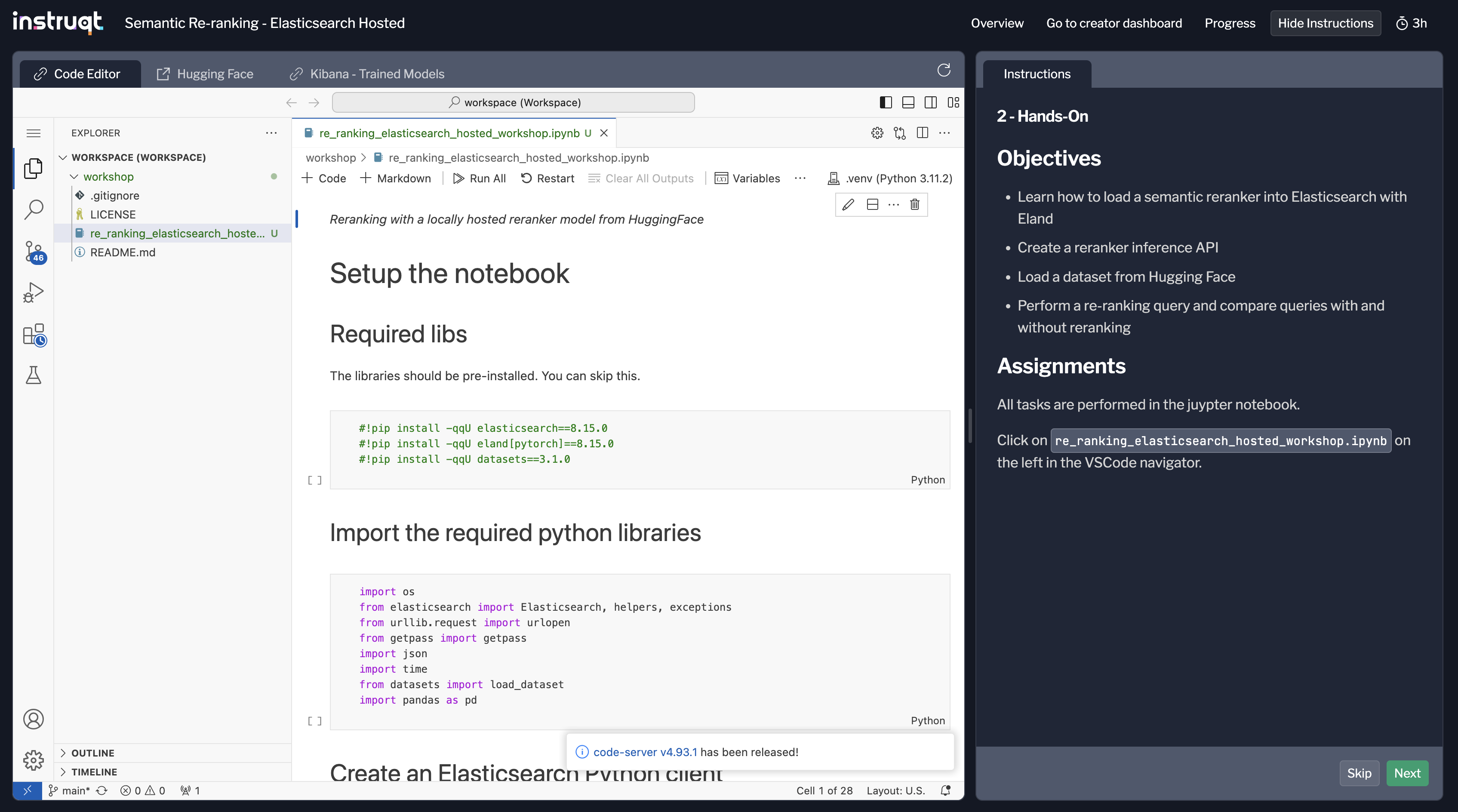

In the notebook, you can follow along to set up your cluster to run the re-ranking query in the next section. The setup steps after downloading the model shown in the notebook are:
  • Create an Inference Endpoint with the rerank task
    • This will also deploy our re-ranking model on Elasticsearch machine learning nodes
  • Create an index mapping
  • Download a dataset from Hugging Face - CShorten/ML-ArXiv-Papers
  • Index the data into Elasticsearch

You can try the accompanying notebook in a live workshop environment for free!
Click here to head over to the lab now.
Try out the accompanying notebook in a live lab environment now.
Click this link to head over to the lab environment!
If you haven't clicked on one of the many links to the accompanying notebook, now's the time!
