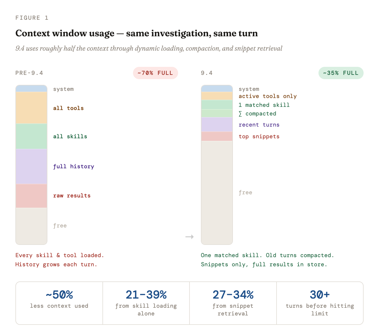

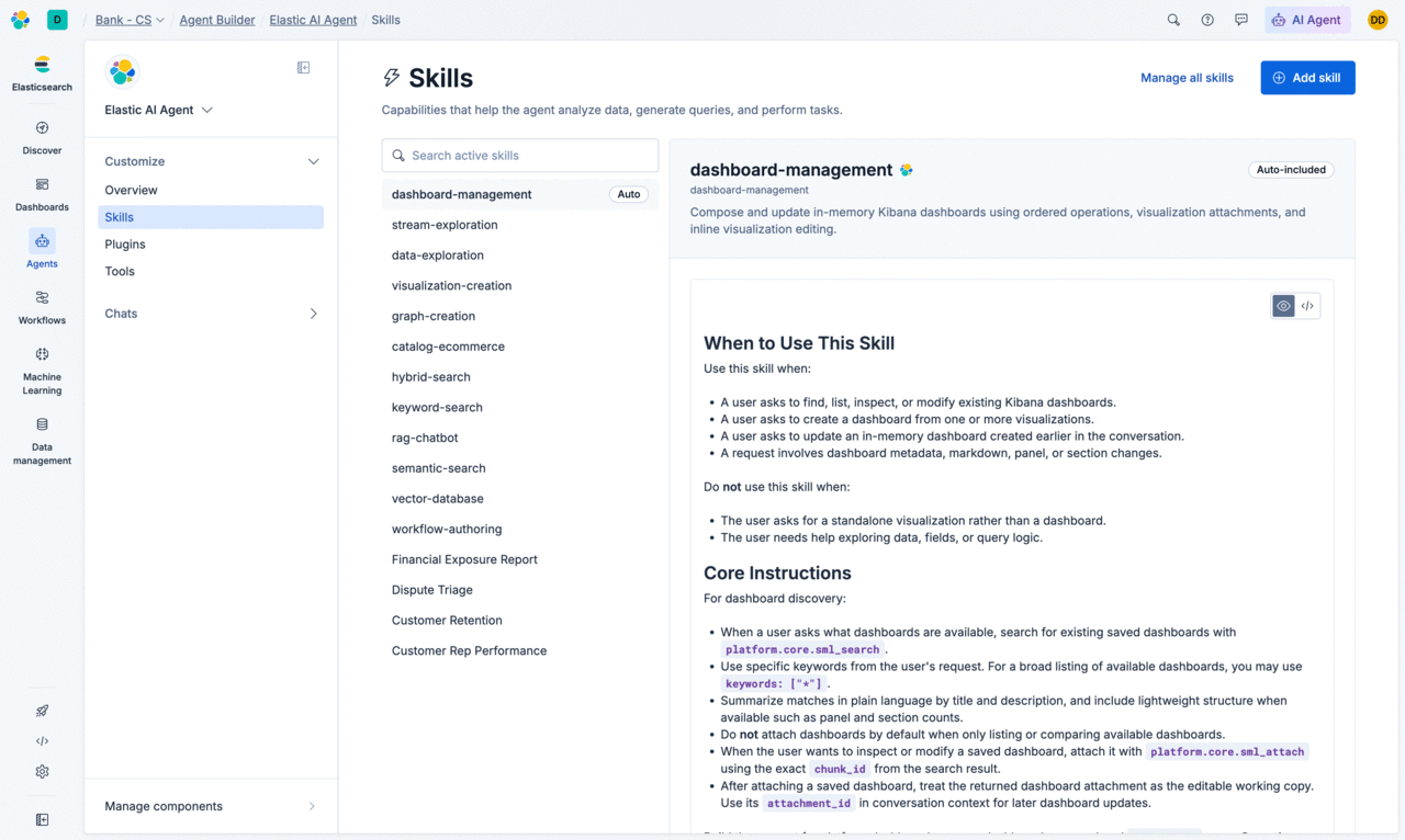

Firstly, prompts get bloated because every instruction has to live in them. Skills fix that by loading on demand and with fewer input tokens. Skills provide structured descriptions of how an agent should operate and act in a specific task. Agent Builder ships with built-in skills for common data analysis patterns, but the real value is that users can also build custom skills. A security team can encode its triage playbook as a skill. An SRE team can describe how they want root cause analysis to proceed. A developer can encode their API design conventions and error handling patterns. Skills are reusable and shareable across agents, which means a pattern that works for one team's deployment doesn't have to be reinvented by the next.
In practice, this looks like: a team lead defines a "Summarize this incident" skill with the process they care about, the severity classification their org uses, and the output format their runbook expects. Anyone on the team invokes it by typing in the chat input and selecting it from autocomplete. Skills follow the Agent Skills open format, so you can pull them from a shared library, write your own, or craft skills using an agent of your choice.
In internal testing, we found that removing instructions from the agent prompt and placing them in dynamically loaded skills showed a 21 to 39% reduction in input token usage across test datasets. The key architectural improvement is that skills and their associated tools are loaded only when the agent needs them. All other skills stay as lightweight stubs with just a name and description, consuming almost no context.

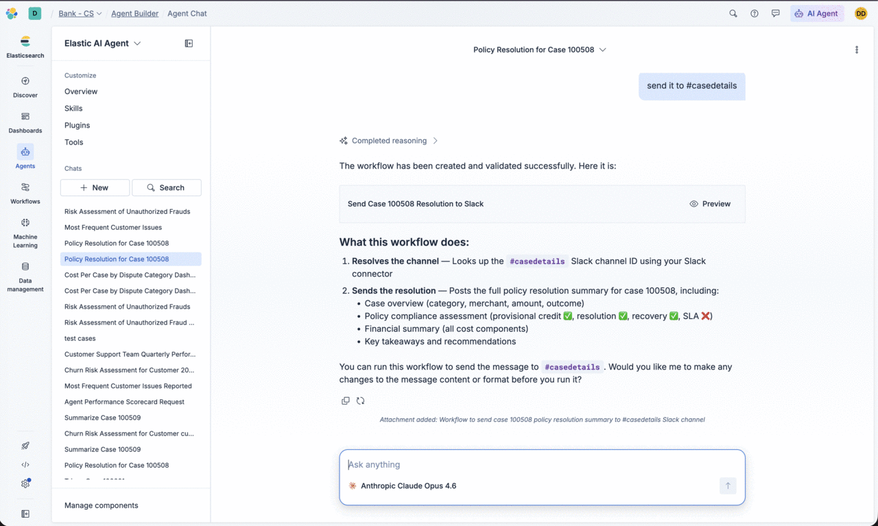

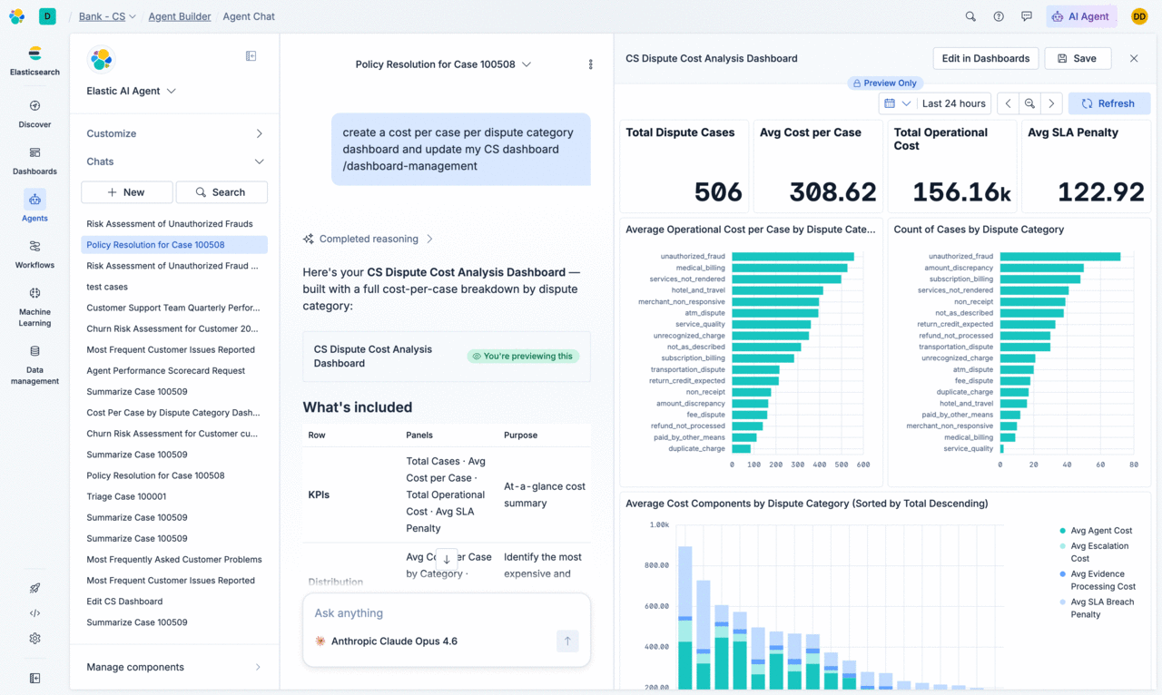

Chat with your data and act on it too (dashboards, workflows, queries and more): Agentic tasks don't stay simple for long. Agent Builder now has contextual awareness of objects in Kibana. With agentic dashboard creation, a user can describe what they want to see in plain language, and the agent generates a dashboard with panels, visualizations, queries, and everything that's needed. Users can refine it conversationally: "break that out by region," "add a filter for the last 7 days," "swap the bar chart for a line chart."
Dashboards, alerts, and rules also work as inputs. Once a dashboard exists, it can be retrieved from the Agent’s context. This unlocks the "act" side of agents. Once a dashboard or alert is in context, the agent can modify it, extend it, or create new ones. The agent can reason about what the data shows, suggest follow-up analyses, or modify the dashboard based on what it sees. It's a feedback loop: the user describes intent, the agent produces a visual artifact, and both the user and the agent can reason over that artifact together.
For business analysts and operations teams, this collapses the gap between "I have a question about the data" and "I have a dashboard I can share with my team," reducing hours of manual work to a few minutes of conversation.

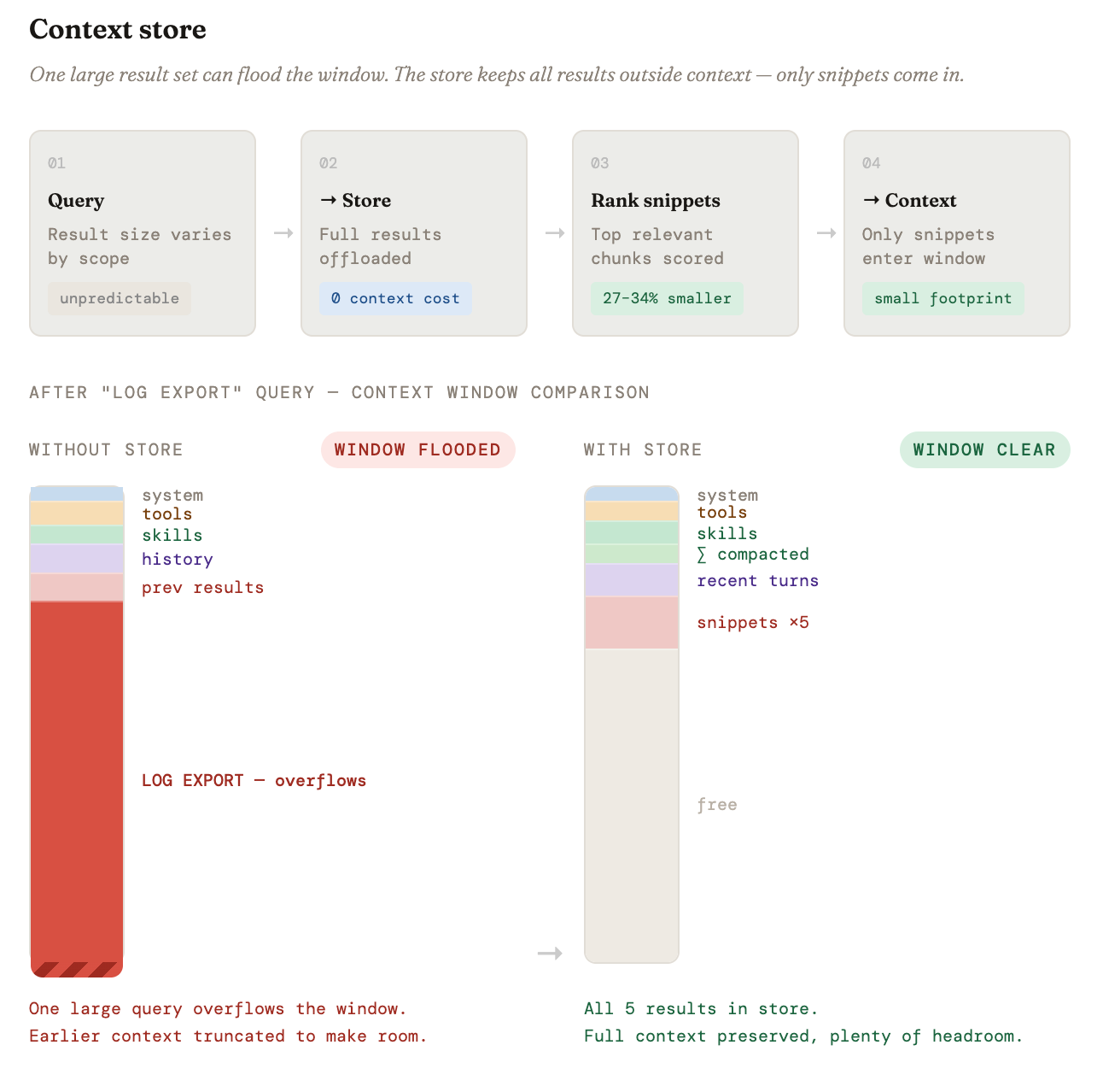

We built a context store for retrieval results. As the agent retrieves data from indexes, the results can grow large and crowd the context window. We introduced a temporary store that holds the results of a query in an in-memory “file store” and only pulls the results into the active context when needed. This allows for conversations to extend and deal with multiple related data sets without blowing out the context. We are also optimizing the retrieval results themselves, applying top snippets retrieval, which demonstrated a 27 to 34% reduction in token usage.

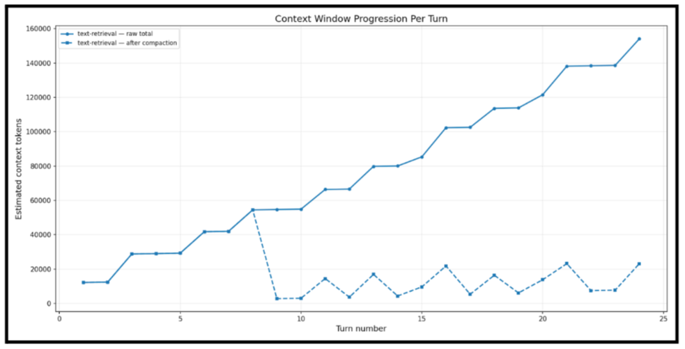

We also added intelligent context compaction for longer interactions: As a conversation progresses, the agent manages what stays in the active context and what gets compressed into a summary that can be retrieved if needed. This isn't a simple truncation; it's selective compaction that preserves the information most likely to matter for the next turn.
This enables agents to handle larger result sets, more complex queries, and longer conversations without the token cost scaling linearly with every turn. With context compaction agents, the context window remains within a limit even for chats with 30 or more turns, rather than quickly ballooning to max size.
