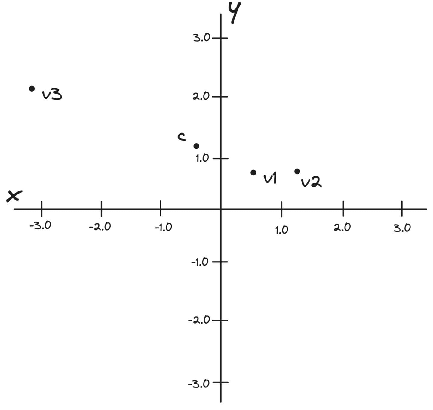

Let's continue with our vectors, v1v_1, v2v_2, and v3v_3. We pick their centroid as the pivot point.
v1=[0.56,0.82]v2=[1.23,0.71]v3=[-3.28,2.13] c=[(0.56+1.23+-3.28)/3,(0.82+0.71+2.13)/3] c=[-0.49,1.22]v_1 = [0.56, 0.82] \newline v_2 = [1.23, 0.71] \newline v_3 = [\text{-}3.28, 2.13] \newline ~\\ c = [(0.56 + 1.23 + \text{-}3.28) / 3, (0.82 + 0.71 + 2.13) / 3] \newline ~\\ c = [\text{-}0.49, 1.22]
Here's all of those points graphed together:
Figure 1: graph of the example vectors and the derived centroid of those three vectors.

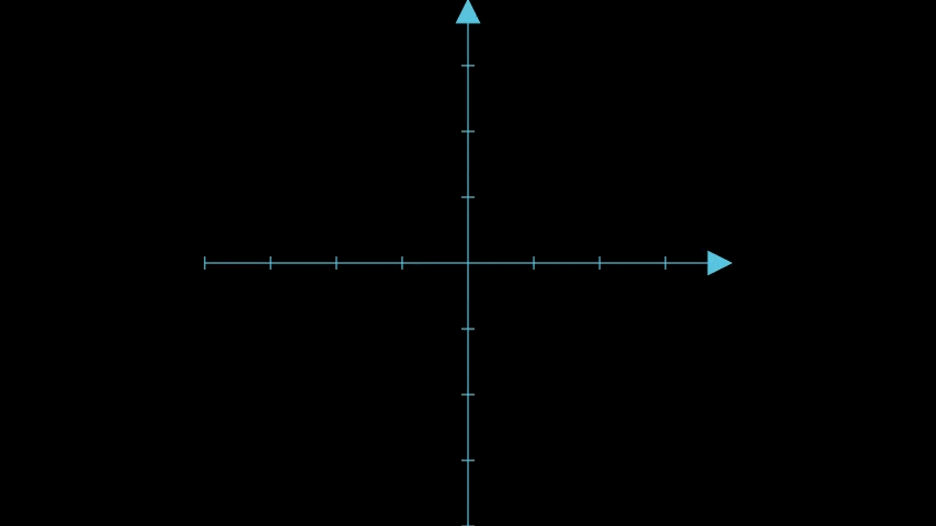

Let's see that transformation and normalization all together:
Figure 2: Animation of the example vectors and the derived centroid transformed within the unit circle.
As you may be able to see our points now sit on the unit circle around the centroid as if we had placed the centroid at 0,0.
