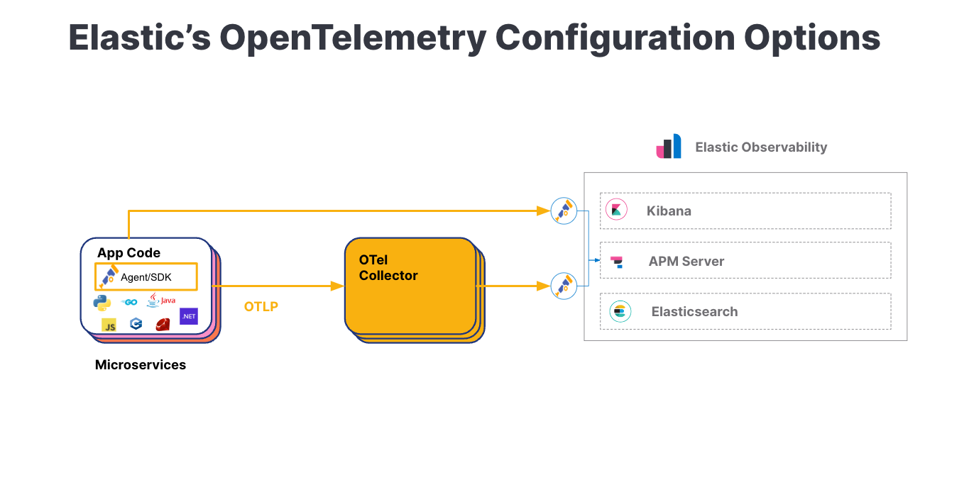

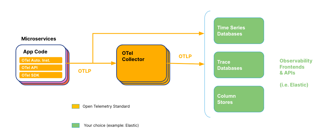

Use the OpenTelemetry Collector or go direct?
When starting out with OpenTelemetry, ingesting and transmitting telemetry data directly to a backend such as Elastic is a good way to get started. Often, you would be using the OTel direct method in the development phase and in a local environment.
However, as you deploy your applications to production, the applications become fully responsible for ingesting and sending telemetry data. The amount of data sent in a local environment or during development would be miniscule compared to a production environment. With millions or even billions of users interacting with your applications, the work of ingesting and sending telemetry data in addition to the core application functions can become resource-intensive. Thus, offloading the collection, processing, and exporting of telemetry data over to a backend such as Elastic using the vendor-agnostic OTel Collector would enable your applications to perform more efficiently, leading to a better customer experience.
Advantages of using the OpenTelemetry Collector
For cloud-native and microservices-based applications, the OpenTelemetry Collector provides the flexibility to handle multiple data formats and, more importantly, offloads the resources required from the application to manage telemetry data. The result: reduced application overhead and ease of management as the telemetry configuration can now be managed in one place.
The OTel Collector is the most common configuration because the OTel Collector is used:
  • To enrich the telemetry data with additional context information — for example, on Kubernetes, the OTel Collector would take the responsibility to enrich all the telemetry with the corresponding K8s pod and node information (labels, pod-name, etc.)
  • To provide uniform and consistent processing or transform telemetry data in a central place (i.e., OTel Collector) rather than take on the burden of syncing configuration across hundreds of services to ensure consistent processing
  • To aggregate metrics across multiple instances of a service, which is only doable on the OTel Collector (not within individual SDKs/agents)
Key features of the OpenTelemetry Collector include:
  • Simple setup: The setup documentation is clear and comprehensive. We also have an example setup using Elastic and the OTel Collector documented from this blog.
  • Flexibility: The OTel Collector offers many configuration options and allows you to easily integrate into your existing observability solution. However, OpenTelemetry’s pre-built distributions allow you to start quickly and build the features that you need. Here as well as below is an example of the code that we used to build our collector for an application running on Kubernetes.

Elastic provides native OTel support. You can directly send OTel telemetry into Elastic Observability without the need for a collector or any sort of processing normally used in the collector.
Here are the configuration options in Elastic for OpenTelemetry:

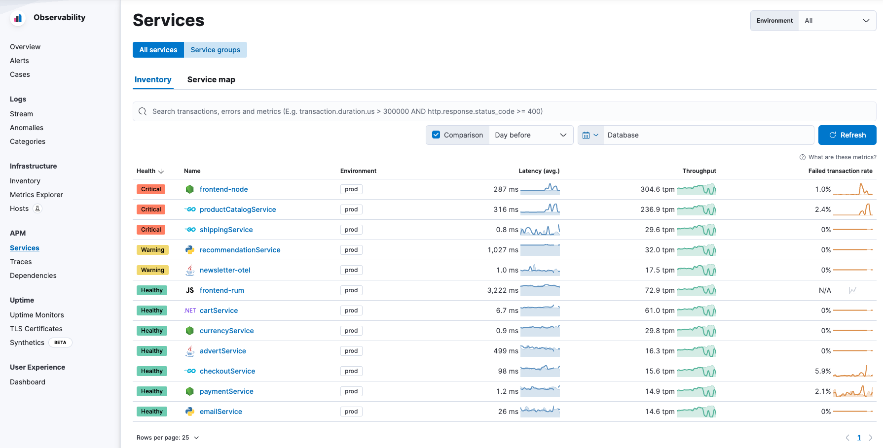

Most of Elastic Observability’s APM capabilities are available with OTel data. Some of these include:
  • Service maps
  • Service details (latency, throughput, failed transactions)
  • Dependencies between services, distributed tracing
  • Transactions (traces)
  • Machine learning (ML) correlations
  • Log correlation
