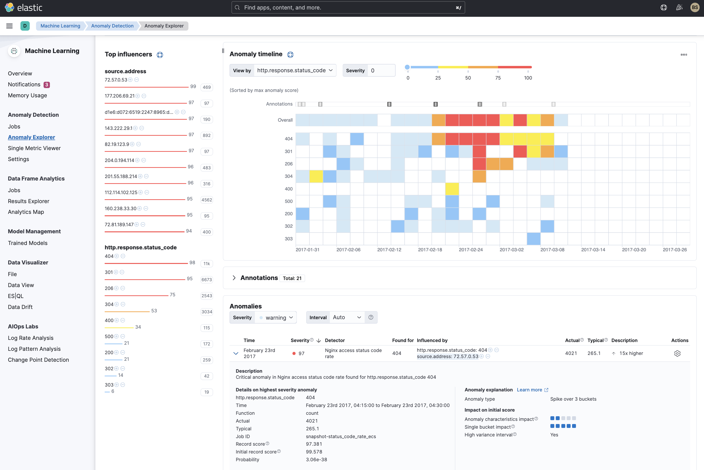

Locating anomalies with ML
While using the AI Assistant is great for analyzing information, another important aspect of NGINX log management is to ensure you can manage log spikes and anomalies. Elastic has a machine learning platform that allows you to develop jobs to analyze specific metrics or multiple metrics to look for anomalies.When using NGINX, there are several out-of-the-box anomaly detection jobs. These work specifically on NGINX access logs.
  • Low_request_rate_nginx - Detect low request rates
  • Source_ip_request_rate_nginx - Detect unusual source IPs - high request rates
  • Source_ip_url_count_nginx - Detect unusual source IPs - high distinct count of URLs
  • Status_code_rate_nginx - Detect unusual status code rates
  • Visitor_rate_nginx - Detect unusual visitor rates
Being right out of the box, lets look at the job - Status_code_rate_nginx, which is related to our previous analysis.
With a few simple clicks we immediately get an analysis showing a specific IP address - 72.57.0.53, having higher than normal non-successful requests. Oddly we also found this is using the AI Assistant.
We can take this further with conversations with the AI Assistant, look at the logs, and/or even look at the other ML anomaly jobs.
