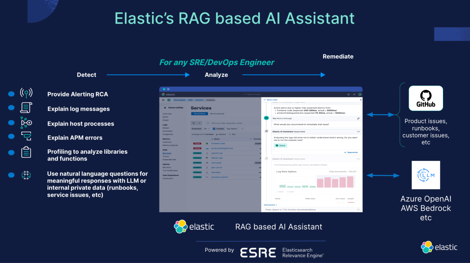

As an SRE, analyzing applications is more complex than ever. Not only do you have to ensure the application is running optimally to ensure great customer experiences, but you must also understand the inner workings in some cases to help troubleshoot. Analyzing issues in a production-based service is a team sport. It takes the SRE, DevOps, development, and support to get to the root cause and potentially remediate. If it's impacting, then it's even worse because there is a race against time. Regardless of the situation, there is a ton of information that needs to be consumed and processed. This includes not only what the customer is experiencing, but also internal data to help provide the most appropriate resolution.
Elastic’s AI Assistant helps improve analysis for SREs, DevOps, Devs, and others. In a single window using natural language questions, you can analyze using not only general information but combine it with things like:
  • Issues from internal GitHub repos, Jira, etc.
  • Documents from internal wiki sites from Confluence, etc.
  • Customer issues from your support service
  • And more

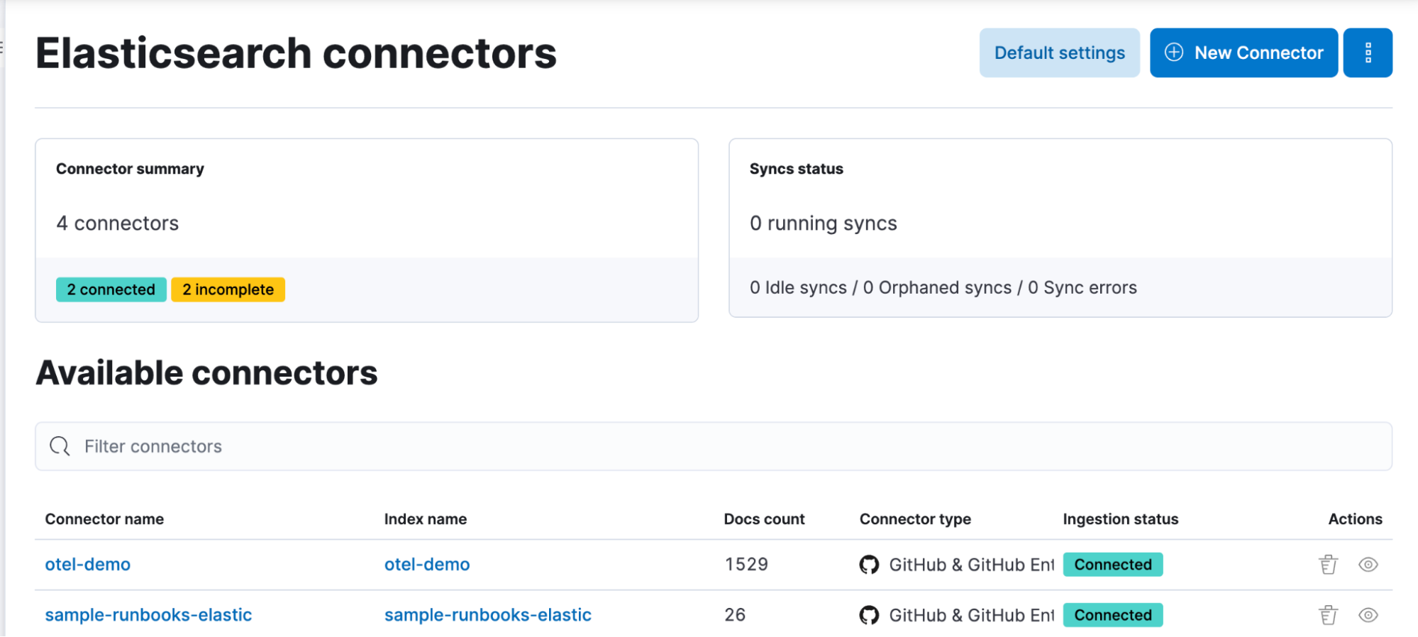

We initially connect to GitHub using an Elastic GitHub connector and ingest and process two repos: the OpenTelemetry demo repo (public) and an internal runbook repo (Elastic internal).
With these two loaded and parsed by ELSER, we ask the AI Assistant some simple questions generally asked during analysis.
How many issues are open for the OpenTelemetry demo?
Since we ingested the entire repo (as of April 26, 2024) with a doc count of 1,529, we ask it a simple question regarding the total number of issues that are open. We specifically tell the AI Assistant to search our internal index to ensure the LLM knows to ask Elastic to search its internal index for the total number of issues.

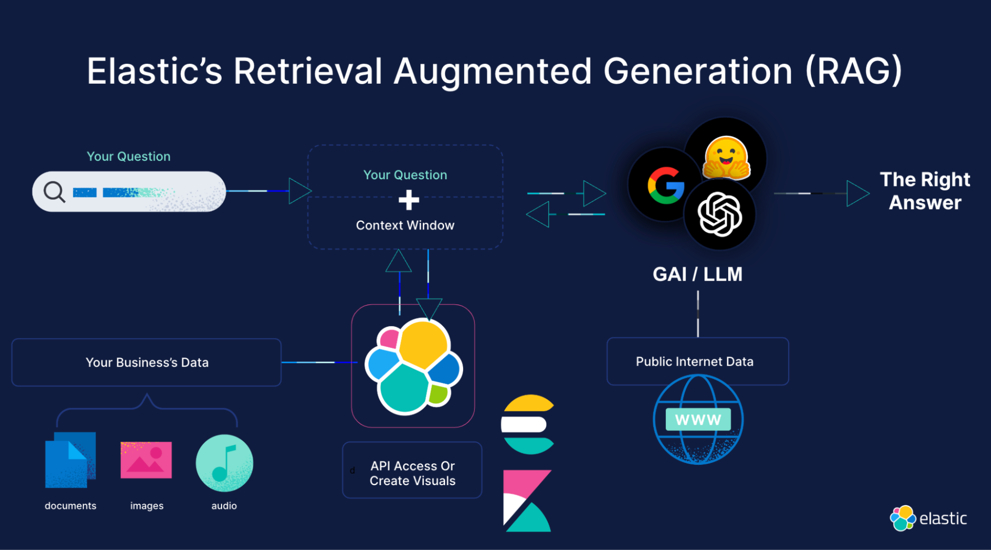

Retrieval augmented generation (RAG) with Elastic AI Assistant
Elastic has the most advanced RAG-based AI Assistant for both Observability and Security. It can help you analyze your data using:
  • Your favorite LLM (OpenAI, Azure OpenAI, AWS Bedrock, etc.)
  • Any internal information (GitHub, Confluence, customer issues, etc.) you can either connect to or bring into Elastic’s indices
The reason Elastic’s AI Assistant can do this is because it supports RAG, which helps retrieve internal information along with LLM-based knowledge.
Adding relevant internal information for an SRE into Elastic:
  • As data comes in, such as in your GitHub repository, ELSER is applied to the data, and embeddings (weights and tokens into a sparse vector field) are added to capture semantic meaning and context of the data.
  • This data (GitHub, Confluence, etc.) is processed with embeddings and is stored in an index that can be searched by the AI Assistant.
When you query the AI Assistant for information:
  • The query goes through the same inference process as the ingested data using ELSER. The input query generates a “sparse vector,” which is used to find the most relevant highly ranked information in the ingested data (GitHub, Confluence, etc.).
  • The retrieved data is then combined with the query and also sent over to the LLM, which will then add its own knowledge base information (if there is anything to add), or it might ask Elastic (via function calls) to analyze, chart, or even search further. If a function call is made to Elastic and a response is provided, it will be added by the LLM to its response.
  • The results will be the most contextual based answer combining both LLM and anything relevant from your internal data.

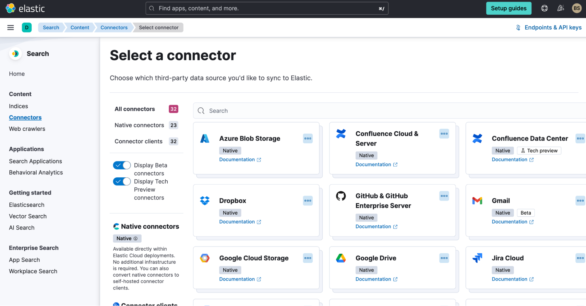

Adding the GitHub repos to Elastic

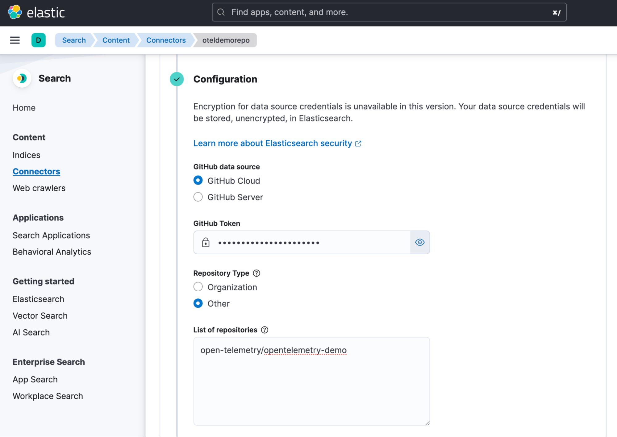

The first step is to set up the GitHub connector and connect to your GitHub repo. Elastic has several connectors from GitHub, Confluence, Google Drive, Jira, AWS S3, Microsoft Teams, Slack, and more. So while we will go over the GitHub connector in this blog, don’t forget about other connectors.
Once you select the GitHub connector and give it a name, you need to add two items:
  • GitHub token
  • The URL open-telemetry/opentelemetry-demo

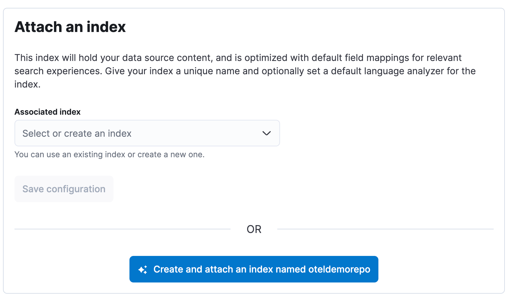

Next, add it to an index in the wizard.

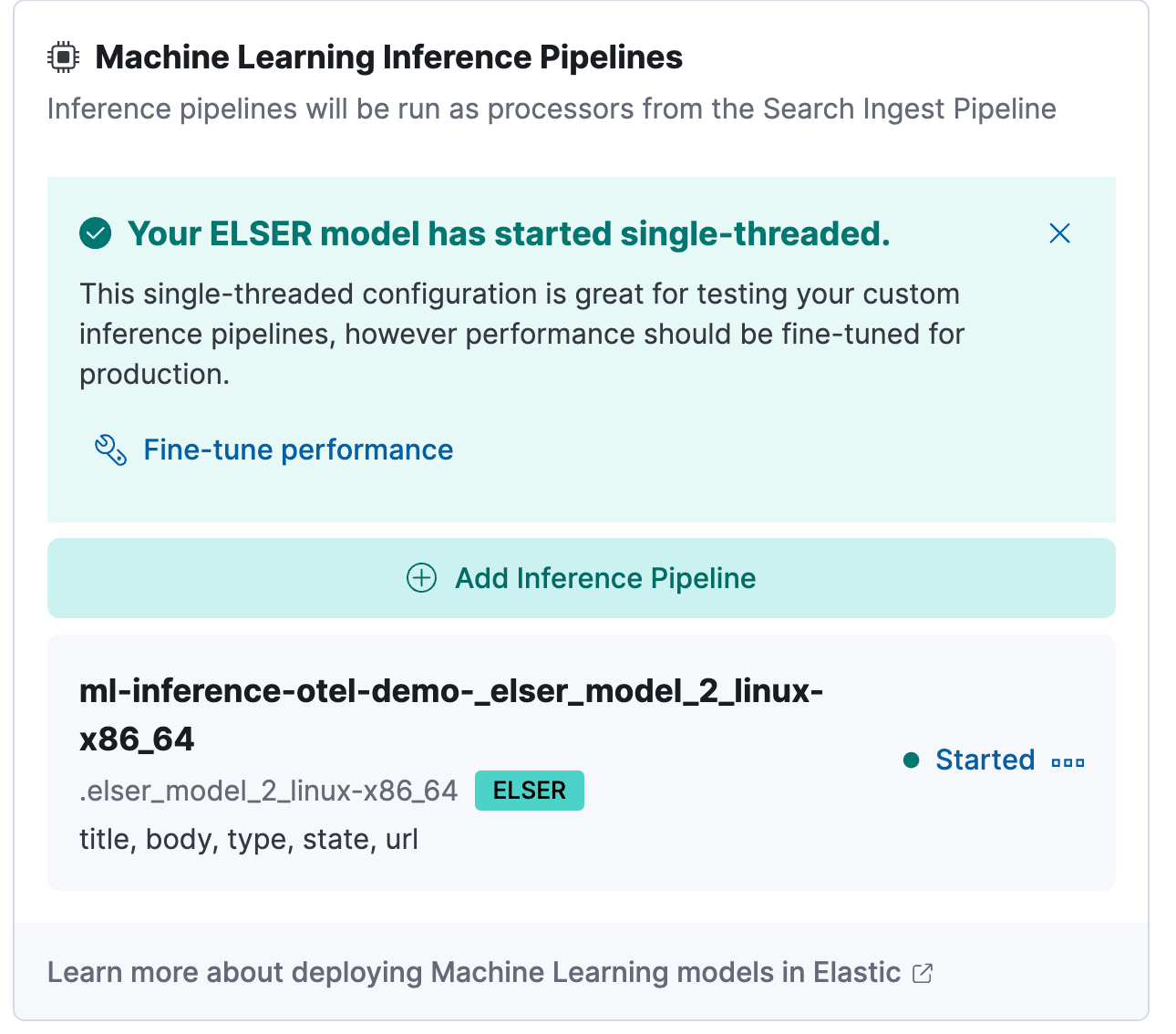

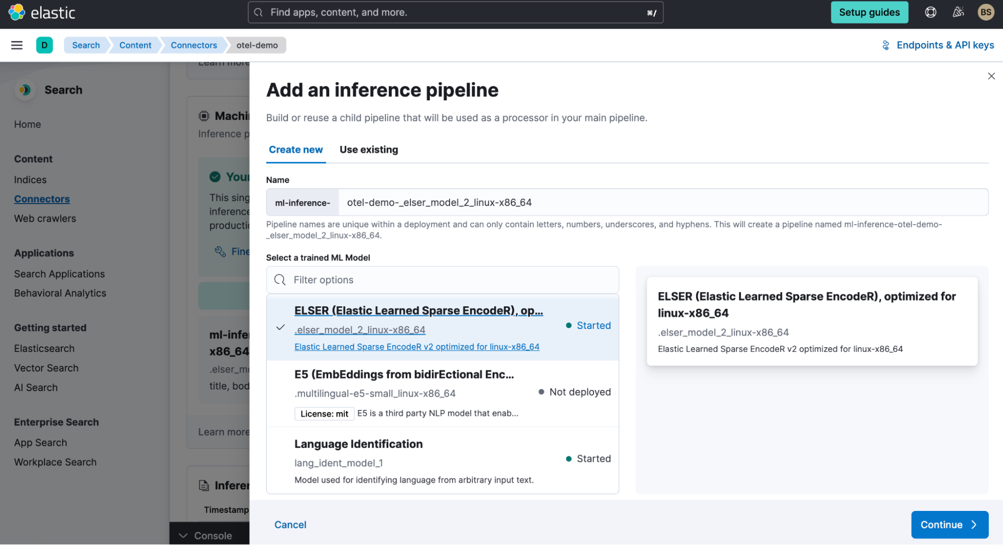

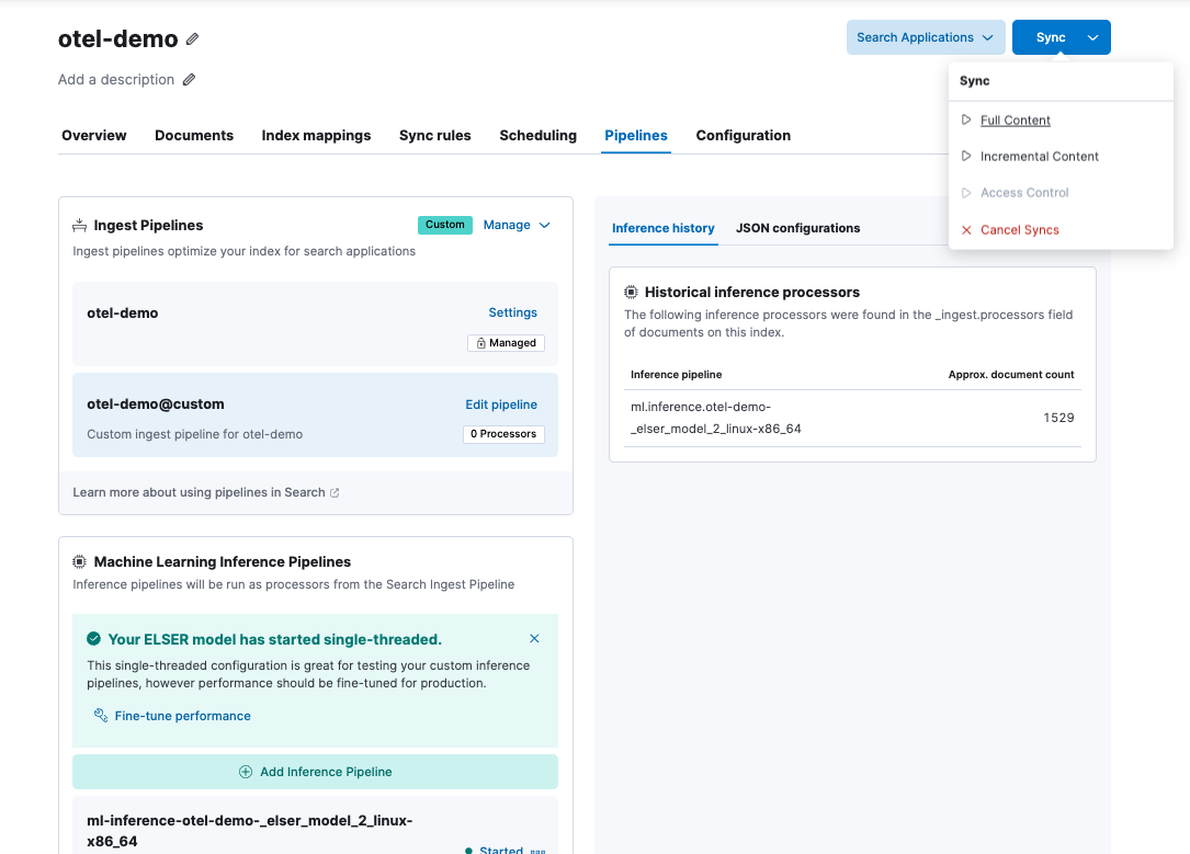

Create a pipeline and process the data with ELSER
In order to add the embeddings we discussed in the section above, we need to add the following to the connector:
  • Create a pipeline in the configuration wizard.
  • Create a custom pipeline.

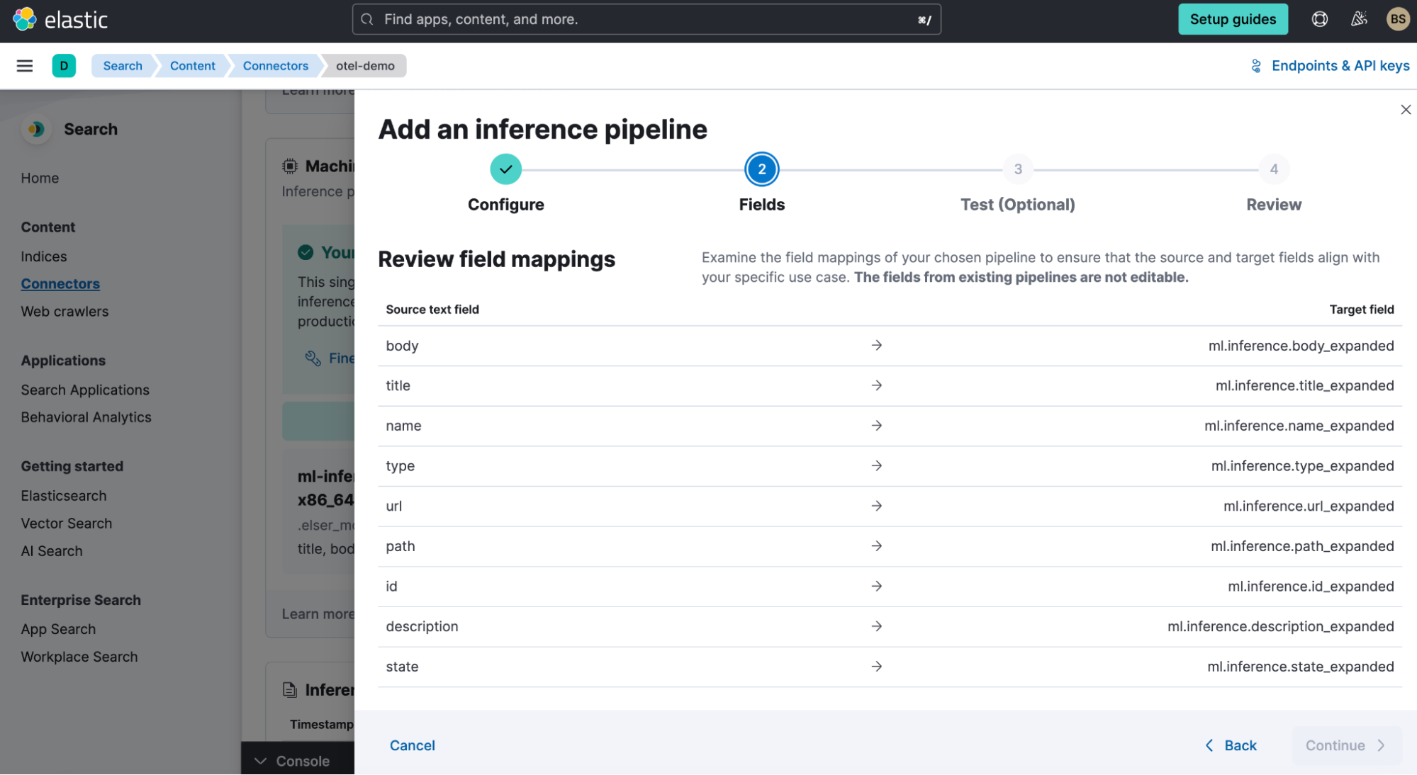

  • Add the ML inference pipeline.
  • Select ELSERv2 ML Model to add the embeddings.
  • Select the fields that need to be evaluated as part of the inference pipeline.
  • Test and save the inference pipeline and the overall pipeline.

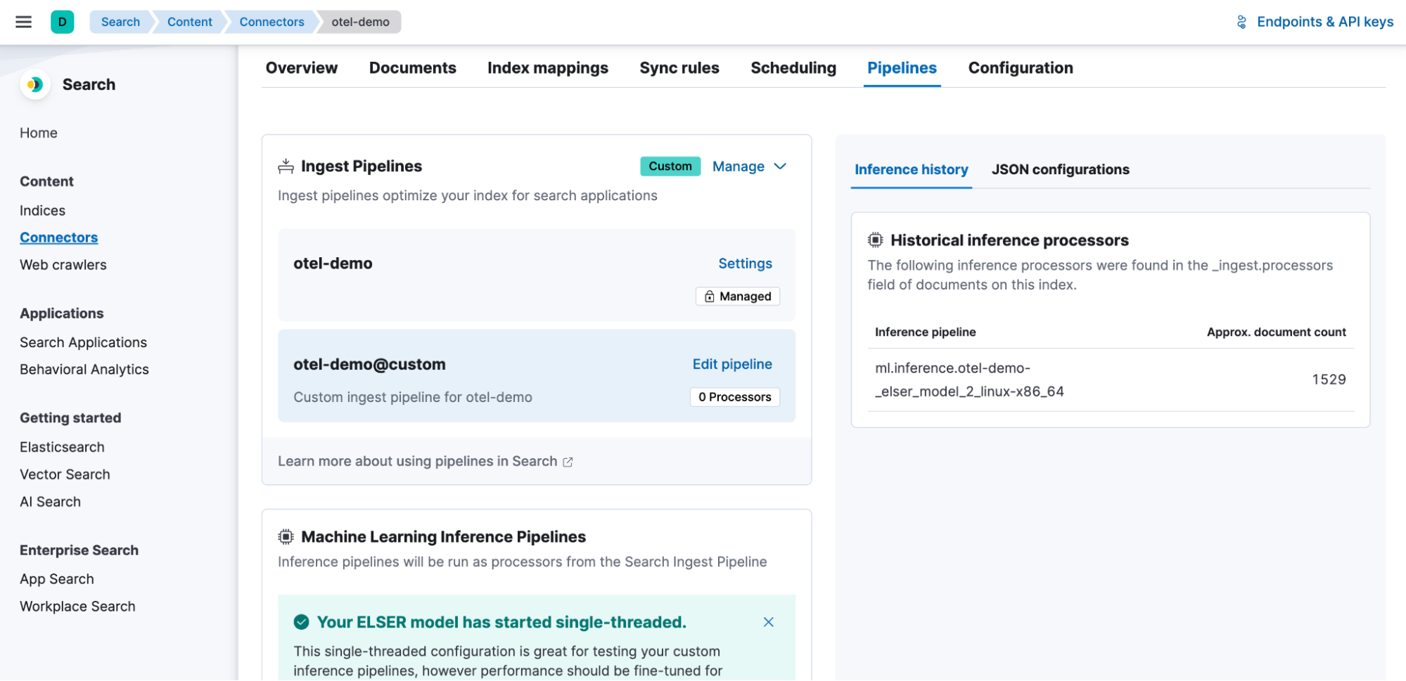

Sync the data

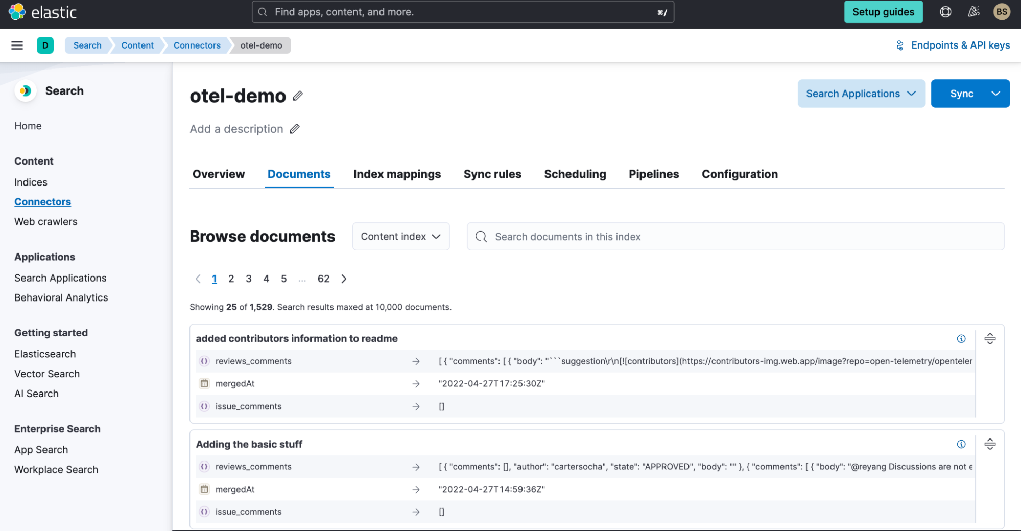

Now that the pipeline is created, you need to start to sync the github repo. As the documents from the github repo come in, they will go through the pipeline and embeddings will be added.
Embeddings
Once the pipeline is set up, sync the data in the connector. As the GitHub repository comes in, the inference pipeline will process the data as follows:
  • As data comes in from your GitHub repository, ELSER is applied to the data, and embeddings (weights and tokens into a sparse vector field) are added to capture semantic meaning and context of the data.
  • This data is processed with embeddings and is stored in an index that can be searched by the AI Assistant.

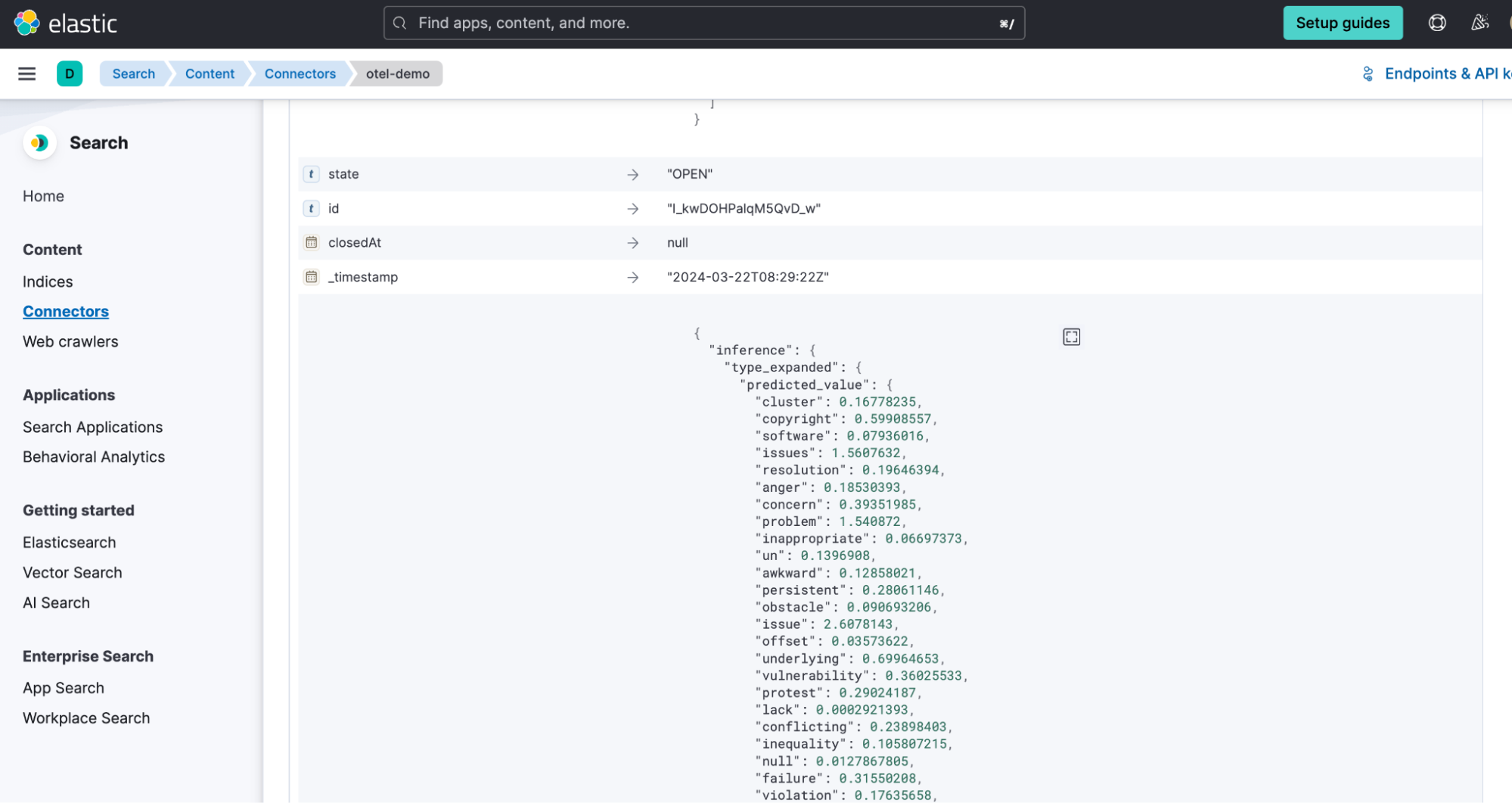

When you look at the OpenTelemetry GitHub documents that were ingested, you will see how the weights and token are added to the predicted_value field in the index.
These embeddings will now be used to find the most contextually relevant document when the user asks the AI Assistant a query, which might use this.
