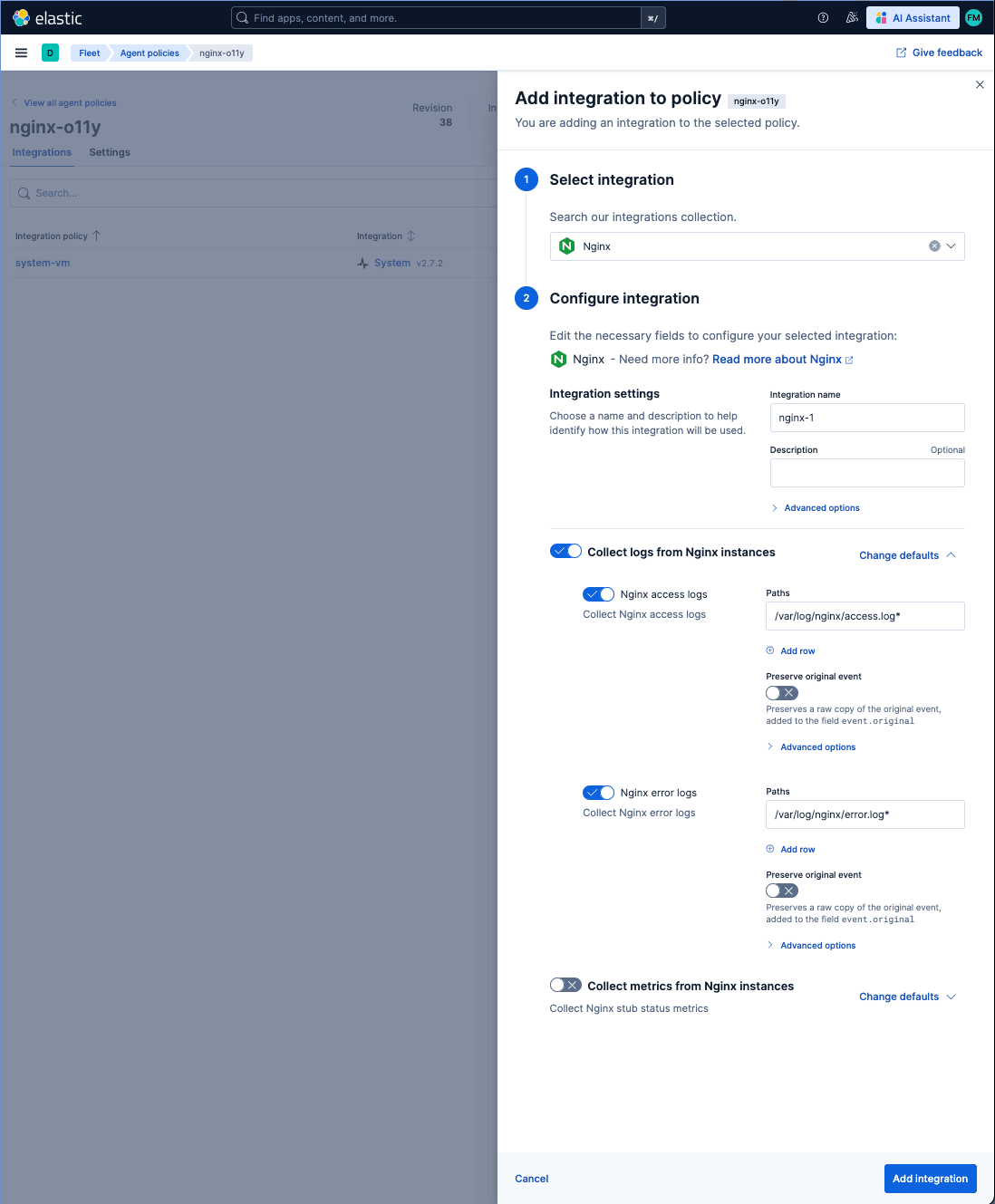

3. Add the Native Integration (Logs)
  1. In Fleet, go to Integrations.
  2. Search for NGINX.
  3. Click Add NGINX.
  4. Select your nginx-o11y policy.
  5. Only enable log collection (access + error logs).
  6. Save and deploy.

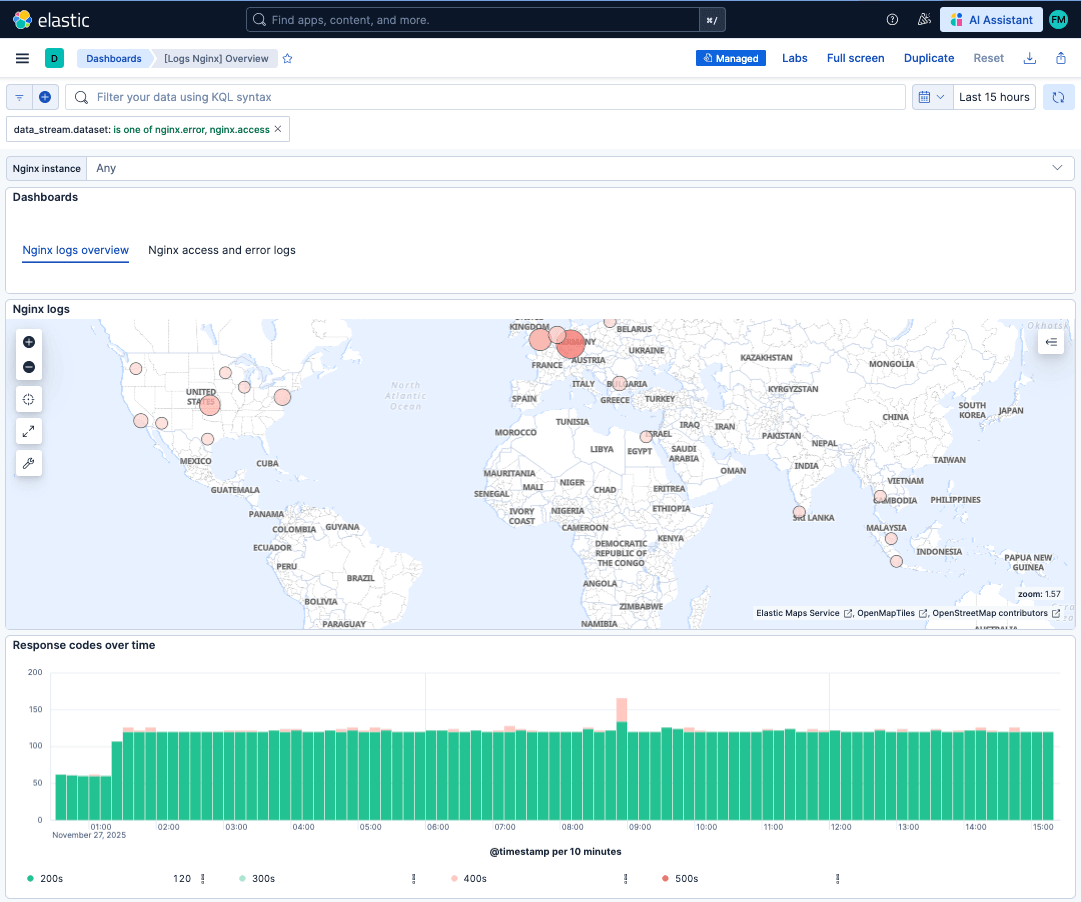

4. Validate Log Collection
  1. In Kibana, go to Analytics → Discover and search for:
data_stream.dataset : "nginx.access" or "nginx.error"
  1. Or open the built-in dashboard:
Analytics → Dashboards → [Logs Nginx] Access and error logs

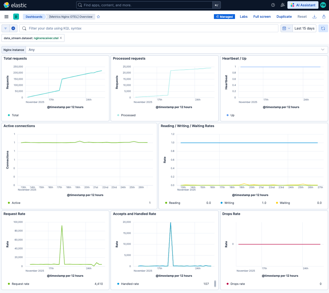

5. Collecting NGINX Metrics via the OTel NGINX Receiver
Elastic Agent 9.2+ allows Fleet to deploy OTel input integrations.
This scenario uses the OpenTelemetry nginxreceiver through a Fleet-managed integration.
5.1. Install the NGINX OpenTelemetry Integration Content
  1. In Kibana, go to Management → Fleet → Integrations.
  2. Search for NGINX OpenTelemetry Assets.
  3. Click Add Integration.
5.2. Install the NGINX OpenTelemetry Input Integration
  2. Search for NGINX OpenTelemetry Input Package.
  4. Assign it to your agent nginx-o11y policy.
Provide the endpoint for the NGINX status page:
  • Endpoint: http://localhost/status
  • Collection interval: 10s
Click Add integration.
6. Validate OTel Metrics
  1. Go to Analytics → Dashboards.
  2. Open: [Metrics Nginx OTEL Overview] Dashboard
You should see metrics such as active connections, writes, reads, waiting, and request counts.
