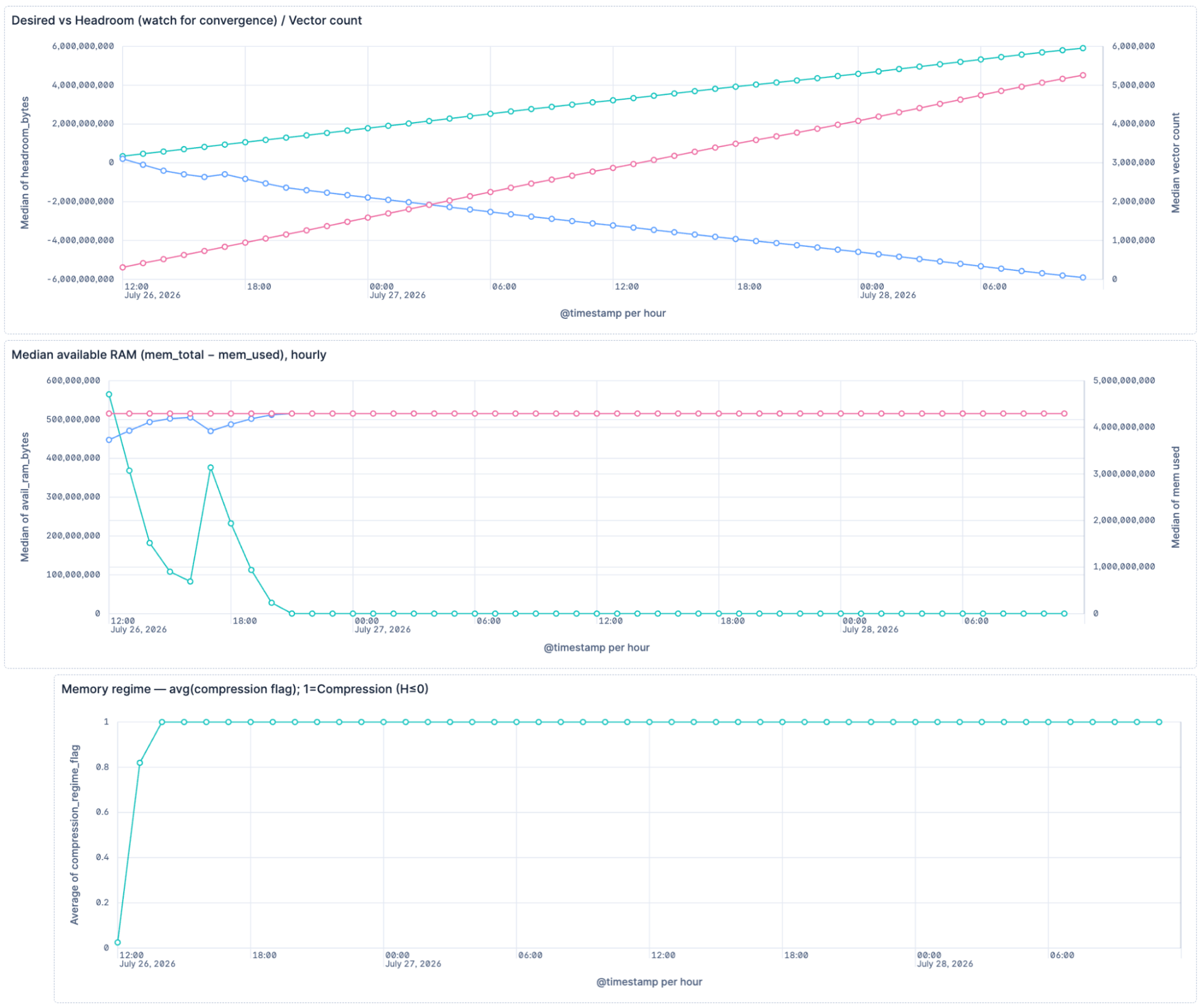

AutoOps works from the same node stats metrics you already use for Stack Monitoring. For each node, it tracks three derived numbers:
Symbol
Meaning
Source (typical)
Chart (see below)
V
Vector off-heap footprint
indices.dense_vector.off_heap.total_size_bytes
First, green line
A
Available RAM in the product view
Delta between os.mem.total_in_bytes and os.mem.used_in_bytes
Second, green line
H
Headroom
A − V (headroom_bytes)
First, blue line
H > 0 means there’s a modeled runway: Vector use still fits comfortably in that accounting. H ≤ 0 means that you’re in a compression regime: Vector footprint (V) meets or exceeds the free RAM (A) picture that AutoOps can align in telemetry. On small tiers, that can be common under load. The insight emphasizes trends, growth in vector off-heap footprint, and corroborating stress, not a single negative snapshot.
AutoOps also tracks a compression regime flag (fraction of recent samples where H ≤ 0), so brief flickers don’t dominate the story (see third chart below):

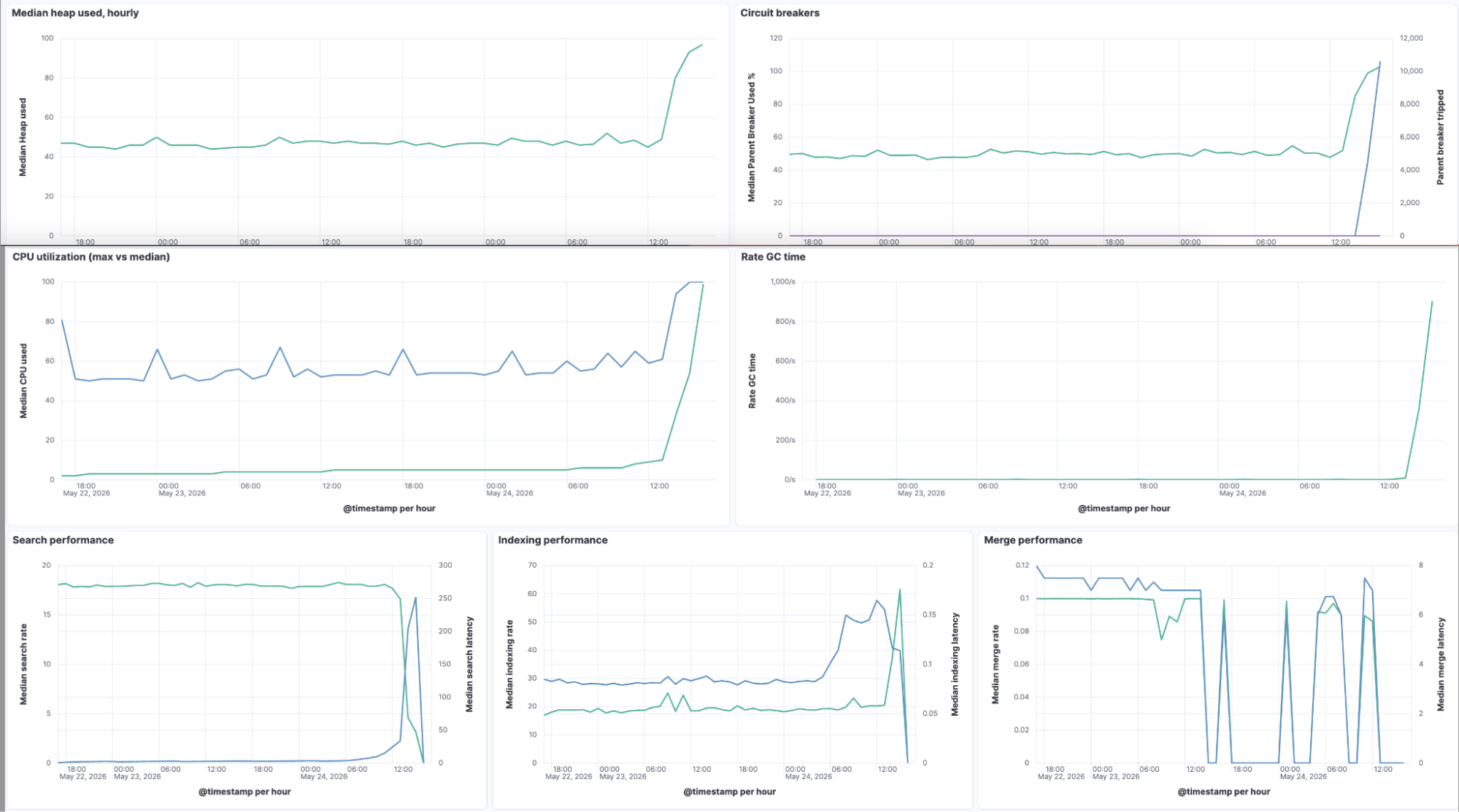

  • On both HNSW and BBQ HNSW, the insight fired once heap climbed past ~75% with memory compression and thread-pool queue stress, roughly an hour before heap neared saturation. Node out of memory (OOM) and circuit breakers followed in the same window, as did slow search/indexing. As we can see on the dashboard below, performance drops drastically due to corroborating stress toward the end of the test run:

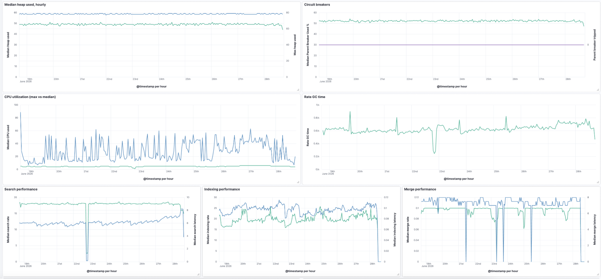

  • On DiskBBQ, where compression was chronic but heap stayed normal, the insight didn’t fire, since storage rather than memory was the limiting factor. Disk and watermark signals are the right path to follow for that profile. As we can see on the screenshot below, all indicators stayed steady with constant performance throughout the test, even though we filled up the disk with more than 70 million vectors on the same instance type:

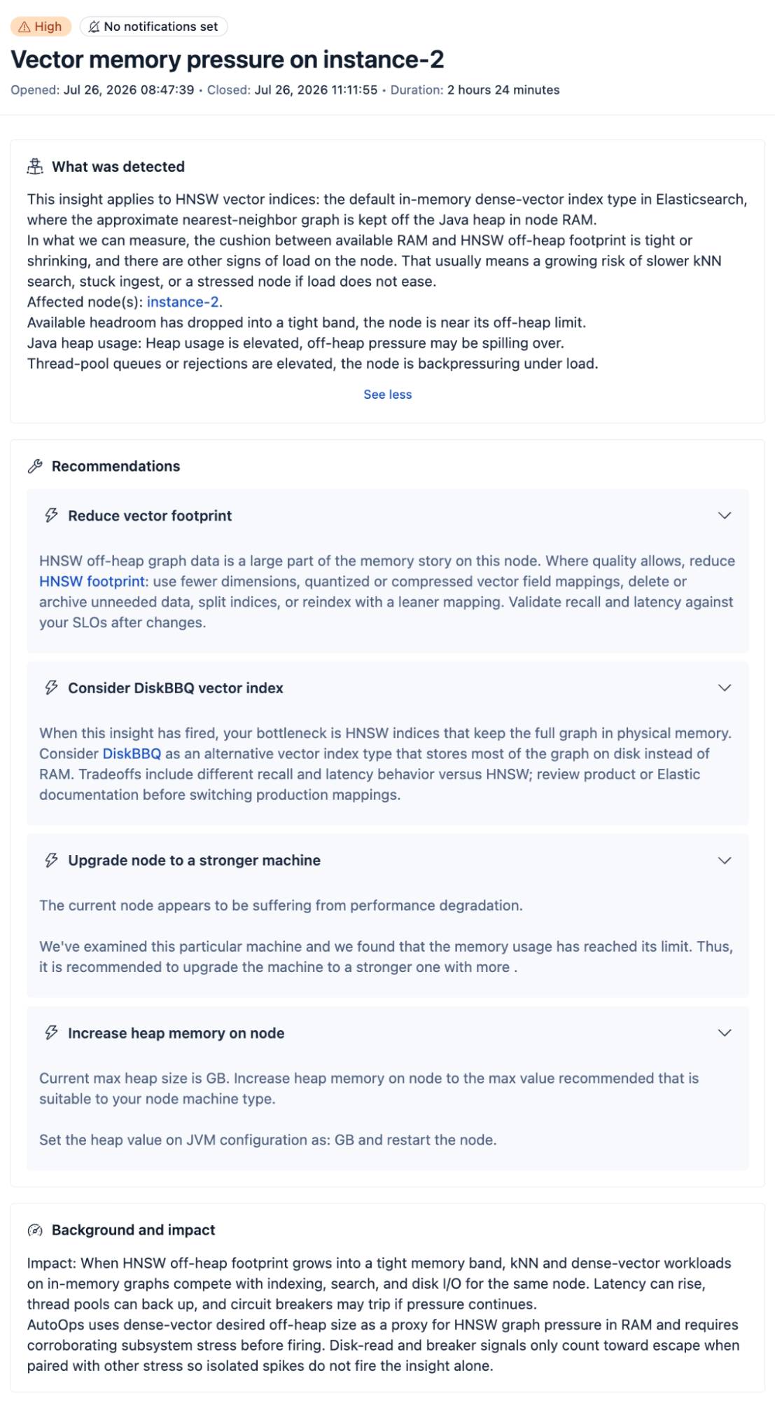

Here’s the insight that AutoOps now raises when it detects vector memory pressure:
Recommendations in the product map to concrete actions:
  1. Reduce vector footprint where quality allows: Fewer dimensions, quantized mappings, archive or split indices, reindex with a leaner mapping.
  2. Tune kNN load: Lower num_candidates, reduce concurrent query rate, narrow filtered kNN where possible.
  3. Consider DiskBBQ when HNSW in RAM is the bottleneck (evaluate recall/latency trade-offs for your use case). If you’re already on DiskBBQ and the heap memory is calm, treat disk and watermark insights as the primary signals. Note that DiskBBQ requires an Enterprise license.
  4. Right-size RAM when vector off-heap footprint (V) trends up and headroom stays tight.
AutoOps links affected nodes and summarizes regime and stress in plain language. Treat it as “act now, rather than waiting for red on every chart.”
