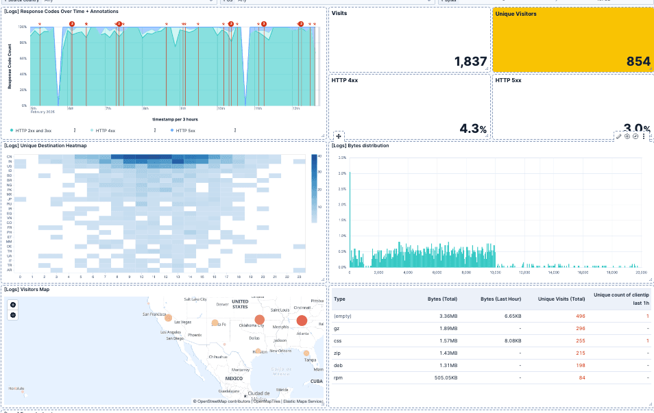

Almost all Elastic stack users at some point will use a Dashboard. Elastic ships many out-of-the-box dashboards for all its integrations, and users will create custom dashboards: to share with others, do a root cause analysis, and/or generate a PNG report. As a result, the Dashboard app is one of the most used applications in Kibana (for those wondering, the other most popular one is Discover).
In addition, many of the core application components of Dashboards support other Kibana applications. Kibana’s widget framework for embedding charts and tables was originally developed for Dashboards, or the data plugin, which brokers search requests to Elasticsearch from the Kibana browser app and is heavily used by all Kibana plugins.
In other words, the Dashboard application – both from a product and technical perspective – is central to Kibana, and deserves to be the best experience for users.
Yet, dashboards in Kibana could feel “sluggish”. We would experience it as developers, and we would hear it from users.
Comparisons with other tools (like Grafana, or to a lesser extent OpenSearch Dashboards) also showed that Dashboards in Kibana sometimes tend to feel slower.
For this reason, the Kibana Team recently undertook an effort to bring down the render time of a Dashboard.

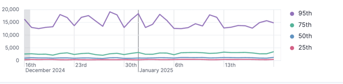

The time here is dominated by (very) long-running Elasticsearch queries. The 95th percentile (i.e. the minority) of dashboard rendering times sits significantly above the mean. This does not have to be unexpected; for example, the search the panels issue can span a large time-range, queries hit cold or frozen storage tiers that are not optimized for analytical workloads. These are a minority of dashboards, “the long tail”.
Note also a clear seasonality in the data, with longer render times during the weekday versus the weekend. This likely indicates that the “worst case” is influenced by the overall load on the cluster including ingest (not just the runtime analytical queries), which tends to be elevated during working hours.
(b) On the other hand, the majority of dashboards load in the low-second range.
The 75% and under (the green, blue, and red lines) are significantly less, but they still take 1-3 seconds.

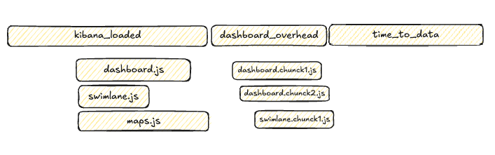

a) What to measure
From a high level, we introduced three core metrics, each capturing a specific span of the dashboard load. These can be stacked neatly bottom-to-top when opening a dashboard by its unique URL in a fresh tab.
Metric
What
When
Frequency
kibana_loaded
Initial asset loading session (“the spinner”)
Opening Kibana for the first time
Once per user session
dashboard_overhead
Bootstrapping of dashboard app and panels
Opening a specific dashboard
Once per dashboard
time_to_data
Time for data to appear on screen
Changing a filter, a time-range, a control…
Once per query-state change
This instrumentation is largely implemented ad-hoc. Conventional Core Web Vitals (https://web.dev/articles/vitals) do not exactly measure what we were looking for, although we can draw some parallels.
Specifically, Time-To-Interactive (TTI) corresponds roughly to the end of “kibana_loaded”. After that, the app is usable, although not all UX may have fully initialized yet. For example, the dashboard controls may not have been initialized yet, even though the dashboard-app technically can start responding to inputs.
Another tricky metric was to match the “completion” of a dashboard to when all data is on screen, comparable in spirit to Largest Contentful Paint (LCP). This is the result of AJAX data-requests and front-end rendering which are custom to each panel-type.
So to gather it correctly, each panel on a dashboard needs to report its “completion” state.
For some charts, this is fairly straightforward (e.g. a simple metric-chart), but for others this is complicated. For example, a map is only complete when all tiles are rendered on screen. Detecting this is not trivial.
After all panel-types report “completion” correctly, it is then up to the dashboard-application itself to observe all these “completion” events and report the “time-to-data” metric accordingly after the last completion.
Additionally, further segmentations of these benchmarks were introduced, as well as additional metadata like the number of panels on a dashboard or whether the user navigated from within Kibana (some assets are loaded already) or from outside Kibana into the dashboard (no assets have been loaded). The app is also collecting metrics on the server on the duration of data requests.

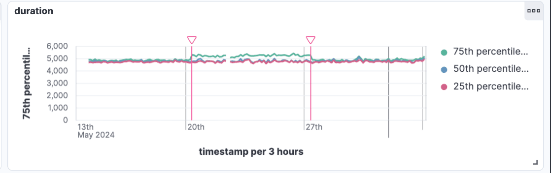

Performance metrics are being collected for a handful of representative dashboards. These have similar configurations as our integrations, each dashboard containing a mix of chart types.
An example of a dashboard benchmark
These benchmarks run every three hours on Kibana’s main release branch. The runner spins up a single Elasticsearch and Kibana cluster on dedicated hardware. Metrics are collected from Playwright scripts in a Chromium headless browser.

A typical smile-pattern in our benchmarks. A regression was detected and resolved.

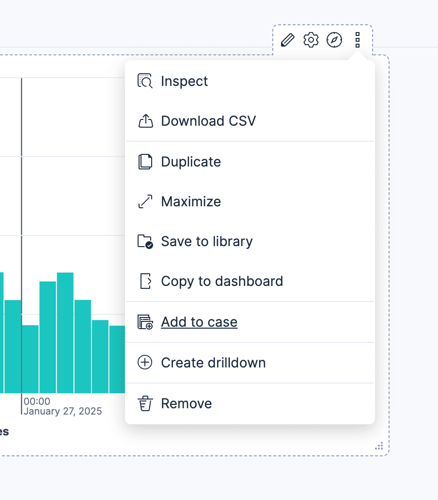

The first is particularly a problem for Dashboards. Many plugins register widgets with the dashboard app, for example,. a maps panel, a swimlane panel, etc…. However, most dashboards will never display a map or swimlane.
Example: plugins can add pop-up links to dashboard panels. These are context dependent.
Before: pseudo-code of how a plugin registers a pop-up item for dashboard panels. This pattern causes unnecessary code to be loaded.

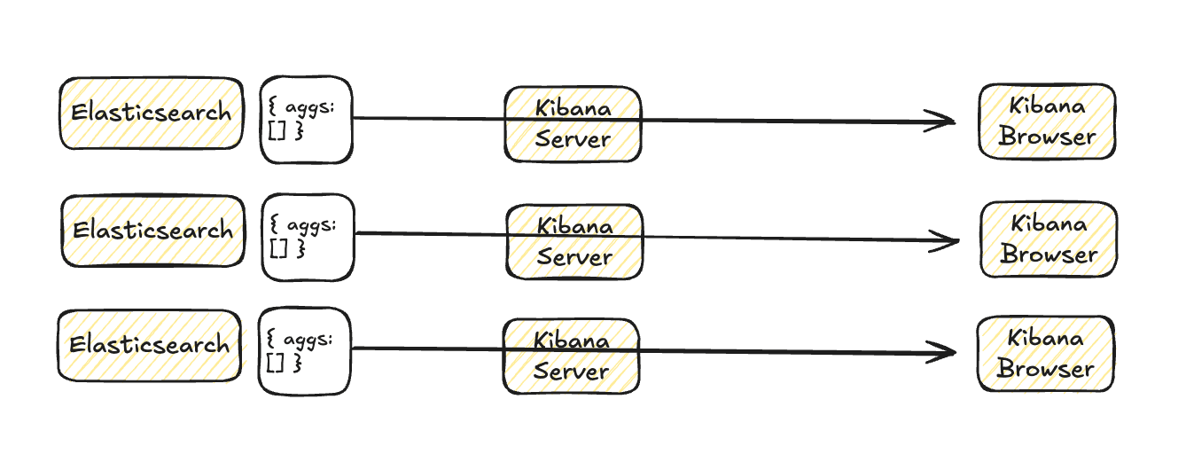

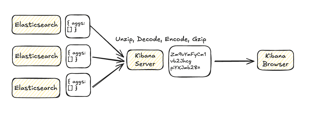

Data transfer improvements

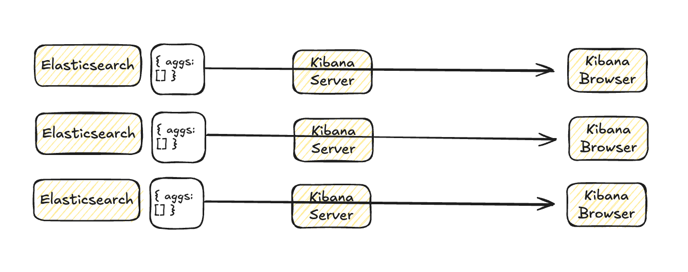

The data request roundtrip from a Dashboard running Kibana-browser to and from Elasticsearch was batched. Multiple requests would be collected and the Kibana server would fan these out to Elasticsearch as individual _async_search requests, and combine these ES-JSON responses in a new Kibana-specific format.
The main reason for this batching was that it side-steps the browser connection limit for HTTP1. This sits around 6 concurrent http requests, something which is easily exceeded on Dashboards with multiple panels.
This approach has two main disadvantages. It adds a small delay to collect the batches. It also puts a strain on the kibana-server to wait and re-encode the ES-responses. Kibana-server would need to unzip them first, decode the JSON, concatenate the responses, and then gzip again. While this re-encoding step is generally small, in the worst case (for example, for large responses), it could be significant. It would also add significant memory pressure, occasionaly causing Out Of Memory issues.
Given that the proxies that sit in front of Elastic Cloud and Serverless already support HTTP 2.0, and that Kibana will start to support HTTP 2.0 for stateful in 9.0, it was decided to remove this batching. In addition, kibana-server no longer re-encodes the data and streams the original gzipped result from Elasticsearch.
This greatly simplifies the data-transfer architecture and in combination with running over HTTP 2.0, has shown some nice performance improvements. Apart from the performance benefits (faster, less sensitive to OOM), debuggability has much improved due to the simplified architecture and the fact that data-responses can now easily be inspected in the browser’s debugger.

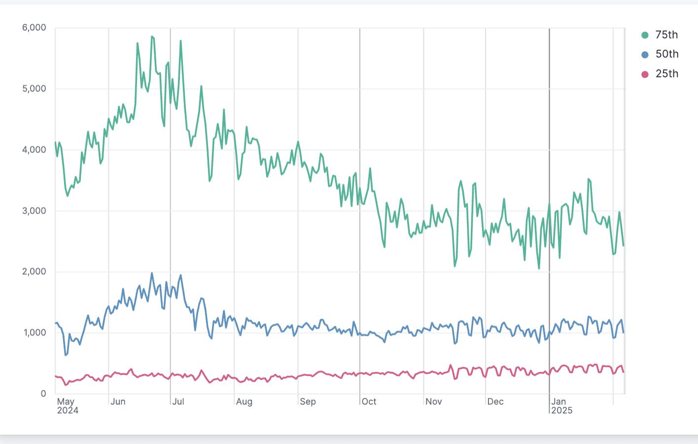

Real-world users

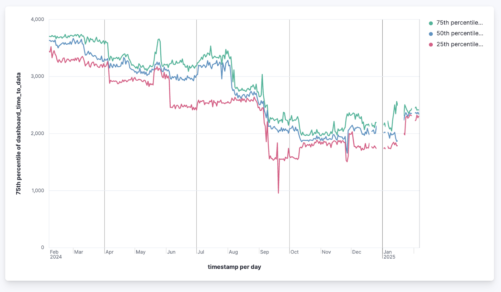

The real world, as explained in the intro, is harder to measure. We just do not know exactly which dashboards users are running, and how their configurations evolve over time.
However, looking at it from two different perspectives, we can verify the same evolution as in the synthetic benchmarking environment..
First, over time we see a drop of time to render in the 75 percentile. It allows us to say that – on average – the experience of users on a dashboard in Jan 2025 is significantly better than in June 24.
Dashboard render-time for 25, 50, and 75 percentile

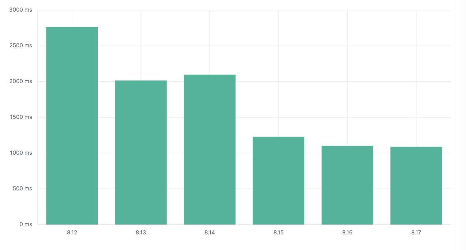

We can also compare mean time_to_data by version of all users in the last week. Users in 8.17 wait noticeably less time for data to appear on screen than users of 8.12.
The drop in real world is also slightly delayed from what we are observing in our benchmarks, which roughly is in line with the cadence the stack is released.
