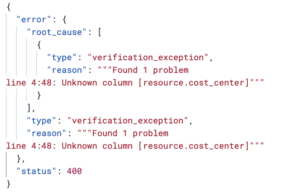

Consider an OTel logs index where resource.cost_center was never mapped. Without SET unmapped_fields, referencing it produces an error:
-- This fails: "Unknown column [resource.cost_center]"
FROM otel-logs-*
| STATS errors = COUNT(*) BY service.name, resource.cost_center

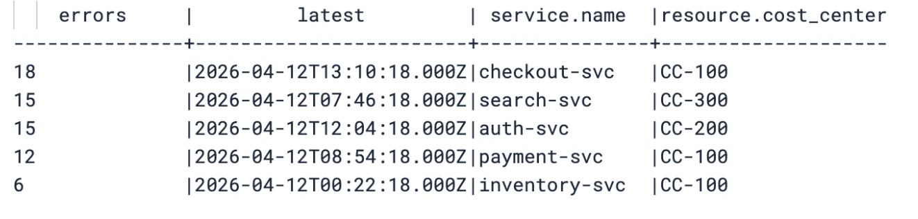

Add one line and the query works:
SET unmapped_fields="load";
FROM otel-logs-*
| WHERE log.level IN ("error", "warn")
| STATS errors = COUNT(*), latest = MAX(@timestamp)
| SORT errors DESC
The field is loaded from _source at query time. No mapping change. No reindex. Works against data that was ingested weeks or months ago.
