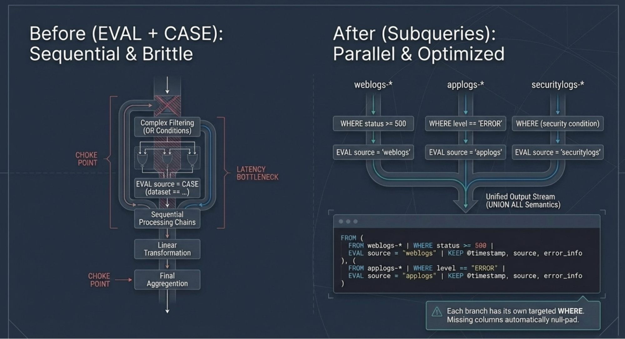

The problem: Heterogeneous data, one query
Consider a production incident investigation. Errors are spread across three microservices: an API gateway, a payments service, and an auth service, each with different field names and different conventions. Before subqueries, combining them in a single ES|QL query meant cramming everything into one FROM with CASE chains:
FROM svc-gateway-*, svc-payments-*, svc-auth-* METADATA _index
| WHERE http.response.status_code >= 500
    OR transaction.status IN ("failed", "timeout")
    OR (event.action == "login" AND event.outcome == "failure")
| EVAL
    service = CASE(
      _index LIKE "svc-gateway*", "gateway",
      ... /* one branch per source */),
    error_detail = CASE(
      _index LIKE "svc-gateway*", CONCAT("HTTP ", http.response.status_code::string),
| KEEP @timestamp, service, error_detail, source.ip
| SORT @timestamp DESC
This is brittle and slow. The disjunctive OR prevents predicate pushdown; every index scans every condition. Every CASE chain grows with every source. Copy it into five dashboards and three alert rules, and you have eight places to update when anything changes.
The fix: Independent pipelines
Subqueries replace the monolithic FROM + CASE pattern. Each data source gets its own complete pipeline:
FROM
  (FROM svc-gateway-*
   | EVAL service = "gateway",
         error_detail = CONCAT("HTTP ", http.response.status_code::string)
   | KEEP @timestamp, service, error_detail, source.ip),
  (FROM svc-payments-*
   | WHERE transaction.status IN ("failed", "timeout")
   | EVAL service = "payments",
         error_detail = transaction.status
  (FROM svc-auth-*
   | WHERE event.action == "login" AND event.outcome == "failure"
   | EVAL service = "auth",
         error_detail = CONCAT(event.action, " ", event.outcome)
| LIMIT 20
The gateway branch only scans for HTTP 500s. The payments branch only looks at transaction statuses. The auth branch only checks login failures. Because each branch has its own WHERE, the optimizer pushes filters independently into each index, restoring the predicate pushdown that a single FROM with OR conditions prevents. Fields that exist in one branch but not another are filled with null.
Adding a fourth service means adding a fourth branch. Existing branches don't change.

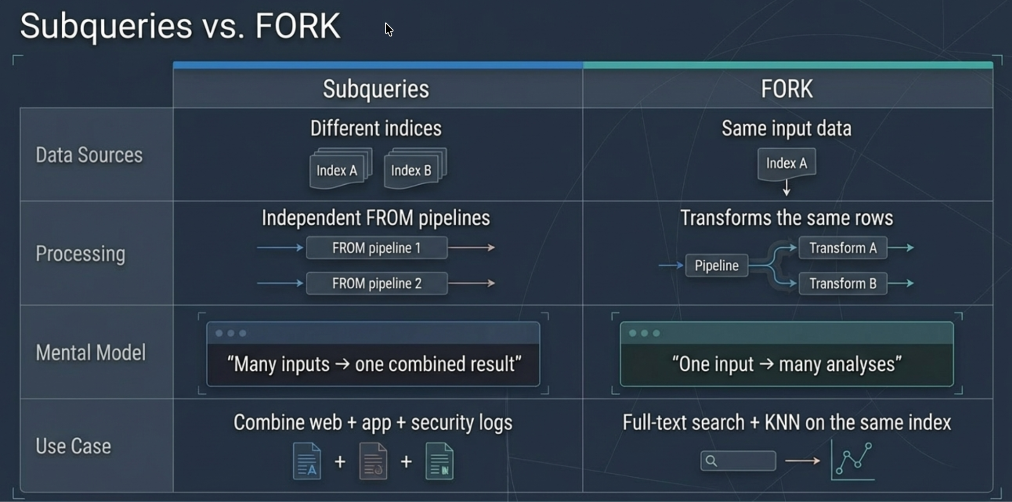

Subqueries vs. FORK
ES|QL also has FORK (now generally available), which creates parallel execution branches from the same input. The distinction:
Different indices → subqueries. Same data, different analyses → FORK.
