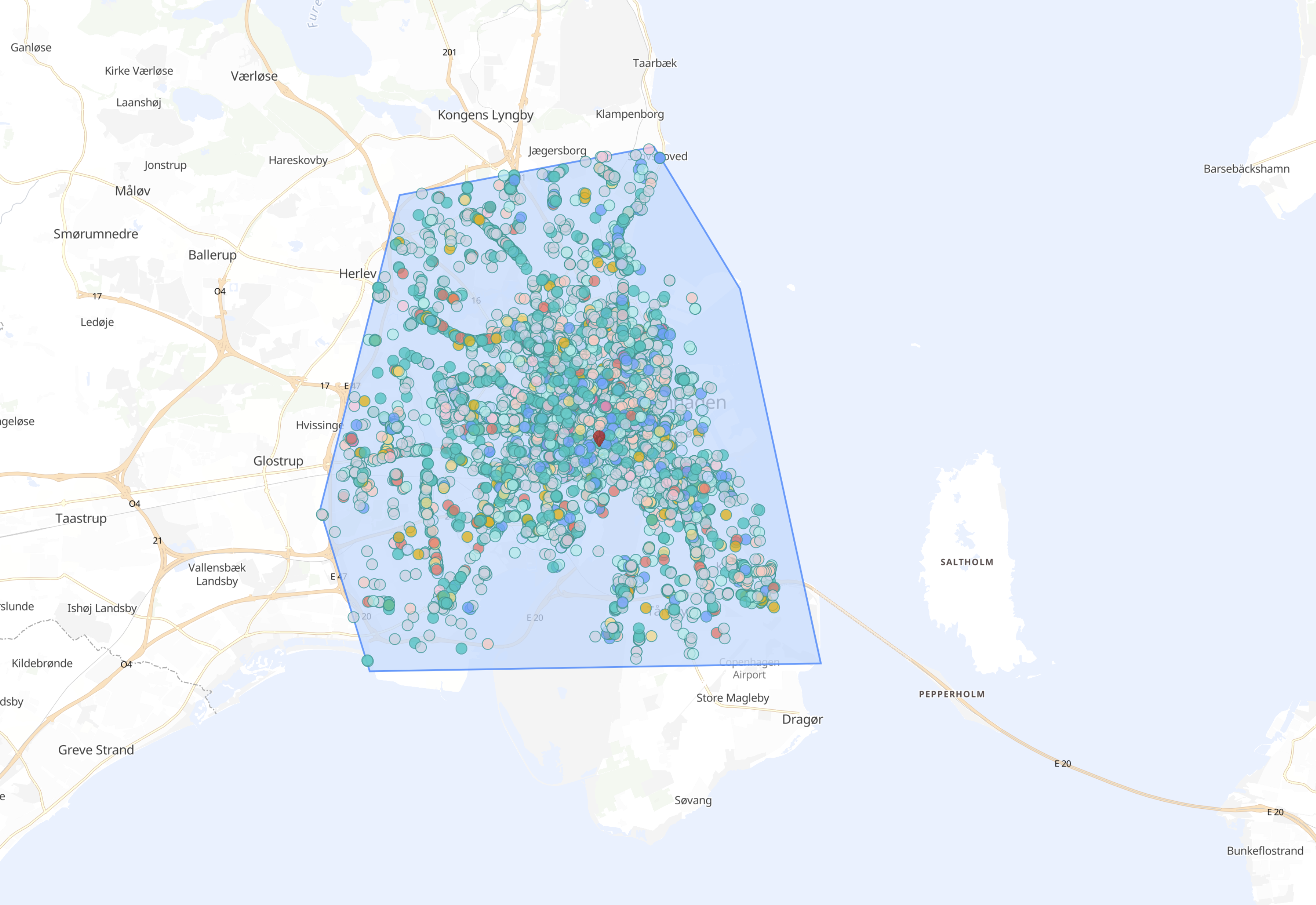

Let's remind ourselves of the main search function we used in the previous blog, the ST_INTERSECTS function. Assuming you have a dataset of points of interest (POIs) in Denmark, such as the Geofabrik download of OpenStreetMap Data for Denmark, and have imported it into Elasticsearch (for example, by using Kibana map's ability to import ESRI ShapeFiles), you can use ES|QL to search for points of interest within a specific area, in this case, the city of Copenhagen:
FROM denmark_pois
| WHERE name IS NOT NULL
| WHERE ST_INTERSECTS(
    geometry,
    TO_GEOSHAPE(
      "POLYGON ((12.444077 55.606669, 12.681656 55.608996, 12.639084 55.720149, 12.593765 55.762282, 12.459869 55.747985, 12.417984 55.654735, 12.444077 55.606669))"
| LIMIT 10000
This performs a search for any point geometry within the simple polygon we used to outline the city of Copenhagen.

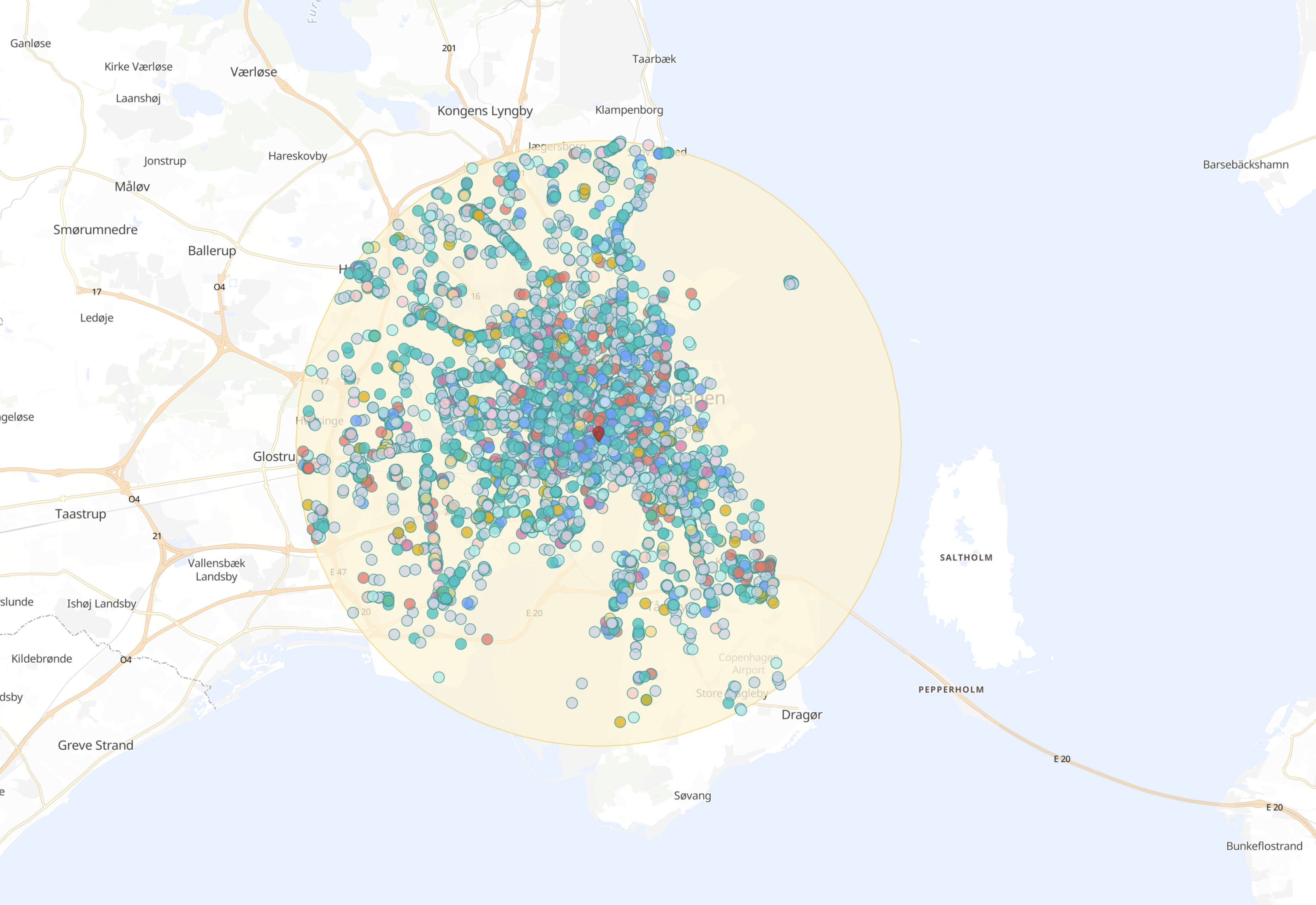

But the query was not particularly pretty with that large polygon expression. What we are far more likely to want to ask is for all points within a distance of a central point, perhaps our current location at the Copenhagen Central Train Station:
FROM denmark_pois
| WHERE ST_DISTANCE(
    geometry,
    TO_GEOPOINT("POINT (12.564926 55.672938)")
  ) < 10000
| LIMIT 10000
This much simpler query asks for all points within 10,000 meters (10 km) of the point at latitude 55.672938 and longitude 12.564926, inside the central station.

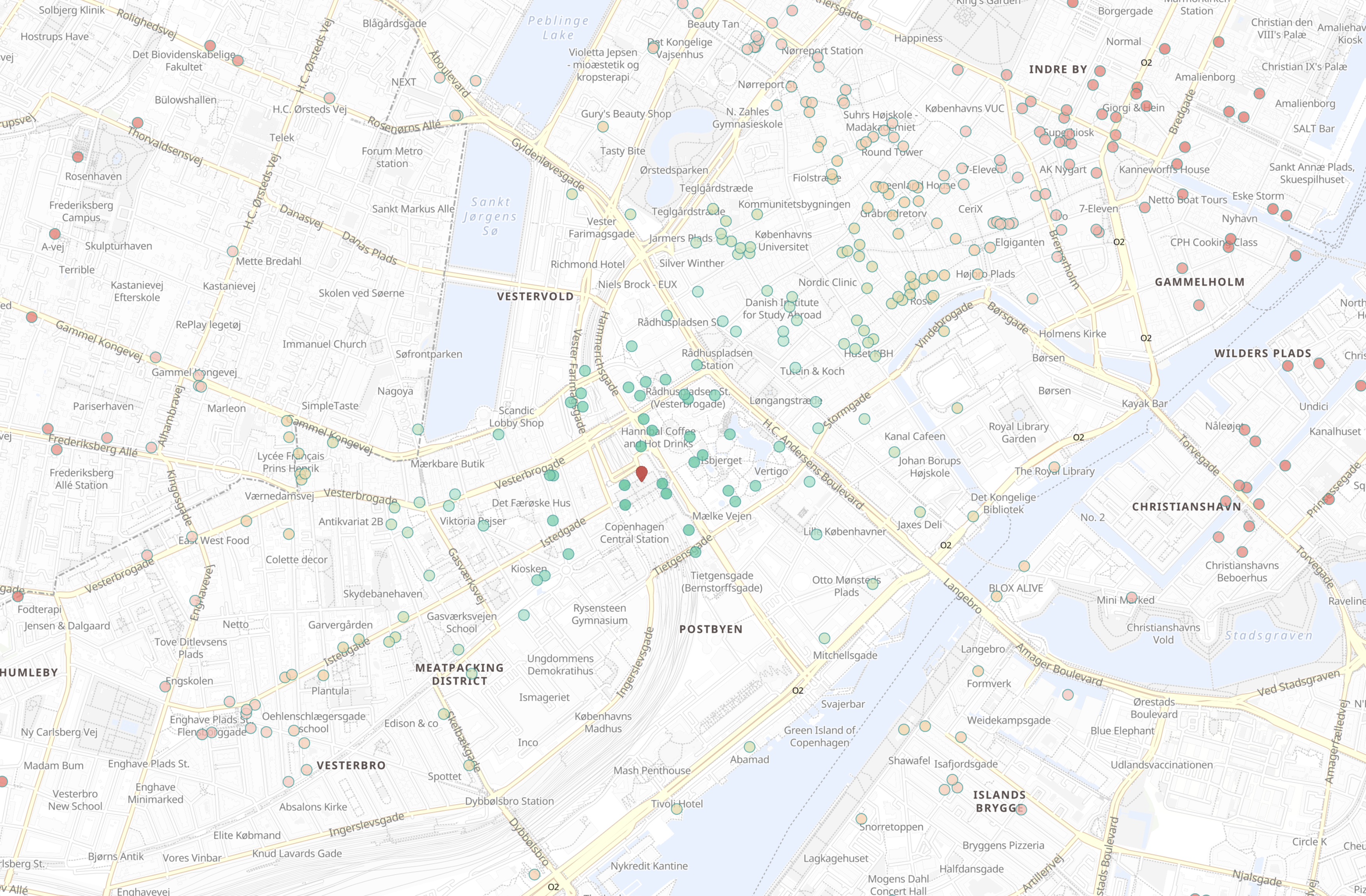

So next we might want to focus on Cafés and find the closest ones to the central station:
FROM denmark_pois
| WHERE name IS NOT NULL AND fclass == "cafe"
| EVAL distance = ST_DISTANCE(geometry, TO_GEOPOINT("POINT (12.564926 55.672938)"))
| WHERE distance < 2000
| SORT distance ASC
| LIMIT 100
This query not only filters the results to only include Cafés, but calculates and returns the distance, with the closest Cafés sorted first. We can even use the reported distances to color the map in Kibana:

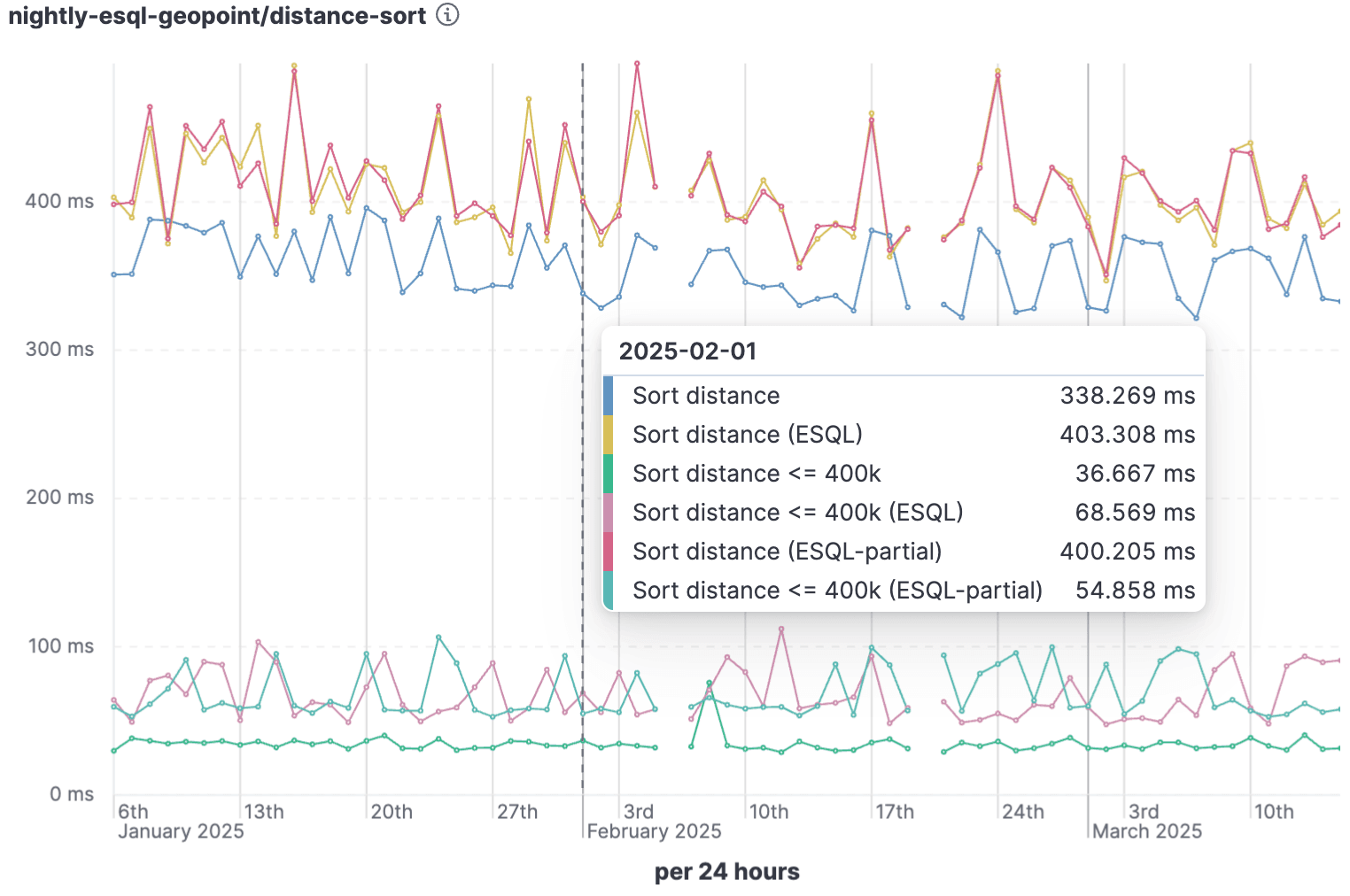

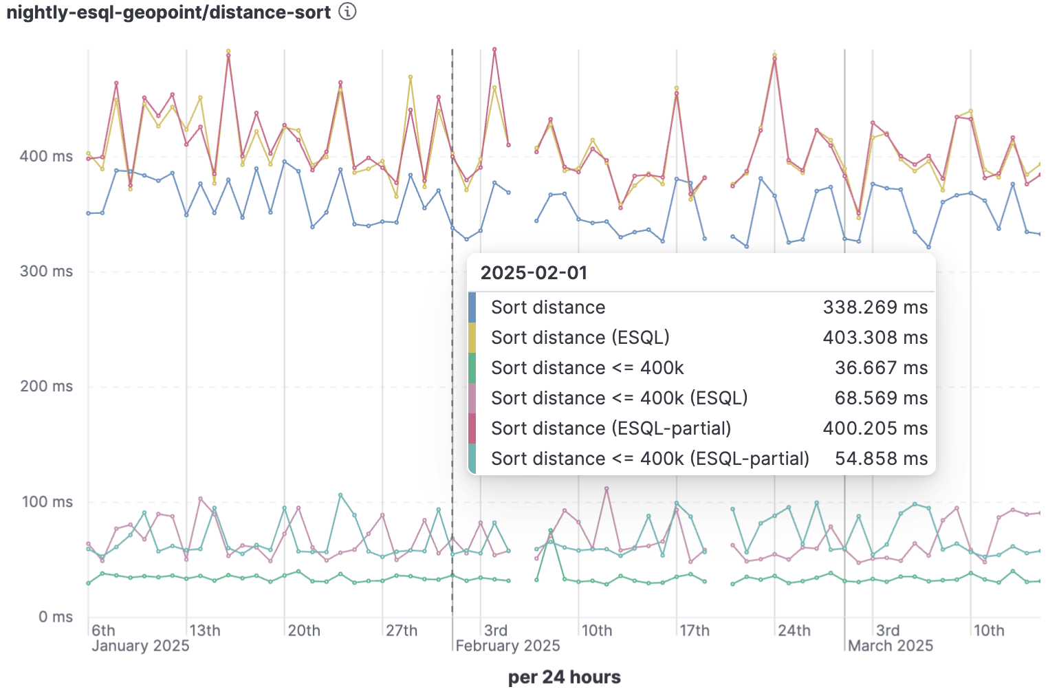

ST_DISTANCE performance
An obvious question is how does the ST_DISTANCE function perform? At first glance, it seems like it would be slow, as it requires calculating the distance for every point in the index. However, this is not the case. The ST_DISTANCE function is optimized to use the same spatial index as the geo_distance query in the Query DSL. In fact, even the SORT distance ASC command is optimized to use the same spatial index, so it is very fast.
Last year, when we first implemented the ST_DISTANCE function, it took about 30s to run on our benchmarking dataset. Then we performed an optimization called 'Lucene Pushdown' whereby we make sure that appropriate queries make optimal use of the underlying Lucene index when possible, and after that, the same query took only 50ms.
So, how are these optimizations achieved? In general, with declarative query languages like ES|QL, the query engine can analyze the query and determine the best way to execute it. Whether a function like ST_DISTANCE can be optimized depends on the query structure and the underlying data. Consider the following query:

As mentioned above, the performance of queries like this is impressive. In our benchmarks, it took only 50ms to run on a dataset of 60 million points, compared to 30s when no index optimizations were applied.
