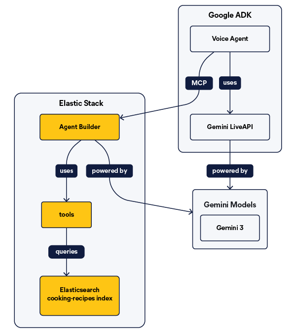

The architecture is straightforward:
The voice agent (built with Google ADK) listens to your speech and delegates queries to Agent Builder via MCP. Agent Builder then searches your Elasticsearch data and returns answers that the voice agent speaks back to you.

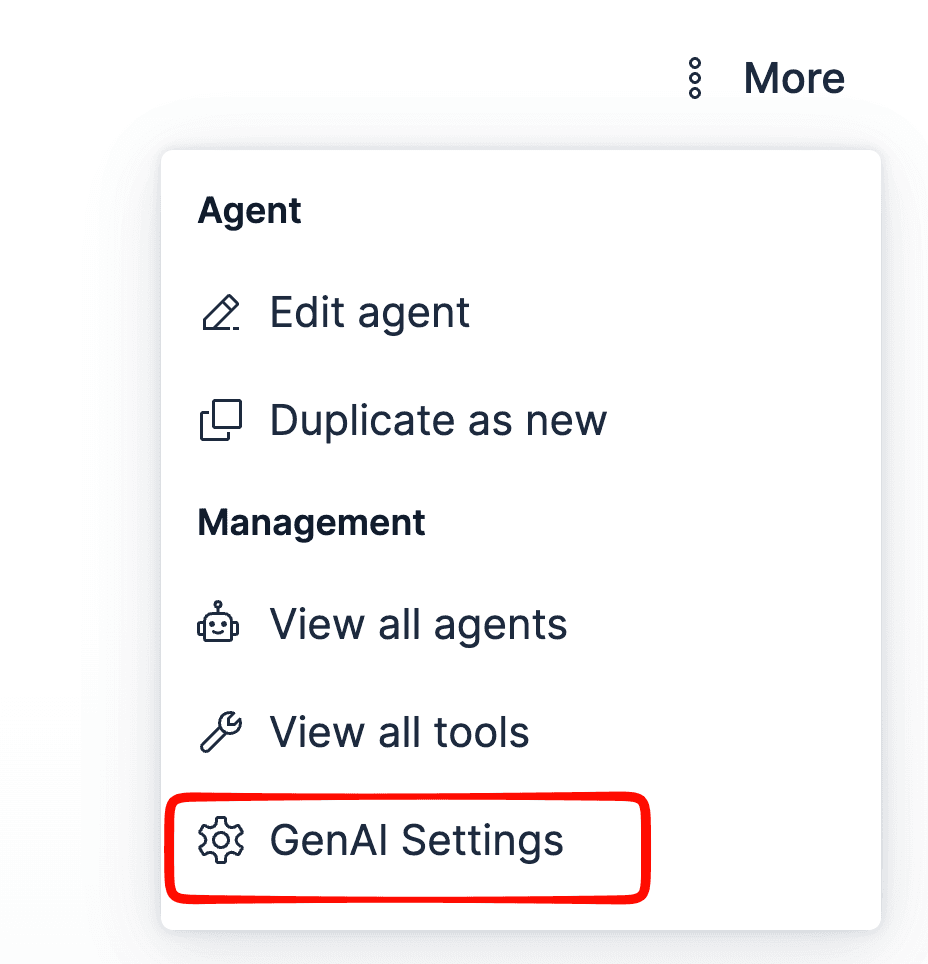

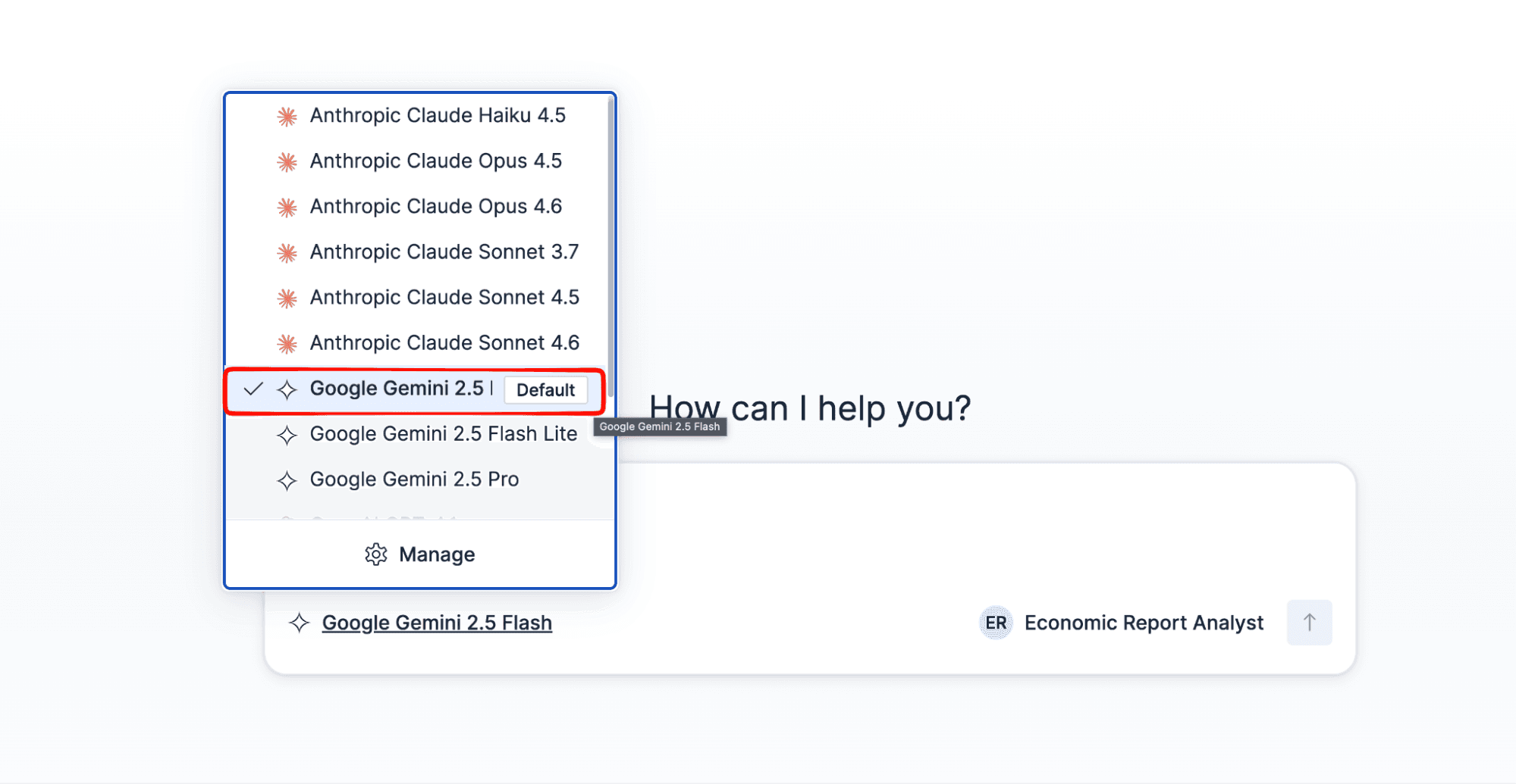

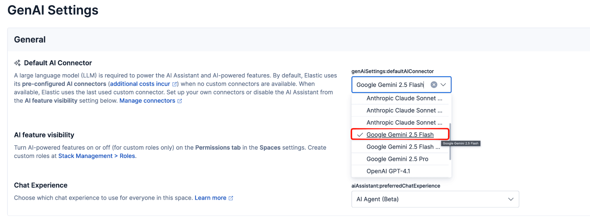

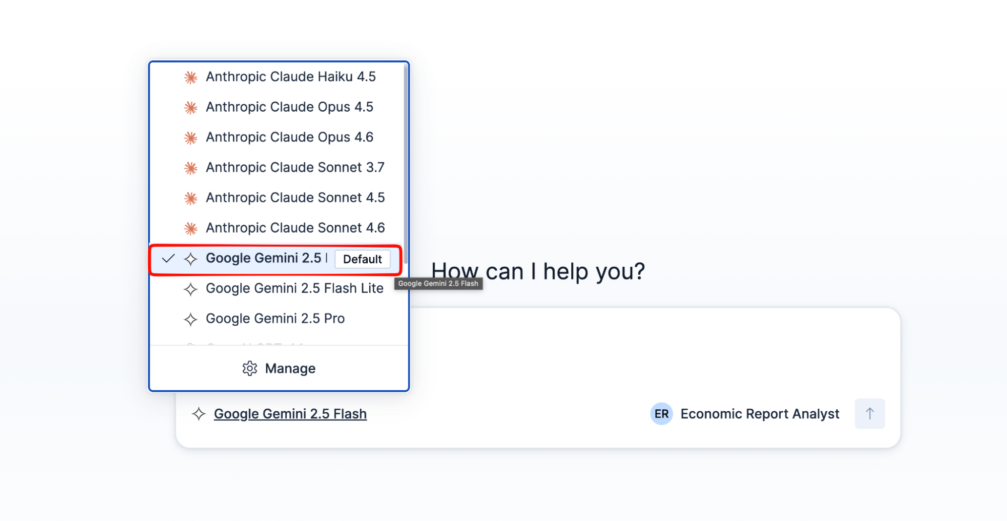

Set Gemini as the default model on Agent Builder
By default, Agent Builder uses Anthropic Claude Sonnet as its AI connector. Since we're using Gemini in this tutorial, open the Agent Builder menu, click GenAI Settings, and select Google Gemini 2.5 Flash as the Default AI Connector. Then, in the chat interface, make sure the same model is selected from the model dropdown.

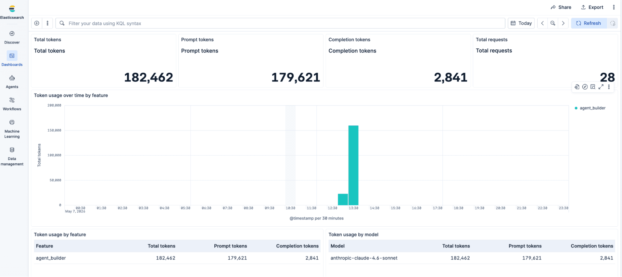

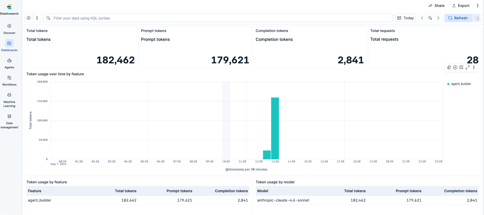

Monitor token usage
Agent Builder integrates with a Kibana dashboard that tracks prompt tokens, completion tokens, and total requests, broken down by feature and model. This gives you a clear picture of consumption across conversations. See the usage monitoring documentation to set it up.

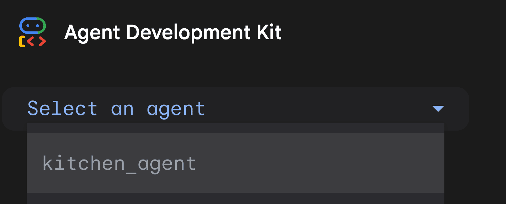

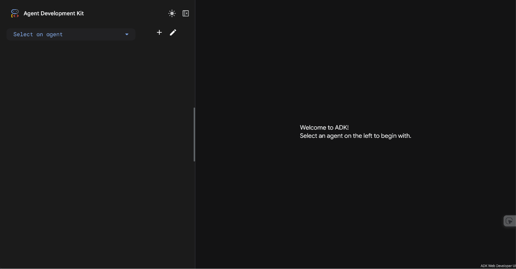

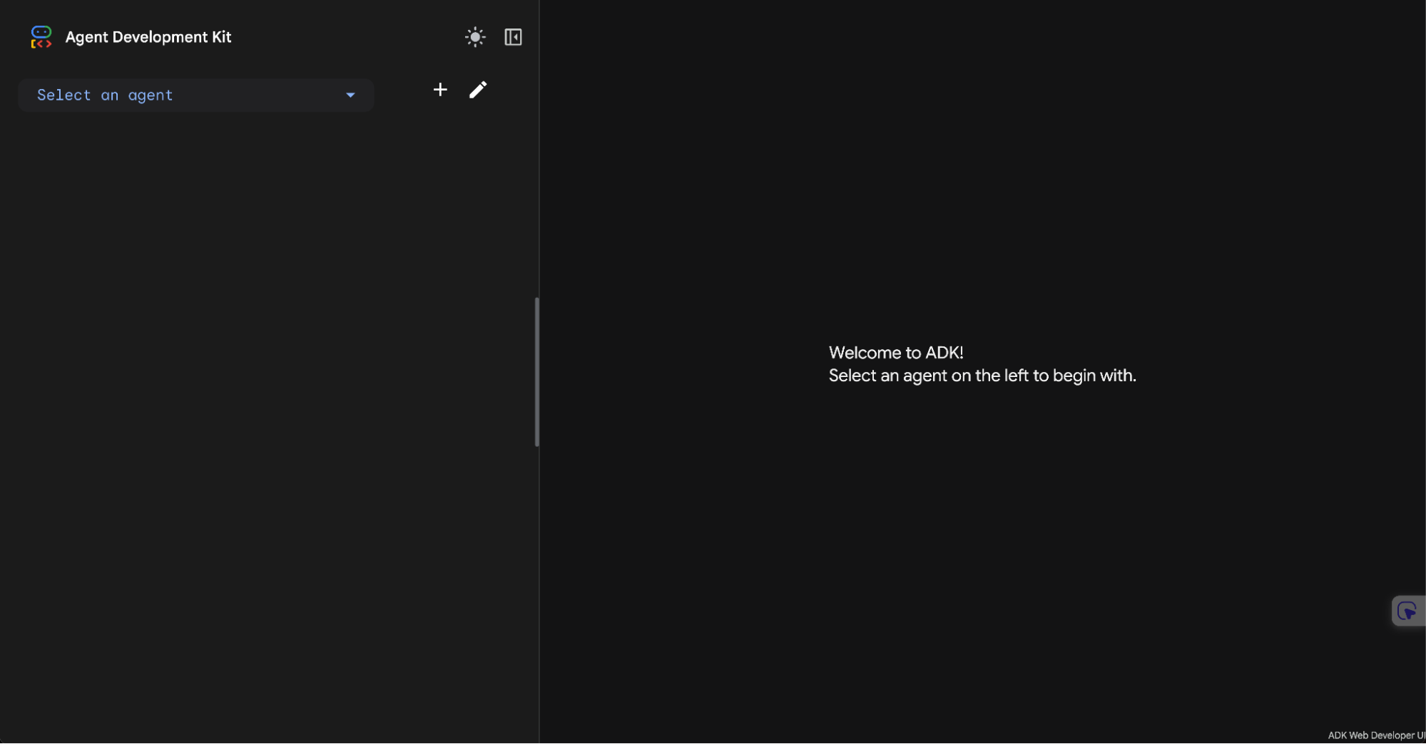

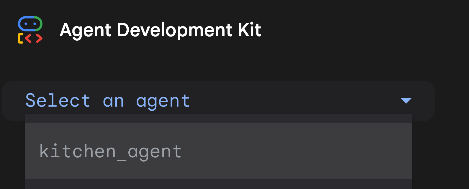

Once you run the web interface option, you’ll see this:
In the left menu, you can select the created agent:
Once selected, you can start chatting with it.

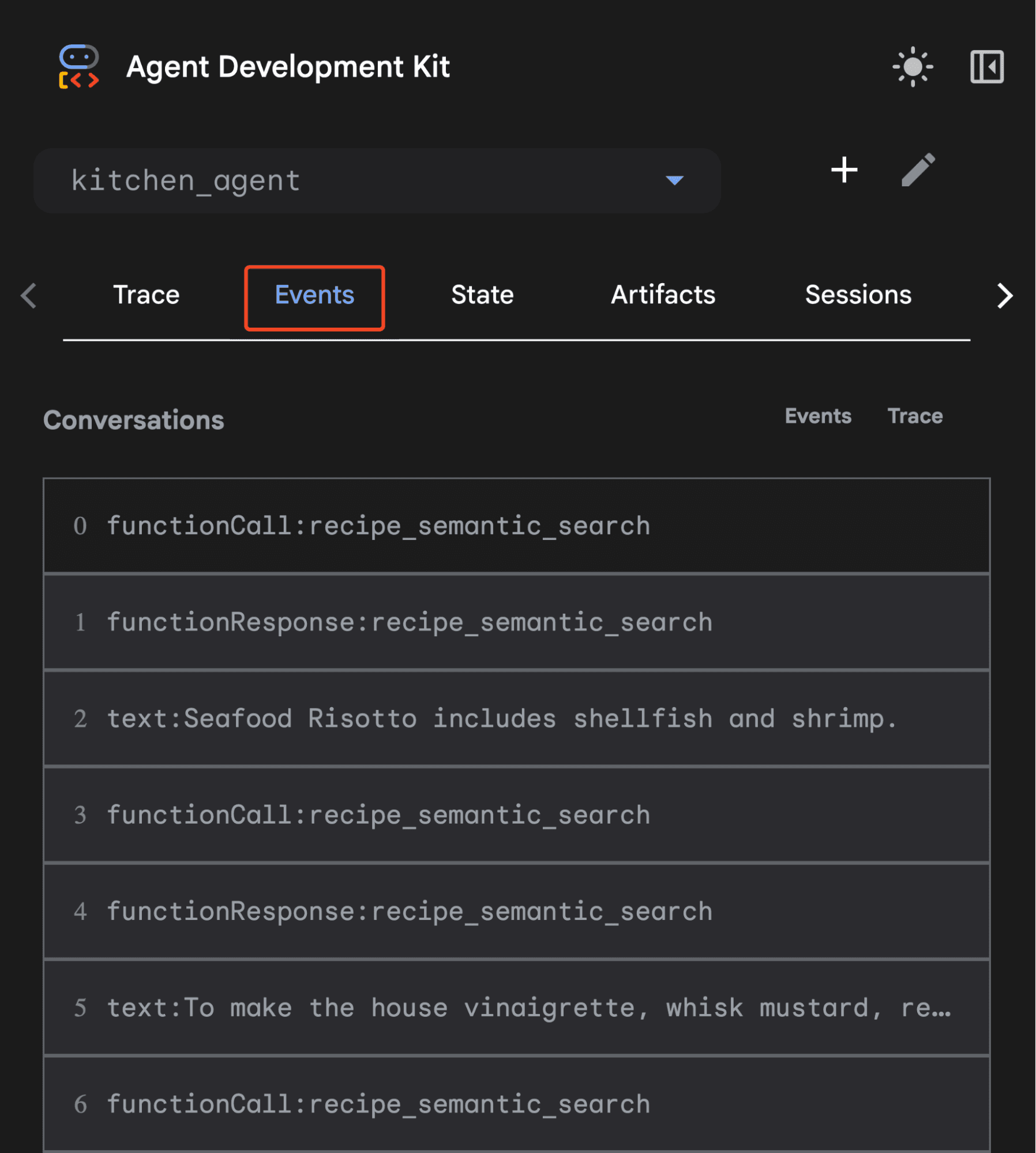

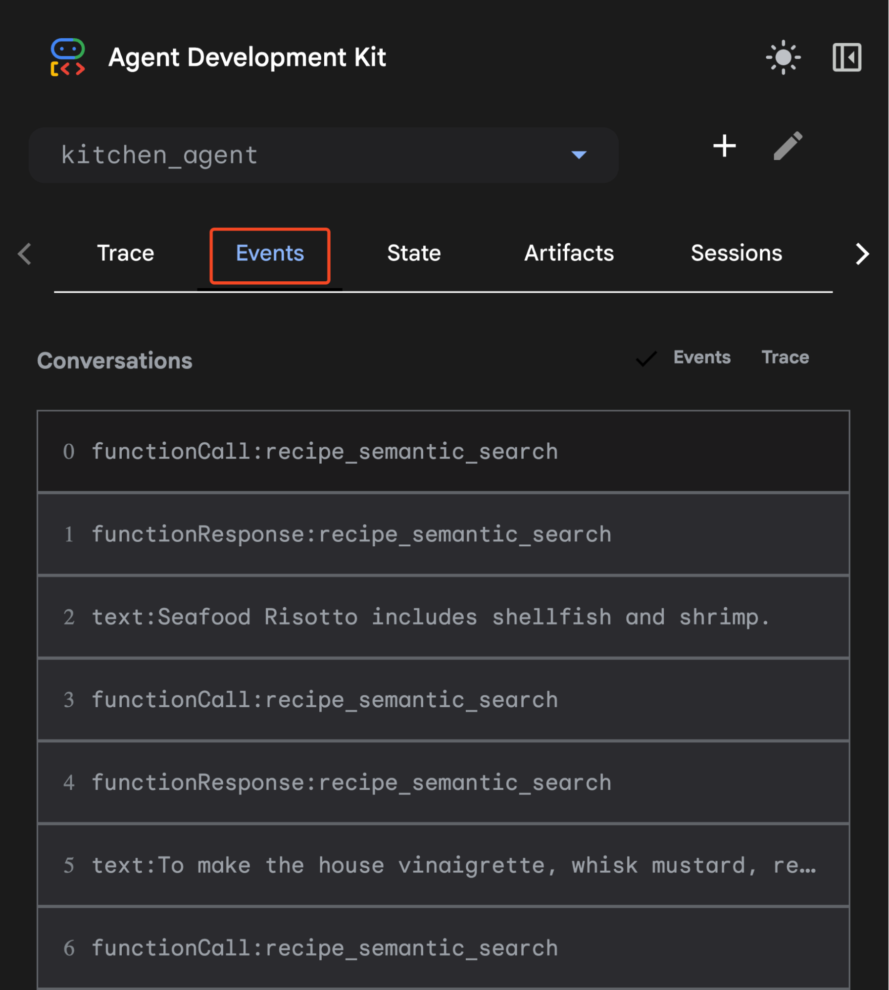

Events view

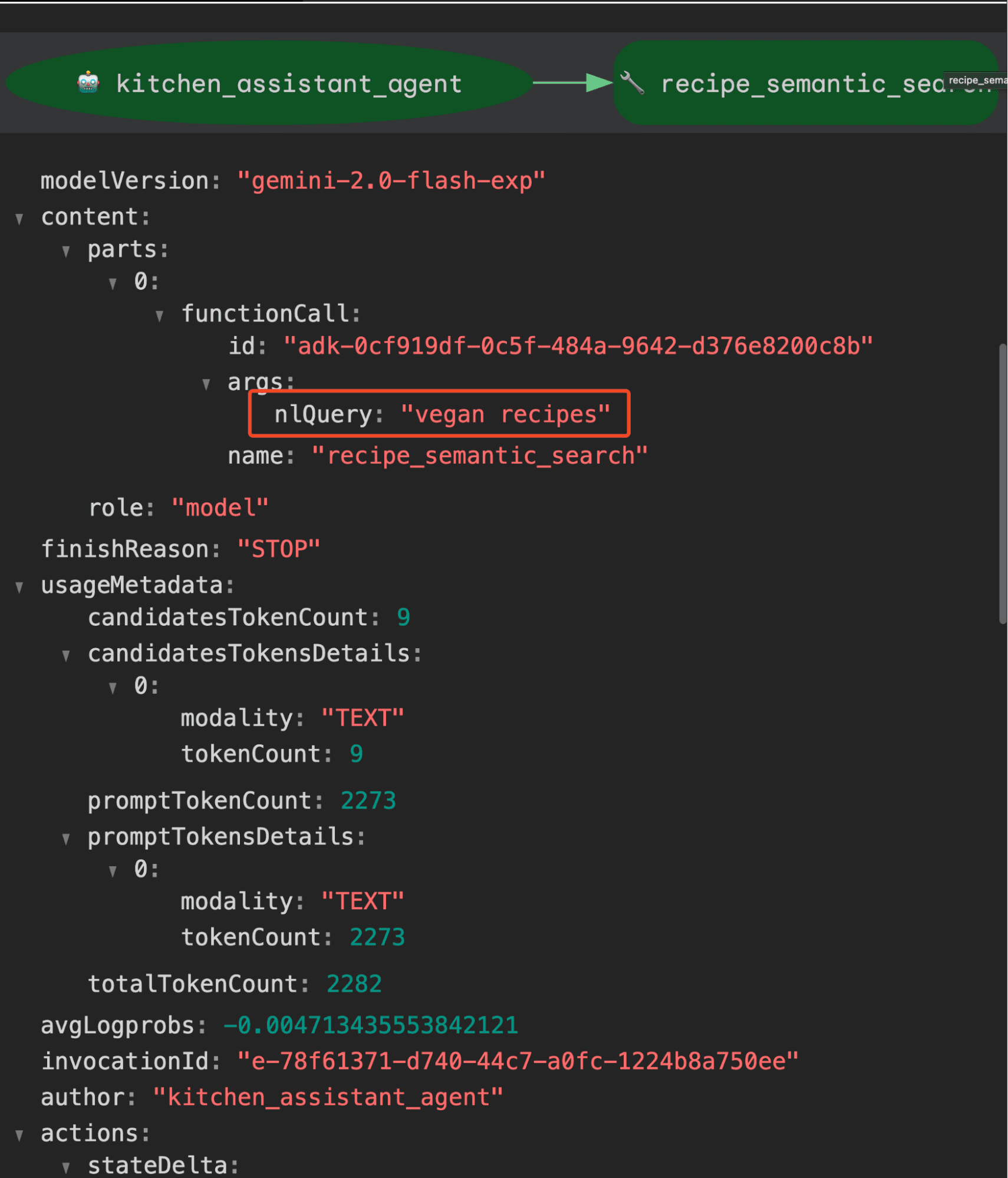

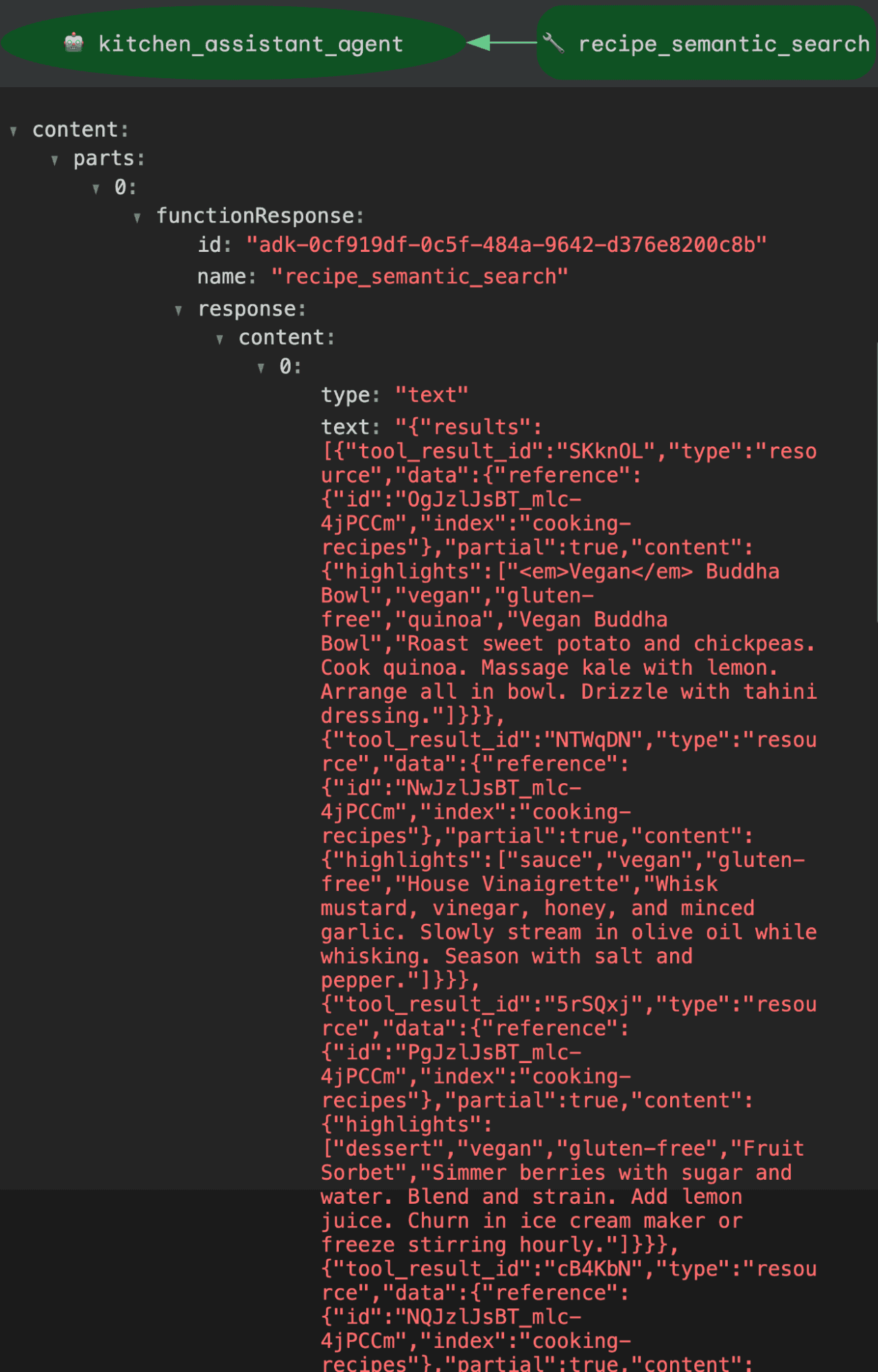

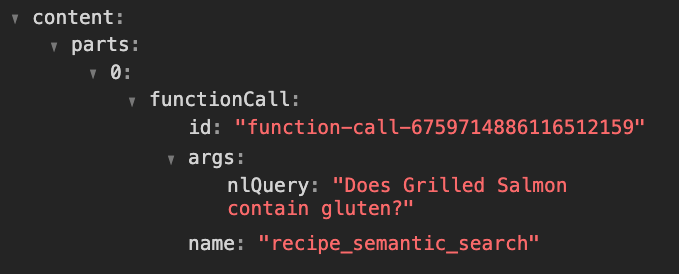

The web interface allows you to debug the operations executed by the agent. In the left menu, you can find the Events view, where the event calls are available.
In the function calls, you can find the executed query in Elasticsearch, and in the function response, the hits retrieved by the semantic search.
Query sent to Elasticsearch:
Hits response:

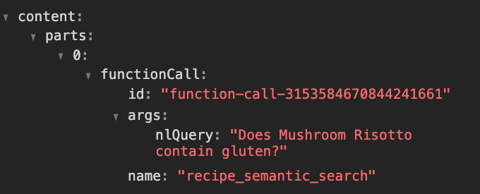

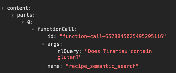

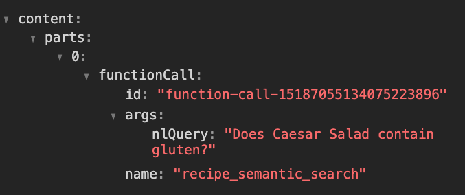

As you can see, the responses were fast. Now let’s see what was sent to Elasticsearch by the model.
In this case, the model triggered four semantic search requests to Elasticsearch, one for each dish in the order. An interesting point is that the model made the requests in the same order as in the list, which means it was able to identify how the order is organized. This opens the door to many useful use cases, but that will be a story for a future article.

  • Connecting ADK to Agent Builder via MCP server.
The kitchen assistant pattern applies to any hands-busy scenario: warehouse workers checking inventory, nurses accessing patient records, or technicians querying maintenance manuals. The combination of voice and video input, plus Elasticsearch's search capabilities, opens up use cases where traditional interfaces fall short.
